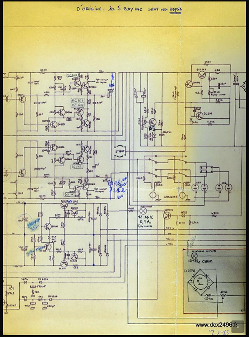

look at this schematic of the Mach50 we designed in 1970 and a link to the site of a guy witch had make a restoration of it. (Please, look at the feedback !)
SCIENTELEC Haute Fidélité française

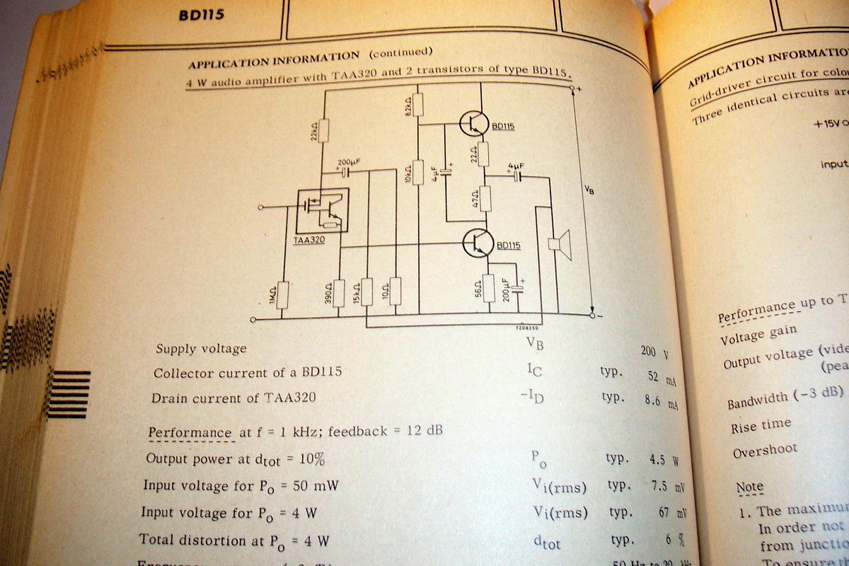

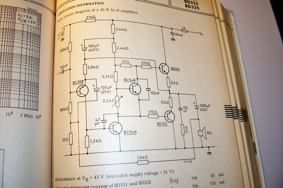

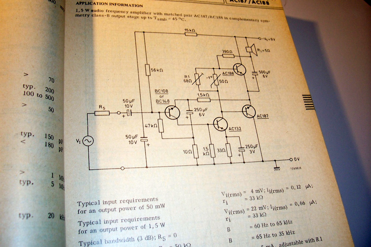

The vast majority of the amplifiers from that era (~'65 to '75) had a single supply and capacitive coupling.
That configuration of the single transistor used as a subtractor was therefore the most straightforward, economical and effective, and it was used in ~75% of amplifiers designed at that time.

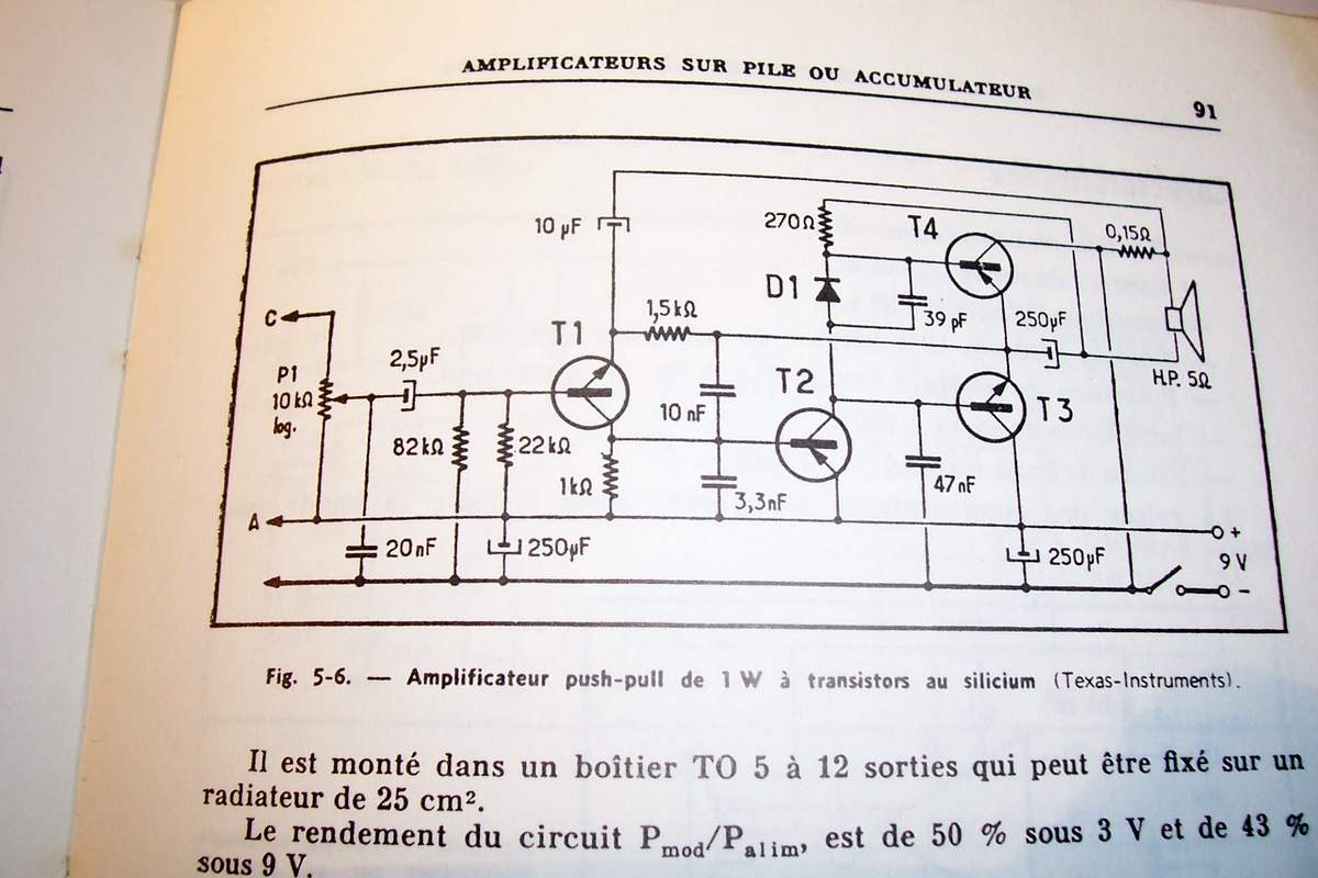

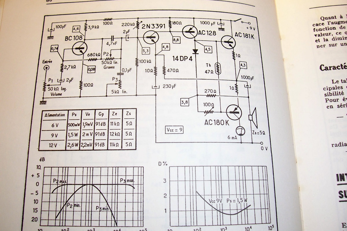

First, three examples using Ge transistors, from Philips, Siemens and Thomson.

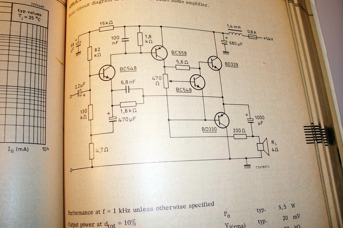

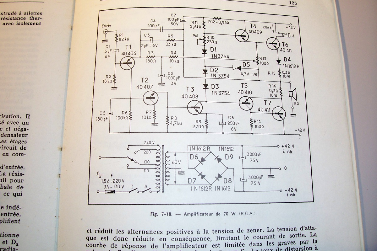

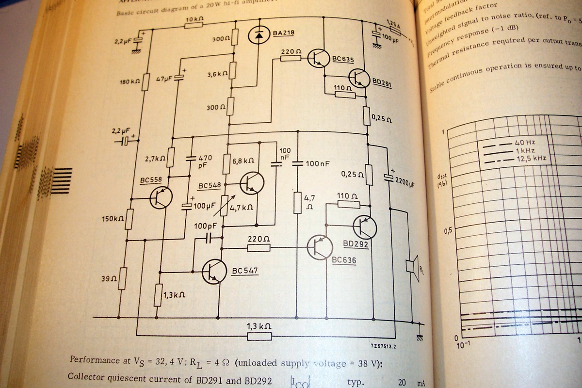

Then, some later examples based on silicon.
But there was no awareness or intent from the designers to create CFB, quite the opposite in fact: this effect was seen as nuisance, as it spent uselessly part of the loop gain.

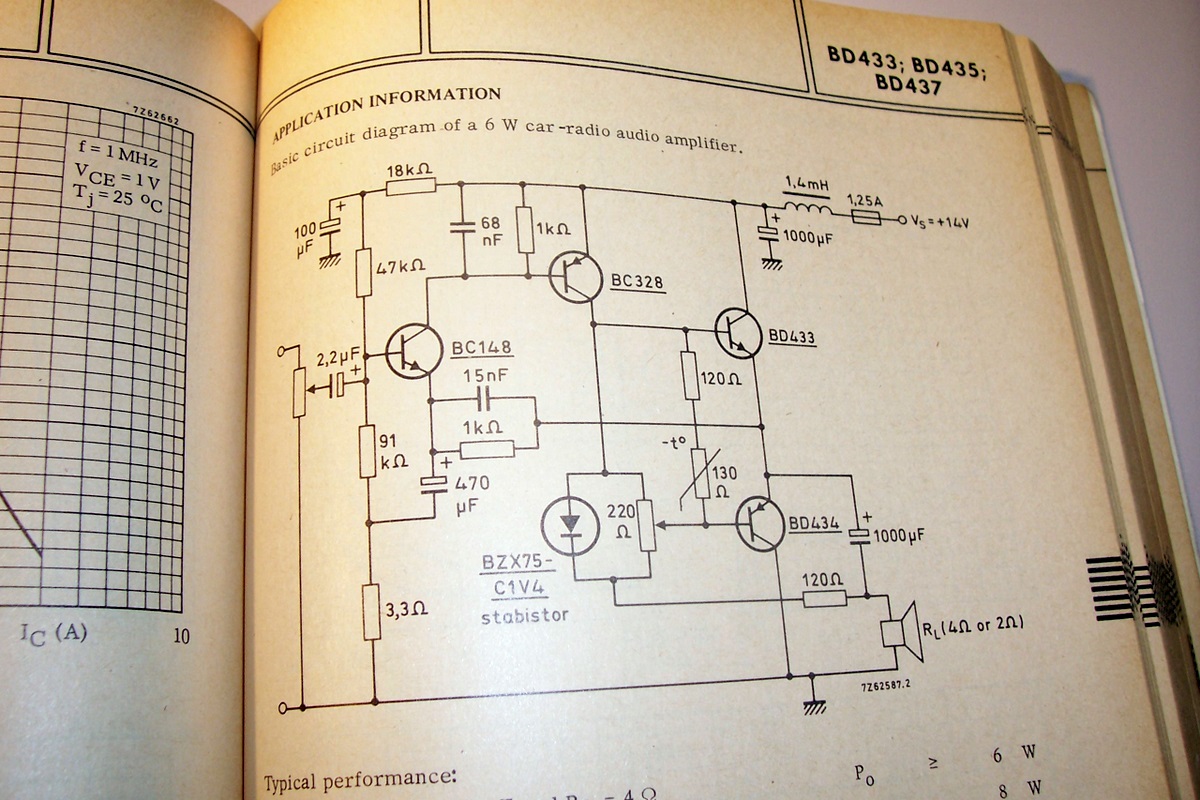

There were therefore "clever" attempts to circumvent the effect, without using a disproportionately large feedback electrolytic (necessitated by the low impedance of the FB network).
The next pic shows an example of such a smart scheme, where the speaker is part of the impedance of the FB divider.
Finally, a curiosity: an amplifier duplicating the tube OTL, with a composite MOS/bjt IC as input, also with CFB.
Now, you could say that CFB already existed at the time, but unbeknown of the designers, "à l'insu de leur plein gré", just like Mr Jourdain had been speaking prose all his life without knowing it.

I'm impressed with your schematic library ! We had no time, on our side, to look at other's company work. some in the datasheets, yes...
Note: Our amp had something a little special at this time, using the first planar power transistors for more speed (BDY56, if i remember well)...

First transistors amps had a justified bad reputation. At this time, no one i knew was able to compete with my tube Macintosh.
The company i worked for at this time had started his history, before our arrival, selling kits and amps, based on an RCA schematic, with 2N3055s. Cheap and absolutely awful !
We had worked a lot on this Mac 50 to make-it a good 2X50W amp.
And i suppose we reached our goal, because it was my preferred amp during decades (despite grass is always greener elsewhere) and the guy witch had refurbished-it has published positive comments on its sound.
"When released in 1971, this unit which remained until the end the flagship of the manufacturer, was a racing car in front of witch very few American or Japanese amplifiers could compete.
Amazing performance (0.05% THD) instantaneous power 200W, volume controls and tone controls with switched fixed resistors, protection against overload, such were the characteristics of this amazing amp. This copy is one that my dad bought in 1973"
and, in a mail to me:
"These amplifiers are still along the best I have ever been given to listen."
I was pretty proud of it
