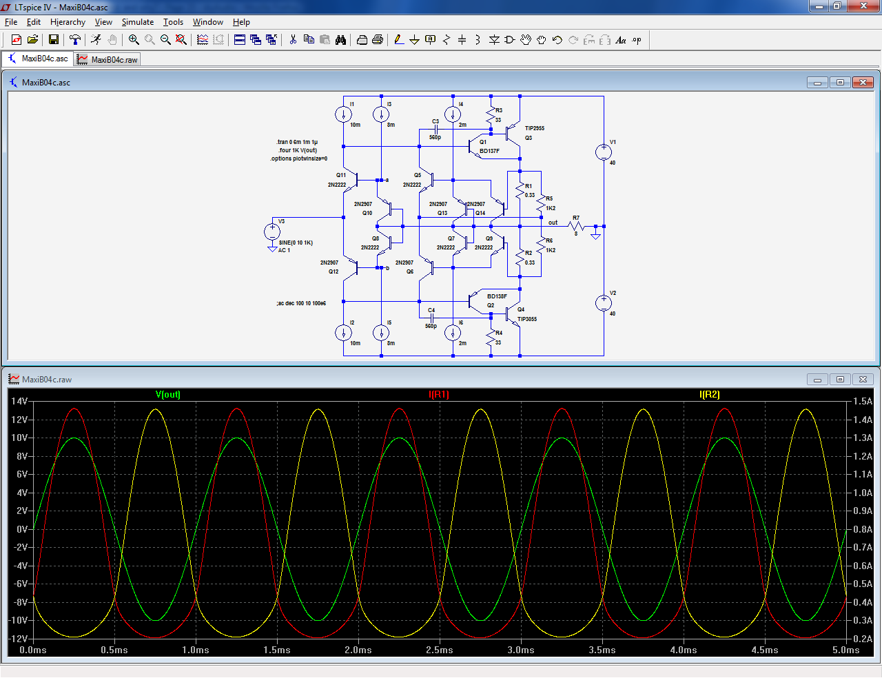

That is not quite true: the "handover" parameters can be shaped to any degree by altering the current densities ratios in the control transistors. See a "softer" example:

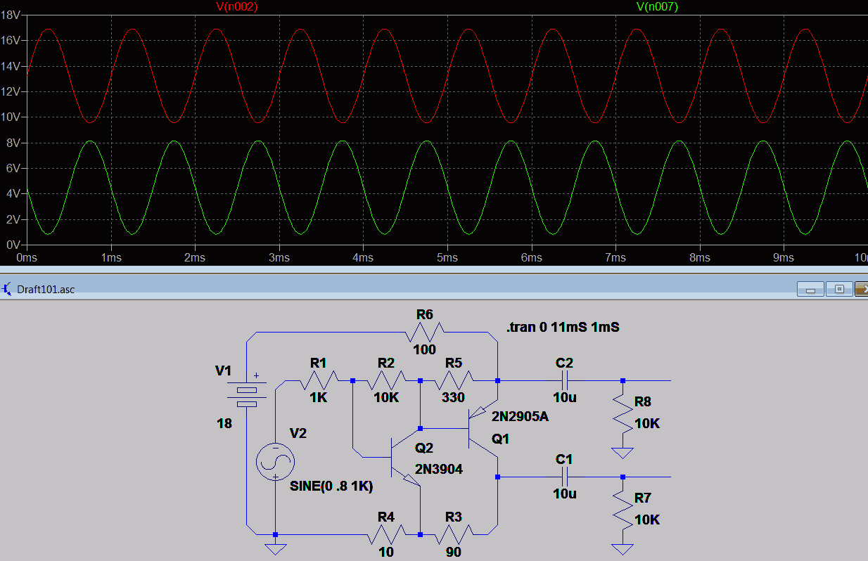

... , and the collector is normally never used as an input.
CFB from collector makes this splitter have equal impedance and gain.
*** OK, half each behavior is impedance, and half cross coupled noise
that (if the loads are equal) just happens to look like impedance ***
For those confused by simultaneous CFB from the anode, its the same
theory of operation as the triode hybrid splitter from a few posts back.
We just make a real simple triode emulator using collector as an input.
I remind that it is not normal for the concertina style splitter to have
any voltage gain. But thanks to R3 R4 CFB, this one does. Also is not
normal for top and bottom impedances to be equal. But again, thanks
to R1 R2 and CFB...
Emitter of Q2 swings 1/2 the input voltage, just as it might in a LTP.
Thats probably an important observation, not quite sure why...
Now, look back to Elvee's OP circuit and compare.

The MaxB topology is completely experimental, and it has some interesting peculiarities. Among them, is the independent control of the two bases of OP transistors (required to achieve the linearity).
In more classical topologies, the interbase potential is set rather rigidly by a low impedance network, like a diode string or equivalent.
In MaxB, both bases see a high impedance, from the drive transistor's collectors and the positive and negative CCS. As this wasn't enough, the CCS's pull in opposite directions.
This means that there is not only plenty of room for things to go wrong, but when they do, to do it utterly and in the most spectacular manner.
If there is hiccup in the control part, or a beginning of "vertical" oscillation, it ends in an immediate destruction of the transistors.
Imagine what happens when the vertical loop (the one controlling the xover) oscillates: if the input is fixed at 0 potential, the collectors of the input transistors have a dynamic of ~0 to +/-40V. If the average level establishes itself at 20V, that is sufficient to vaporize instantly the OP transistors.
This can happen for various reasons, inherent stability problems, tests on reactive loads, lock-up of the control part, etc.
I have tried to include to safety accessories, like a diode string supposed to keep things at a safe level when things get out of control, but a string short enough to be effective also tends to disrupt the operation of the circuit and kills the performances.
In the end, I prefer to blow cheap devices until the thing is sufficiently debugged

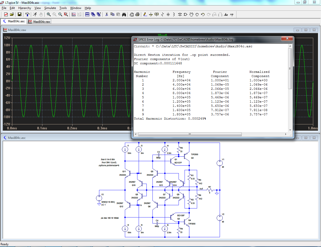

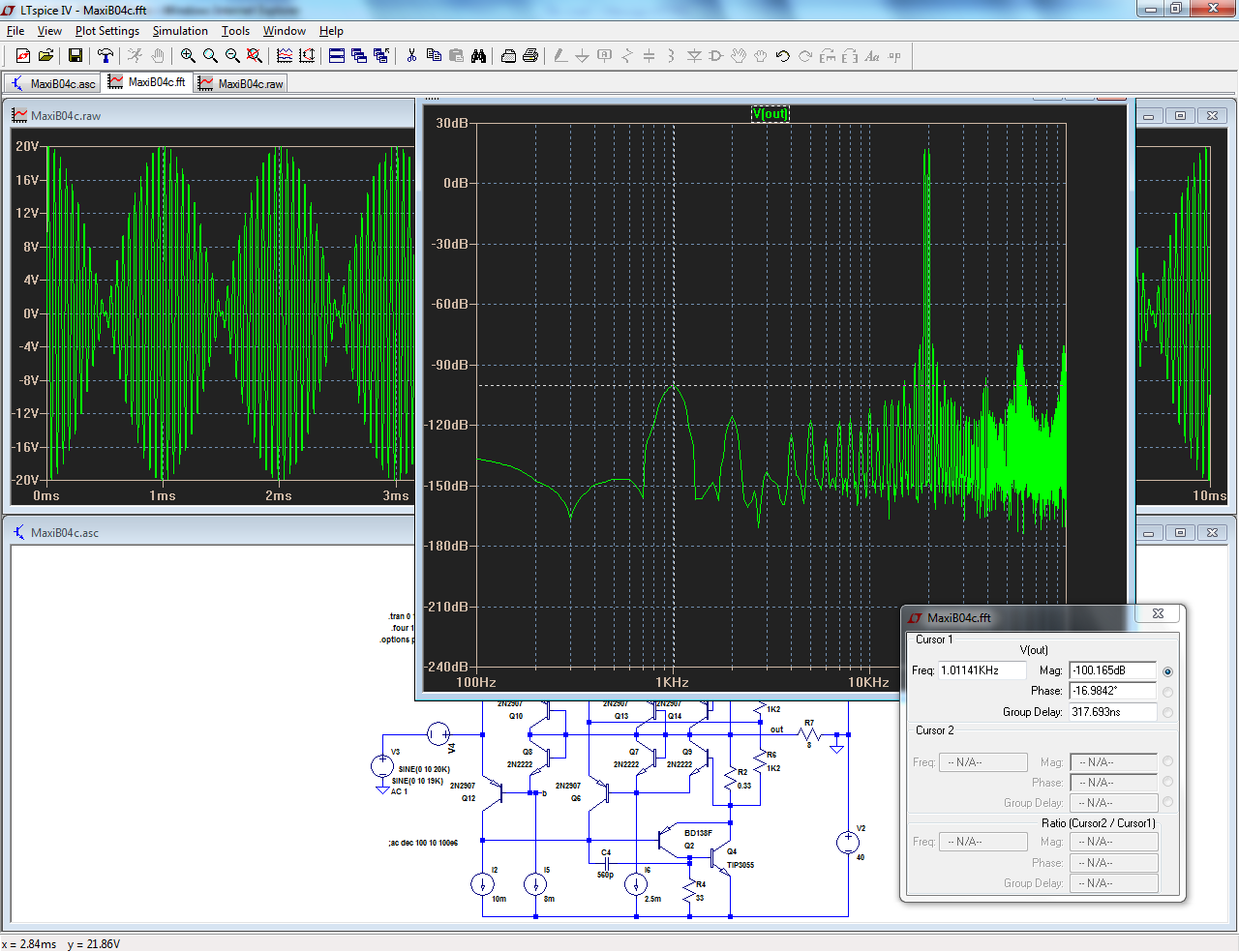

And about your last schematic, please, think about slew rate and the related TIM at high levels. EOT for me.
TIM is an old red herring, but an amplifier would need to be much worse than 14V/µs to show the effect. In addition, this OPS uses low grade devices and a brutal compensation scheme which could easily be upgraded, but nevertheless it is entirely fit for audio, and wouldn't be pushed to its limits even in demanding situations: the distortion at 20KHz is only marginally higher than at 1KHz (even if does not really matter), and the IMD at 20KHz is even lower, at a nice -120dB
