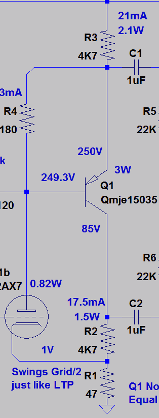

This is what I done with CFB: Attenuate feedback to the cathode.
Making collector gain and impedance equal with Plate+Emitter.
Keep in mind the AX7 plate gives 1/100 feedback, so attenuation
ratio for cathode feedback wants to be set about the same.
"Normal" thing would have been unity gain at the cathode. And
approximate inverted copy at the plate, with unequal impedance.
This was intended a phase splitter for a hybrid amp, if omission
of the irrelevant context of circuit made its function hard to see.
Now we got a concertina splitter with +50/-50 gains. Go figure...
I'm just sayin' this topology has other uses beyond the obvious.

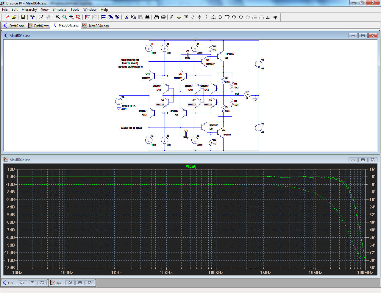

If you could see where is my power amp, and the time it ask-me to unplug everything and get-it out, you would understand why i am lazy to do-it 🙂the answer is still on the waiting months later.....
In my sim, current feedback, no signal, values are around:
645µa in R1, R2
1.25ma in R6 R29
736µa in R12 R 26
138ma inR21, R22, R24, R23

645µa in R1, R2
Hence , there will be about 645mV voltage drop across R1 and R2 ,
not enough to bias the BE junction of Q7/Q9 whose emitter resistors
low value will induce extremely temperature dependant current
once the VAS start to conduct substancialy.
736µa in R12 R 26
This is the VAS quiescent current....
As already said , the VAS work in the edge of class C while the low value
of R12/R26 allow it to supply high current once it enter conduction leading
to high slew rate.
Given the value of R12/R26 , once the VAS is class A biaised its
quiescent current will increase dramaticaly at a rate of 10mA for 100mV
variation of the voltage across the said resistors and will be highly temperature dependant as Q7/Q9 have 2mV/°C VBE variation with temperature, hence the VAS current will vary at a rate of 0.2mA/°C.
The result is that at very small output voltage the amp has
low open loop gain and reduced bandwith.....
Once the VAS conduct , its transconductance rise dramaticaly ,
and the amp bandwith and open loop gain increase accordingly.
If the VAS is biased in class A the amp become instable.

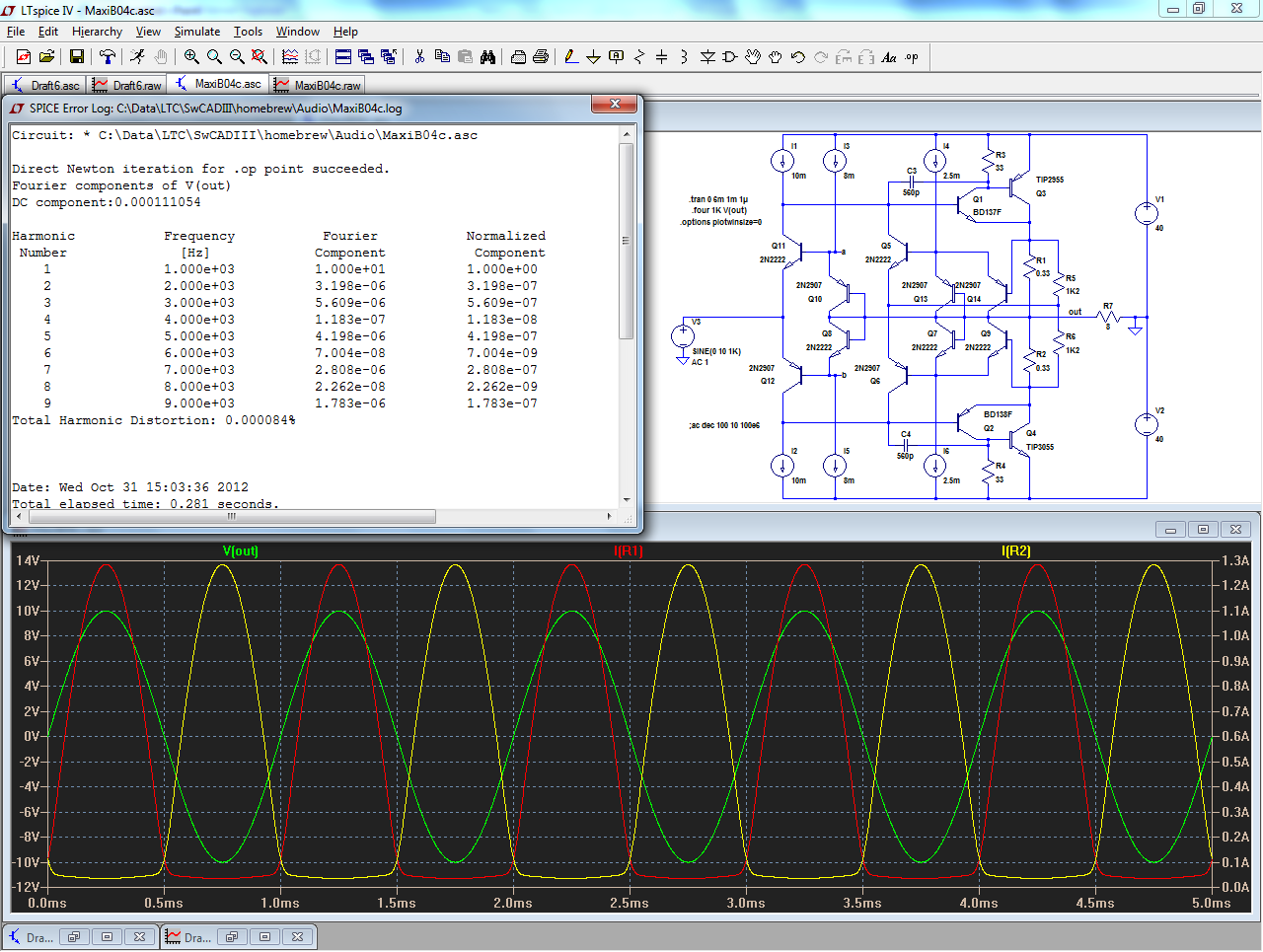

I believe in my old LEA. The original amp showed something like 0.008/9 % reduced by something i evaluate as a 10 factor with current feedback (needle was moving too much with the noise to can measure anything).A distorsion test would be interesting , just use whatever
soundcard you have , it will be enough up to a few Khz.
As spectral analyzer Visual Analyzer or RMAA should do it perfectly.
Such estimation cant be right as it involves one order of magnitude
better linearity , yet there is still two stages and the original Crescendo
already almost maxed out the THD numbers that are possible for two
stage topologies.
So either your amp has 20db higher OLG , wich is not the case
or the components did magicaly yield ten times better
built in linearity....
Wahab, as i said, it was too low to measure. The only thing i'm sure about is that distortion was decreased significantly.. I tribute-it to the speed improvement.
To close the subject, here is a final example showing how misleading preconceptions can be.
This output stage has performances that most aficionados would think as typical of CFB: sub-ppm linearity, output impedance in the microohm range, etc
Yet, it is a pure VFB, but more than that it is an absolute extremist of its kind: the feedback is 100%, and pure voltage mode, and the input by contrast is almost in current mode (sort of). In fact, the exact opposite of CFB.
Think about it...
Think about it...
Replace Q8/Q10 by low Z resistances, and common base by common emitter for the input stage, what is-it ?
Non switching!
Haw about the bias, is it something close to the Edmond non switching auto bias OPS?
Could you give some more information?
