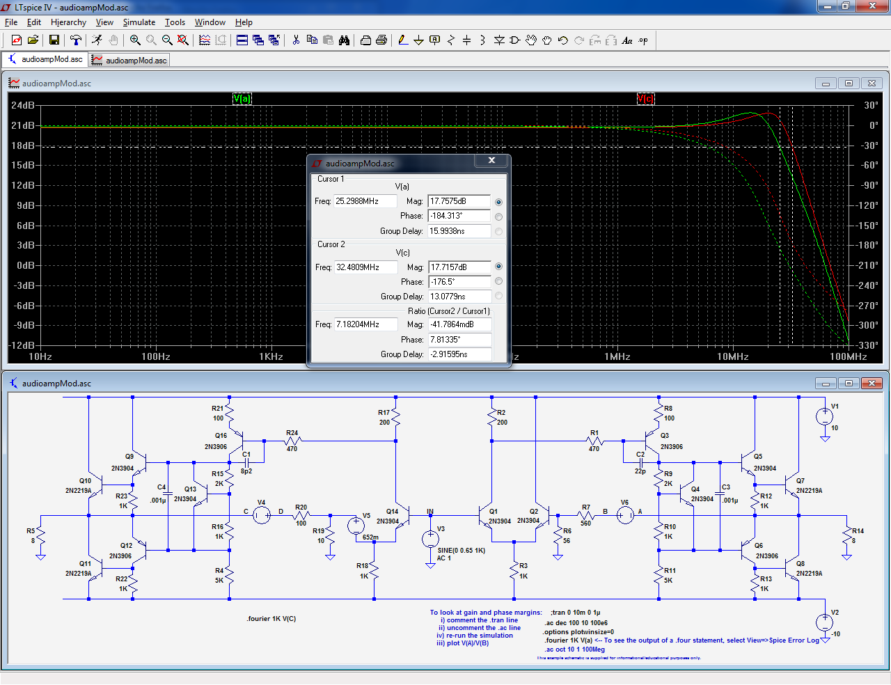

Here is the comparison between the two versions of amplifier from LTspice's examples.
The test conditions have been properly normalized, and the silly impedance levels corrected (at least for the VFB; for the CFB I have kept the values chosen by Esperado, even though they are unusually low).
Some remarks about the way the initial comparison was made: with the very low feedback resistor values, the CFB was in fact on the verge of being VFB: the emitter resistance of the transistor at ~5mA is ~5ohm, with the equivalent resistance of the FB network under 10ohm.
This means it classifies as CFB, but just.
By contrast, the ridiculously high values in the "VFB" version made it in fact CFB too, and even more so than the one that is supposed to be so: the input resistance of the transistor is 800ohm, much less than the FB network.
This means that in fact, the comparison was not between VFB and CFB, but between two half-baked CFB.
Another problem was the level, which was so high that it brought the VAS into presaturation.

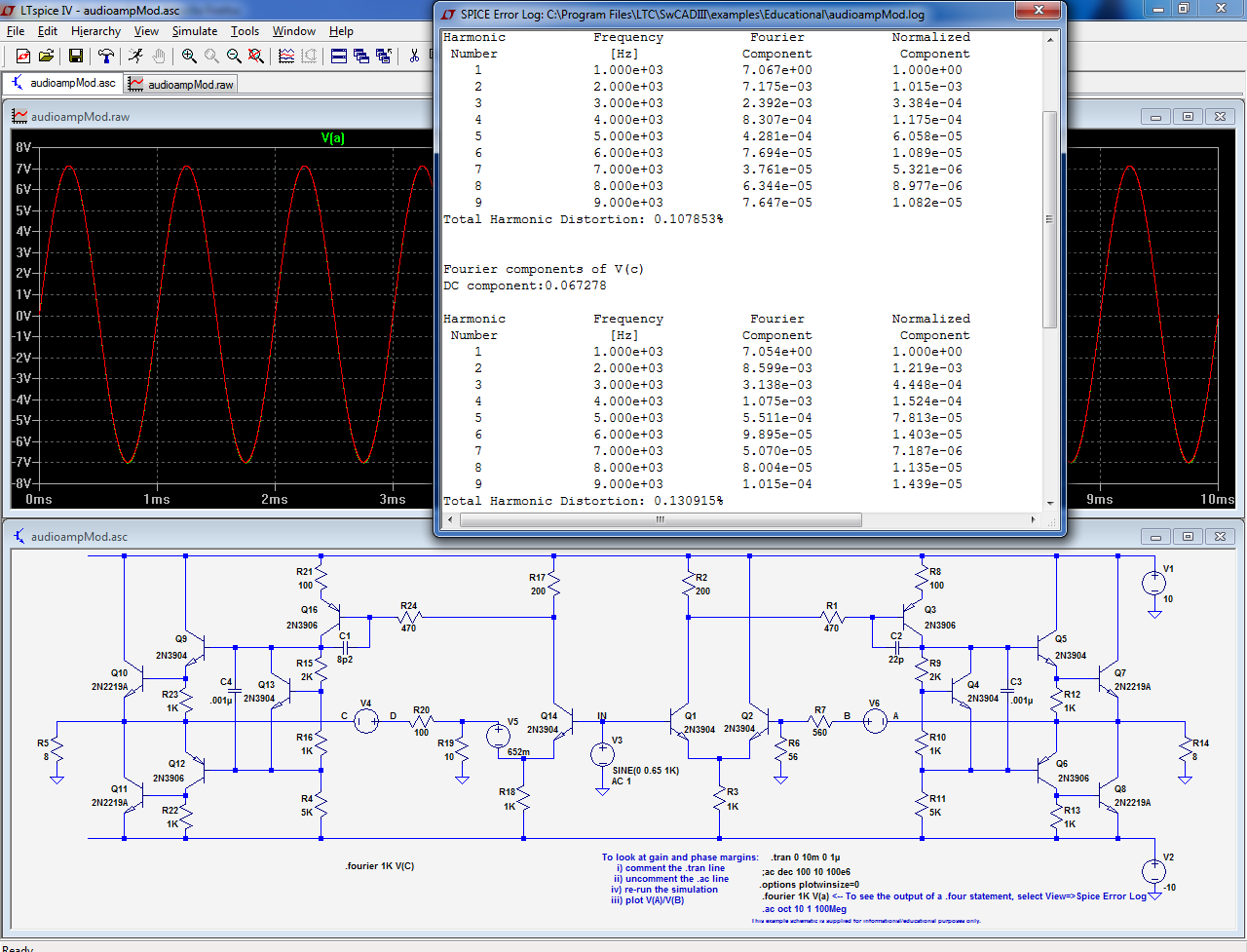

The problems have been fixed, at least partially, the levels exactly equalized, and the phase margins have been set at 50°, meaning the comp capacitor is 8.2p for CFB and 22p for VFB.
THD is 0.13% for CFB, and 0.107% for VFB. Not striking, because in this amplifier, the main source of distortion is elsewhere: it is shown by the high level of 2nd harmonic, which remains high with the VFB, when it should almost vanish. The poor quasi output stage is to blame.
Next is the bandwidth: the CFB has a -3dB point at 32MHz, against 25MHz for the VFB.
Thus, a moderate improvement, traded for a moderate degradation of linearity.
But the poor performance of the amplifier hides part of the picture; which is why the sim I made earlier concentrated only on the parts of interest: the VFB and CFB cores.

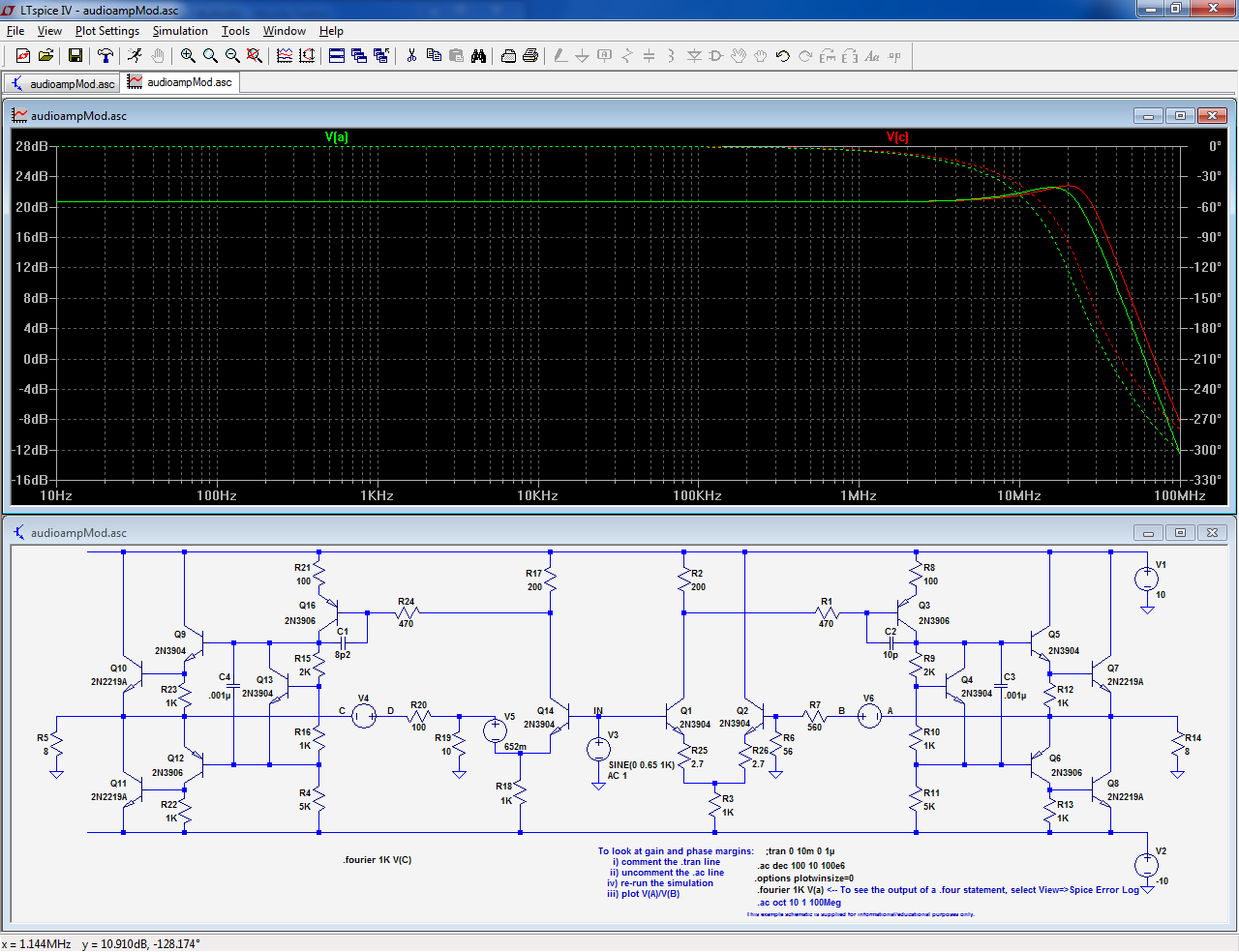

Now, if we want, we can add a degeneration to the VFB to mimic CFB: third pic.
The difference is becoming much smaller, and it is indicative of the true speed penalty brought by the second transistor in the loop.
