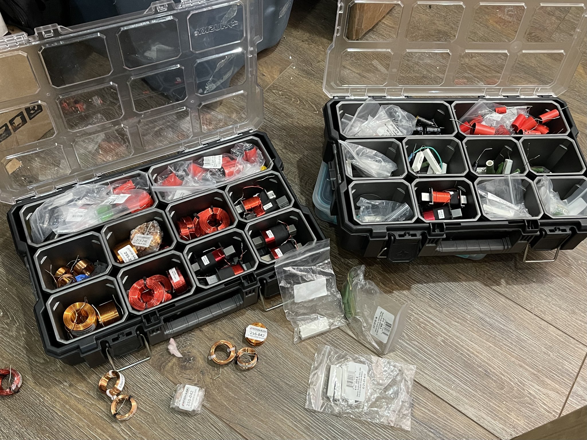

Any of those configurations will have an impact on the driver response if the values of the components are chosen to appropriate values to have an effect. But pick strange values far off the nominal impedance of the intrinsic system and it has little effect. For example, one can put a 10Mohm resistor, 5nH inductor, or a 10pF cap in those positions in a speaker crossover where impedance is circa 10ohms and say it has no effect. But use something like 10ohms, 1mH, or 10uF and it will shape the response. We do this all the time in crossovers.
But to answer your question is it worth it to invest in LRC components for a notch filter. I assume the “invest” word means to use premium, boutique or expensive components. Probably not. Basic quality MKP film caps are $1 to $10 for typical values and similar prices for typical copper air core inductors. Changing from a $10 Audyn 400V MKP cap to a $200 Mundorf silver foil in oil is not going to be a huge difference (IMO). Better to invest $200 in a wide set of LRC “toolkit” of many values. Upgrade if you feel you need to but hard to hear the difference. I do agree that changing from electrolytic NP to film caps makes a bigger difference though. Sometimes adding a small 0.1uF film bypass cap helps a lot and is less expensive.
Here is a kit that is maybe $350 worth of reasonably priced but high quality components. Is a single boutique cap worth as much? I use this for all my crossover development work and I have enough parts to prototype almost any crossover in minutes.
