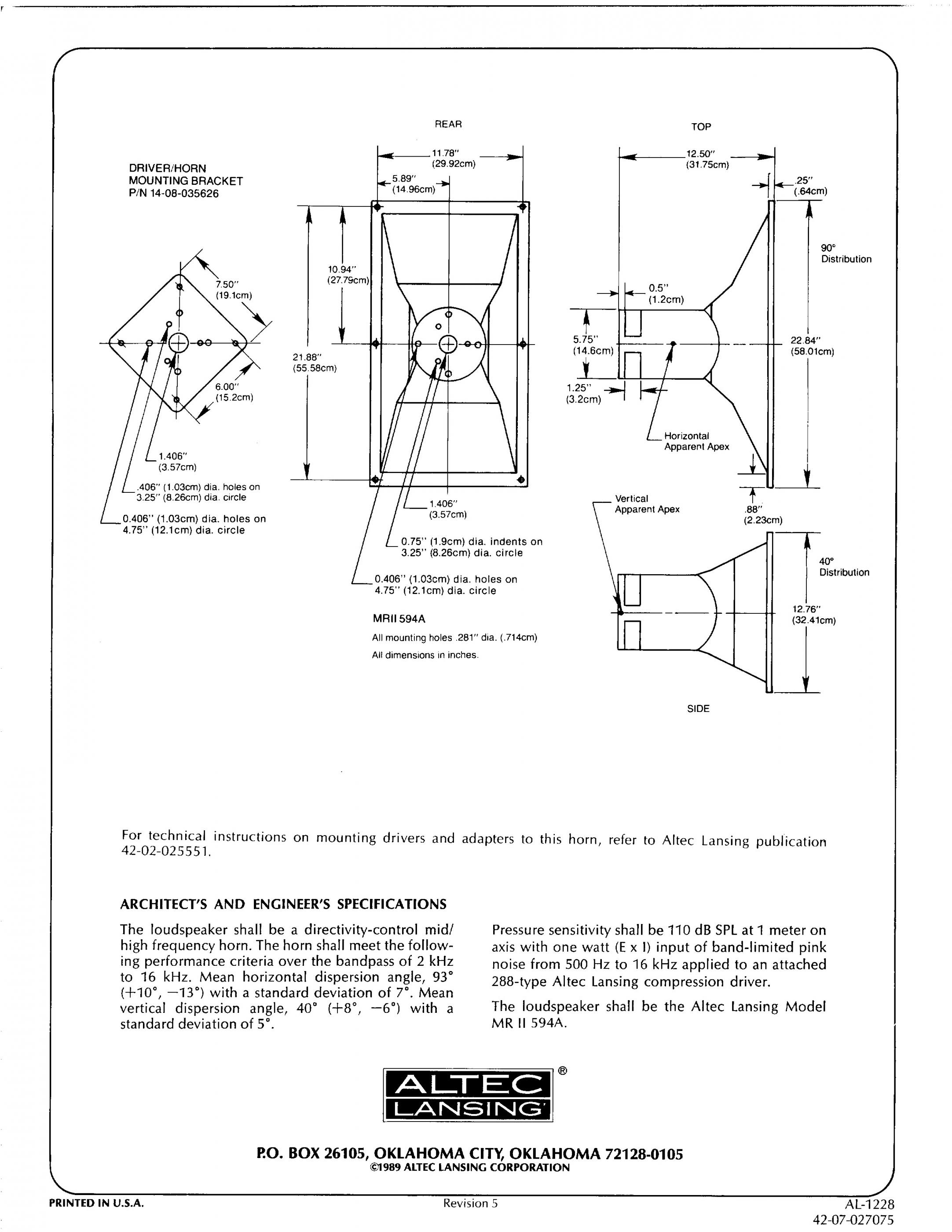

Apparently, MRII 594As are quite rare.
For the sake of completeness:

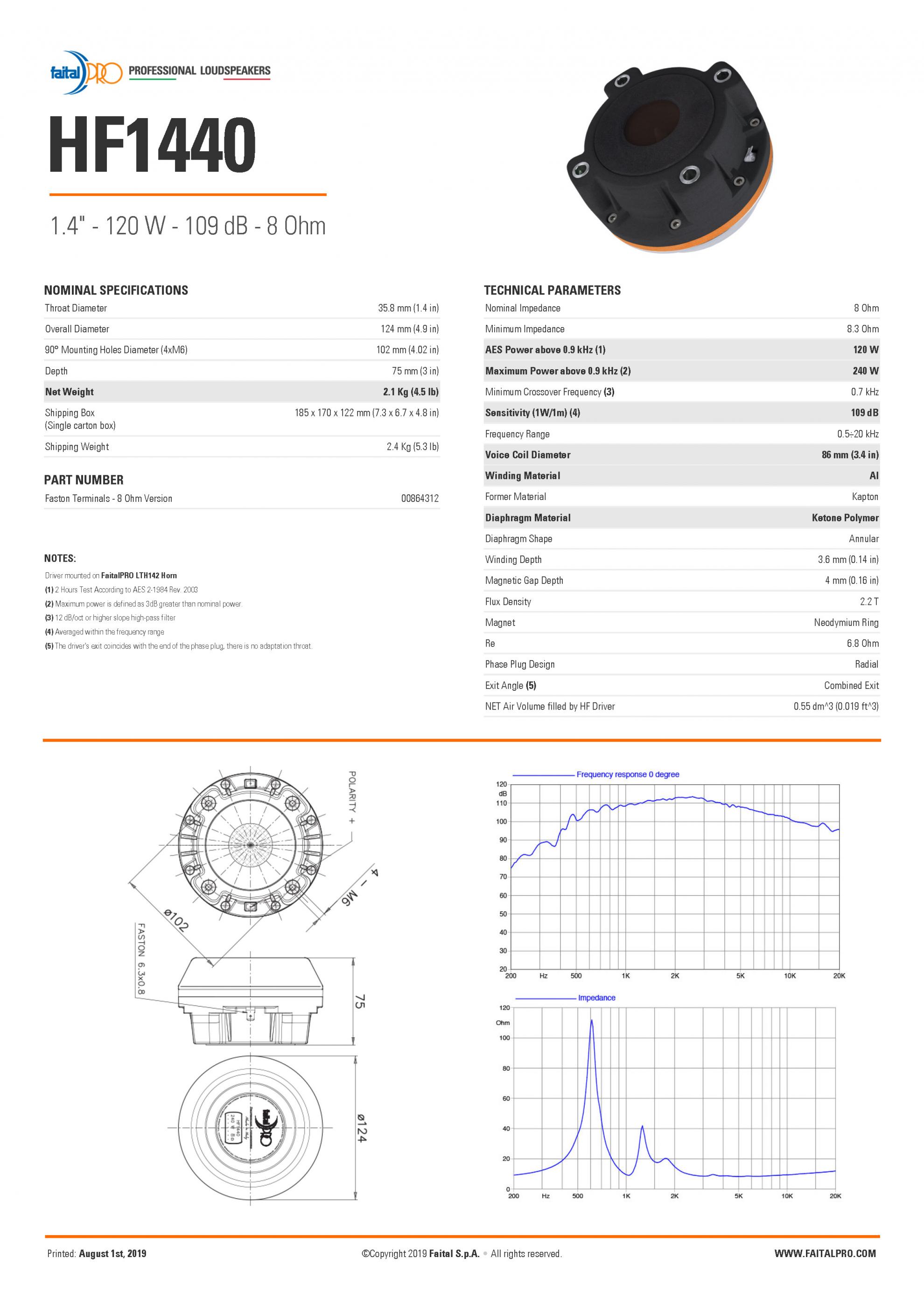

which 1.4" driver best suited for the manta ray horns? Apart from $$$ altec units?
I would try Faital Pro HF14X drivers:
https://faitalpro.com/en/products/HF_Drivers/

Hmm, lowest is 700 Hz, so not in the same league as 500 Hz Altec/GPA, so guess an XO point needs to be spec'd.
GM
Personally, I'd (like to) try this one... on the MRII 594 and many other horns.
Changes are, it would work well. At least, it's also got a radial phase plug.
The specified 700Hz minimum XO freq. (for PA) translates in 500Hz, probably even lower, at home.
I will just find a 1" to 1.4" adapter and run the altec 808-8b with the MRII 564 horns. Being able to play down to 500hz seems interesting.

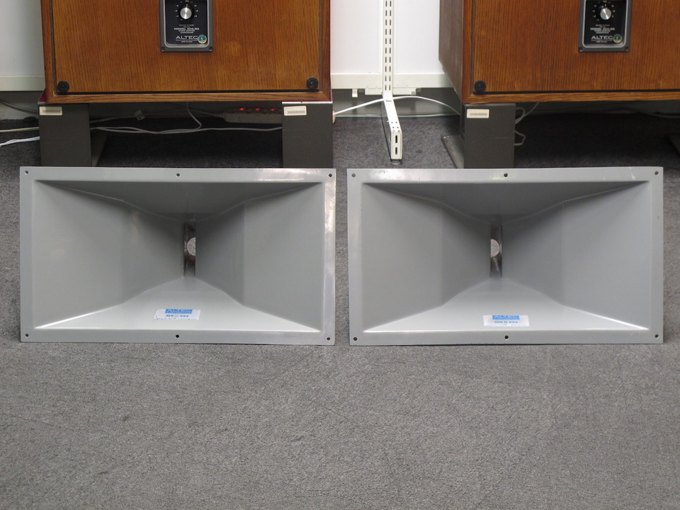

My own horns are slightly bigger than the MRII 594.
Total depth -0.75 cm
Mouth height +9.5cm
Mouth width +3cm.
The mouth is more akin to a JBL Bi-Radial though.
I'll post some pics one of these days.

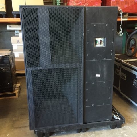

DIY or ?

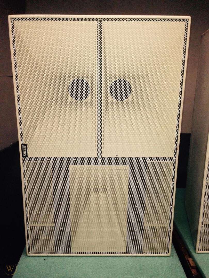

No, these were once ordered by a local audio engineer/entrepreneur and inherited by his business partner/friend who builds custom cabs.
So far I haven't been able to ID the manufacturer.
These are well made fiberglass horns, somewhat similar to Community.
They look similar, but identical, to some of the bigger EAW horns.
About 30% bigger than the horn on top of the stack in the first image and probably closer in size to the mid/high horn of the MQV 1394e in the 2nd and 3rd pic.

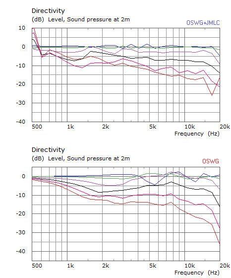

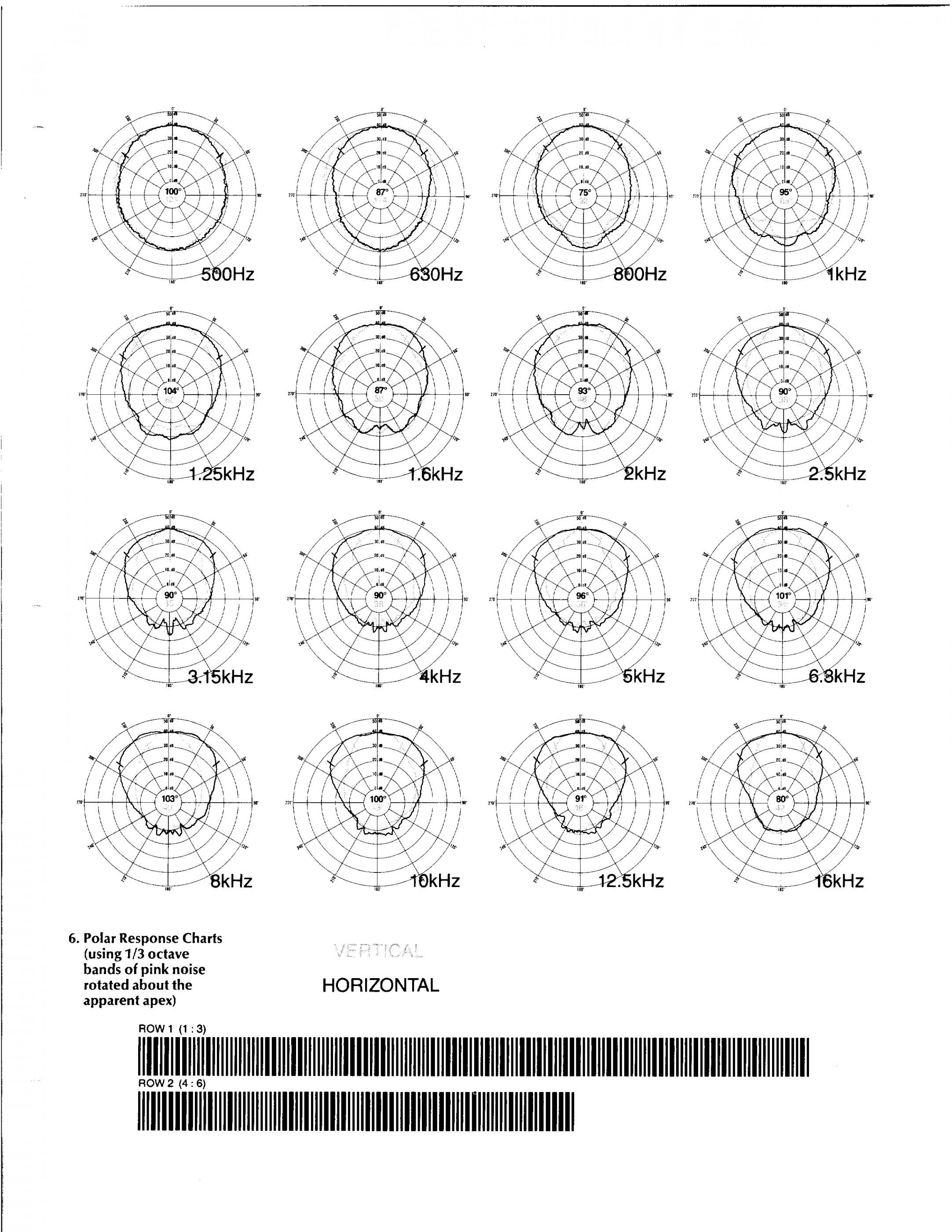

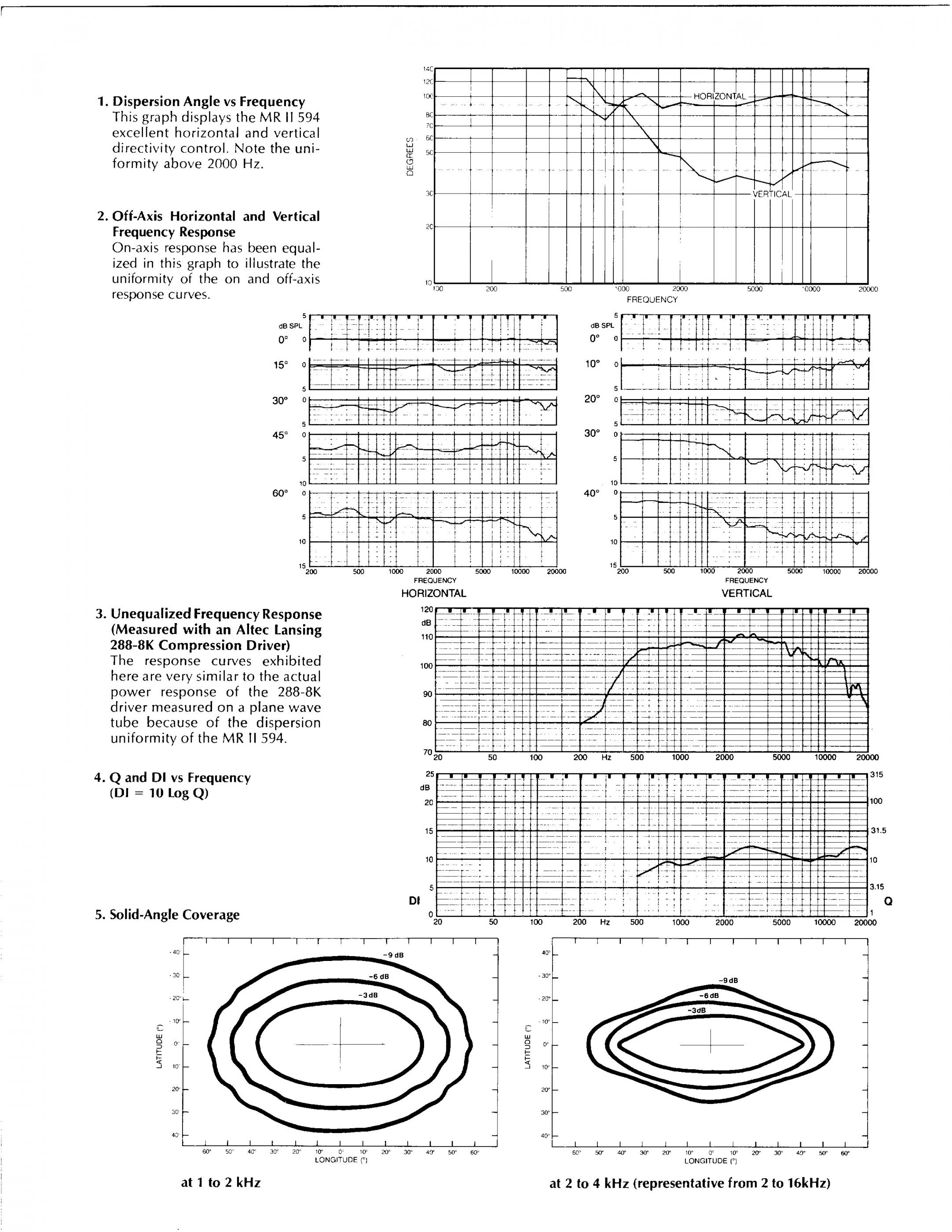

Indeed, at 500Hz the XT1464 won't load the driver very well. In a domestic application this isn't problematic, the loss of directivity control is.
Bjørn Kolbrek's latest blog entry touches on the subject.
Here is his measurements, the resistance and the reactance are out of control under 530hz... and it is a 200hz horn.
