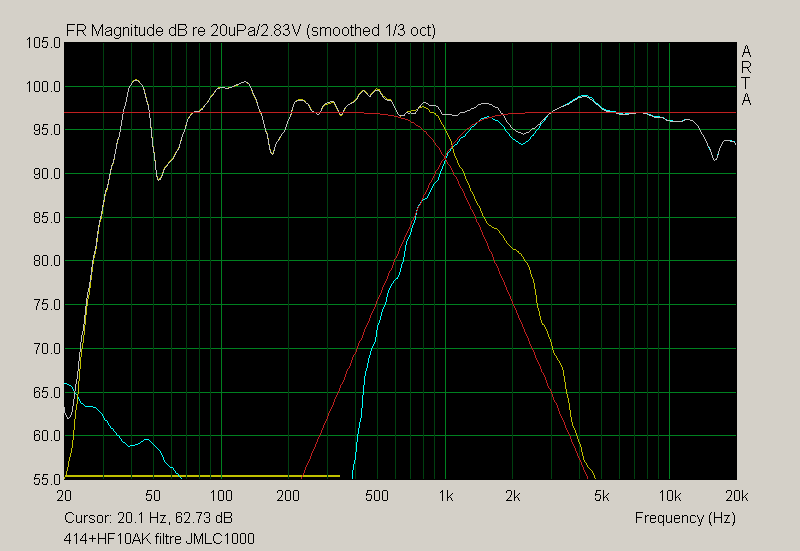

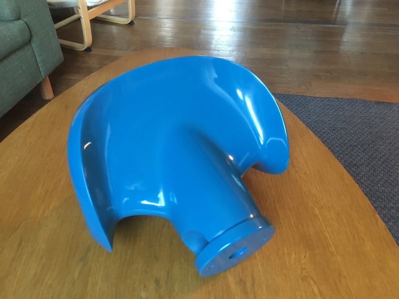

It's Bjørn Kolbrek's measurements, i've colorized the traces.Thanks for posting, is it your own plot?
It seems to be a 400hz horn and should preferably used above 800hz.XT1464 a 200Hz horn?

This enlarged XT1464 measures 585 x 428 & 368mm deep, and it's a 300Hz horn:
There is a bigger XT1464 ?

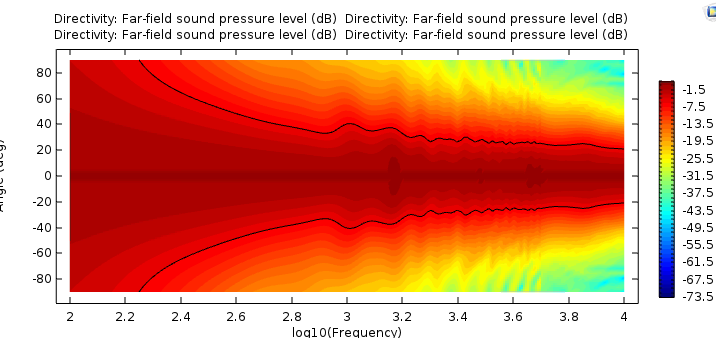

No, it was a project on another forum a few years ago.
The XT1464 was cloned, enlarged, slightly modified and optimized in Comsol.
Intended for use with 2" exit BMS Coaxial(s).
Some French folks have even crossed the HF10AK at 750Hz, which seems pushing the limit.

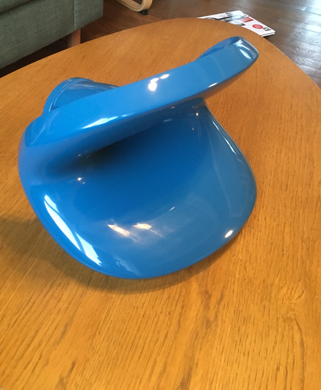

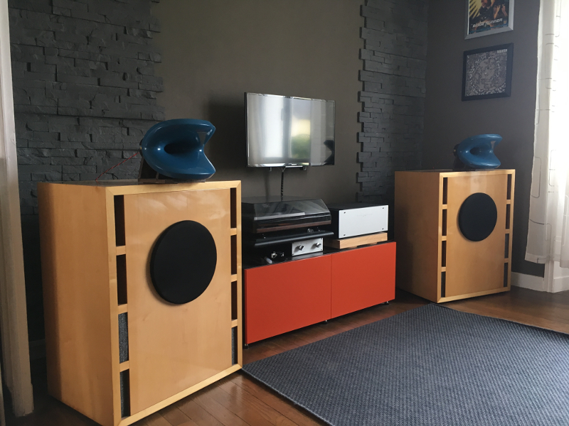

Here's a more sensible solution of a guy who replaced his Altec comp. drivers with HF10AKs, because he wanted to improve the top octave.
Crossover is 1000Hz (passive).
Cab is a Petite Onken and the little blue horn is an Audio Pavillon MA600.

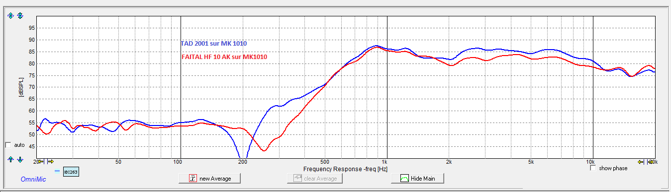

Comparison between HF10AK and TAD TD-2001 on a Markus Klug MK1010 (small multicel) and RCF H3709 (semi Altec/WE 32 clone).
5dB increments, but still...

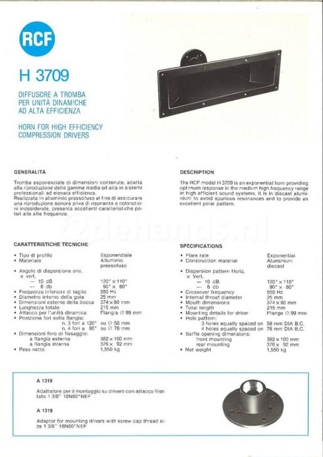

For those who aren't familiar with the RCF H3709:

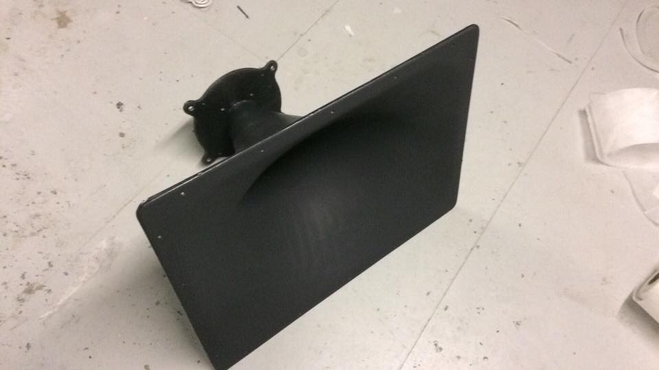

So, they have designed a 50°x 60° horn... only to break the symmetry ?That makes more sense.
