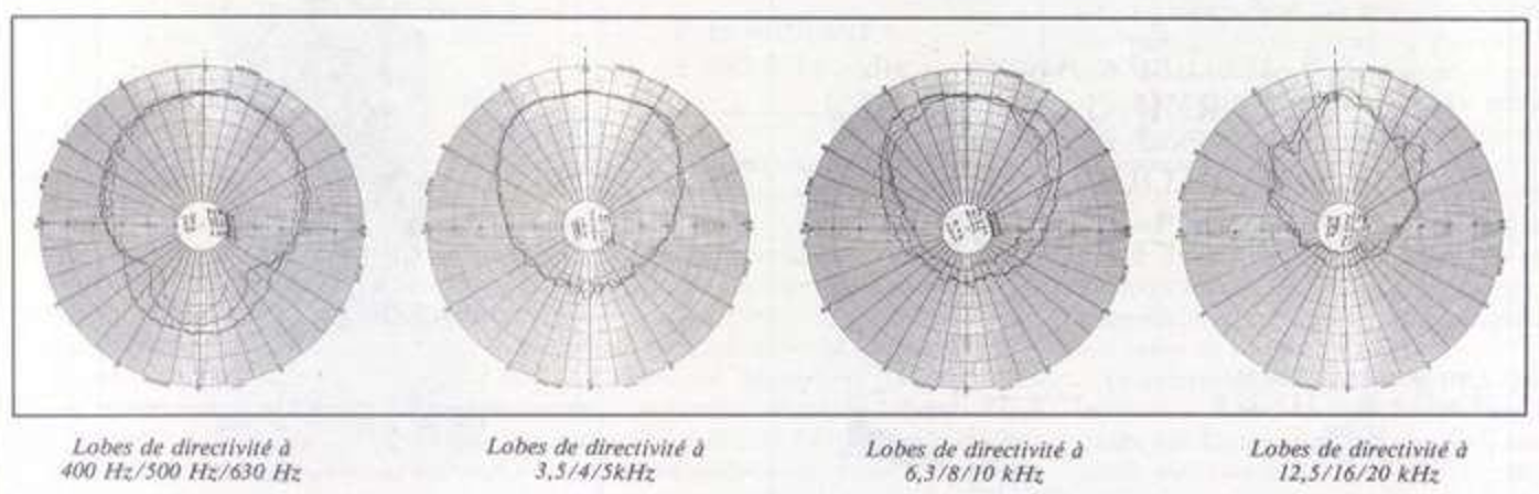

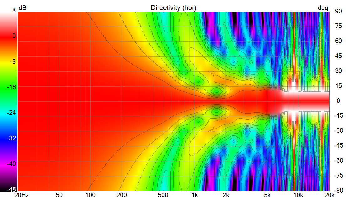

The problem with the horizontal polar chart in post #13635 is the drastically narrowing off-axis response from 100 to 1kHz caused by the side by side 15" drivers won't match the off axis response of your high frequency horn at any frequency within that range.Looking at the above chart, Comb Filtering does not appear to be a problem to me, Until about 500hz?
A single driver won't have that problem.

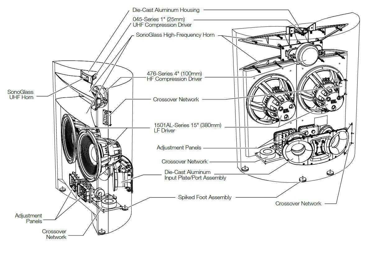

One strategy to avoid that is to only use both woofers in the low end where needed. Have only one reach the midrange horn.The problem with the horizontal polar chart in post #13635 is the drastically narrowing off-axis response from 100 to 1kHz caused by the side by side 15" drivers won't match the off axis response of your high frequency horn at any frequency within that range.

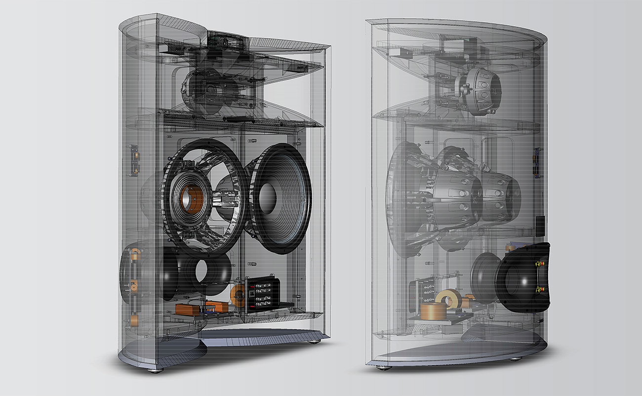

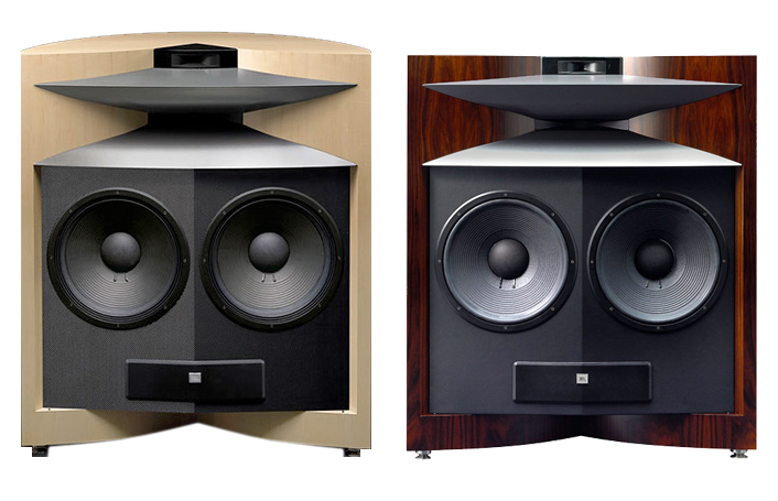

One product is the JBL Everest which has two woofers but allows only one to run up to match the midrange horn. https://www.jbl.com/floorstanding/DD67000RW-.html
My guess is they use fairly low Qts in a relative large sealed enclosure and want the low boost. They also provide a switch to control which woofer is full range.
I believe that's what the Augspurger doesOne strategy to avoid that is to only use both woofers in the low end where needed. Have only one reach the midrange horn.

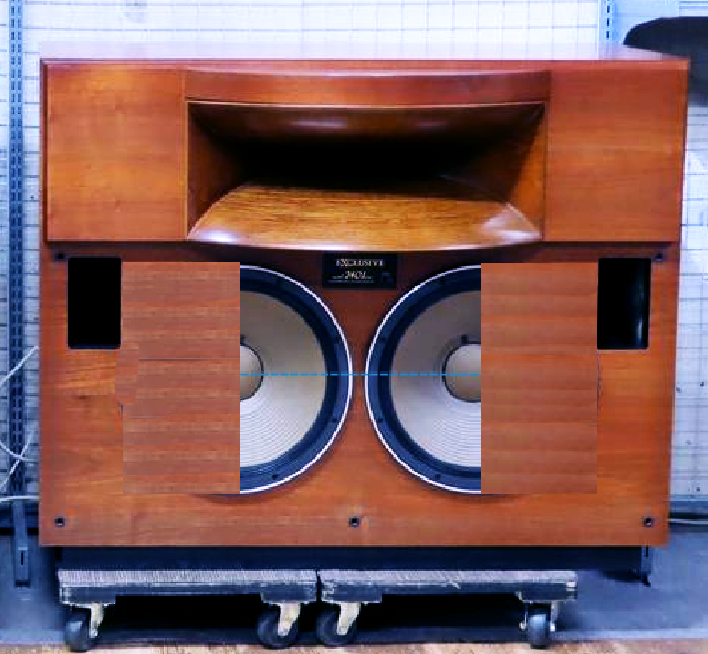

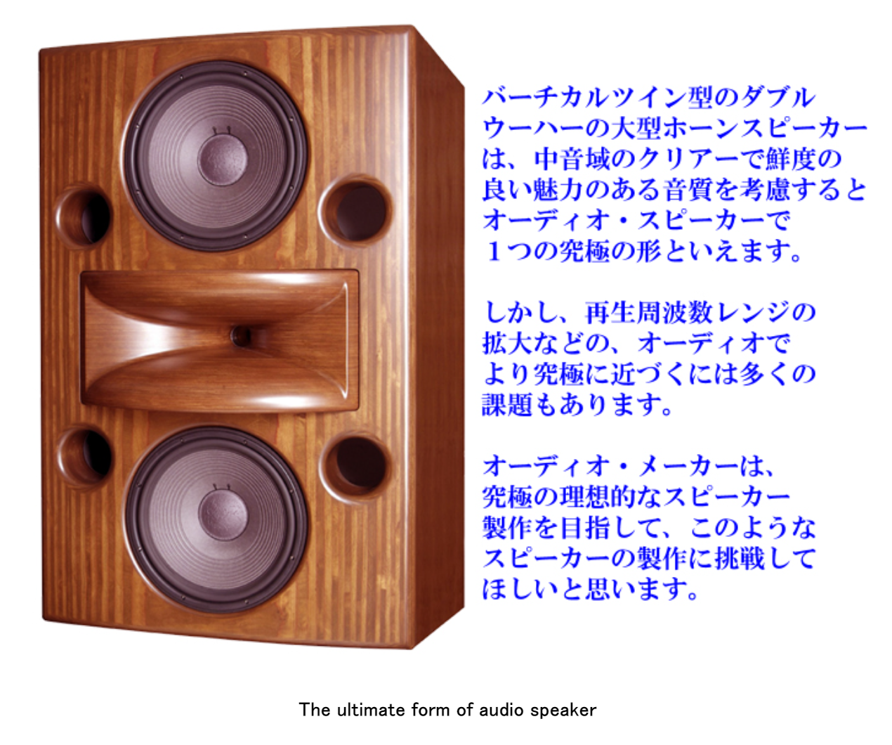

An excerpt from one of the more prominent Japanese audio blogs on dual woofer systems:
Horizontally mounted twin woofer system (JBL Everest DD66000/67000)
This speaker is extremely luxuriously constructed, using a large horn for the mid-high range and two large woofers at the bottom for the low range.
With speakers this large, the sound reproduced is powerful and amazing, something that is hard to get at home.
The sound quality is also excellent, with the clear, fresh mid- and high-range tones that are unique to a large horn and powerful bass that resonates through your body. Because it is driven by two large woofers (double woofers), the balance ends up with more bass.
This speaker's large horn provides good/powerful coverage of the mid- and high-range frequencies, so even if there is excessive bass, the sound does not become muddy due to being overwhelmed by the mid- and high-range frequencies.
Exceptional double woofer system
A vertical twin type large horn speaker is a speaker that has one large woofer above and one large woofer below the mid-to-high range (horn).
Even with a vertical twin woofer system, the sounds reproduced from the two woofers can be bassy, but because the sound axes are aligned, the bass is not diffused excessively to the side and the large rectangular horn for mid- and high-range frequencies effectively suppresses this excessive bass.
To be precise, the mid-to-high range reproduced by a large horn has a higher density of sound due to the directionality of the horn, and this density of the mid-to-high range can effectively cover up the overlapping bass sounds.
If the double woofers were placed under the horn, the bass would spread too far to the sides and would not be able to be covered by the high density of the mid-to-high range reproduced from the horn, resulting in even more excessive bass.
Although this large vertical double woofer horn speaker is the best method among double woofer types, it has the disadvantage that it requires a lot of material and is therefore a very expensive speaker.
It could be said to be the ultimate form of a horn speaker, or even the ultimate form of a speaker.
A possible objection is that the most ideal speaker for audio reproduction has a flat response from ultra-low to ultra-high frequencies.
However, even a well-made horn speaker will have distorted frequency characteristics because sound will be reflected at the opening of the horn.
Because of this disturbance, it is not possible to create a flat response horn speaker.
In other words, no matter how well designed a horn speaker is, it is impossible to achieve the ideal flat response with high fidelity reproduction, and compromises must be made with some degree of distortion in the frequency response.
However, even though horn speakers cannot reproduce flat frequency characteristics, there are many attractive aspects of the sound they produce.
The appeal of horn speakers is the freshness of their mid-range sound. The fresh, clear sound of the mid-range of horn speakers is hard to obtain with other speakers.
Vertical twin woofer type horn speakers are the most well-balanced of all horn speakers, and if built well, you can expect the best sound quality.

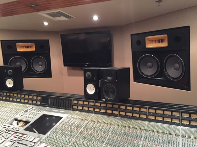

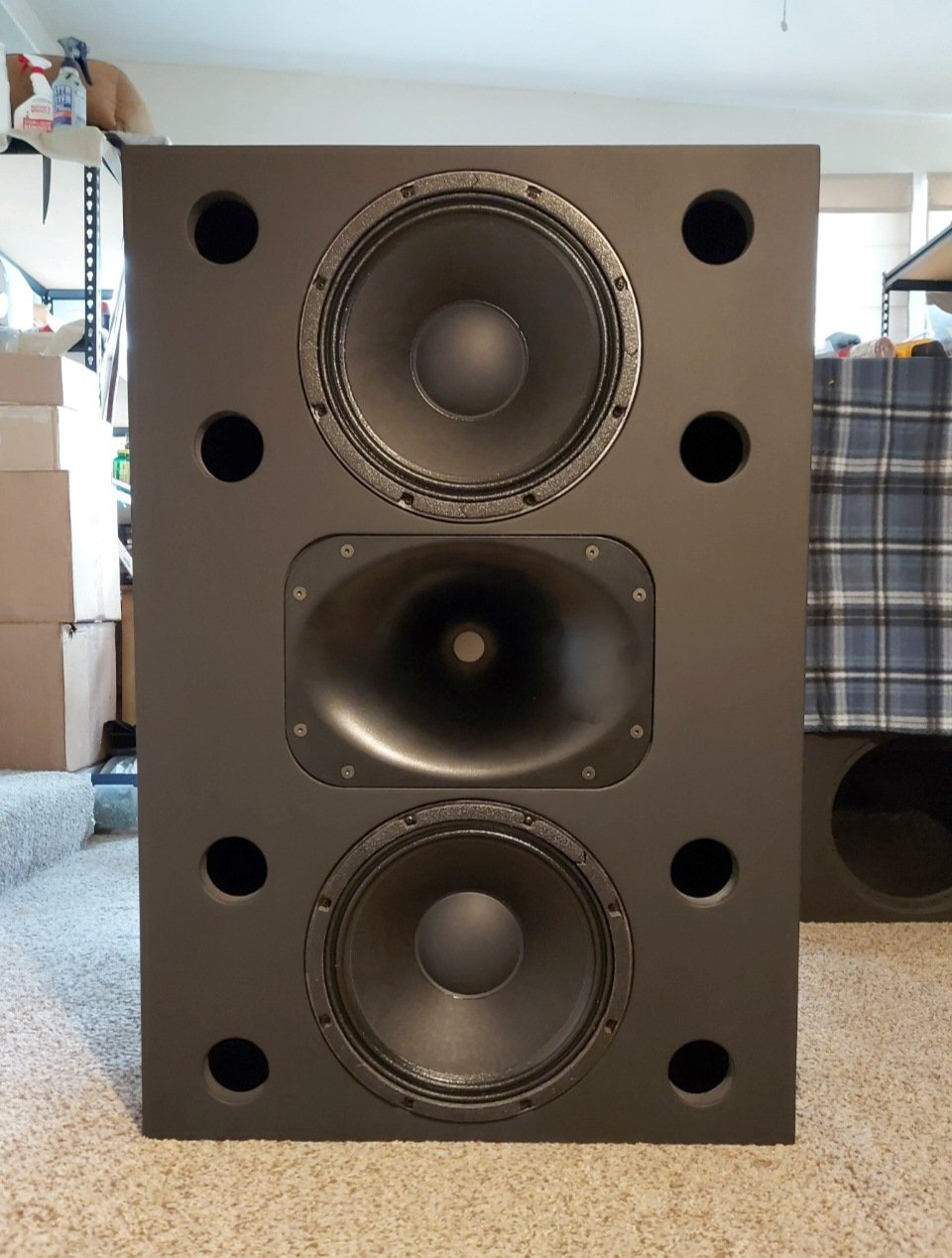

Probably the most interesting character I see from pretty much every model of large monitor that I've seen, is that no one is using a sealed cabinet.
In my mind I know why people have favor for these 15" side by side woofer multi ways. If those people think they like that, try two 18's paired together.
So I am entertaining two 15's side by side with a 15" slot down the middle, to widen the horizontal pattern. Problem is, I have no way to simulate this to see how comb filtering plays out.

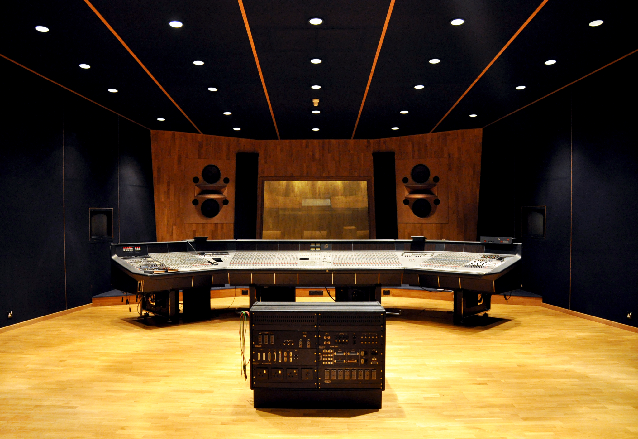

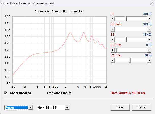

pretty sure they do this in some pa line arrays but I can't remember why I think it's to reduce the center to center distance between cabs .

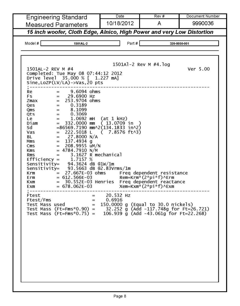

These high sensitivity LF drivers don't get low in a sealed cabinet.
