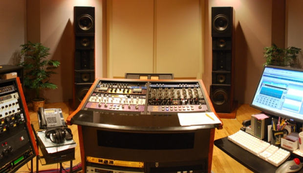

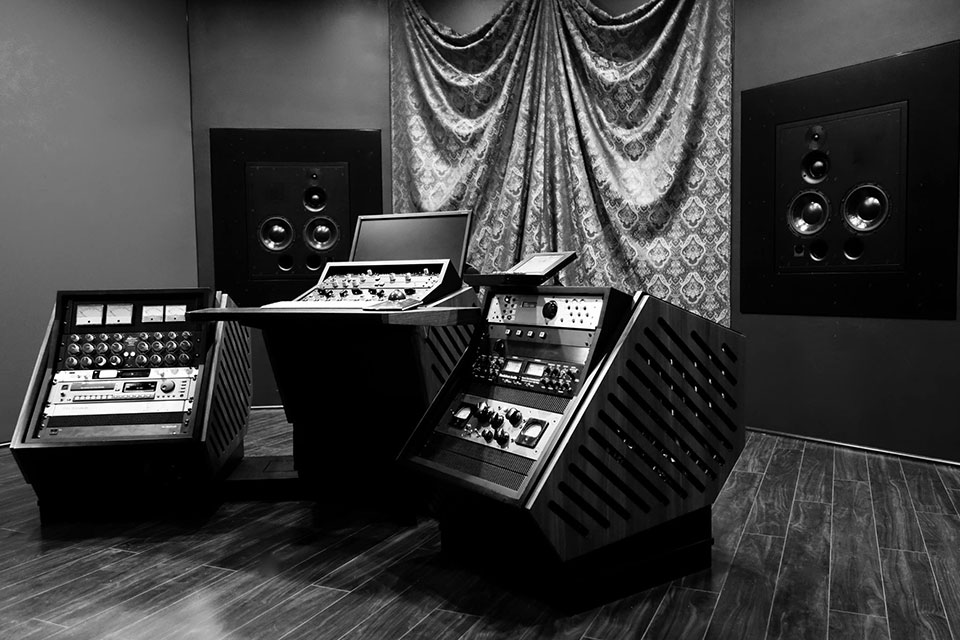

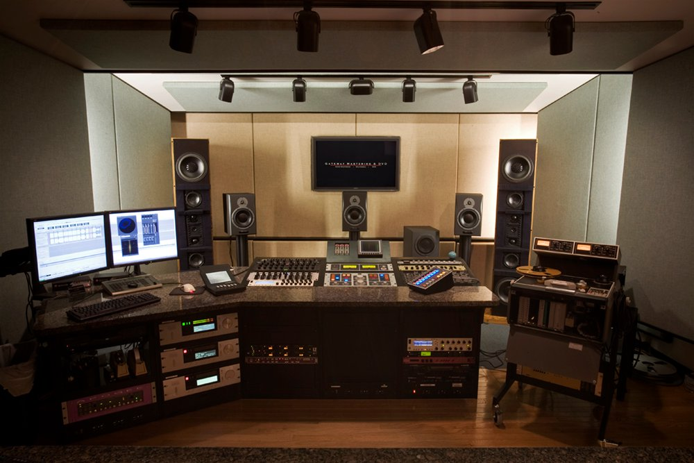

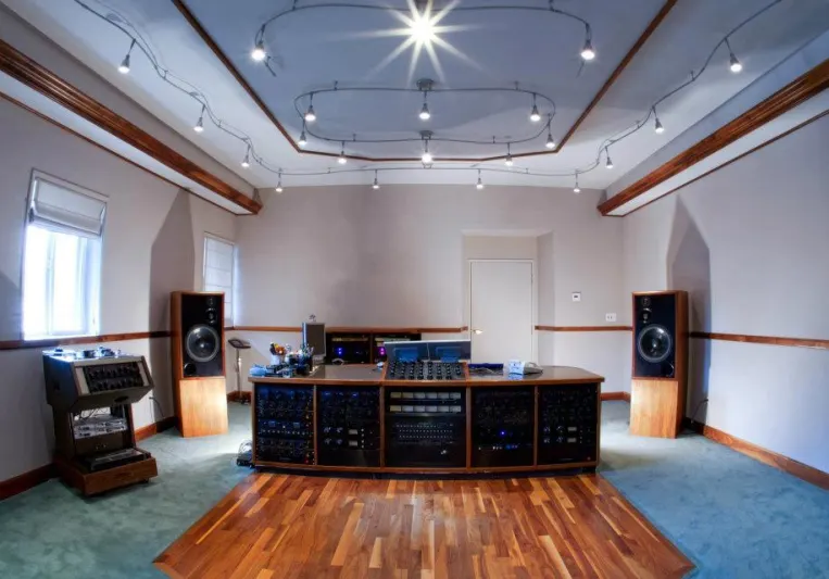

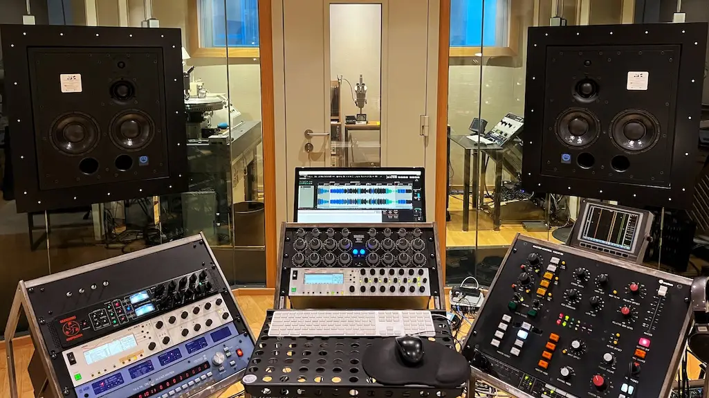

@IamJF The mains in half the pictures of first group are 2 ways. The first group is popular studios in NY, The second group is Popular Mastering studios in the US. Flagship model 2 ways probably out number 3 ways. The 2 ways in these pics probably cost more than most of the multiway shown. Yet in the studio environment you almost always will have a sub section.
Can a 2way cover everything? Yes, but its not the majority.

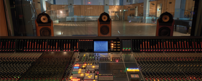

Ähm ... you looked at the photos? There are subwoofers -> 3way.
Mixing:
1) subwoofer
2) you can't see the subwoofers 🤓
3) black grill next to speaker? Not sure.
4) They listen just to a bass driver?
5) subwoofer
6) 4-way
7) 3-way
8) 3-way
9) 3-way
Mastering ... similar but less horn speakers.

So you mean the main question, as in the thread title. A large two way at 1 meter can do it to probably about 30hz. Not everyone needs to stay linear to 120db down to 20hz.
Build those MTM with high performing 15/18 inch woofers and tune it low, at 1 meter, should do the trick. Multiple subs are a desirable thing.

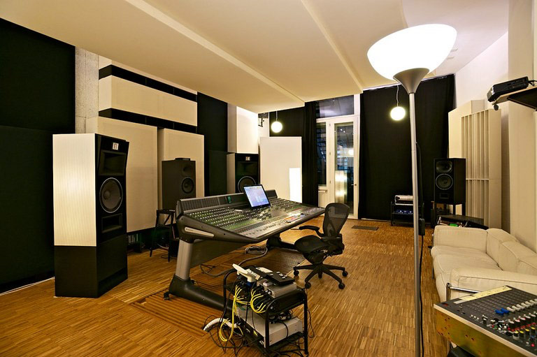

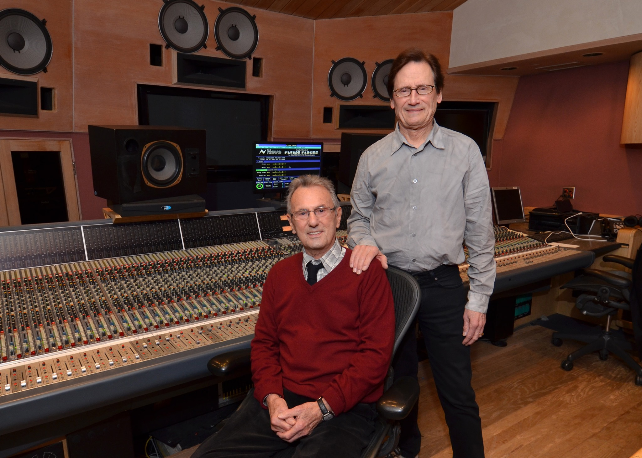

I have once been to the studio in the last picture. Back then they did also have 18" TAD drivers as dedicated subs that were mounted into the walls. But the two-way Strauss monitors that you can see would definitley suffice for most applications. The sound was authoritative and effortless BTW.

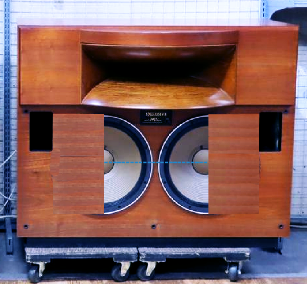

is this acceptable in order to widen the horizontal polar and help stop comb filtering? The picture demonstrates about 15" slot. The width of the slot could be even smaller, like 7-8".

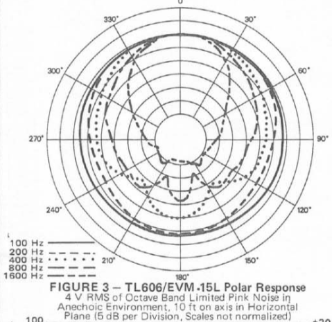

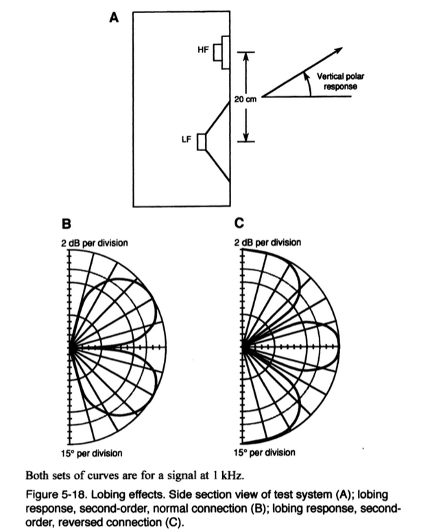

Lobing is the directivity from a large source, comb filtering is the combining of two sources with a delay.I thought that lobing was a part of comb filtering.
No, the panels have not changed the horizontal center to center distance between the two 15", and the cavity formed by covering over half the cone will cause additional bandpass peaks and dips.is this acceptable in order to widen the horizontal polar and help stop comb filtering?
Whether the source is large or small, a "lobe" is a visual representation of an acoustical level that varies with frequency and listening angle.Lobing is the directivity from a large source..
The directivity of a single source has different looking "lobes" depending on the frequency:
As Tom Danley wrote:comb filtering is the combining of two sources with a delay.
"With the case of two acoustic sources, the addition and cancellation is a function of position in space and so when one makes a polar plot of intensity, one sees a pattern of lobes and nulls, the lobes being where the signals add and nulls being regions of cancellation. This pattern of cancellation and addition is also called an interference pattern. If you play pink noise through this system and move around, you hear a swishy swishy sound, classic comb filtering."
The off axis lobes and nulls seen in a polar plot of two sources are the visual representation of the interference pattern, when viewed on a frequency response chart look like the teeth of comb, hence the name.
Art
I suppose I could see that coming across a little ambiguous. Subjective similarities aside, lobing is a polar pattern and polar patterns are plotted at one frequency showing level against angle.
Comb filtering is pressure taken at a single location against frequency.
These terms have wide application and have been used in antenna theory and general electronics.

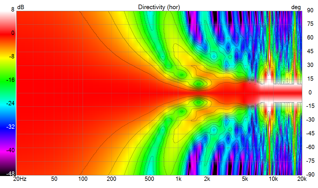

Seems like this model never gets any bad press/critique? It has issues with comb filtering on the horizontal, beaming from the horizontal pair isn't helping the polar to match the horn or maybe it is, Never came across any off axis measurements for this model. The woofers are simple enough to sim in VituixCad but I wonder what the real measurements look like.
Off axis similar to the simulation. While these speakers for sure sound impressive there is probably a reason why there are no off axis measurements 🤓The woofers are simple enough to sim in VituixCad but I wonder what the real measurements look like.

830cm2 woofers separated by roughly 1"
Looking at the above chart, Comb Filtering does not appear to be a problem to me, Until about 500hz? I would have to investigate further, the issue of peaks/dips issue. Theres a chance that most of those issue will be on the outside of my desired passband.No, the panels have not changed the horizontal center to center distance between the two 15", and the cavity formed by covering over half the cone will cause additional bandpass peaks and dips.
Each concept has its own disadvantages/limitations.I guess one could argue that unless both midrange sources are identical for mids of an MTM, it would be a step away from accuracy. One could argue the same message towards 2.5way or 2 way MTM, or even a 3 way since the same is true for any drivers in crossband or redundancy. I have enough variables already so it would seem as I need not complicate things with a unique never seen before MTM lol.

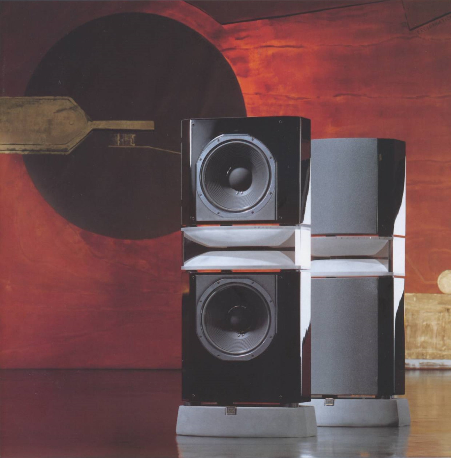

Given your drivers and horn, a MTM - in accordance with theoretical optima - is feasible.
If the GT-Sound MTM is considered one of the best speakers (in Asia), then the concept should at least 'work'.
