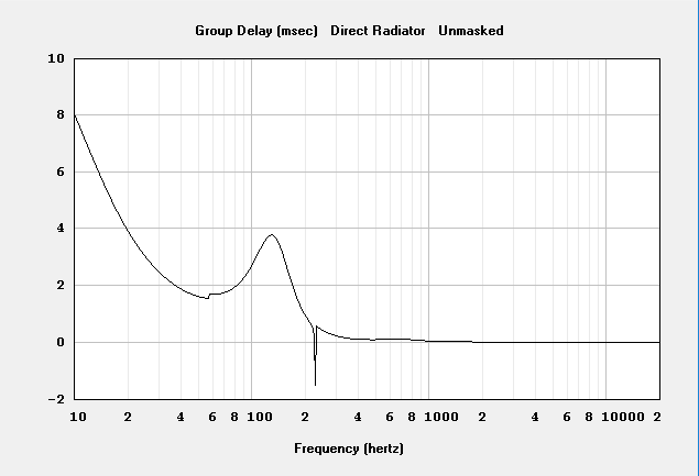

Raising BL lowers GD in the LF as well, strengthens Qes, thus increasing damping but no loss in LF efficiency. Consequence of increased filter? Thats a consequence?

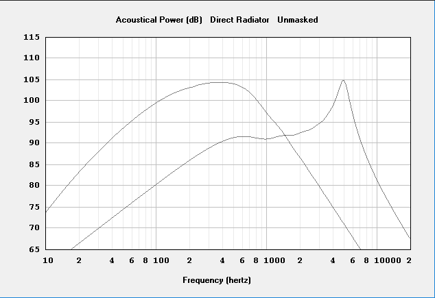

27BL above vs 270BL below
Le will change the start up transient performance but the effects are not as drastic as some describe.
0Mh above and 10mh below.
And finally 100mh

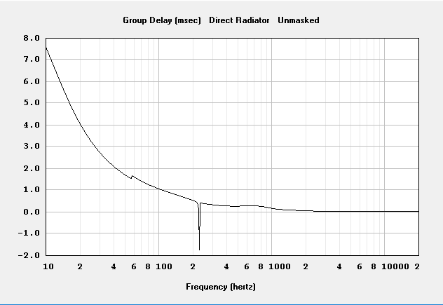

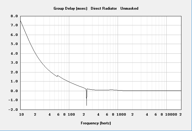

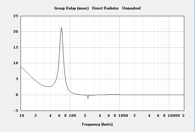

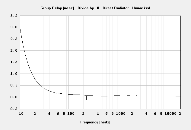

Group delay is a function of the frequency response roll-off.
So in the example of the target curve I showed before, the group delay is 100% identical.
Will also be identical between a BL of 8 vs 40.

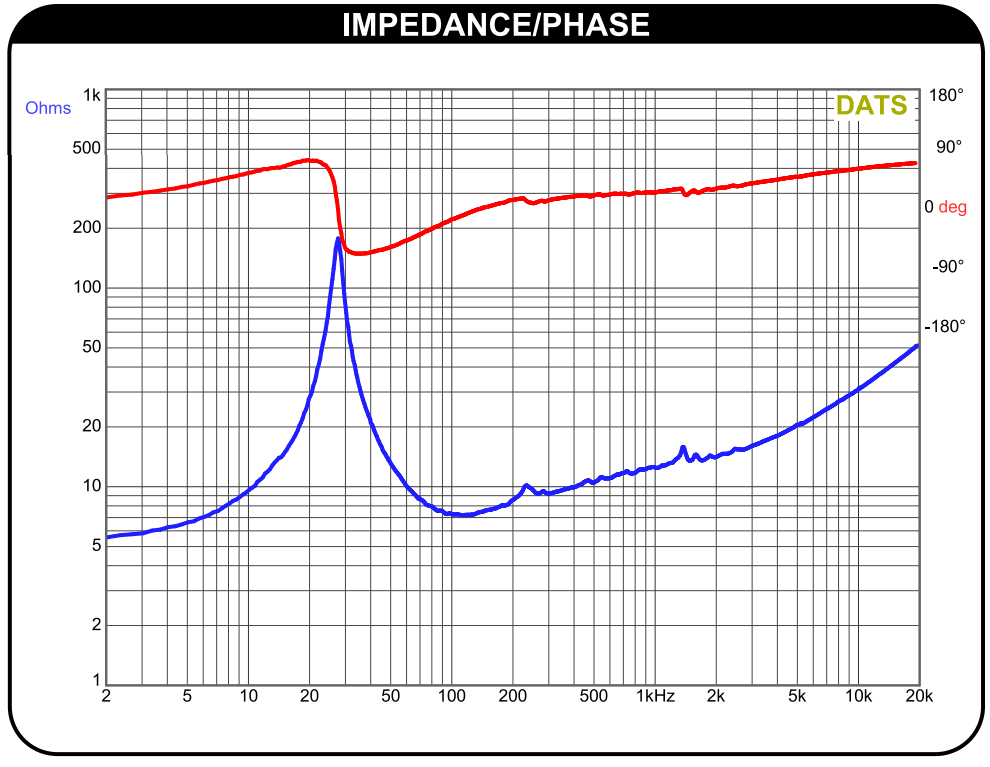

Is that for sure? It seems higher Bl (assuming same Re) creates higher and more reactive electrical impedance with broader peak around resonance. So higher Bl not reduces LF efficiency, just creates a different electrical impedance and actually increases LF efficiency.Don't know about the data, but it lowers Qt' = higher roll-off = less LF eff..
Just compare the data of 2 similar woofer, one with relative low motor force (high Qts) and one with higher motor force (lower Qts), the electrical impedance of the lower Qts driver is higher in the LF region around resonance despite the fact it have lower Re:
http://www.dibirama.altervista.org/...vox-380-2000ob-woofer-15-8-ohm-1200-wmax.html
http://www.dibirama.altervista.org/...aital-15pr400-8-woofer-15-8-ohm-800-wmax.html

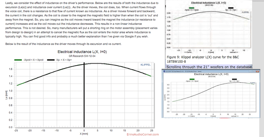

Question.... Is Le the final say or is it the impedance plot? I ask because I find woofers with low Le that have impedance rise sooner than another driver with higher Le.
This driver has an Le of 1.8mh but yet impedance rise is not bad, crossing 20ohms at 5k... Scrolling through the 21" woofers on the database, a 21" with le lower than 1 is not a thing... How does Le and Diameter play together?
Le – Voice coil inductance, in millihenries (mH), typically measured at 1 kHz for woofers. So this parameter is given by the physical properties of the coil. The real measured impledance is what matters - you can see unwanted resonances there and it interacts with passive crossover components.
Checking different diameter (membrane aera) woofers with the same voice coil and magnet construction, the larger one always have higher Le.How does Le and Diameter play together?
Le as used in specs is an approximation. In the real word the VC inductance is not a constant value but varies with frequency. There are several different models to approximate this effect. The only importance for Le IMO is in a passive crossover. For active or very LF X-overs it does not play a significant part.Is Le the final say or is it the impedance plot?
If it has the same motor structure, how could the LE be different?Checking different diameter (membrane aera) woofers with the same voice coil and magnet construction, the larger one always have higher Le.
I think that I agree with you, but the verbiage around here is so loose that it's hard to tell what is being claimed. People use "efficiency" when they mean "sensitivity", and visa-versa, and may not even know the difference.Is that for sure? It seems higher Bl (assuming same Re) creates higher and more reactive electrical impedance with broader peak around resonance. So higher Bl not reduces LF efficiency, just creates a different electrical impedance and actually increases LF efficiency.
Okay, I'm not sure about that the same motor but larger cone leads to higher Le, probably was a too early call.If it has the same motor structure, how could the LE be different?
I agree, this can be misinterpreted. To clarify, in my view the efficiency is dB/W and the dB/V is the sensitivity (aka Voltage sensitivity).I think that I agree with you, but the verbiage around here is so loose that it's hard to tell what is being claimed. People use "efficiency" when they mean "sensitivity", and visa-versa, and may not even know the difference.
And as well as Le varying with frequency, it also varies with position of the voice coil, not much for "better" drivers.Le as used in specs is an approximation. In the real word the VC inductance is not a constant value but varies with frequency. The only importance for Le IMO is in a passive crossover. For active or very LF X-overs it does not play a significant part.
Klippel measurements of the SI HT18 at Xmax show the Le going from around 1.9mH coil in to over 4mH coil out.
