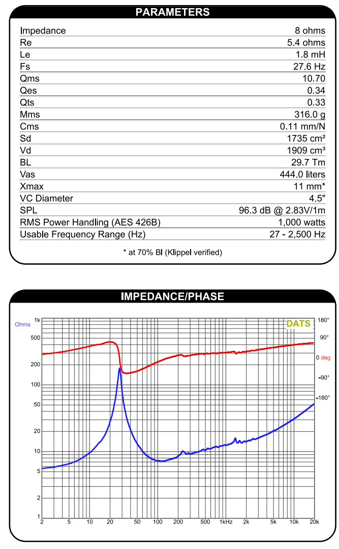

Yes, I paid careful attention to Le linearity in my woofers because I tended to take them higher than what most people would.And as well as Le varying with frequency, it also varies with position of the voice coil, not much for "better" drivers.
As you show, B&C do this well.
The 12" has an Le of 1.35mH, the 15" 1.4mH, the 18" 1.48mH.Anyway, here are a positive example for the claim. Exactly the same motors but different cones sizes:
The difference in the proximity of the coil to the aluminum frames could account for that little change.
There is over 900 gram difference between the frame weights.
I measured a nominal 2 mH air core inductor & former (180 grams) at 1.95 mH.
Placed on top a 60 gram 40 cm long aluminum angle, the coil read 1.87 mH.
Carbon fiber, if used in the larger cones, might also affect the inductance.
At any rate, the materials surrounding the magnetic structure and coil do have an effect on inductance.

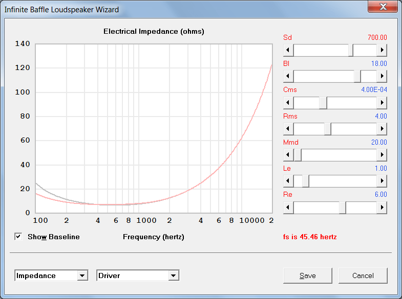

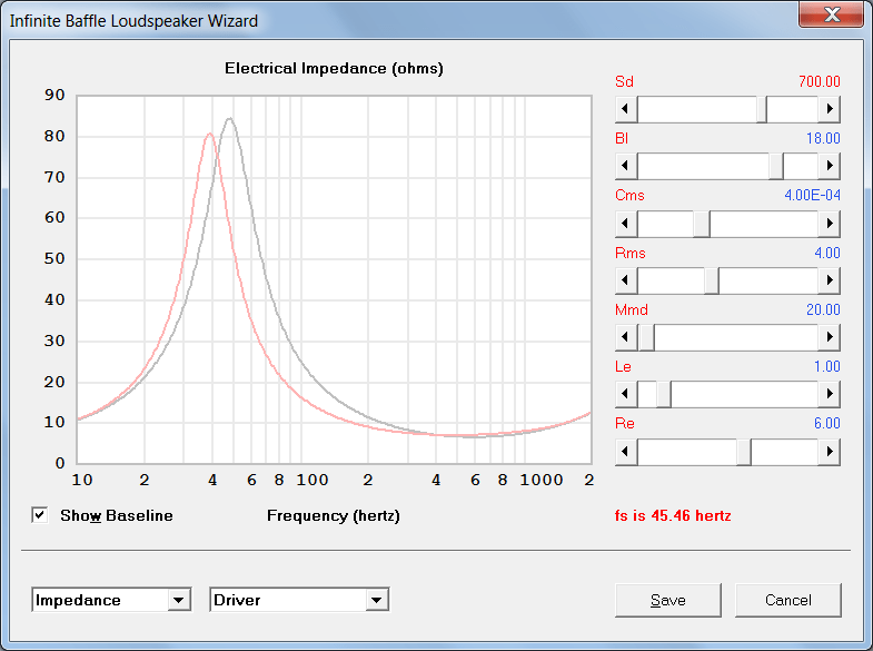

I'm bringing the woofer just up to 200hz. is it there a connection between impedance rise and sd? Sd will lower acoustical impedance and in turn... something else? I know that Le is electrical, but maybe the increase in Sd has an effect.
what if potentially due to Increased Sd changes the driver's coupling to air, potentially affecting the back EMF and thus impedance curve?
The vent tuning and damping material and other acoustical events manipulate the impedance response, the acoustical event difference between Sd's probably have type of influence.
The above response is particular good for being marked le1.8mh...
Sd doubled...
Electrical input impedance unaffected at high frequencies, assuming pistonic behaviour.

Sd only effects Mms slightly, thus lowering Fs a little.what if potentially due to Increased Sd changes the driver's coupling to air, potentially affecting the back EMF and thus impedance curve?

In theory no.is it there a connection between impedance rise and sd?
In practice it's tight on such a way that the type of voice coil and the way it's being wound can change the Mms.
Since you also want to optimize that with the diameter and application of the woofer, it will change.
But obviously that's just the practicality of it. There is no direct relationship.
With plenty of demodulation, you can make the impedance practically flat.
It only doesn't add much for subwoofer applications, but that's a different story.
Actually, this isn't even true in theory only in practice.Sd only effects Mms slightly, thus lowering Fs a little.
In theory we only care about a moving mass, not how this mass is composed.
Incorrect. The larger Sd changes the acoustical mass loading on the diaphragm, but since this air mass is a small fraction of the cone mass it's effect is small.Actually, this isn't even true in theory only in practice.
That is what I meant, I just worded it on a weird way. 😀Incorrect. The larger Sd changes the acoustical mass loading on the diaphragm, but since this air mass is a small fraction of the cone mass it's effect is small.
What I meant was that there is only mass from the moving parts as a whole + the mass of the air.
So the Sd only says something about the air mass, but nothing about the other part of the mass.
