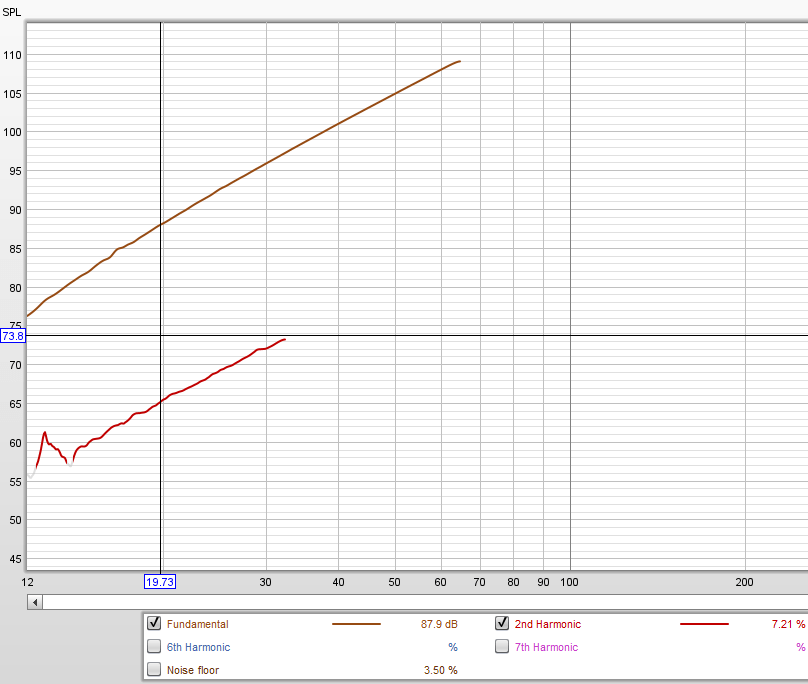

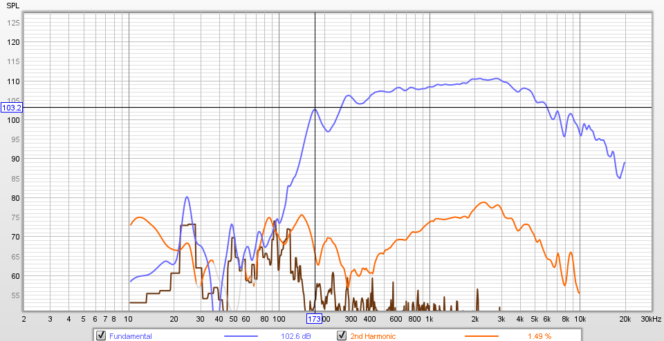

The idea was to be as close as possible to the diagram to pick up on any distortion hinting at xmax. The closer the the 2 points, the more accurate the information. I think because of the situation, pulling the mic away will allow enough intimacy and lower peak.Whether reading peak or RMS, a compression driver driven near full power can reach in the 160dBSPL range at the throat, but there is no reason to measure at the throat, or "several inches" from the throat- measuring inside a horn is not representative of what you (or your mic) will hear at a listening position.
These measurements of THD

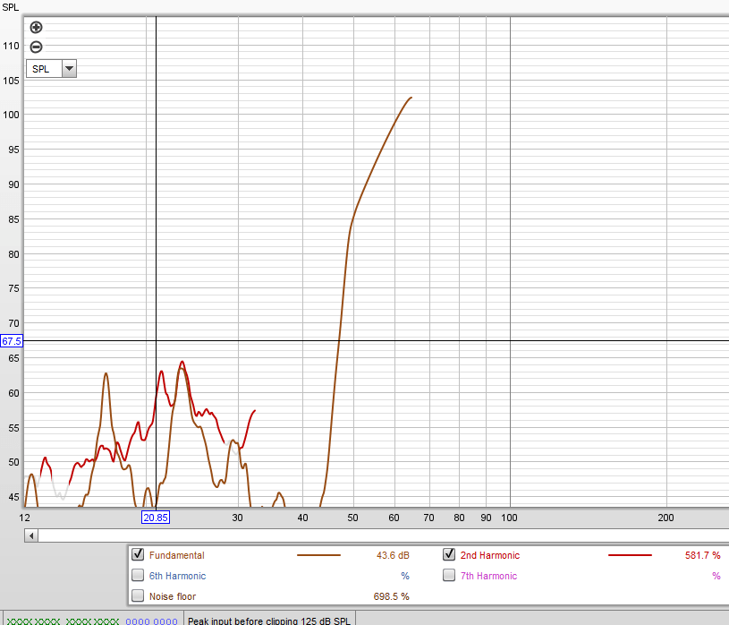

Are not correct. Raising the slope steepness of a XO point shouldn't make THD go up. I must assume that the noise floor or ambient noise is too high to get an accurate reading, no one has suggested anything on the topic.

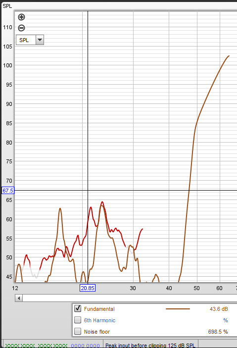

Ok I think I got the bottom of it. I have Rew set to measure 10-80hz.... the sweep goes well past 80hz, to ~155hz......it is hear that headroom is gone, and it should be.... but why is Rew wanting to sweep past the measurement criteria???

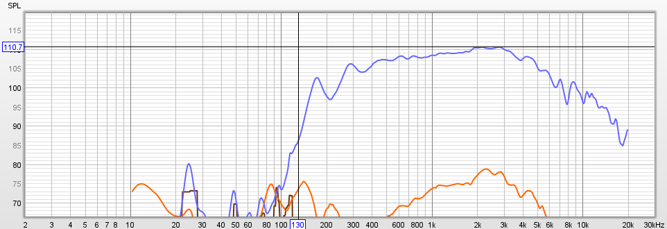

The purpose of putting the microphone on the drivers exit, was to monitor for distortion, signaling potential damaging conditions, not for voicing. Considering that thd will increase with mic distance, increasing distance doesn't seem to be the direction to go in for said task is what I am saying. Moving the microphone farther doesn't increase excursion so how does this help me if I'm trying to monitor thd for said reason???
When you say "less accurate" what is the context? Are you saying that the microphone used on a horn in the nearfield is erroneous.... as in, if I put my ears at the same distance, my ears wont hear according to what the microphone is picking up at the same distance, considering the horns are going to be used in the nearfield???
For example
This appears to be the conditions I could say, suggest, nearing xmax. So as long as I never increase spl above those levels, I should not fear suspension strain. Even though this measurement is taken in the throat.... This part of the spectrum is playing well below the actual intended passband spl, so thus, why concern what the thd is when measured at listening distance.....I am just trying to ensure I don't ruin the diaphragm and suspension......
How is measuring the horn at 90inches away going to facilitate that?????
I am also just now realizing I should pay attention to the to the noise floor reading. As you can see here
both measurements have the same XO point... the 2nd measurement has a steeper slope..... Moving the microphone farther away actually makes the measurements less accurate for the this part of the spectrum, due to the noise floor.
Hopefully you see now, why I thought to place the mic on the exit. Moving the microphone farther away will only submerge the output under the noise floor causing inaccurate readings.

As @gedlee suggested, I found the root of the issue of loosing headroom. It was due to Rews functionality to past the measurement criteria....I tell it to measure from 10-80hz.....it doesn't cut the signal off at 80hz. Not sure why it does that, or how to stop it.

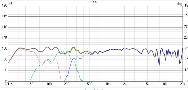

How did you measure the freq responses for the above sim?I am probably trying to get lower than I should, in XO point.
How are people getting down to 300hz XO with such small horns and I got this giant *** horn but I can't do 200hz

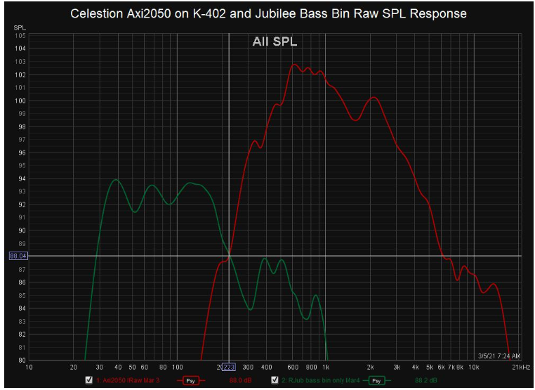

View attachment 1066816....I think someone is fibbing or at least taking sacrifice to SQ. 400hz XO on the Strauss with such tiny horn.
This is what I would call, "as in intended" at this point...putting the XO at ~330hz/....The polar information is not accurate BTW.

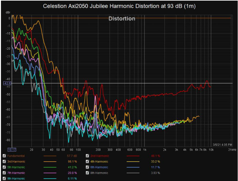

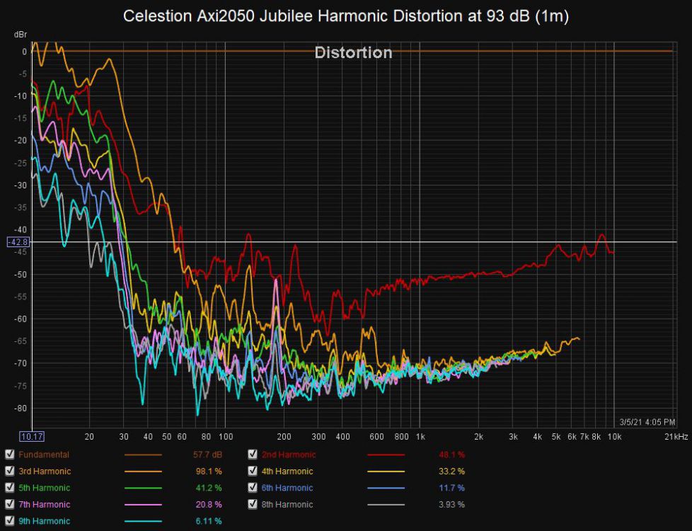

Here’s the distortion for the Axi2050 crossed at 250Hz @93dB:

Within inches for the woofers...and out doors pointed at the sky at 1m, no XO...about 1watt.

The mea above shows a 2nd order distortion (dominant) at about 0.7% at 1m at around 225ish Hz and 5k w the driver crossed below your intended x/o at 93 dB.
This is pretty much as good as it gets for a compression driver.
You will have to apply the appropriate PEQ:s for your application and measure at least 1m for this kind of horn for the numbers to be meaningful imo. You’re just killing that mike right now.

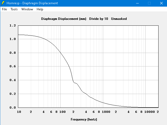

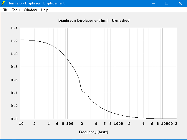

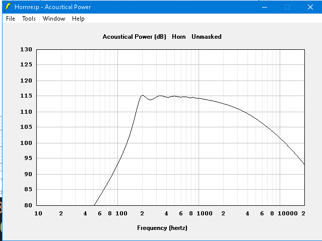

Above are the simulations for a 100hz tractrix and a 350hz tractrix at 115db....notice the excursion slope is very similar. So if I wanted to run either of these two horns without a XO I would run into similar issue reaching 115db....just within different frequencies due to where the cutoff is. I say this is due to diaphragm size.
So yeah this is the easy way out. Being that the filter knee can be placed -15db and lower in the cutoff of the horn, the pairing driver dominates, and you get no rise in GD.Ok, my dumb answer is increase filter slope's steepness and call it a day.
Lets say that the sim is accurate for excursion of a my actual diagram. According to the above, I can Highpass at 83hz if using a Butterworth 2nd order xo
The 100hz or 350hz will then be able to play without a "tradition" XO...to 115db, above cutoff.... no issues of distorting transients. Because Xmax is 0.8mm..........

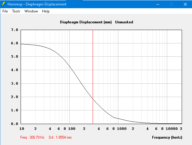

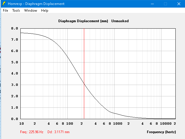

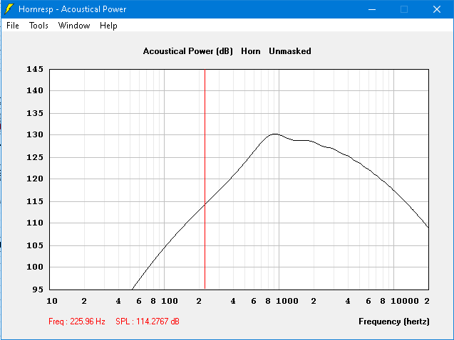

150hz tractrix in HR
No XO, 115db....driver is hitting xlim
No XO, 93db....driver is well within optimal.

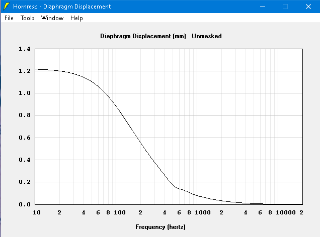

2nd order LR at 225hz, 115db.
This horn only has boost till about 500-600hz....
Supposed voicing, in red....
20-30db headroom needed..... 115db is benchmark for some.

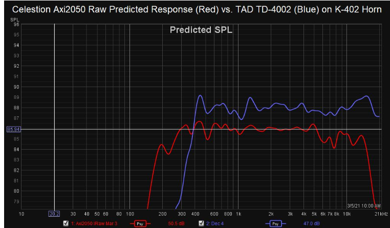

500hz tractrix with my Axi sim. 225hz at 114db
Impossibly high excursion requirement
Nor can it reach 300hz at 115db
The K-402 is basically a to part conical horn, the second portion following more of a tractrix expansion, it's response dropping at only 6dB per octave from 600 to 300Hz, then around 12dB an octave below that.150hz tractrix in HR
This K-402 horn only has boost till about 500-600hz....
