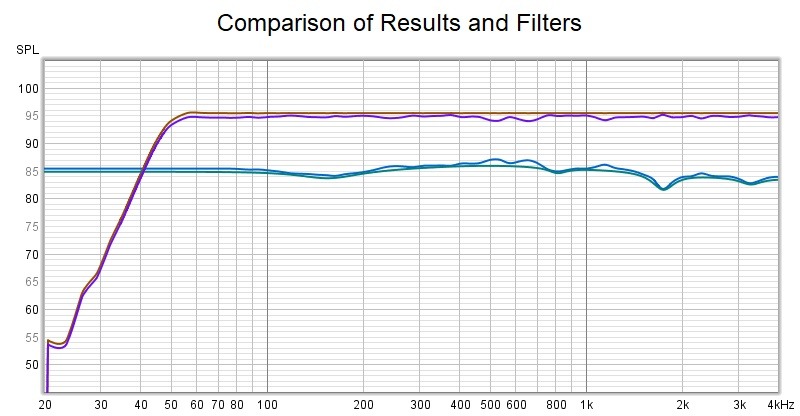

Time, patience and practice, I have spent a lot of time tweaking EQ's
Here is a comparison of a manual EQ I did by eye with a few filters vs a complete inversion

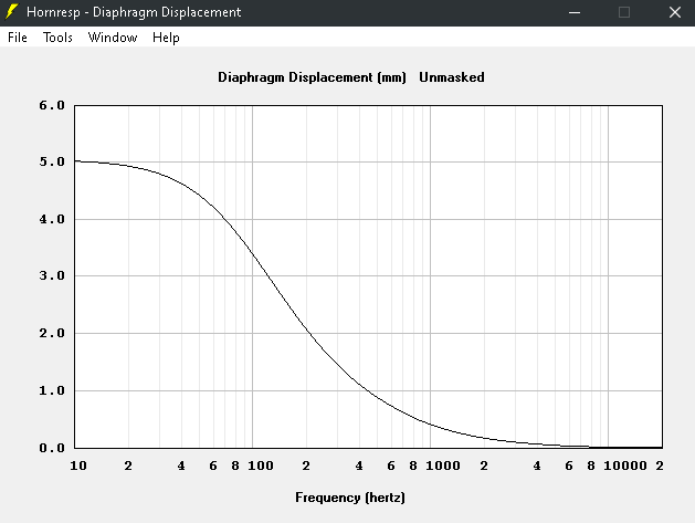

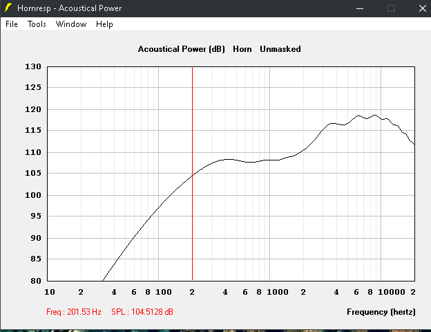

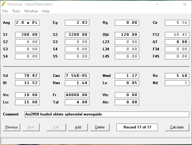

I displayed the woofer polar....I think the waveguide size should be as big as needed which in this case is sorta set my how low can the Axi play in a waveguide...Are we judging by Excursion? Should I look at my horns resp sim of the Axi and see where the xmax is reached without a horn?
The previous polar did not look quite right to me, the final choice should be made from actual measurements anywhere from 500Hz should be quite practical with the axi. The OSSE termination lets go smoothly and loses directivity gradually making it quite flexible.
If you want a totally flat DI then build a 15" version of this.
https://www.diyaudio.com/community/...-design-the-practical-way.354772/post-6214298
That would be the best way to judge the waveguide and 15 together in a box designed to complement them.
I have bmc0's code and can make you a ruler flat DI OS with his termination for a baffle. All of this takes time though so you need to make your mind up what you want.
