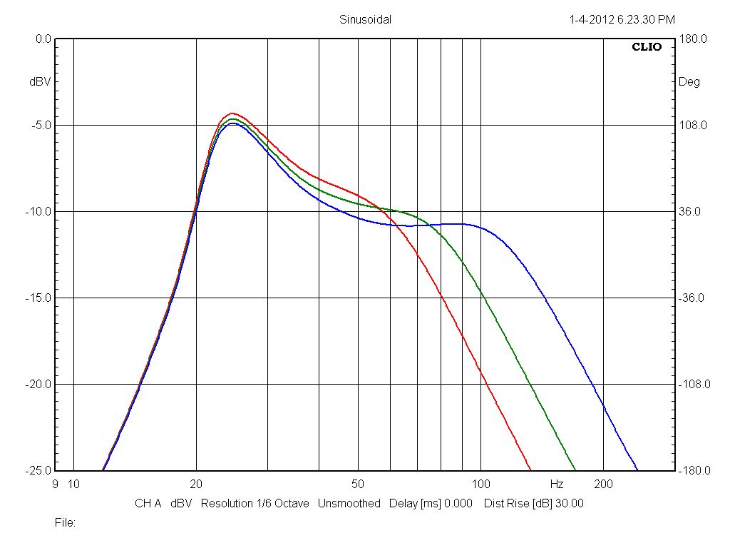

We are using the woofer under it's in-box impedance peak, meaning is it is acting like a Linkwitz Transform. Basically the low pass at 21 Hz is compensating

I am not concerned about the group delay added by the bump filter below 30Hz. I don't see that as an issue. If I was adding group delay above 500 Hz or in excess of the BL curve I would be concerned. How audible will the group delay added be under actual use in a real room with standard program material?? I am not worried.
Your gain structure should be predicable and quite manageable not trying to reinvent the wheel. If making GD a paramount concern in your design have at it. I think there are much bigger fish to fry.
We seem to think differently which is fine and make opposite choices which can lead to good discussions. Since this is an active system you can dial it in using both methods. Try both see what you like.

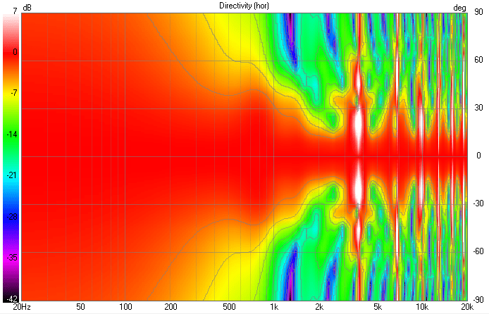

So this is my VituixCad, If I start designing a waveguide. Would I want it to be as wide as the width of the enclosure....or would I just match the size of the woofer and have it on a baffle as wide as the enclosure. I could ask in Mabats thread but I don't want muddy up his thread with "hey can you please tell me what waveguide to build", as he normally has some really good discussion going geared towards the leading of waveguides. Maybe I am being too polite. At one point in time a person actually had an Axi2050 they were trying to design a waveguide towards....I wonder what came of it....
This will be one of several efforts into fostering a conversation on the topic.
What Waveguide does the forum think is the proper selection for my application. This is me letting go of any ideas of a certain XO point.

I'm thinking that group delay, using the method you are now, would be higher than using a low shelf filter. With low shelf filter, you probably need less gain in the filter which would lower the group delay.
A 15" on top of a PPSL-dual 18's is a version of the best one could do in the amount of space it takes up... below a horn/waveguide/synergy. At least I got that part right.
I would look to as big a waveguide as you can live with. Then pick a coverage angle, I'd go round - it's the easiest and works the best from what I have seen. With throat size and angle (readily known) you have all you need to build a magnificent source for 60-70% of the sound that you hear. From the waveguide design found at Mabats thread "something"360 (don't remember), or simply put as OS with a gradual flare to the baffle. Measure or sim this. Now match that with the next driver down, your mids, with both filter summation and polar angle - this will occur at only one frequency (most likely) and that becomes dictated as the crossover point - it's not chosen at will. Fill in the bottom in the last step - done in-situ. That's my recipe. Worked every time.
IMO you are working backwards, as many do, focusing on the very low. Not very important at this stage of the game.
PM me if you really can't find a design over at ATH. I'd stay away from their current discussions, as good as they are, but they are very (b)leading edge stuff. Just ask for a design around the specs that want - coverage angle, throat size and baffle size. That fixes the design. Everything else is just fluff.
