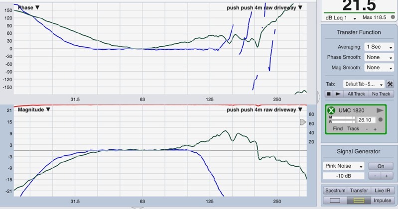

The measurement below is pretty close to intended proximity.....This is very little headroom? Theres still more headroom than this.....but This, isn't enough already!?
I'm not ignoring your point btw, the pic is just a starting point of the real life measurements using the designed filter, as you said, start with sim but move to real life measurements and adjust accordingly. I could see my system rolling off at 30hz. if I chose to roll it off at 20hz....there is plenty of headroom, because the measurement below is very low distortion for the loudness and dept of frequency, as well, practically too loud, as well, at the 20-30db peak transient area meant for listening at 80db range. 30db was the requirement I have an amount that cannot be achieved for measurement because it would break something.
Do I recall correctly? 2nd order is near 7 or 10% rounding xmax? The pic shows 20hz at 115db with 4.5% 2nd order. In what size room would I NOT have enough headroom, that is the thing to discern! For the rooms of the Average middle class house, I think its just right lol. I think I might have enough headroom to power a small home theater with all drivers in motion, thats including the surround subs that are yet to be built.
Yeah, you have plenty of headroom for a small to mid size room, but probably at lower SPL than realized once you move to a more normal listening distance (again, lower than realized if shooting for flat 20Hz response).
Hey, i'm not all that convinced THD matters so much, but i'm thrilled how clean my PPSL sounds so i'm gonna post some measurements after all...just as food for thought for where you decide to take f-3.
Here's a raw measurement outdoors, green is raw, blue is with 3 small PEQs, and a linear phase low pass at 120Hz.
Here's the distortion at almost 126! dB (+6 added to fundamental taken at 2m)
Squeaky clean loud in my book.
I have to believe your 18H+ are capable of very similar....if you ugh, lets go of 20 Hz 🙂

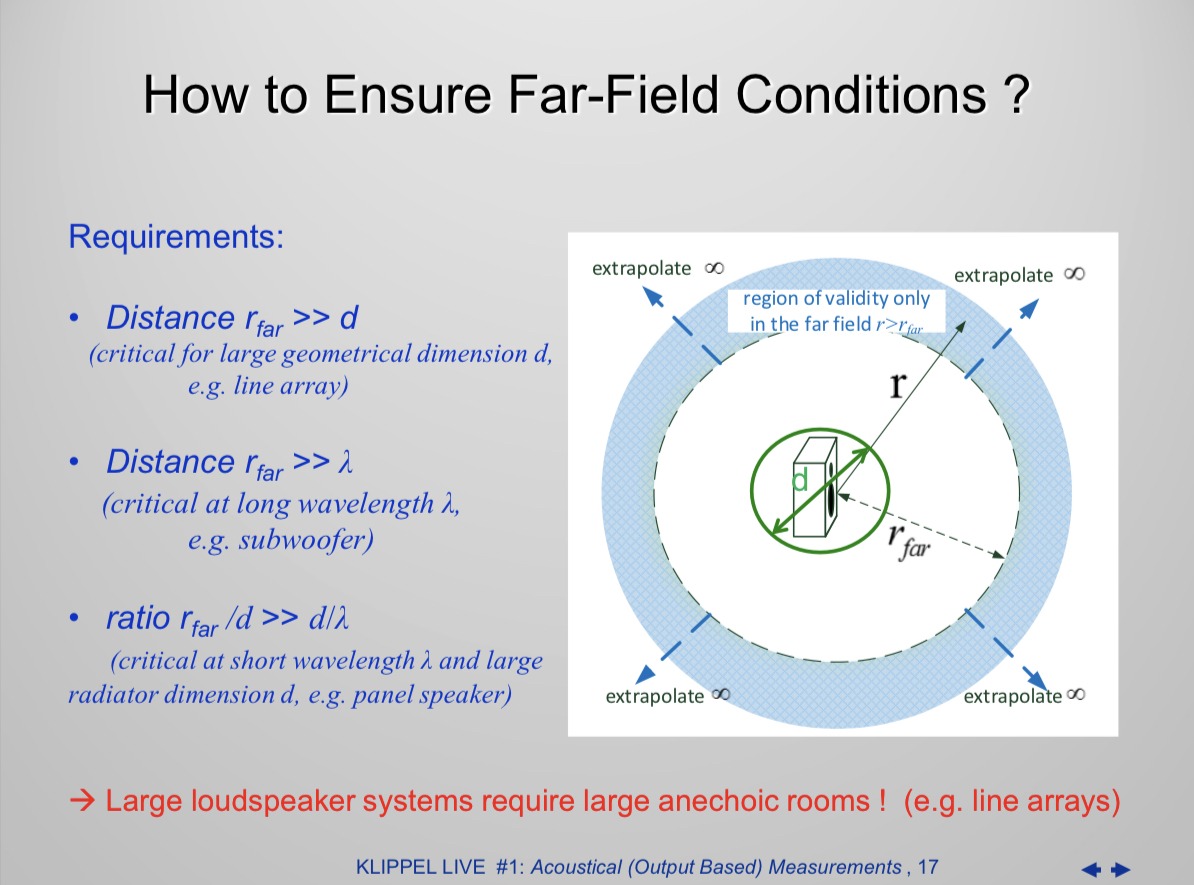

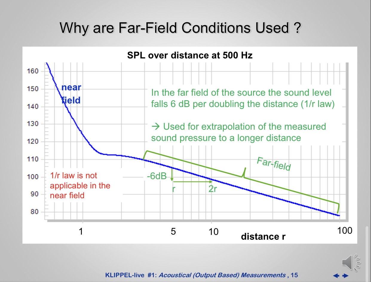

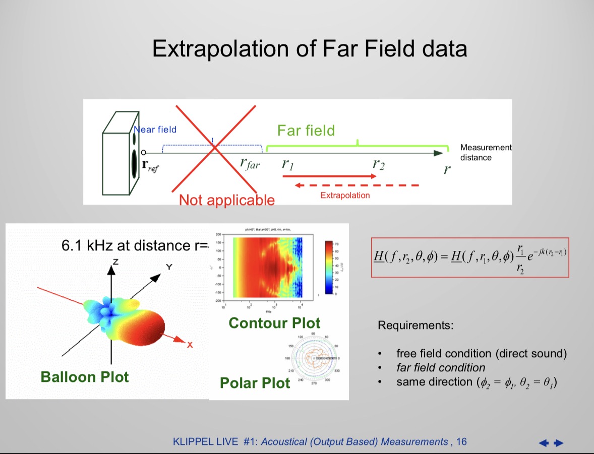

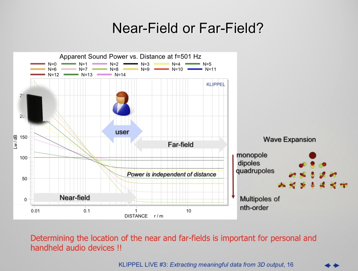

It also seems there might be some confusion about what the 'near field' is. It's a clearly defined transition to the radiated pressure falling off with a 1/r, regardless of angle. In the acoustic near field, this cannot be considered to be true. The transition is also frequency-dependent.
The direct-to-reverberant ratio is affected by the receiver distance, source size and directivity, and the room's acoustical parameters derived from the reverberation time, early decay time, and energy time curve. Likewise for the critical distance, which is the point where the direct sound and reverberant sound fields are of equal level.
Here are some relevant slides from one of the Klippel Live webinars, which can be found here:
https://www.klippel.de/know-how/education/klippel-live-web-seminars/iec-60268-21.htmlParts 1-3 are particularly relevant, with part 2 being about making useful acoustic measurements in ‘too small’ spaces
Absolutely. I've posted links to a few of the Klippel slides you put up a bunch of times, trying to help show the inverse square law / far field kick-in distance.
I think a big part of the confusion with the term "near field", is how the studio guys co-opted it to describe being within critical listening distance.
it's a shame really, the confusion between the near-field / far-field transition line (region), and the critical distance line (region)
