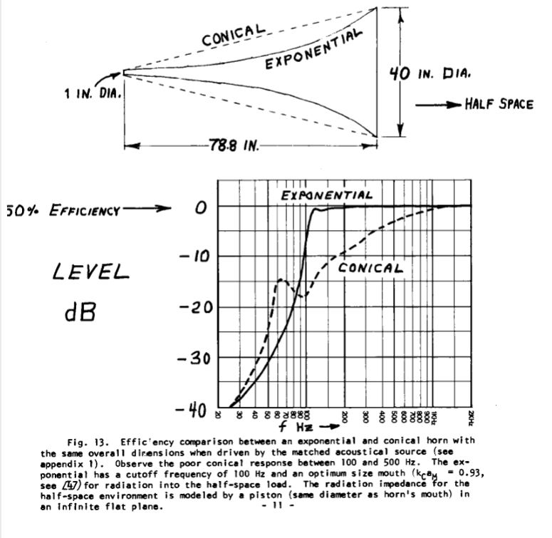

The Kolbrek/Dunker book is an excellent source.
A really good landmark paper was written by Keele:
AES Papers -- Official website of D.B.Keele
I hope that it is ok to show a screenshot out of his paper:
"What's So Sacred About Exponential Horns?," Presented at the 51st Convention of the Audio Engineering Society, Preprint No. 1038 (F-3), (May 1975).
This is why he used a combination of both profiles CE horn. In fact looking from the throat it is an EC horn but I suppose that CE looks better ;-)

There are a few definitions of "cutoff". I suspect most people use (a).
a) In filter designs, the -3dB (N=1) where attenuation begins. [DonVK - this is what I use for nearly everything (drivers, horns, filters, etc) : Cutoff frequency - Wikipedia
b) traditional horn design where throat impedance Im=Re which is also often happens around Re~0.5 so it can be considered like a cutoff where attenuation has started
c) mathematical prediction of "zero" output for an infinitely long exponential flare horn. Since this does not apply to finite horns, it has little practical use.

The origin of the term "cutoff" refers to Webster's solutions for the exponential horn where the waves go "evanescent". The problem is that this solution is wrong and evanescent waves never occur in accurately analyzed horns. That makes the term "cutoff", defined this way, ill-defined as it describes something that never happens.
Thus, it is perfectly reasonable to define a new definition and I have no problem with the definition where Im = Re - it's as good as any other. The key here is that this definition is a parameter of only the horn, not the system. When you try and use a definition based on SPL then things fall apart, because this definition depends now on both the waveguide and the driver (as Marcel so correctly points out.) Only Re = Im is a workable definition.
