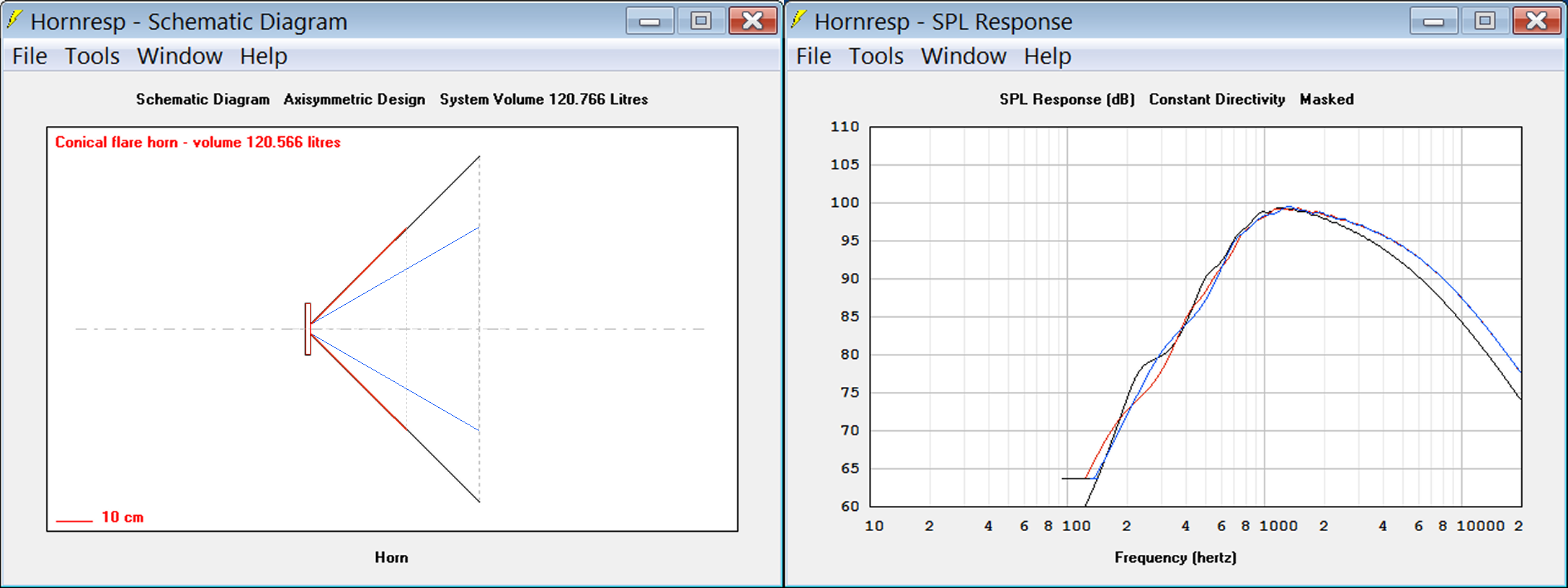

There are a few definitions of "cutoff". I suspect most people use (a).
a) In filter designs, the -3dB (N=1) where attenuation begins. [DonVK - this is what I use for nearly everything (drivers, horns, filters, etc) : Cutoff frequency - Wikipedia
b) traditional horn design where throat impedance Im=Re which is also often happens around Re~0.5 so it can be considered like a cutoff where attenuation has started
c) mathematical prediction of "zero" output for an infinitely long exponential flare horn. Since this does not apply to finite horns, it has little practical use.
Attenuation of what? SPL? That would make no sense, that's why I'm asking because I can't think of any other measurable quantity that would "start to attenuate". Never mind.
Then why does the same driver show different SPL curves (and attenuation) on different horns ?
Because the horns are different 🙄
It simply makes no sense to use the "SPL knee" as an attribute of a horn (i.e. to call it a horn cutoff), because in general it will be different with different drivers. Of course, nothing prevents you from using something that makes no sense, that's up to you. It's only good to make it clear.
Obviously definitions A or B are relevant, all that needs clarifying is whats just been said, regarding the differences.
A is more of a system cutoff, horn+driver system
B is more technically pointing directly at the horn

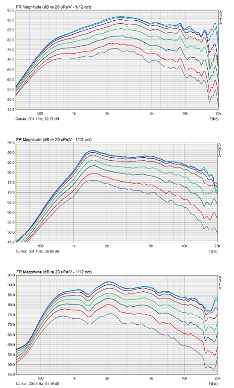

These are three different 1" drivers on the same waveguide. So what is the cutoff of the waveguide?
LF Slopes are different, but from the average peak I would say the horns are all starting to attentuate ~1KHz+/-100Hz and then more even attenuation lower down from the driver(s).
