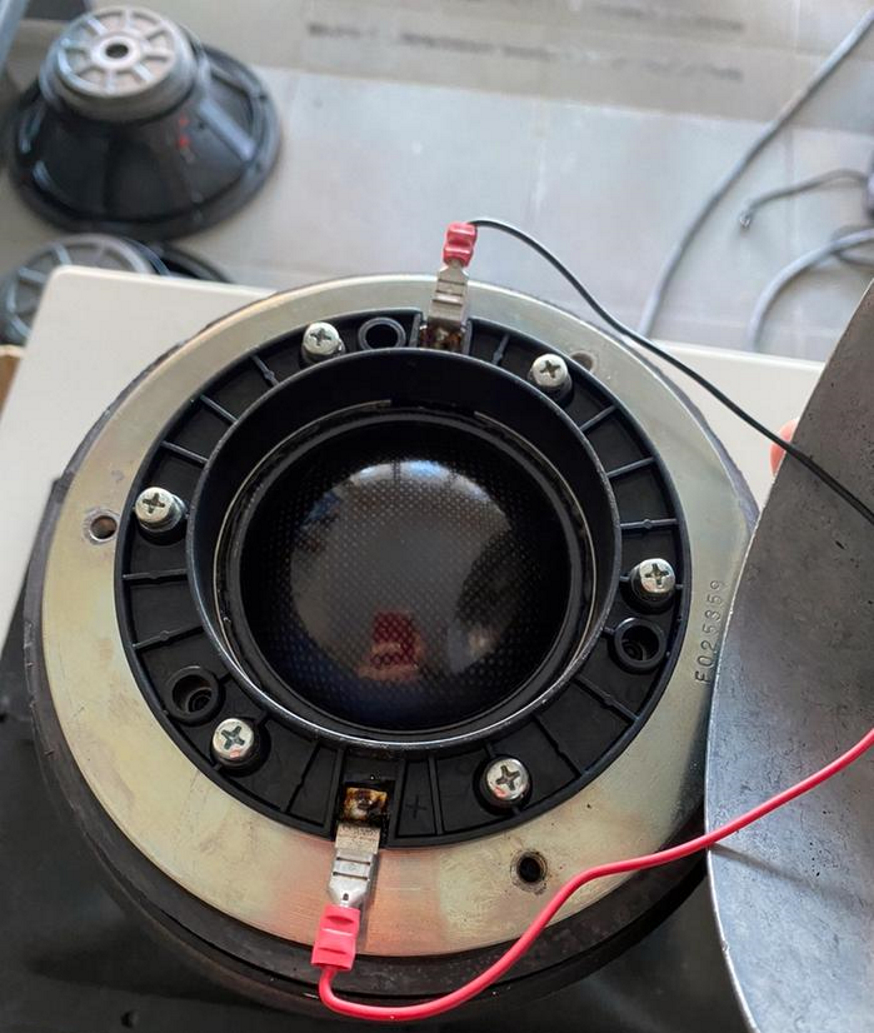

In your shoes, I'd measure the space between the top of the diaphragm (dome) and rear cup Then (using hot wire) cut a round piece of 30 ppi foam that's just slightly thicker (1-2 mm) than said space and stick it onto the cup. This may significantly reduce the breakup resonances.
Thanks for your suggestion. I examined the additional resonance with the aluminum dome and considered it acceptable, in it's range.
I did read an article about modifying a rear cup with foam. I have a link or copy of it.
If I get to this point, I will probably upgrade to a Be diaphragm first. And, for LCR only. I will do that before considering modification, or a custom waveguide.
I figure that Radian knows more about their compression drivers than I do. If Radian did this modification, or sanctioned it, it would be a plus.
Perhaps Radian will introduce a carbon fiber option for the dome. That would interest me too.
I will keep this idea, and a few others, in mind for future reference.

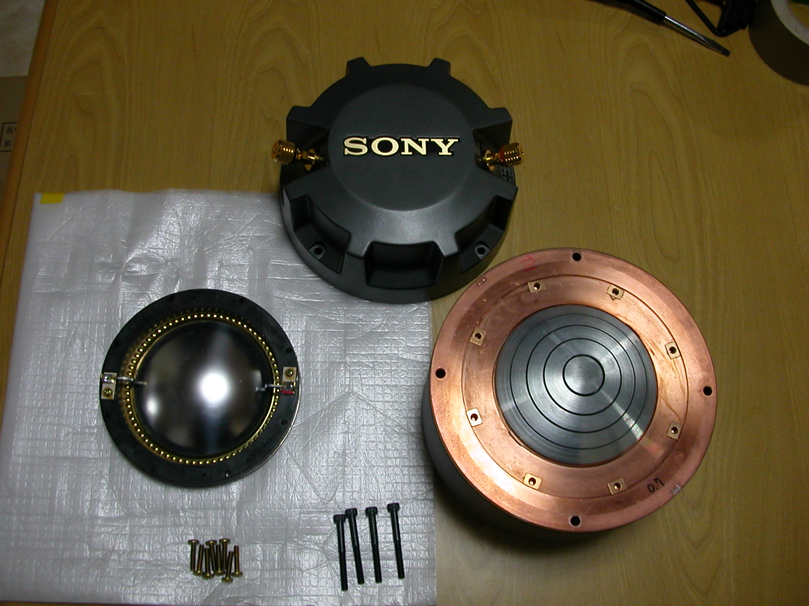

Breakup resonances of 4" metal diaphragms are really hard to surpress/dampen.
Sony did an excellent job with SUP-T11 > video.
Beryllium is the obvious alternative, but apart from the price and poisonous nature, I think it's 'too good' in terms of speed of sound through the material.
Because of this, the mids/highs tend to sound hyper-realistic and separate from the paper cones below, which can get tiresome in the long run.
Carbon fiber was first used in the RCF N980 > video.

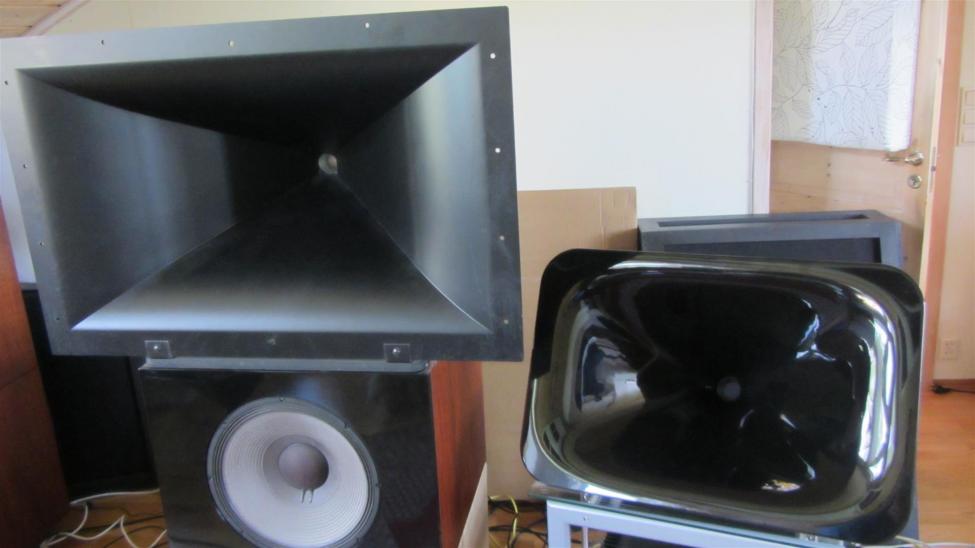

I like that. Does it come in black, 1.4" entrance, not too expensive? Data?
Is that really a 200HZ, 31cm horn? 12.2"? Seems kind of small.
Edit - Is that 31cm front to back depth?

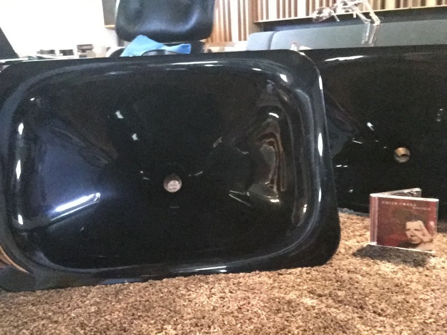

Oh you mean the Seos I posted? Its not a horn, its a wave guide. Calling it a Seos horn is a misnomer
