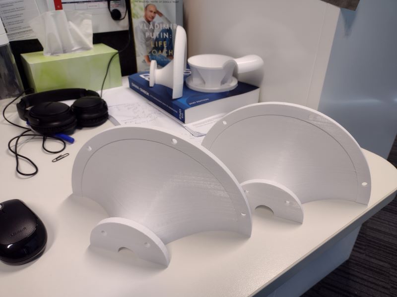

G'day Paul,
If you pop over to the Ath4 thread you'll find you can create perhaps some of the best possible waveguide designs and cheaply and easily 3d print these.
Marcel's designs are available at his site here.
I have printed and measured his ST260/B (with a reasonably priced Celestion CDX1-1975) which I believe outperforms a SEOS12....

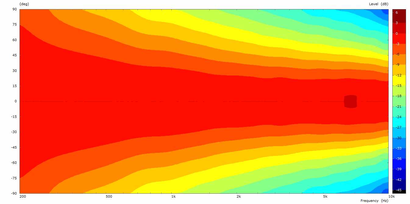

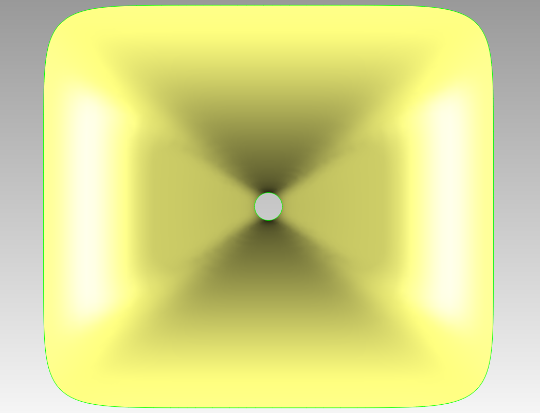

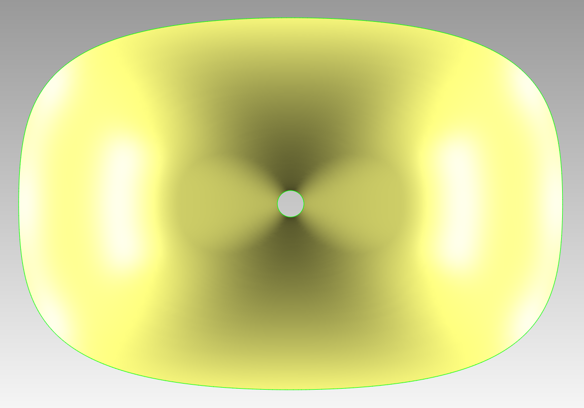

A few pages ago I posted some simulation plots of an axisymmetrical spherical wave horn. The profile was based on a few of my favorite numbers and combinations thereof (it also had an 808 in it 😉 ).
Below is an axisymmetrical and square flat front JMLC horn with identical parameters, except for a different value of the Lamé exponent.
The polar response will be about the same as the attached plot, but slightly more erratic due to the lack of rollback.

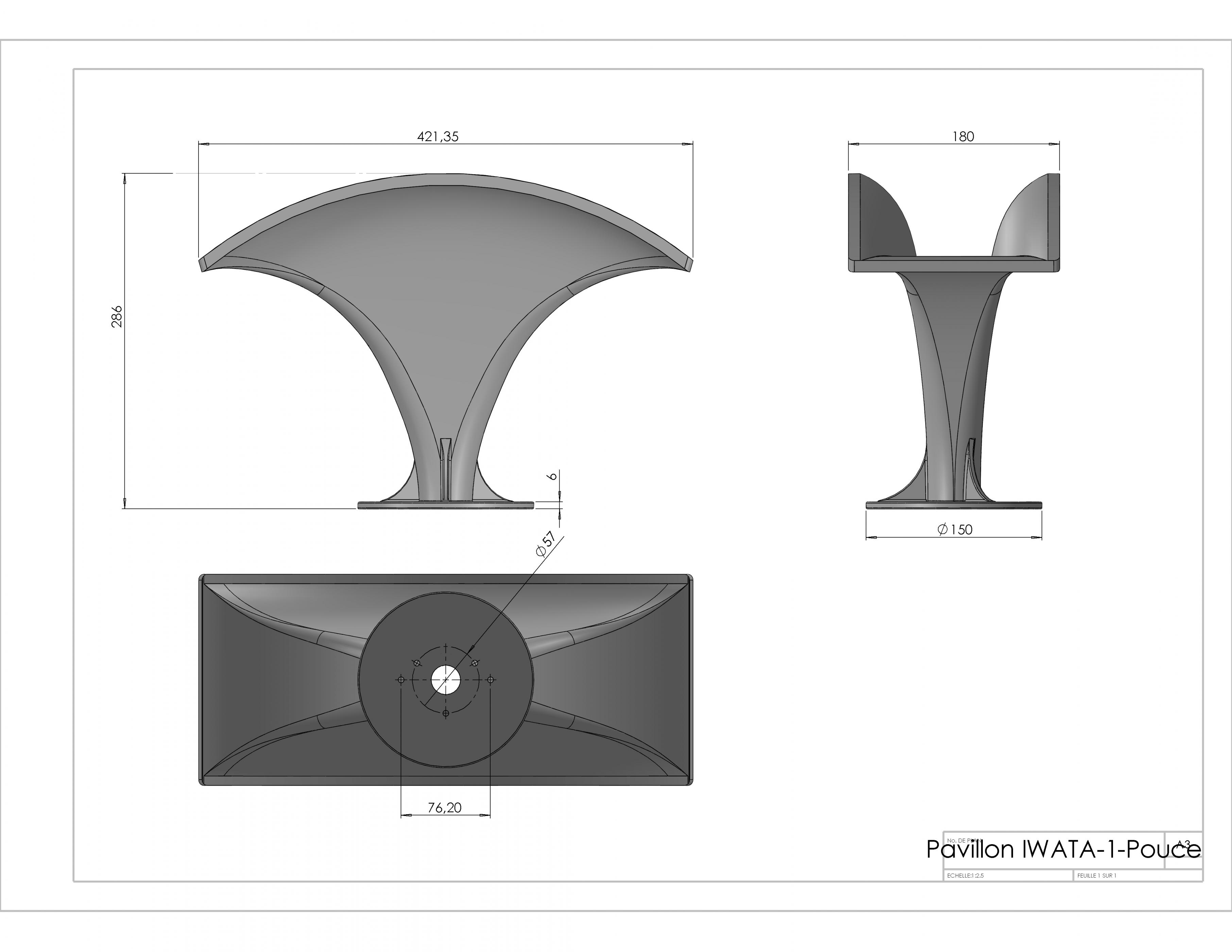

The original Iwata horns (attachments) are hyperbolic, but one could argue these all belong to the same family.
