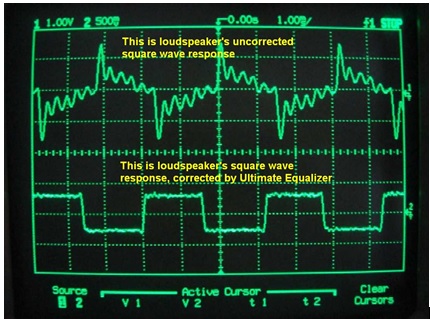

Why get hung up on physics when we can bend it in software. Only in iceskating, points are given out for "artistic performance" (read: look ma, no EQ...) - the proof is in the measurements and SQ pudding. Power is cheap and good.

You aint adjusting decay with software....not yet lol....all it would take is an inverse signal of sorts but I've not seen any implication of that....yet
You need to put a call into David Gunness and tell him he's got it all wrong 😉
https://www.fulcrum-acoustic.com/wp-content/uploads/2019/10/improving-loudspeaker-transient-response-with-dsp-2005.pdf
For the correction to be effective it needs to apply to a linear time invariant issue which not all problems are.

And just to reiterate a point, if I correct a LTI system in the frequency domain with a causal filter (IIR) then I also fix everything in the time domain as well. Have a peak, ringing. No peak- no ringing.

If this was true, we could not enjoy replicated music in any room. An improved impulse response form a speaker will be heard even if a room has a much longer decay than a speaker.
