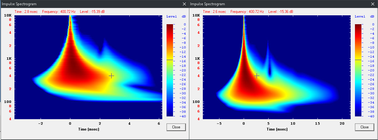

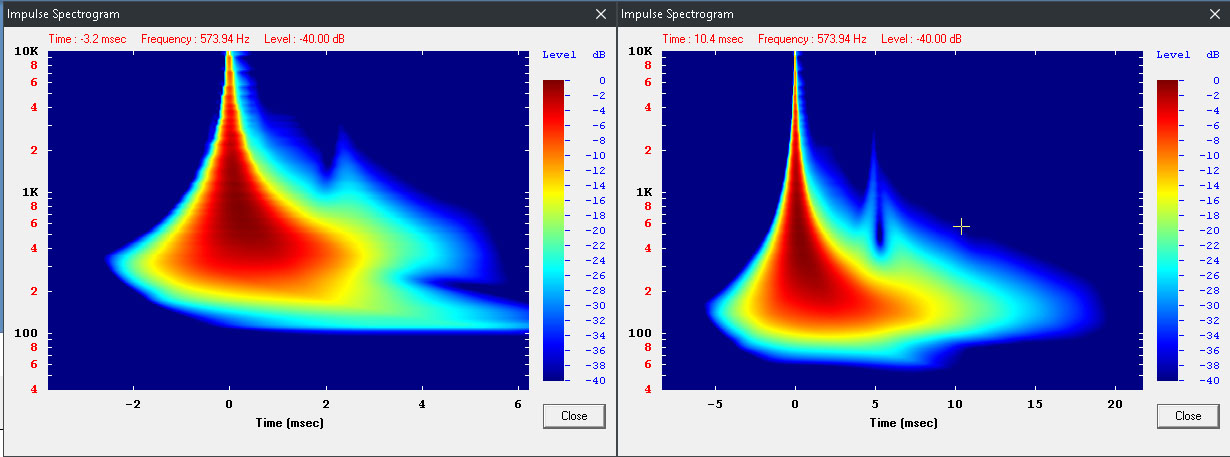

OK I got my spectrogram back by hitting default parameters button but...wtf?

This is why I said these sorts of graphs are tricky to interpret correctly 😉My first question would of been why doesn't the decay graph line up with CSD wavelet....
My second question would of been why doesn't my HR spectrogram line up with REW spectrogram lol

Above are a 150hz a 200hz and a 350hz tuned horn.....Can someone explain to me why at say 400hz for example we have different decay times?
OK my JMLC modelling seems more consistent between 150hz and 350hz tuning.....I had to lower BL to get the response to smooth out towards F....something might be off in my tractrix simulating...I just type in a desired cutoff and let HR do this rest.
I create the sims then import the IR to rew and check out the Burst Decay....These to examples are much more similar than my tractrix sims...I think that is due to something wrong with my modelling...but maybe not?
Maybe this is a better view....you can see below the point of -15 which is very much the same....the tail hangs on something long...Just wondering whats the cause of this?

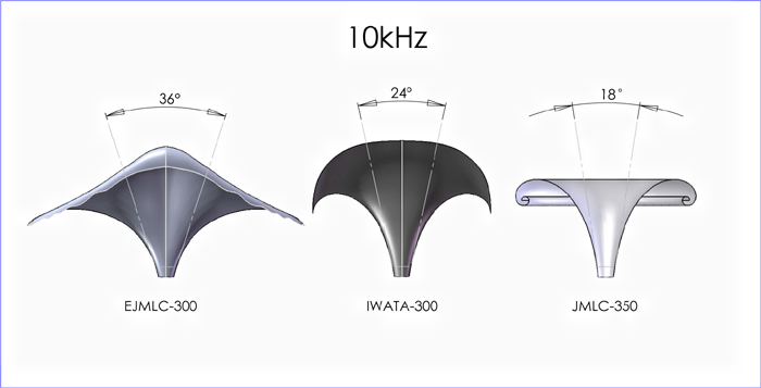

Does anyone know the context of this picture?
Is this supposed to be how wide the beamwidth is, out of the throat, at the frequency size, matching diameter of throat?
or
How wide the polar of 10khz is at the standard -6db?
I posted some of results of my theoretical and experimental investigation of 1" throat JMLC horn (Fcut=900Hz)
https://www.diyaudio.com/forums/multi-way/338806-acoustic-horn-design-easy-ath4-45.html#post5936182
