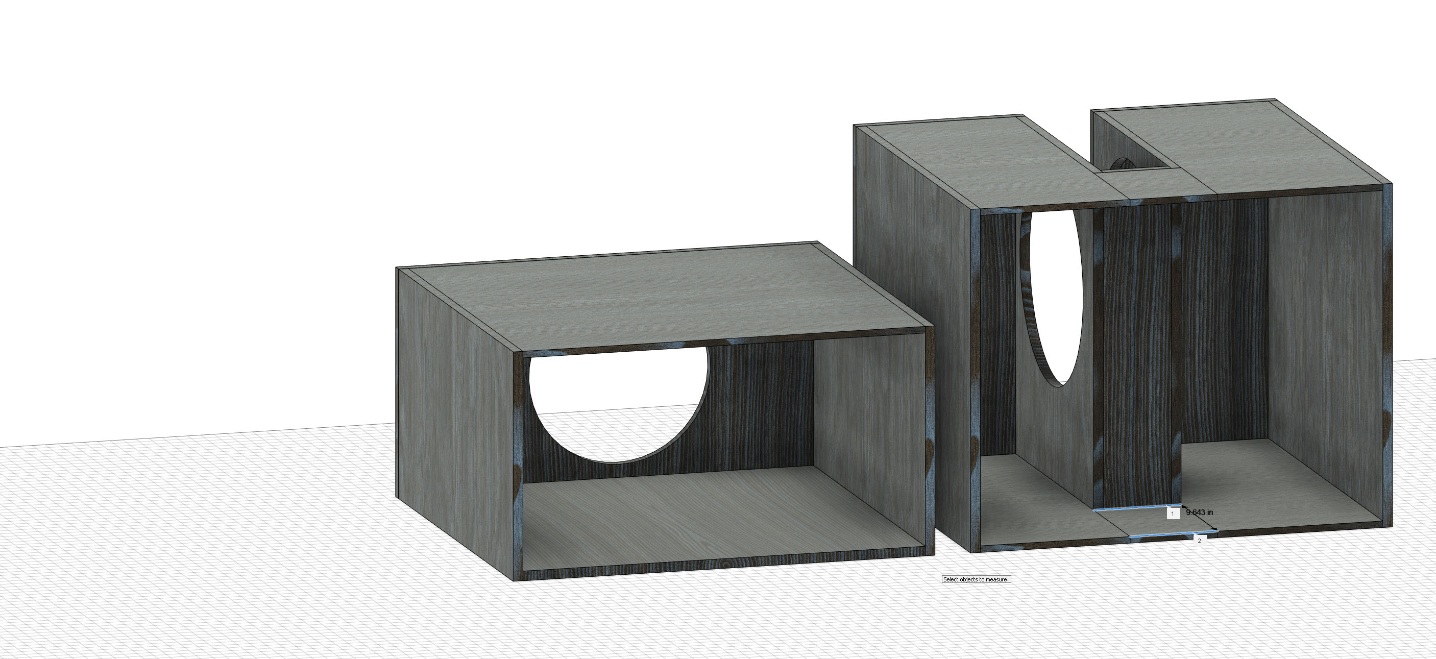

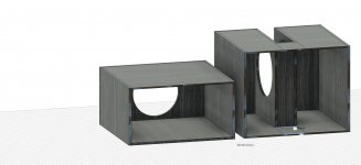

Any opinion on Bracing? The 15" box I envision a cpl of almost full length boards, running the full width of the inside, spaced evenly, with on run of vertical board down the middle...
The Sub box, looks to be pretty rigid already...
If the strongest vibrational forces run the same direction as the firing of the diaphragm, then bracing should reflect that correct?
I could see U shaped run of top to bottom vertically place board splitting the cabinet in two, and from there, A horizontal run of board splitting the top from the bottom....so kinda like a Cross or a Plus sign that is stretched and turned into a U.
What do you guys think?

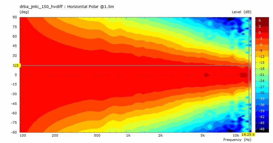

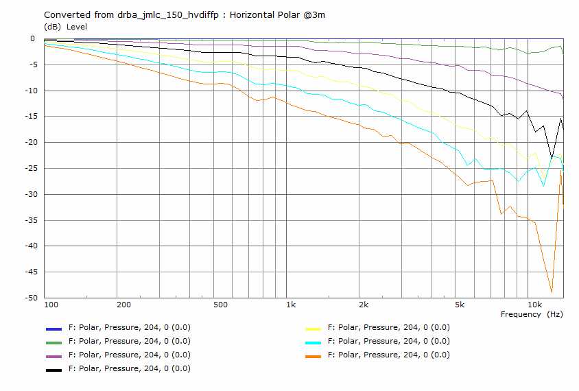

Docali and Don k helped me develop a horn called the HVdiff
attachment.php
attachment.php
This horn, I believe, has the potential to check all boxes.
Does anyone know the formula to predict beam-width vs distance!? I tried this
+/-1.5m*tan(15deg)=+/-40cm
but my calculator don't like it...I probably need to translate degrees into something besides 15...
This horn was designed around a 200hz crossover. This horn has to be manufactured...by my lonesome, so in the mean time I've bought a jbl 2380a and 2386 to experiment with but am open to more ideas. A low crossover is needed to keep KA low enough for nearfield but there is a some room for play. The AXi2050 seems to be able to play as low as intended even in a waveguide. The gross of my experience with horns is an Altec clone using 511 horns... I understand that some horns beam, and as long as I get the full spectrum in the sweet spot, I am content. I am after the most neutral presentation, and it seems that sweet spot size is secondary and that
the only real consensus is that the off axis should be smooth.
. I have plenty of opinions on this but I'm anxious to hear yours.
