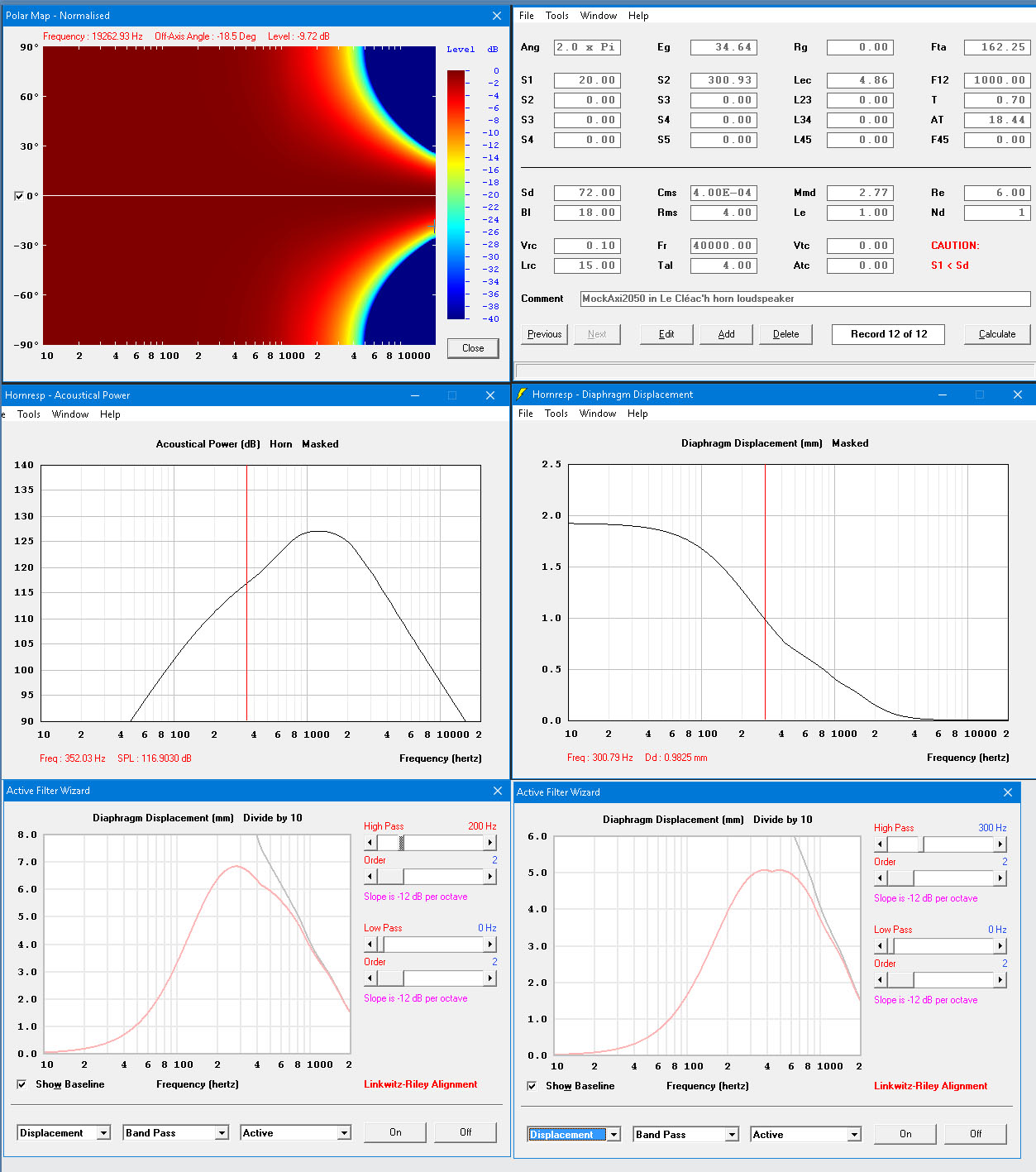

OK time to model lol...well maybe...where are you human calculators at! How do I translate this to model it!?

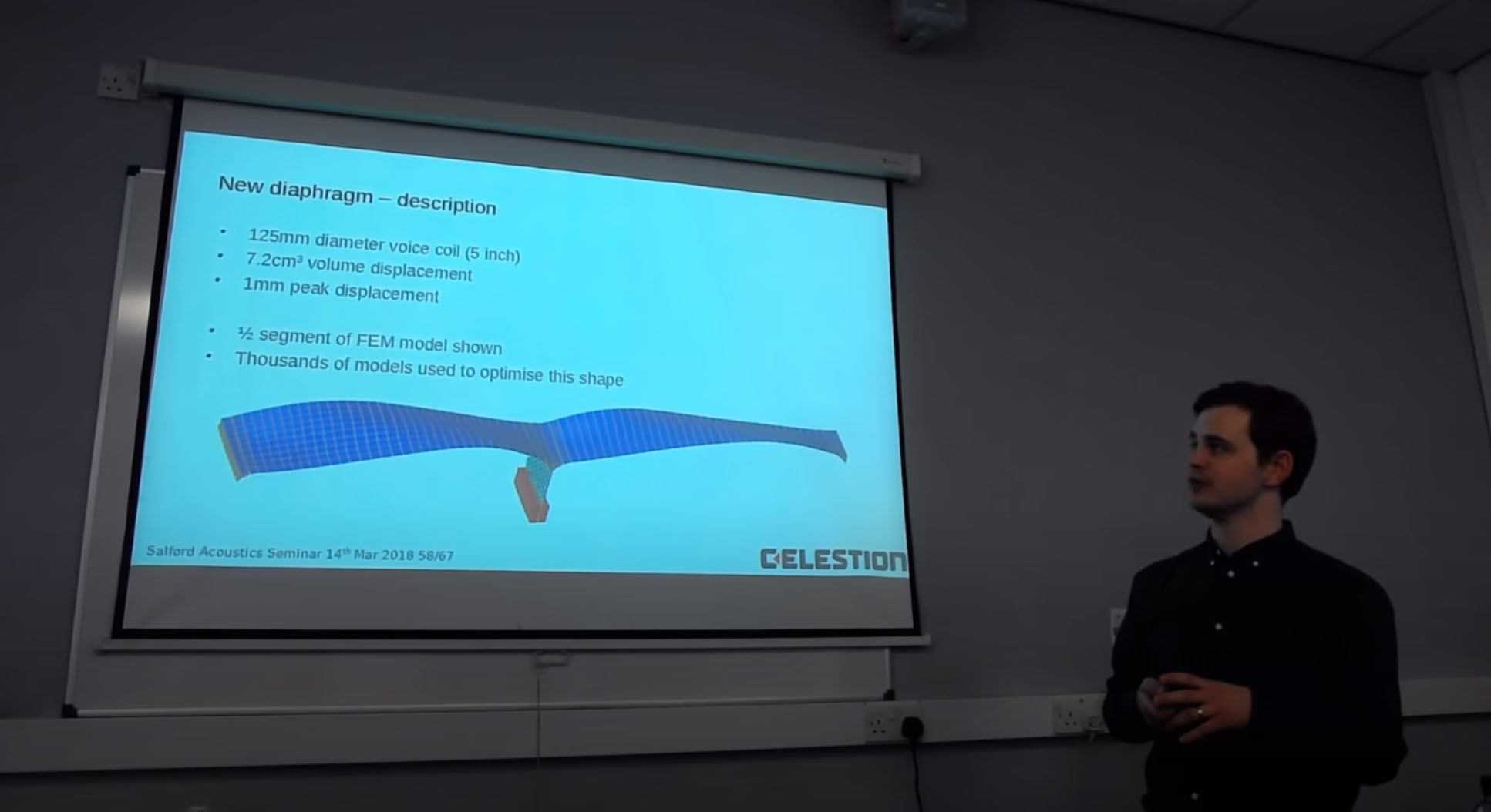

"equivalent to about a 4" dome diaphragm" What SD is that!?
"it can move out to 1mm in either direction..."
Ty so much! I have no idea what formula that is, but I looked up the specs for a 1", 2" and 3" dome and copied the trend to 4" and got ~83cm^2 but it appears that you have a better understanding....
I am having a moment....between the frustration of manufacturers not sharing thiele specs for compression drivers and horn resp cutting off my response display at 2000hz for no apparent reason, I'm almost certain I will have to watch my blood pressure from this point on in life....the ignorance is just uncanny. No wonder old people hate everybody....
Btw 72cm^2 is that of a 3" dome....
Thank you Earnie! Heres what I have concocted using the 72cm^2 for SD and 2.77 for MD
attachment.php
I spoke of a transition where the detriments of performance at cutoff become a non issue....I think this helps prove my theory...it also aligns with discussion that I have had suggesting the 350hz JMLC is the biggest horn one would use for full range...I feel the resonate of larger horns becomes too exaggerated to play anywhere near the Fc but this isn't the case with smaller horns. Where to draw the line in the sand...might be 350hz. I'm not sure but I think Hornresp measures at 1m correct>?
ps if you calculate HR shows all the range selected...*duh* and *face palm*

Now that I can estimate excursion, combined with my theory that smaller horns can be used below cutoff....I can potentially model towards an even smaller horn that will potentially allow me to crossover at 350hz. The counter balance is the loss of directivity...So I still love the big horns, but in the thought of experimentation, I can make educated guesses before making a move. Also, Docali has shown the ability to model horns that can maintin a width while adjusting the fc...so with that in mind, directivity by width can be maintained!
attachment.php

Be wary of the specs gleaned from that power point as they are not really clear, there is 1mm peak displacement listed and a suggestion that there is only 1mm gap which may be been inferred from the 1mm displacement.
That sounds more like the mechanical limits of the driver and not linear xmax in the same way it would be listed for a dynamic driver.
Volume displacement is a simple formula Sd x excursion, just use the same units for both.

In the video, the guy says @ 50:50,
It can move out to 1 millimeter either direction in a (unintelligible...quite?) linear way
https://www.diyaudio.com/forums/attachment.php?attachmentid=847153&stc=1&d=1590370960
So if xmax and xmech are on top of each other thats fine. I don't want to hit 123db anyway....its nice to know I'm not going to hit xmax or xmech, in the non PA setting.

attachment.php
AXi2050 ain't scared of the 1000hz jmlc either lol!...
...According to my completely skeptical calculations, God knows what I'm doing wrong....
If anyone sees some inputs that I could change to make this simulation more realistic please chime in...Its basically a diaphragm with a horn on top of it...I just made up the mmd and rear chamber size, it would be nice if I could get the top end response to appear more realistic to the Axi2050, I wouldn't know where to begin.
It appears, that the Axi can run to 300hz with only a waveguide, more or less...I'm guessing that 1mm of excursion is more than other compression drivers, considering the depth of performance, with a diaphragm that has less surface area than a 4" diaphragm or am I mistaken on my assumption the surface area of a 4" diaphragm.
