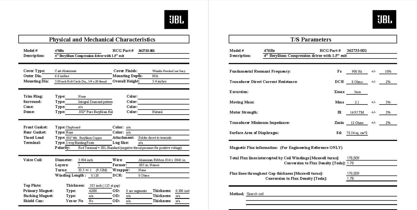

It appears, that the Axi can run to 300hz with only a waveguide, more or less...I'm guessing that 1mm of excursion is more than other compression drivers, considering the depth of performance, with a diaphragm that has less surface area than a 4" diaphragm or am I mistaken on my assumption the surface area of a 4" diaphragm.
Can anyone confirm the sd of a popular 4" compression driver diaphragm? how about the xmax?
A nominal 4” diaphragm has about 12.2 square inches of diaphragm area, Sd 78.54 sq cm for a JBL 4”.

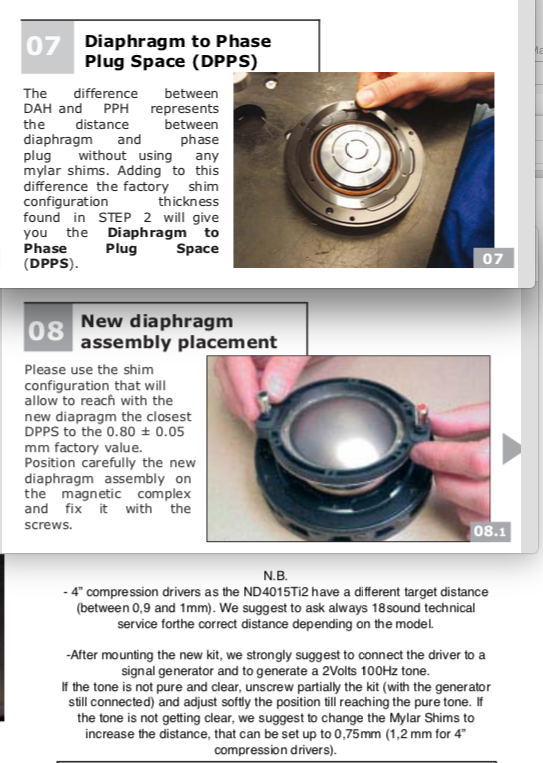

HF drivers are by design displacement limited to around 1mm, or the HF rolloff caused by the acoustical bandpass created by the volume of air between the diaphragm and the phase plug reduces HF extension too much to be useful past 10kHz or so.
With excursions approaching 1mm, the diaphragm hammers against the phase plug, which sounds very bad, though the magnetic system could still be linear at that excursion.
Though JBL lists the Xmax of the 476 Be at .5mm, the actual diaphragm to phase plug gap is probably very close to 1mm.
18 Sound includes the Diaphragm to Phase Plug Space (DPPS) in their diaphragm replacement guide, the smaller diaphragms .8mm DPPS, 4” target DPPS at .9 to 1mm.
As Dr Jack Oclee-Brown mentioned in
YouTube

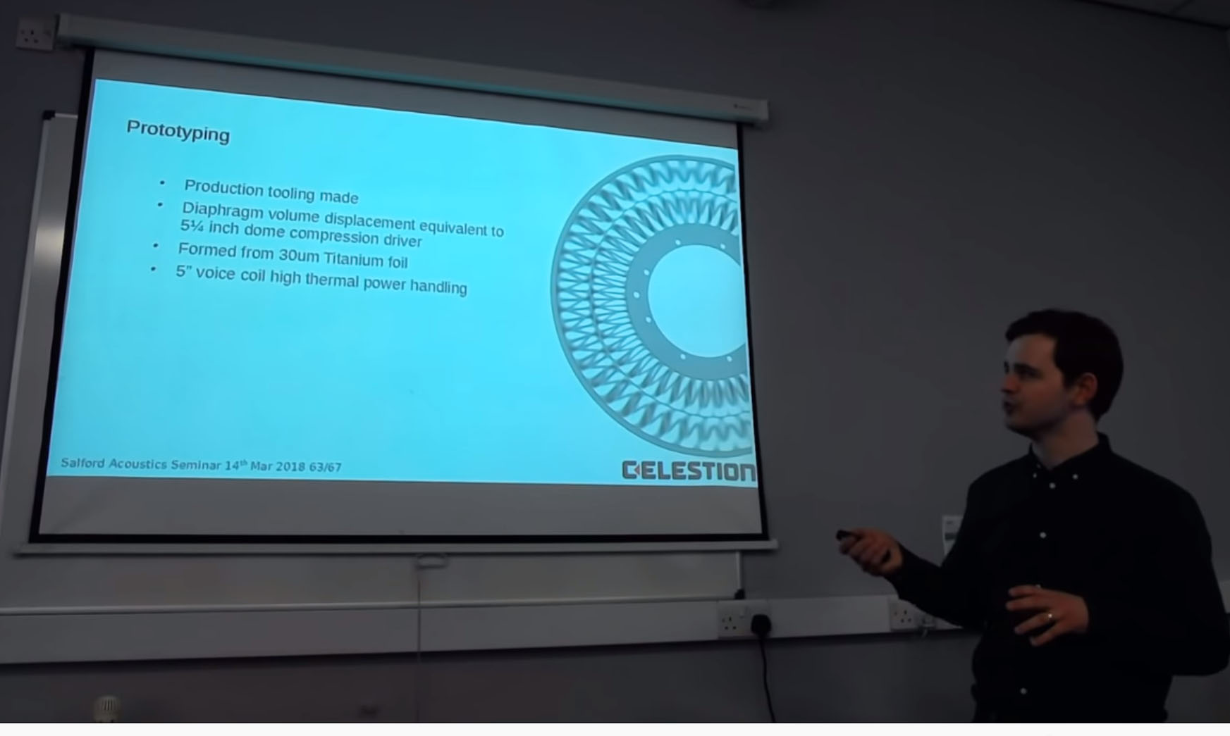

the displacement of the AXi2050 is about the equivalent to that of a 4” dome,
the AXi2050, being an annular diaphragm, has an excursion of 1mm near the voice coil, “coming down to almost nothing at the surround”.
The AXi2050 has less low frequency (below 600 Hz) second harmonic distortion from mechanical limiting of the suspension the (presumably BMS) dual diaphragm driver he compared it to has.
As he also mentioned, “it’s not so good at high frequencies..”
The AXi2050 lack of mechanical limiting will also allow the diaphragm to hammer against the phase plug with less voltage applied ;^).

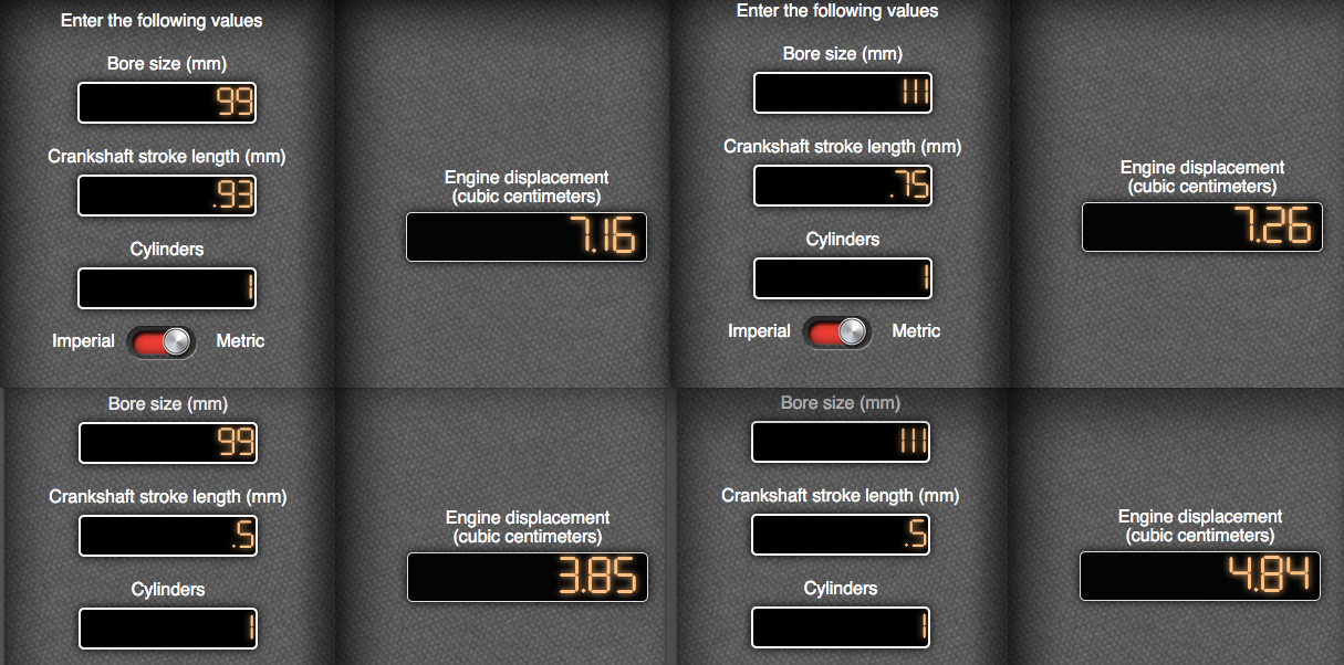

The modelling that I've tried to do, what do I need to do to make it more accurate? Based off of this formula 7.2 cm^3:0.1 cm=72 cm^2....I've used it for the SD...Taking 72 cm^2 as opposed to 5-1/4" displacement can we formulate a more accurate Xmax? The guy says the diagram can move 1mm in either direction linearly in the video so how are we judging this to be inaccurate..
attachment.php
No - it is not !
If it uses pistonic motion then your calculation is right.
But the driver in question doesn't use pistonic motion becaue it doesn't have a suspension. So the Vd is closer to the volume of either a cone or a pyramid whose volumes are one third of the height multiplied by their bottom area.
Regards
Charles

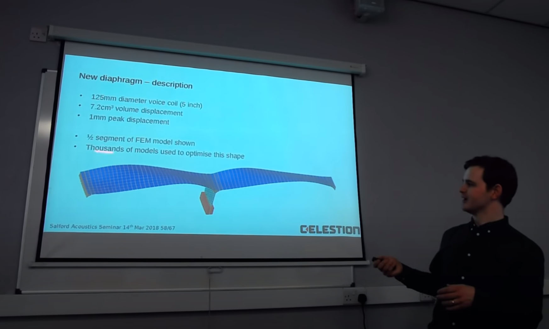

1)The video says 5-1/4" displacement not 4"
2)The guy says the diagram can move 1mm in either direction linearly in the video so how are we judging this to be inaccurate..
1)At 50:38 while the screen says the New Diaphragm has a 125mm diameter voice coil with 7.2 cc volume displacement and 1mm peak displacement, he verbally says that is "equivalent to a very, very big dome, it's I think equivalent to around about a 4" dome diaphragm, so it can move a lot of air".
Domes have a suspension that allows the entire dome to move as a piston, while an annular diaphragm the center can move X distance (about 1mm) while the two outer edges are "pinned", no movement. No simple equation will actually figure it's displacement, even if the Sd and excursion are known, though for Hornresp, you could just as well figure a 4" dome at 1mm excursion..
The 7.2cc displacement claimed for the Axi2050 would be the equivalent of a 99mm (4") dome (piston) moving about .93mm, which sounds reasonable, as that is a bit under the full 1 way excursion possible for a typical 4" diaphragm before the diaphragm hits the phase plug.
Going to a 111mm (5.25") at .75mm stroke gives a similar displacement, though I don't know of any dome diaphragms of that size.
At any rate, a single diaphragm producing 300 to 20kHz at full excursion won't sound as good as it would if excursion was reduced to a fraction of that by raising the crossover an octave, or splitting the range between two diaphragms.
