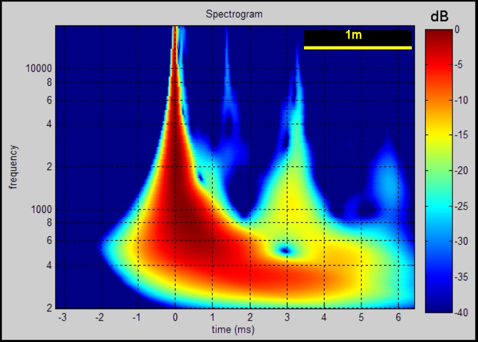

If anything, you'd want to have a horn that shows one of the cleanest pulse results, or viewed in that paper as wavelets. At least I would want that if I were after a reference quality horn for studio work.
In my book that would point to a smooth driver - throat transition and a generous round-over at the mouth to get it. But there's always compromises to make, and I just wonder how far camplo is willing to go size wise to check all these boxes... At least i would think a generous roundover would make his round horn bigger than he'd like it to be?
A square, ellipse or rectangle horn would still have that energy after the pulse, but more smeared out (due to those different path lengths). So it could be one has to choose (as always) your set of compromises to get close to what you'd want.

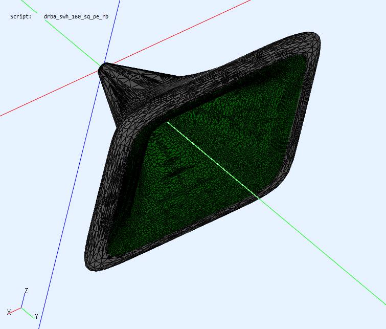

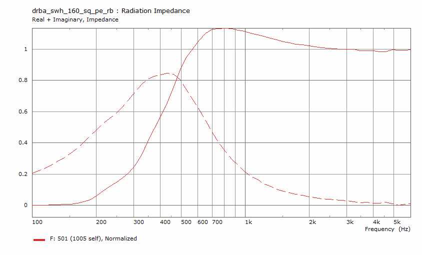

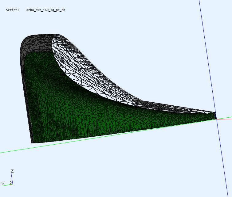

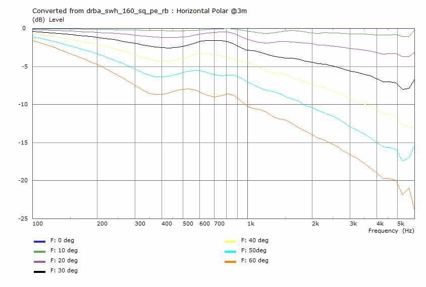

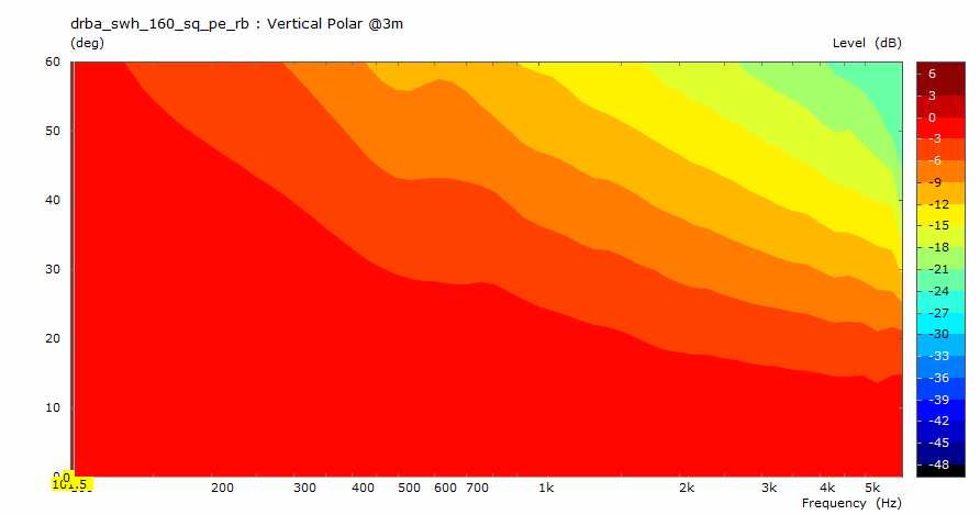

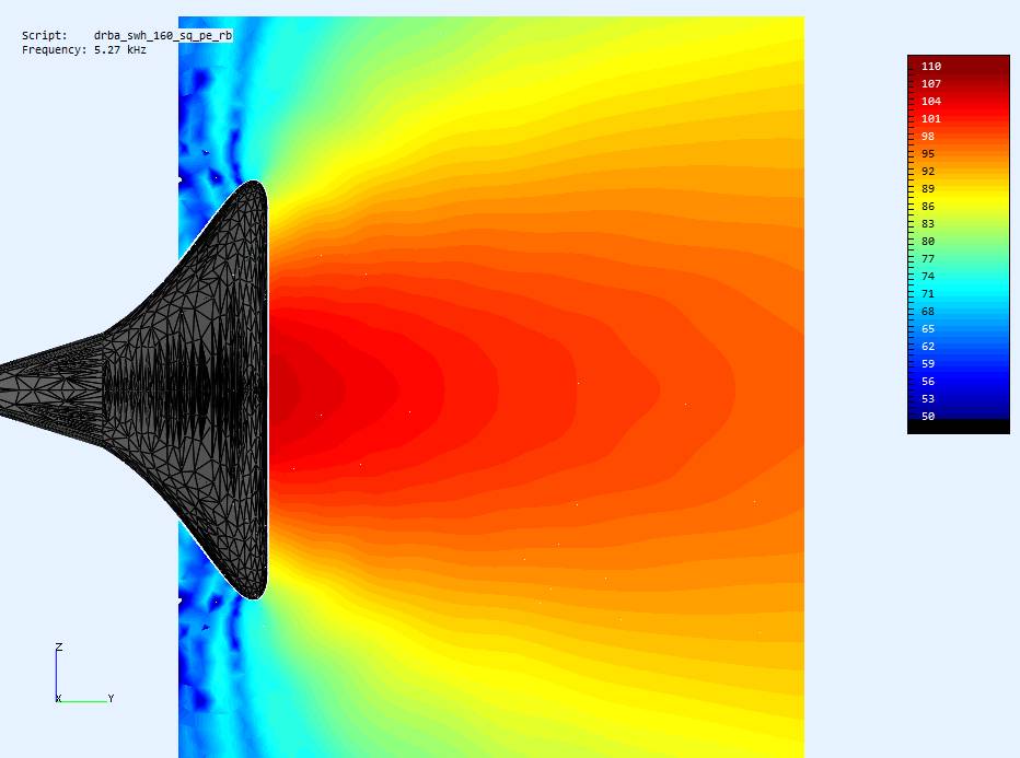

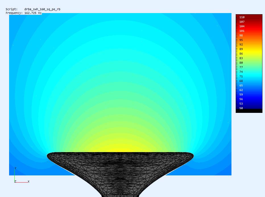

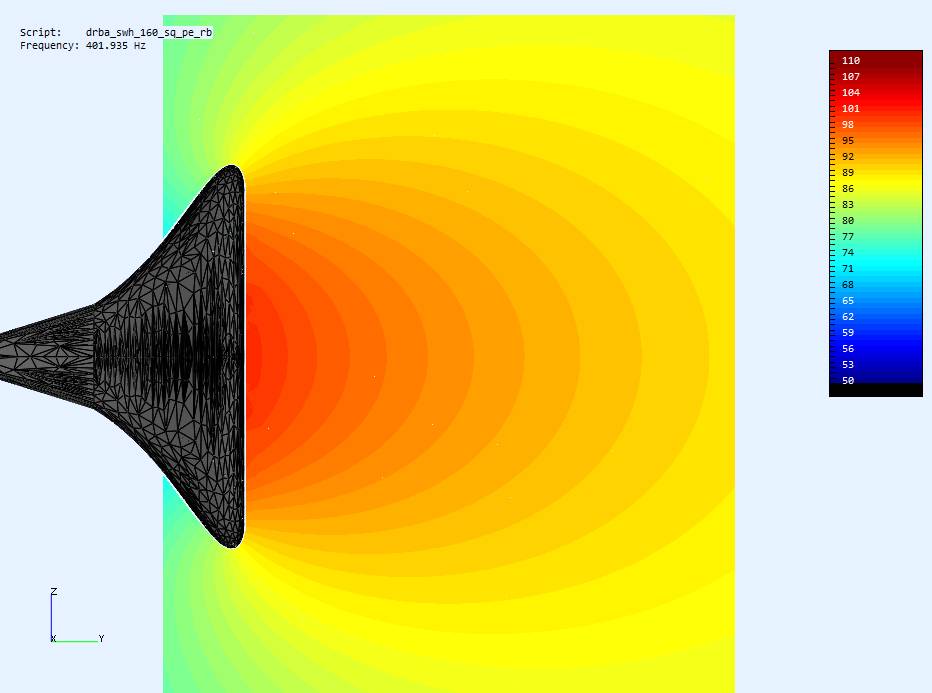

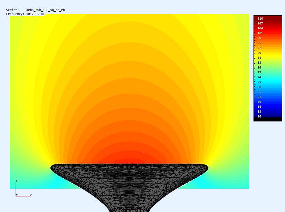

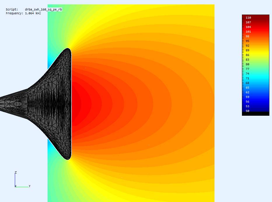

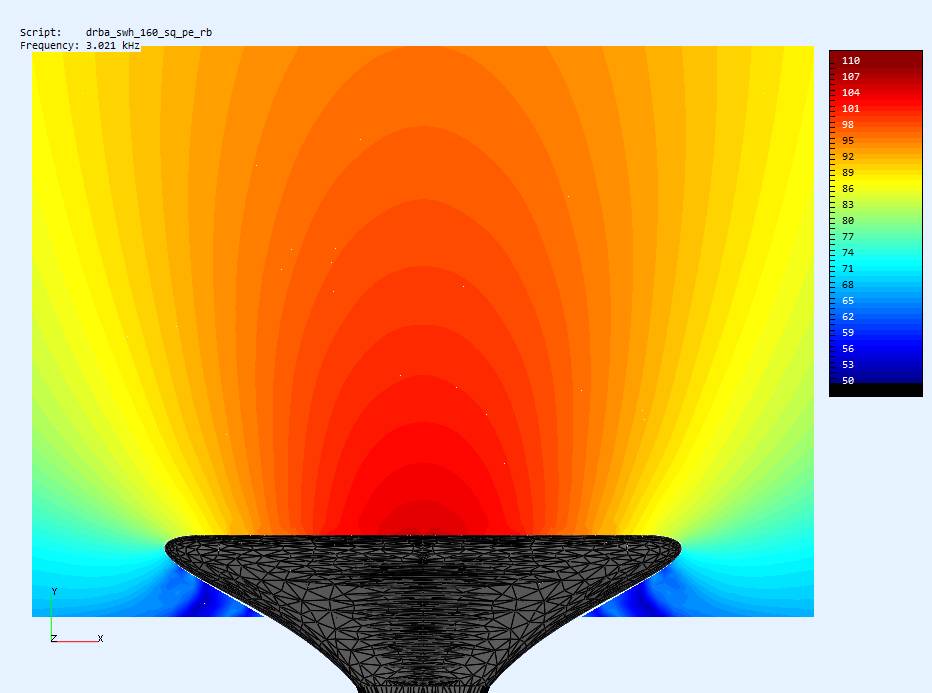

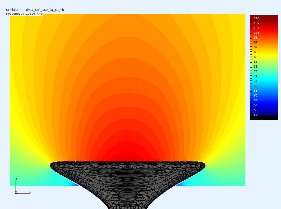

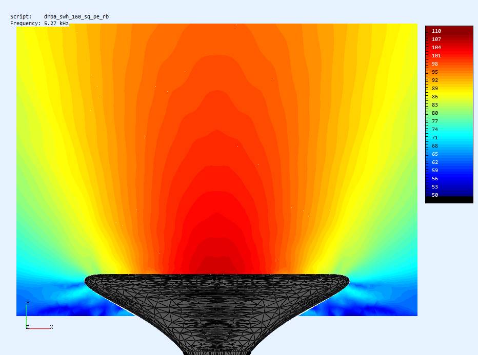

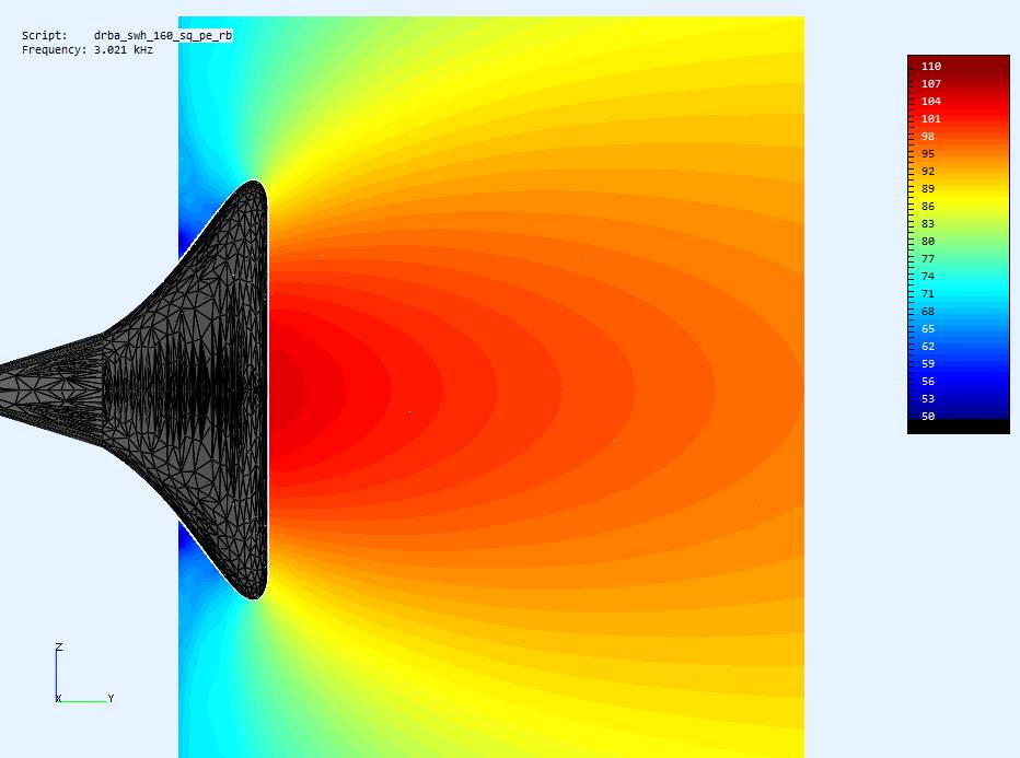

drba_swh_160_sq_pe_rb - BEM sim
This is an ABEC sim of the horn from post #4288 Is it possible to cover the whole spectrum, high spl, low distortion with a 2-way?
I understand from @docali that this does not have constant flare rate. Its has progressive T factor to force shorter axial length so its a compromise.
The simulation model is for 4Pi space and accurate to about 6Khz. The mesh resolution was reduced so this model could run in a reasonable time.
.. and some observation fields

This horn performs better than I expected. The maximum T factor was about 3 here. So, a very drastic reduction of the length.
But it may not fulfill camplos requirement for low signal loading.

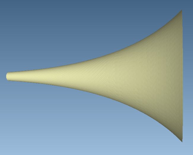

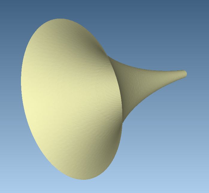

I think that I have found the right horn for camplo and his size restrictions. If I remember well the exponential horn has a terminated mouth and it is terminated at 45 deg. For this angle the reflecting waves from mouth to throat from it's real and imaginary part should theoretically cancel. Therefore, this is a horn of this type derives from spherical wave horn with T=0.7. the length s about 90cm:
View attachment drba_swh_147_T07_Jericho.zip
View attachment 795090 View attachment 795091
Now you are just showing off 😀😀😀
and here a second version which has a slightly larger mouth diameter because of expanding T and lower base cut-off. Btw, the cut-off has not the same meaning as for the typical swh. The construction vector is determined by the cut-off value.
View attachment drba_swh_120_T07-T20_Jericho2.zip
