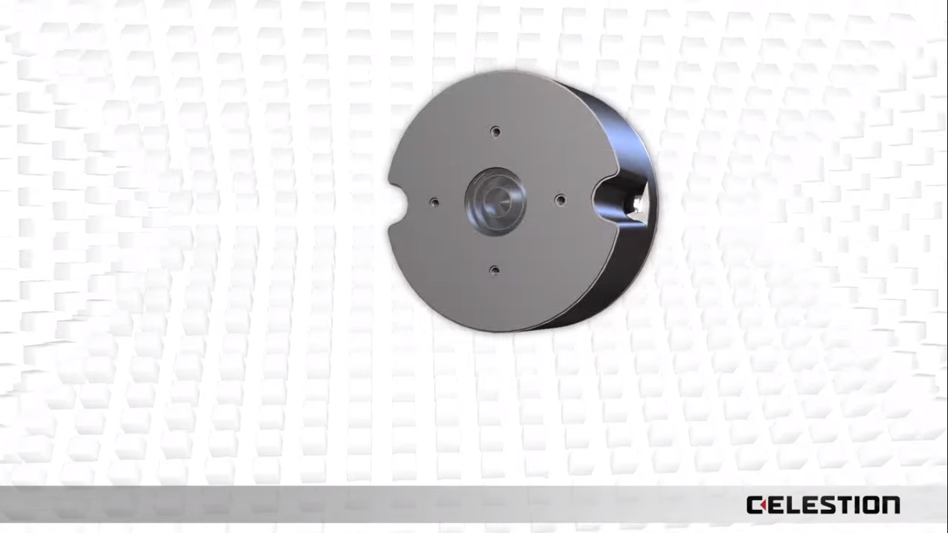

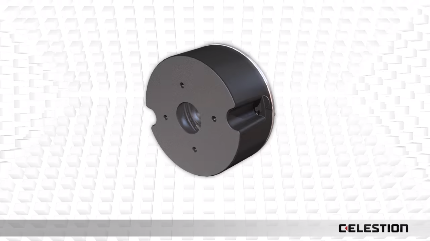

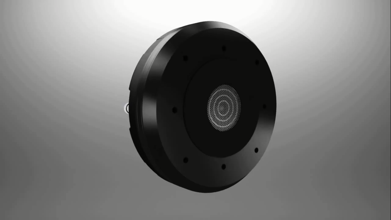

Left: 4015Be, throatless, as confirmed by 18Sound
Right: Axi2050, you'd think it's also throatless.
100% throatless implies all phaseplug channels end at the exit, like the 18Sound 4015 and JBL 2451.
My B&C drivers are flat like a typical pancake driver, but aren't throatless (exit angle = 34.7°).
100% throatless implies a 0° angle.
I'll send a request to Celestion's Doc. about the Axi's exit angle.
