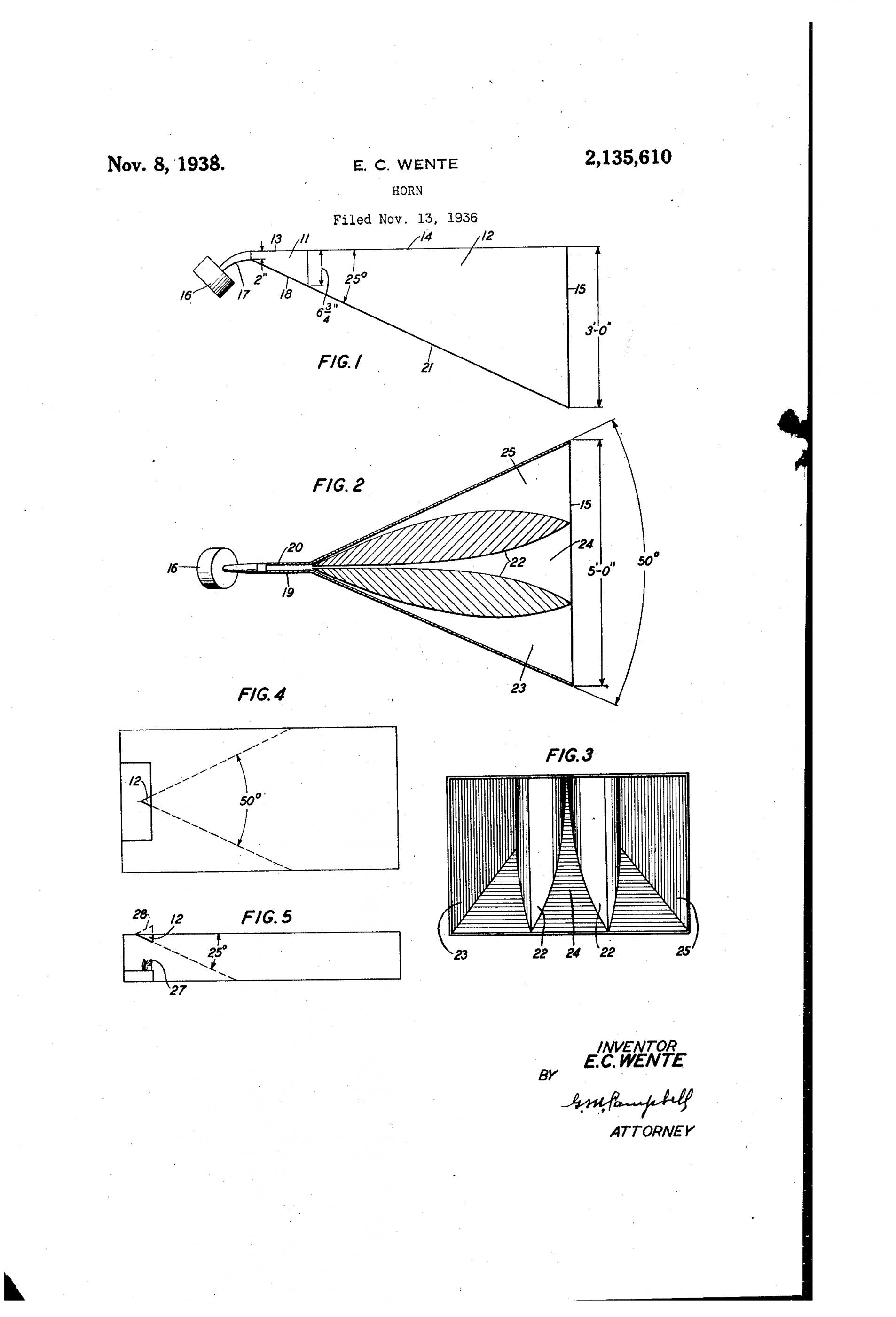

I've been told by those that have have them that the highs slide down the long side (IIRC). Can't verify that as I no longer have access to the large horns.
I guess maybe better to say along the outside. Regardless, W.E. painted a dashed line on the sides for aiming purposes: https://i.pinimg.com/originals/b4/21/8c/b4218cfcd07d2a4a18390e08fc6108d1.jpg

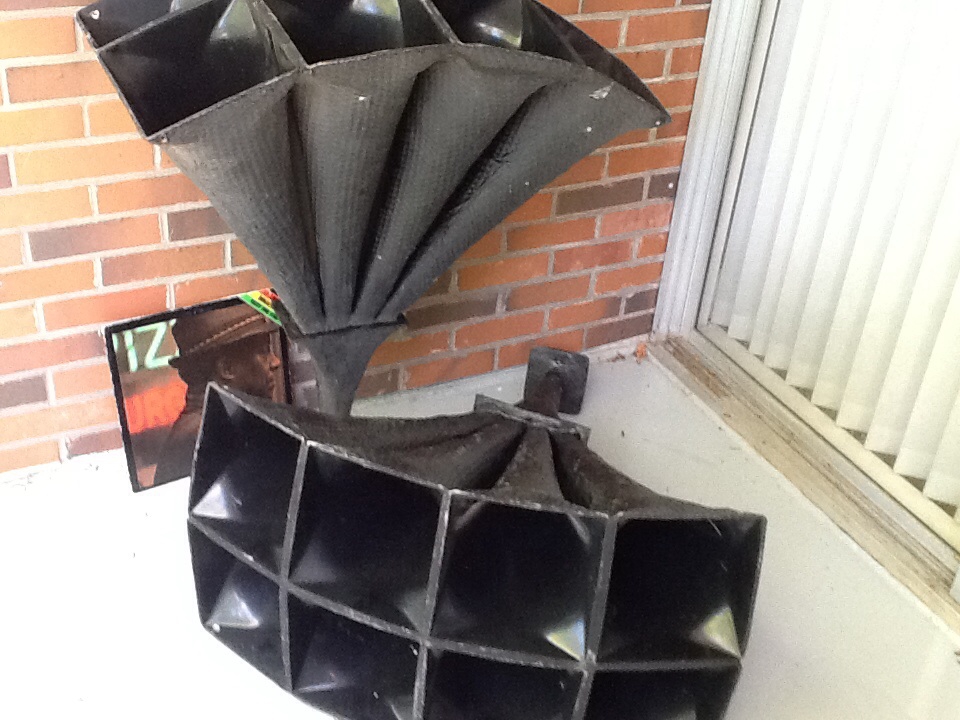

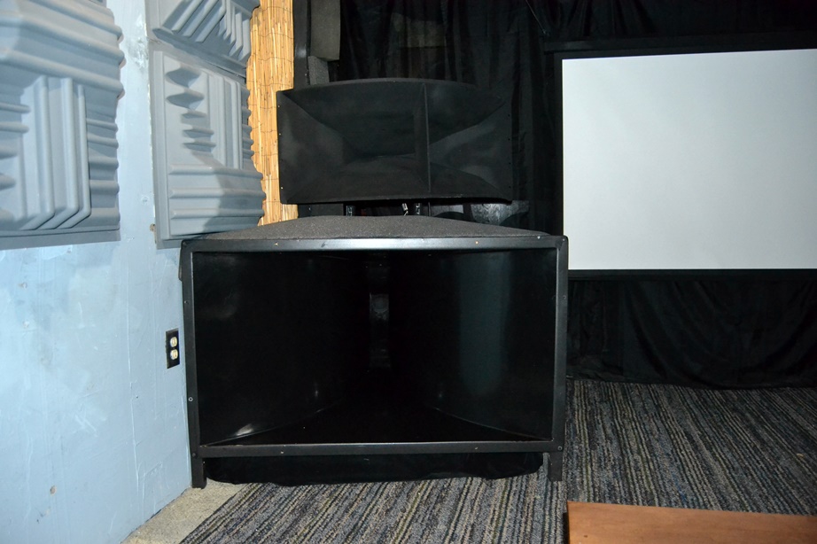

I used black mat camouflage paint. They disappear visually even when I have on the projector in the dark room. The original white was like sitting between two bathtubs. 🙂 annoying
Midbass is Emilar horn with floor/sidewall placed with B&C 8".
I also use the EV big 60 degree horns with JBL 2450SL.. both sound very good.
Crossover is 500 Hz - upper range driver is Radian 835 1.4" with BE

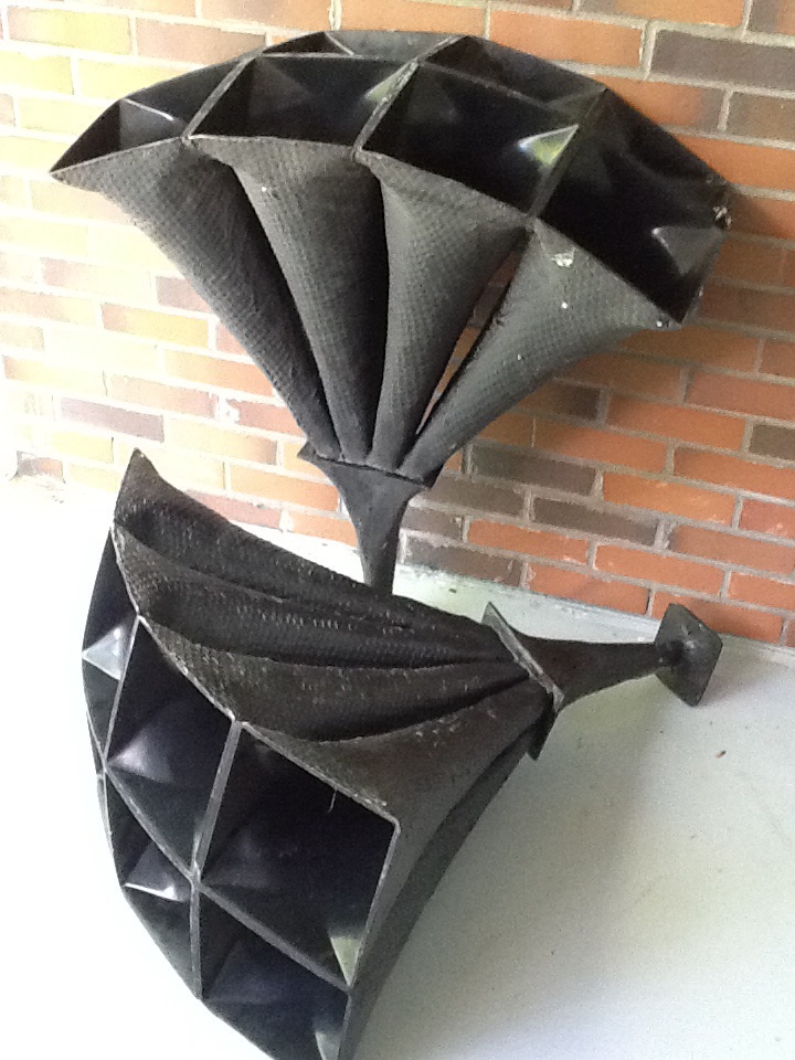

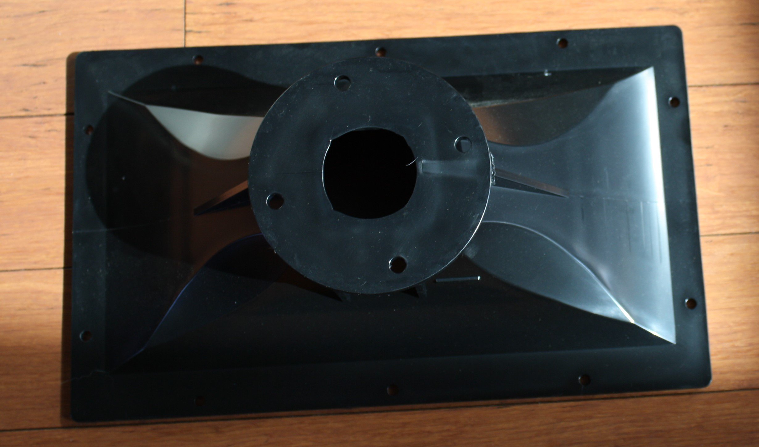

2005: Skew horn for loudspeaker, aka the "mumps" by Roy Delgado (Klipsch).
Delgado's patented Mumps are curved 1" ridges that round off the interior corners within the throat of the K-703-M midrange horn. The goal, according to Klipsch's website, is "to improve coverage and control of the key mid-frequency band."
Klipsch also equips the K510 MkII horn with mumps:

What about mumps in 3 ft. long, oldskool horns (in order to avoid beaming)?

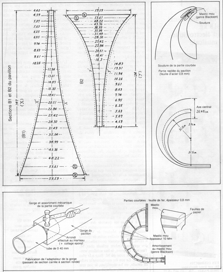

These Rauland multicells are from the 70s:

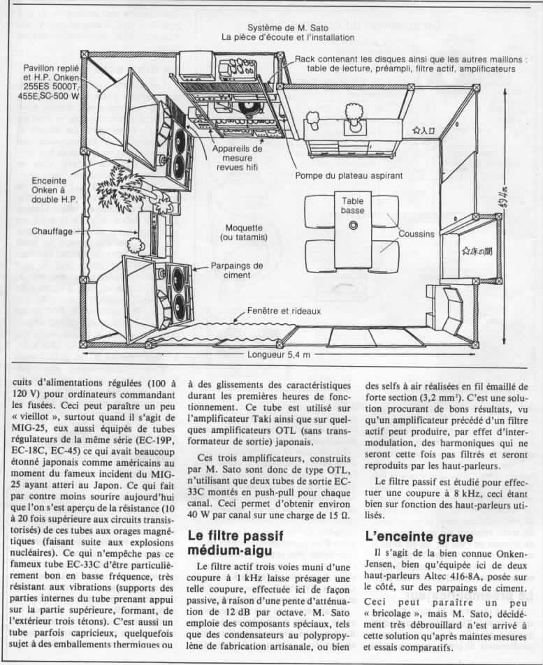

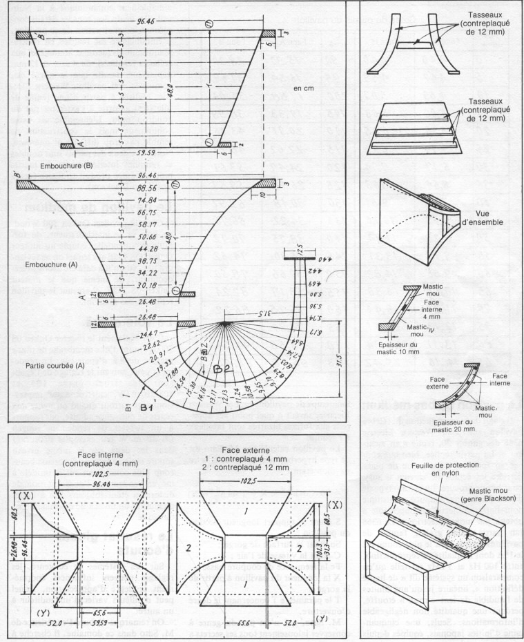

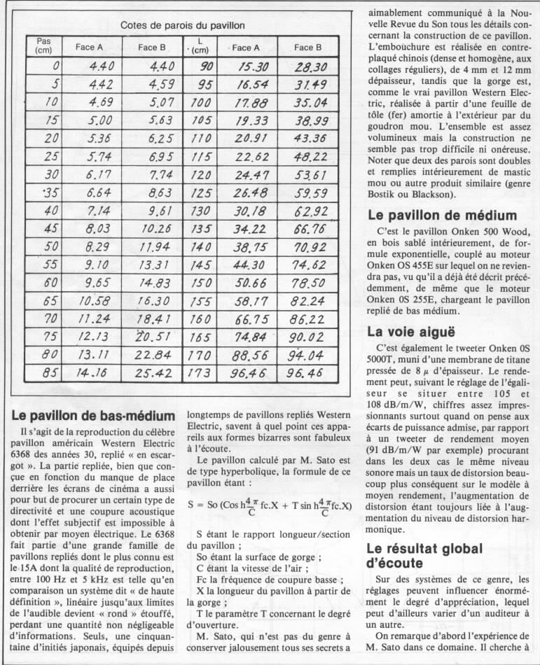

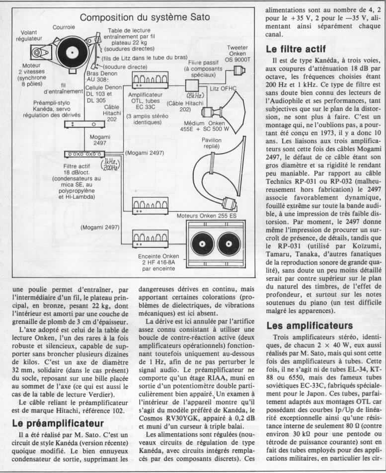

Jean Hiraga visits Susumu Sato:

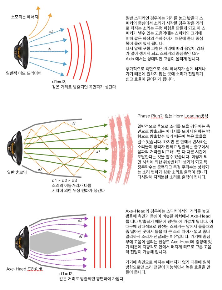

When I designed a radial waveguide for a cone driver I discovered that the best shape for a baffle style phase plug is a diamond, working back toward square with axial length. Is this the same thing/same reason for?Ro808 said:Mumps
There might be some some similarities.
Your description reminds me of Funktion One's Axe-Head (I hope you understand Korean 😀)
The mumps not only reduce beaming and waistbanding, but also acoustically extend the horn's path length, thus lowering the cutoff frequency.
The small K510 loads the driver from about 500Hz, which is exceptionally low, considering its limited depth.

the mumps but also acoustically extend the horn's path length, thus lowering the cutoff frequency.
You could also say: the mumps increase the horn's throat resistance.
