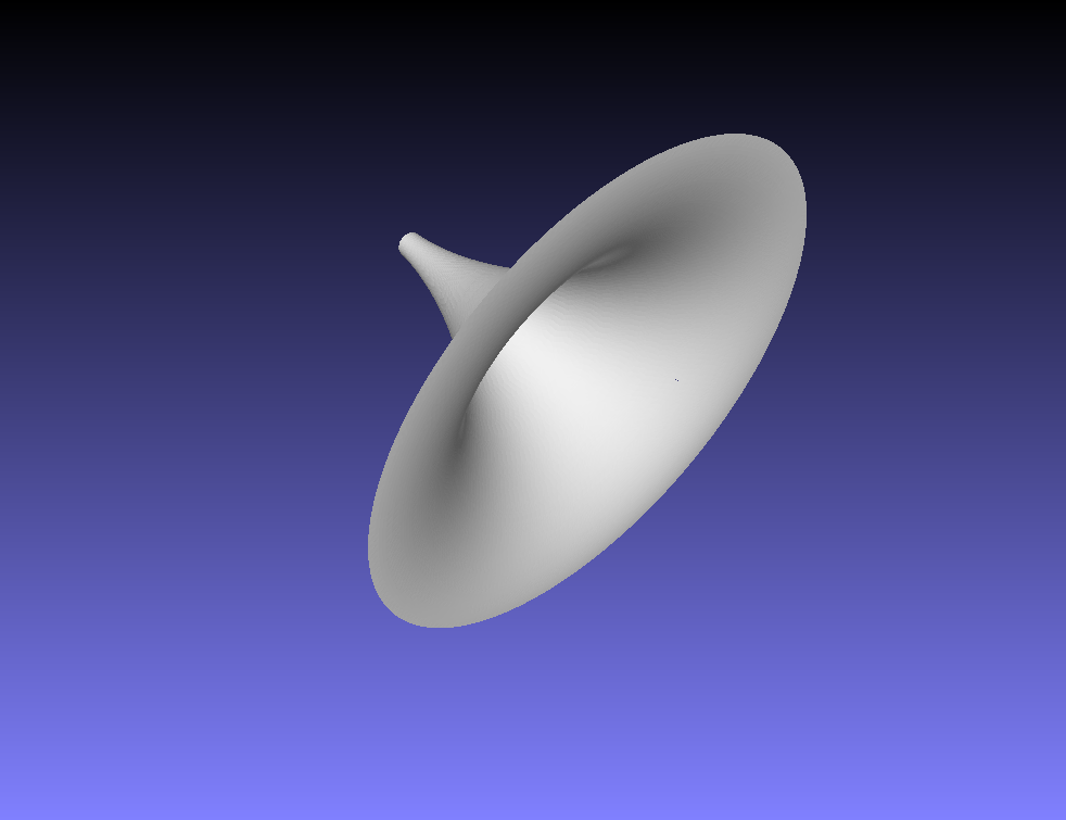

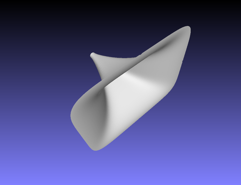

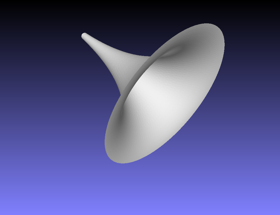

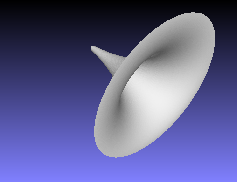

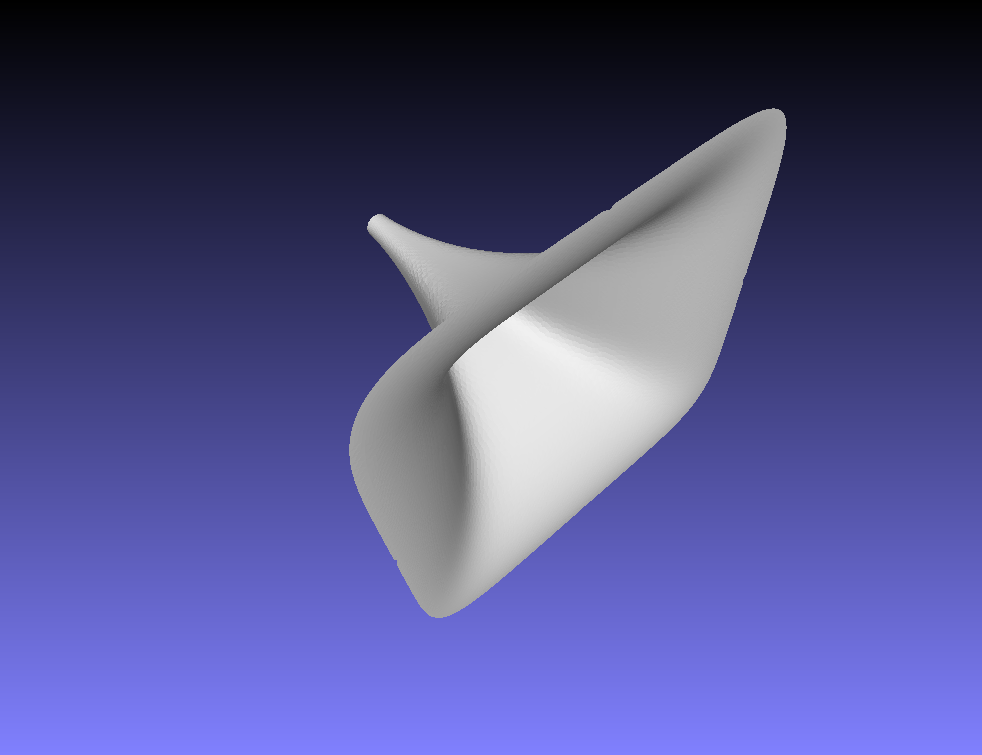

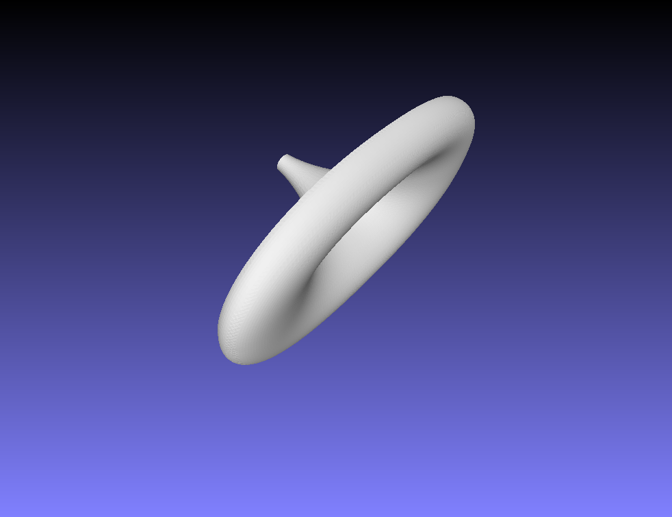

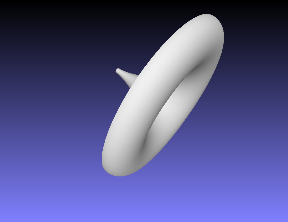

To make it easier for everyone to view these previous 8 horns. The first pic is an overlay of all 8 horns to show relative size.
Hover over the pic and its title will display.

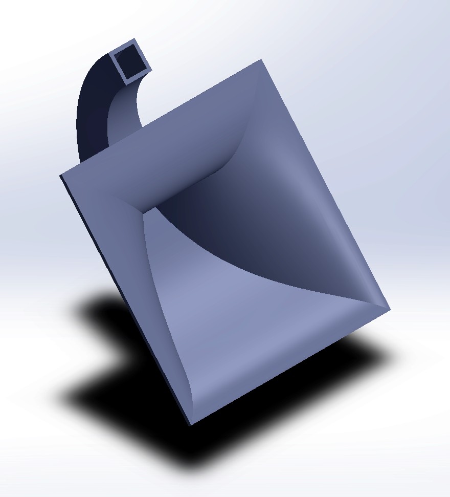

Well kind sir, what is it that you like about square horns? I can tell you that I favor round horns because no matter what angle the response is unanimous. I likle square/rectangle horns because you can create wide horizontal and narrow vertical polar...on that note Docali would you mind throwing a square Horn of Jerico?, Choose what you think would be the optimal vertical and horizontal angles.

I've been told by those that have have them that the highs slide down the long side (IIRC). Can't verify that as I no longer have access to the large horns.It seems like the exit wavefront would be tilted because the inside radius is shorter than the outside radius.

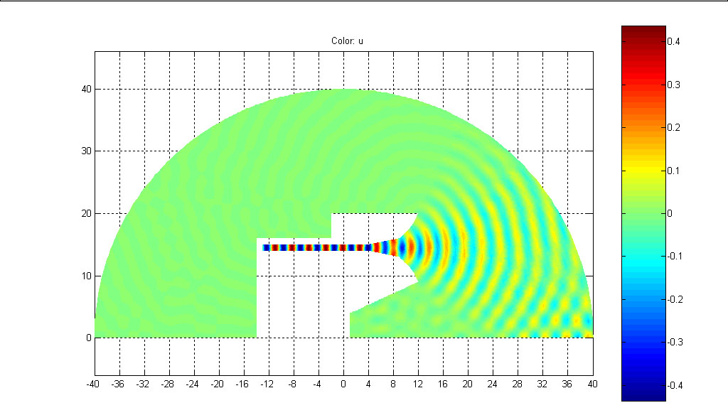

John Sheerin simulated several classic horns in ANSYS:
GOTO style straight horn at 5kHz:
90° bend at 5kHz:
WE30154 at 5kHz

I know that there are many friends in a german forum discussing about these Sato like horns but the common consense is that such horns cannot be used as 2-way. You cannot let travel several octaves through such an horn without "side effects".
