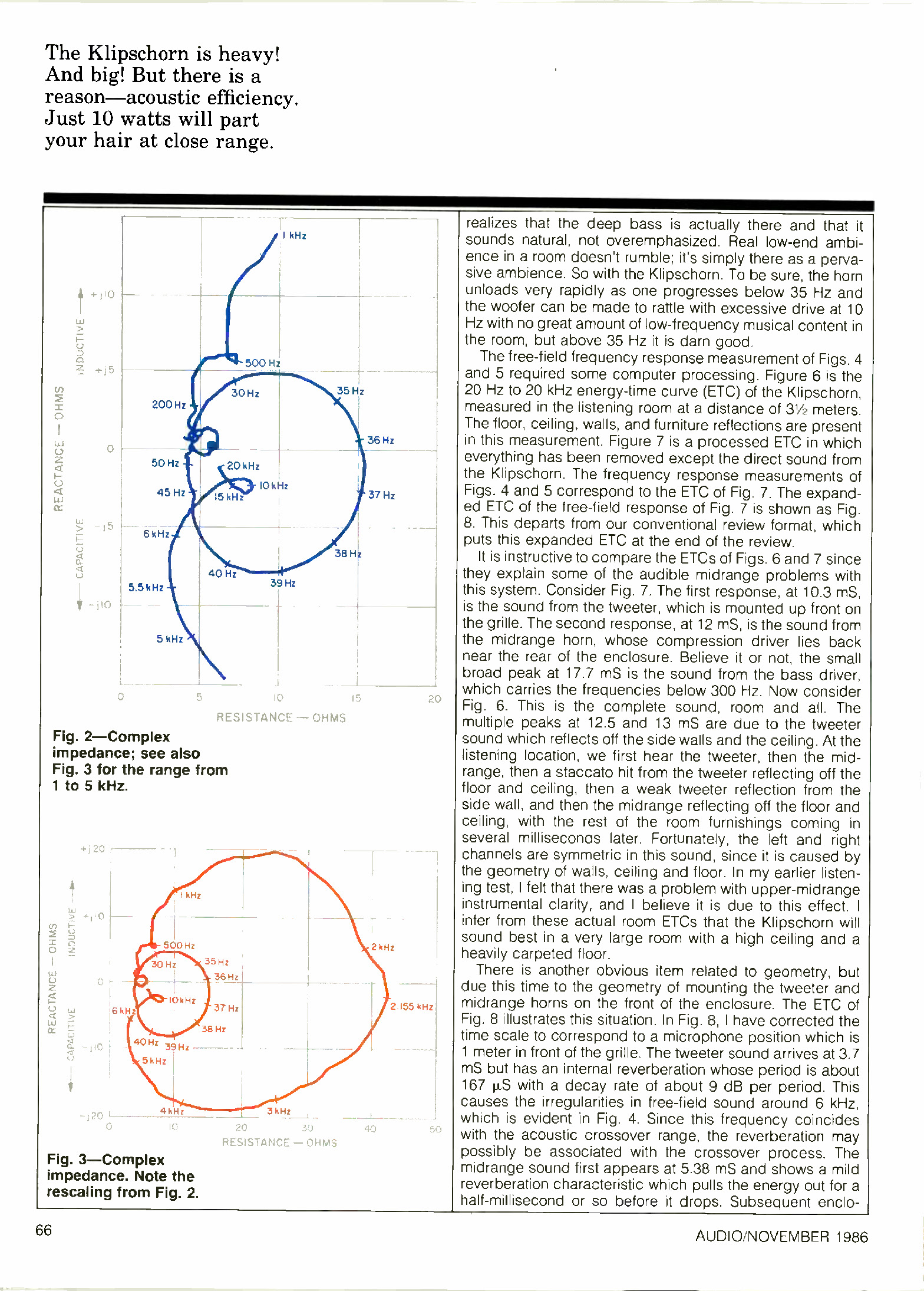

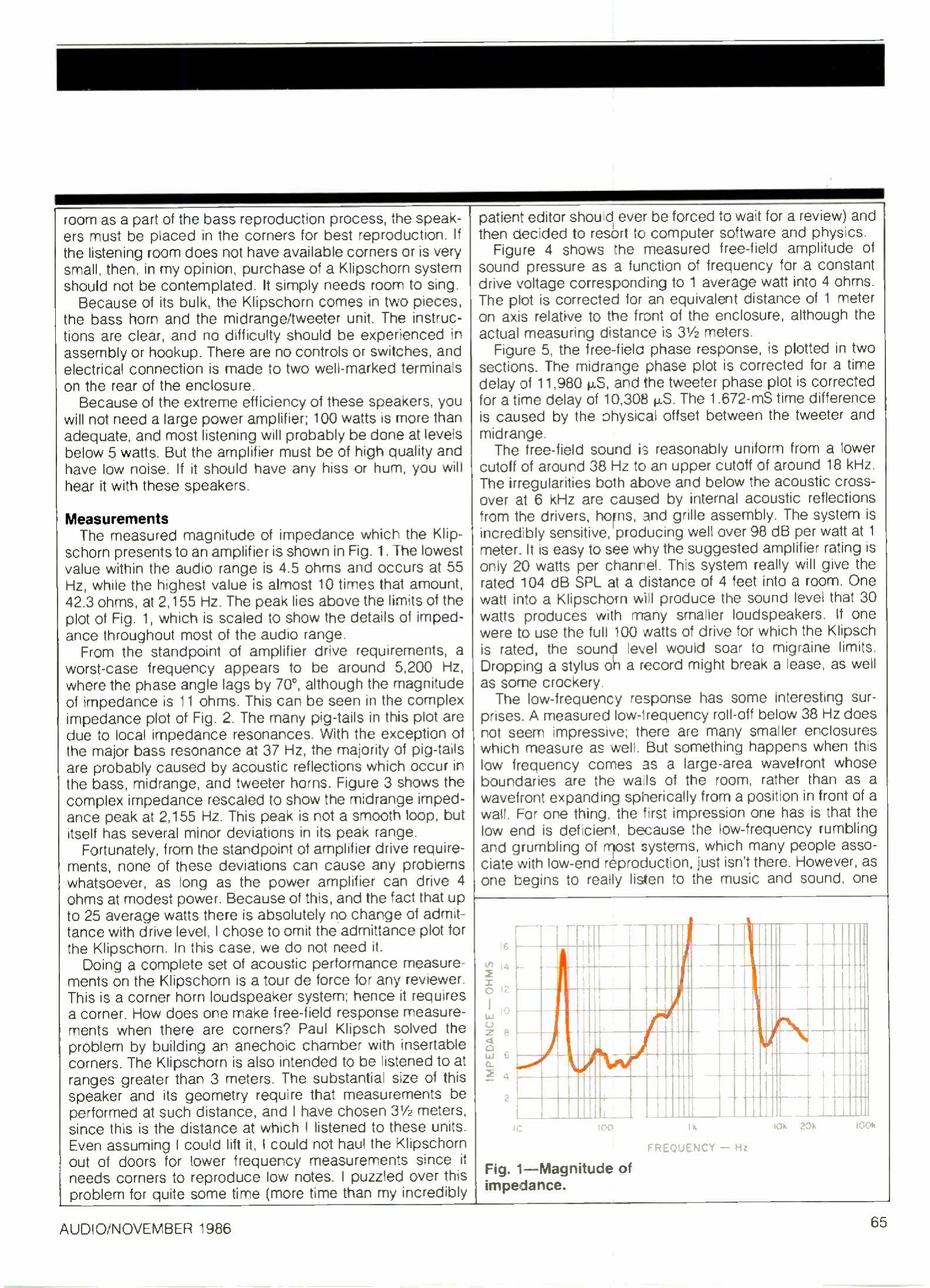

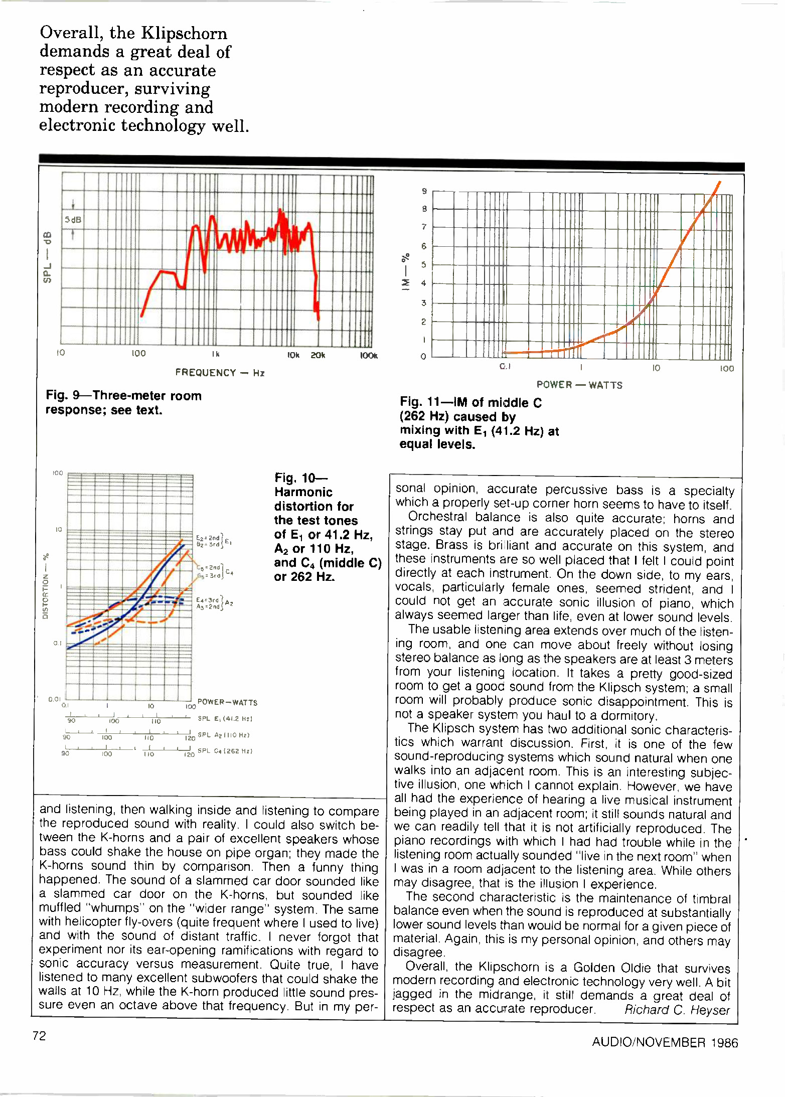

The great (late) Richard C. Heyser found the Klipschhorn to be capable of creating such illusions, despite its shortcomings.
