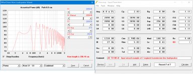

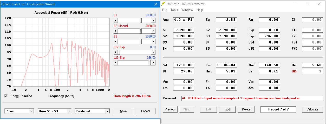

I played with hornresp for the last hour or so, I can't make it do what I think it should, the numbers looked right, my driver fs was lower than I wanted it to say, as reported by AE, but more importantly when I ran acoustical power it was a very rippled line....I tried creating a straight transmission line that was 1/4th of 29hz. I can tell something is wrong because when I run sim, signal is only emitting into the tl instead of coming out of both sides, which is probably where the rest of my output is....I can't get it to chose a driver diameter size...I wonder if there is more straight forward software somewhere.

??? 'Sounds' like you might be trying to design a single driver horn from the Input Wizard, not the Wizard I was referring to.
You have to either load the driver you want or you can highlight a specific spec and type a new one in and it recalculates everything. Double clicking on the [Sd] field pops up a T/S specs input window.
Or just [Save] it and export it to here, so we can load/review/correct it.
If there's easier and accurate for what all it does, I'm not aware of it. Of course using the HELP File is normally required as it's now got way more features/options than it was designed for, so not very intuitive initially [or ever in my case 🙁].

I need to experiment with HR, I used the wizard to create a transmission line and one side is always closed.

Hmm, do you mean one end of the TL is closed? It should be. Otherwise still no clue what the problem is.

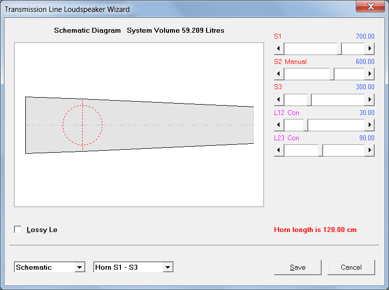

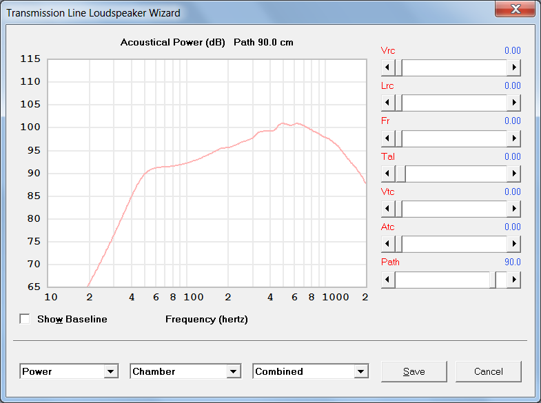

Attachment 1 shows the schematic diagram for a simple transmission line loudspeaker designed using the Input Wizard. The dotted red circle shows the offset driver. The rear side of the diaphragm faces into the transmission line, and the front side radiates directly.

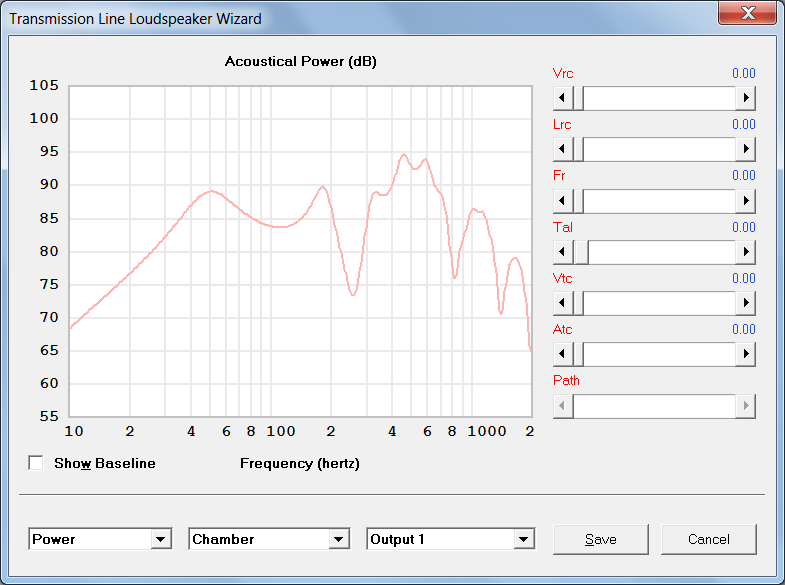

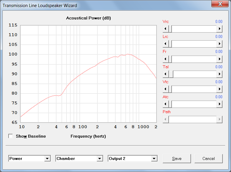

Attachment 2 shows the combined power response. Attachment 3 shows the output from the transmission line only (Output 1) and Attachment 4 shows the output from the front direct radiating side of the driver only (Output 2).
If you run a wavefront sim of that I bet the left side is closed...the waves bounce off of the wall and return to the driver. How can it show you a true combined response without the output of the front of the driver actually leaving the cabinet? Depending on how close to that wall i bet the response changes. I'm probably not understanding something but, thats what I see.
