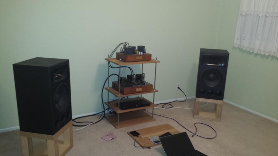

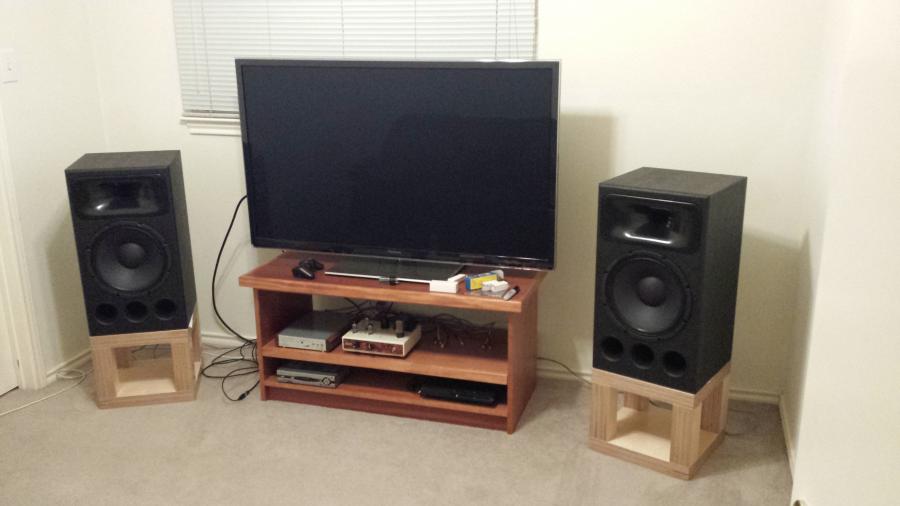

In an effort to find some mixed reviews of the Tempests, I found a reference to a negative review on Audiokarma. I read the whole thread and it’s pretty clear the individual in question would have struggled with any constant-directivity waveguide loudspeaker, let alone the Tempest. Attached are photos off his initial setup and then the properly toed-in setup where everything clicked for him.

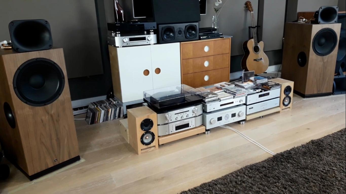

The 12" 2-way concept is a rare thing, but still appreciated by some.
