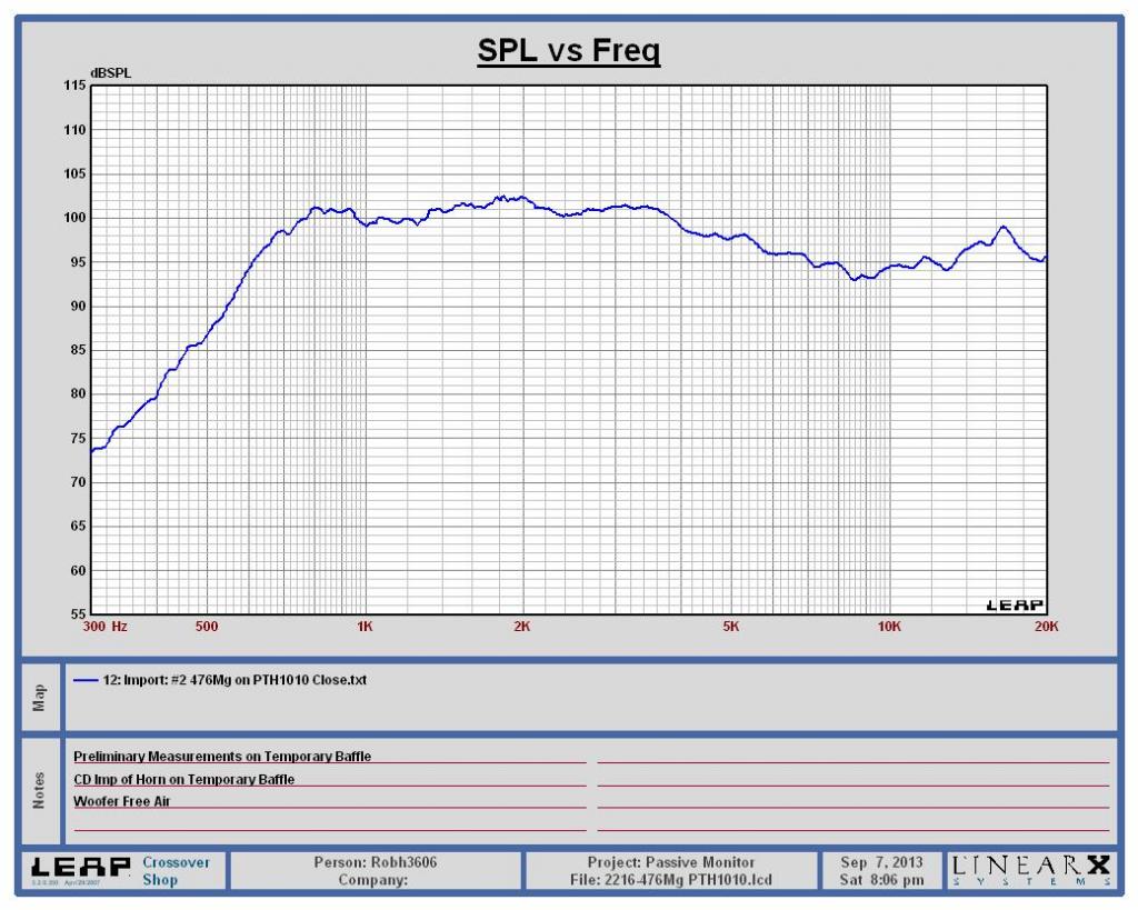

Well it depends on the driver. I know I was surprised when I measured one with a large 4" format compression driver. With the smaller 3" I can see why 1k would be the limit but you can get them a bit lower with the bigger driver. Here are a couple of measurements so you can see what I mean. I have the older PTH1010 with the throat pinches.

Yup, horn i have is the throat pinched pth 100x100.
Dispersion is flatter to 8khz up and down looking at di plots.
https://www.google.com/url?sa=t&sou...FjAAegQIBRAB&usg=AOvVaw2IkfilKFQ1aPLXpBTV_0SZ
Dualtriode has z graphs of the newer pth horn ($63).
4.3" deep, you see a zhump at 1,600.
Rule of thumb would need 1/2 wavelength for smoothish treble, so 1,200hz crossed, maybe 5.64" deep.
But I'm fuzzy on horn zpeaks.
Dualtriode crosses it at 2khz.
In the newer pt horn line is the jbl am5212/00 or am7212/00.
Ain't cheap, and spec'd 1600hz.
A bit high for my likes for a 12" (dispersion and detail).
But pretty consistent dspersion plot.
