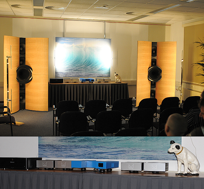

I really like the look of this but how effective are large curved guides on efficiency, whats the design philosophy surrounding them.
Slots defract ...
… air columns resonate. WHG
How strong is resonance of a slot? There is a new acoustical solution - 3D printed metamaterial.
A waveguide of that size will for sure have an influence on efficiency. But the horn loading effect will not extend very low.
The mid-high waveguide is a "castrated" xt1464.
Regards
Charles
