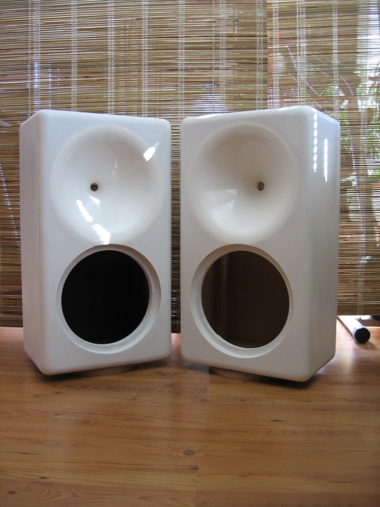

A diy project built around one of Marcel's (mabat) STH (now ATH4) waveguides.
Drivers: B&C DE250 + SICA 12SR3PL.

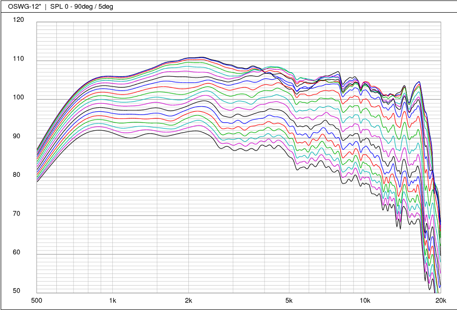

These look like excellent designs. Add a foam plug to the waveguide and you have a Summa (circa 2002) - same excellent polar response. Well more like the Abbey since the woofer is 12" not 15". I don't like the way the compression driver is mounted however.
Want to know what waveguide is "optimum" you can see it here. I can't speak to the details of the waveguide since I don't have a detailed drawing of it, but I would not have made it approach square and I suspect the small aberrations around 8 kHz are due to this change, but it could be a non precise throat.

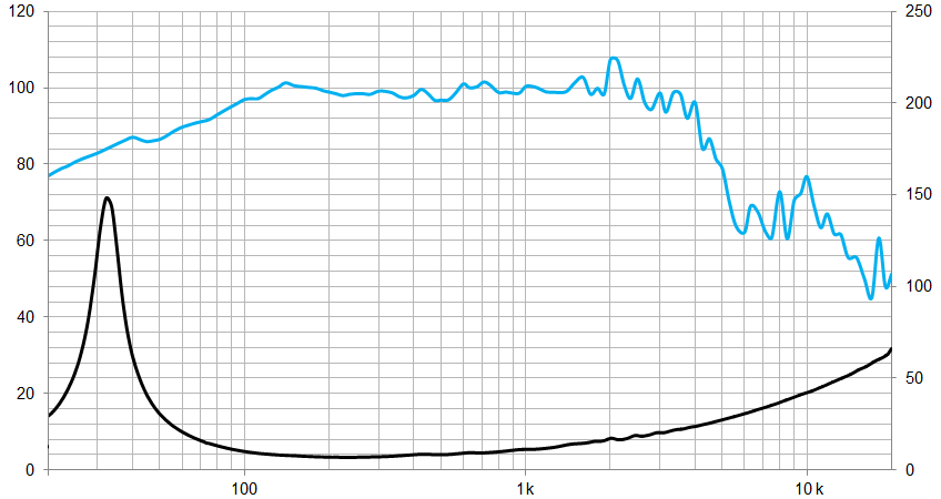

I would like to ask an opinion regarding the woofer of this two-way project. I found the BEYMA 15p80FeN or 15p80Nd and I saw that theoretically they should be valid candidates, someone describes them with a precise and powerful sound ... unfortunately I have no experience on them, I would ask if someone used them to report their experience , in particular 15p80feN. Thank you in advance, renewing greetings.
Mleod
The peaks at 2kHz may be hard to tame unless you cross fairly low. In a two-way system, how the woofer handles these breakups is all important.

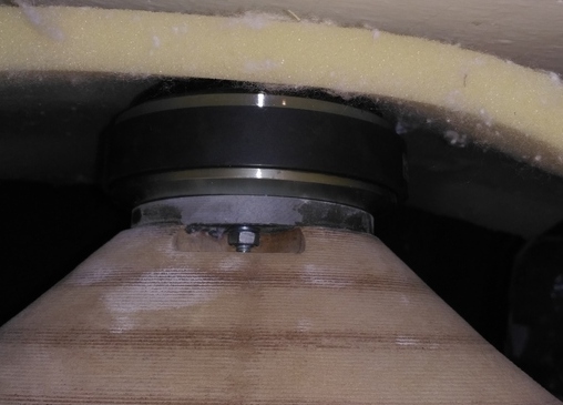

What's wrong with it?... I don't like the way the compression driver is mounted however.
I don't know, I have measured a very similar behaviour on my old (round) 12" OSWGs - also using DE250, different pieces. I would almost believe it is the driver because the waveguides were done so differently.... but I would not have made it approach square and I suspect the small aberrations around 8 kHz are due to this change, but it could be a non precise throat.
Or what do you mean by "non precise throat"?

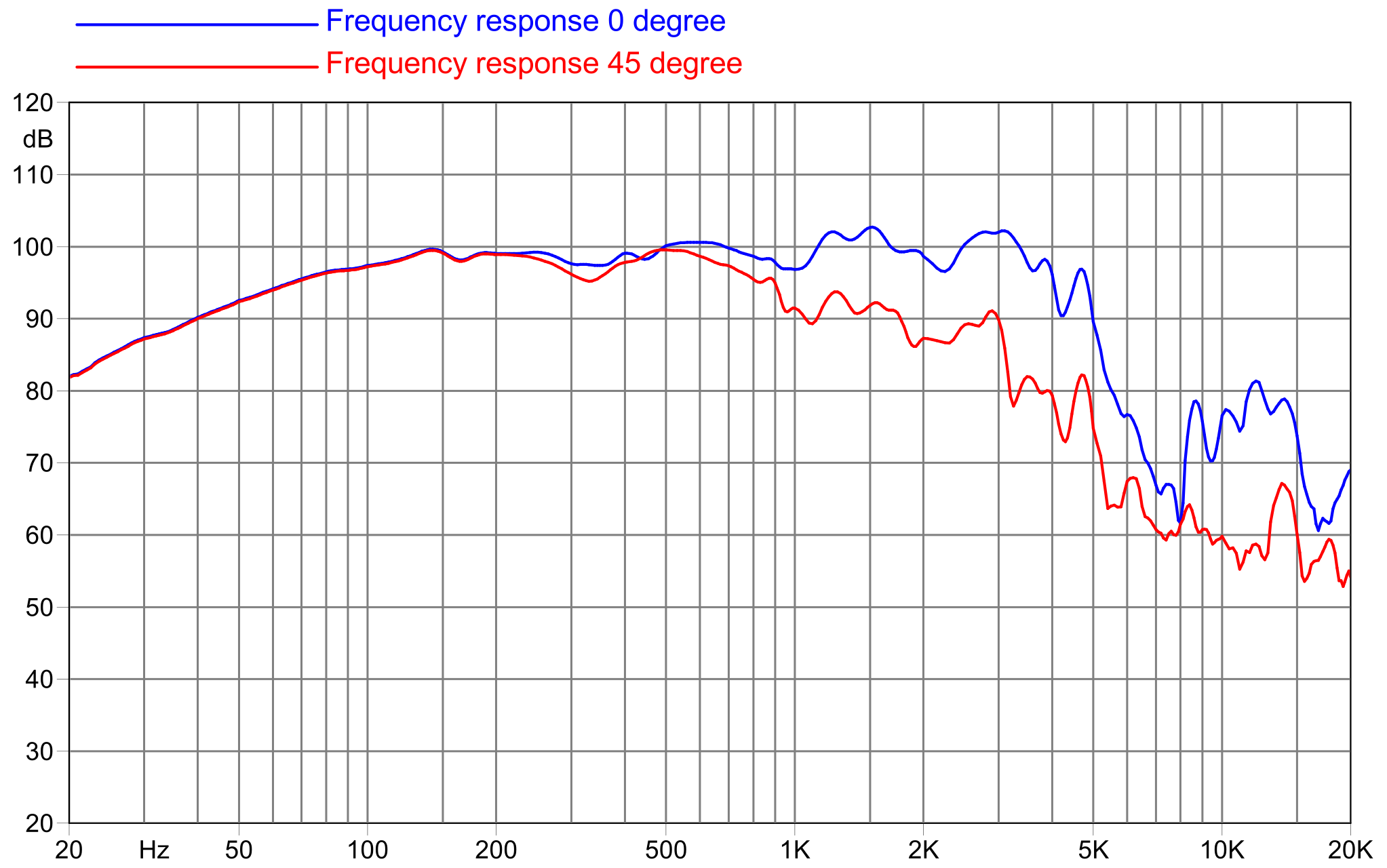

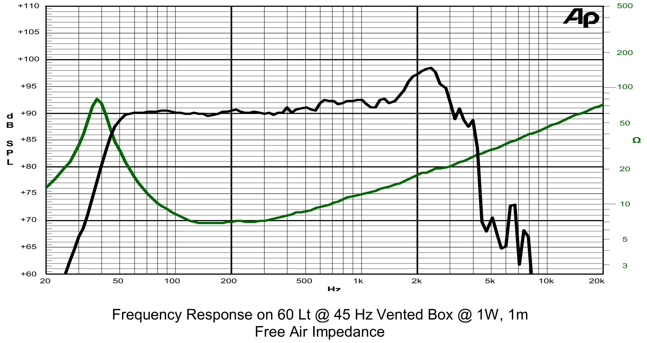

From left to right:
1. Sica 12SR3PL, used for the 2 way with mabat's waveguide crossed at 1100Hz.
2. Beyma 15P80Fe/N.
Conclusion: perfect for a 2 way with XO below 1000Hz.
3. Tip: Beyma CP380/M, top class 1" driver.
4. For comparison: FaitalPRO 15PR400, a favorite among many contributors to this thread.
This looks better than the other photo, but it still concerns me. Is the waveguide shape carried through the mounting plate?
Even a few mm of error at the interface between the driver and the waveguide will cause this kind of problem. I would need to see precise details of this juncture and that it is maintained in production.
I did not see this level of aberration in my DE250's, so I doubt that it is the driver. It really looks like a mounting issue to me.

Of course it is. It is milled as a one piece - the plate is glued to the WG body. In fact it should be quite precise all the way through (CNC).This looks better than the other photo, but it still concerns me. Is the waveguide shape carried through the mounting plate?

The evidences that you have proposed to me are very clear, however the 15p80FeN seems to have an almost double efficiency compared to the 15PR400, I don't know exactly what this involves in the sound, I suppose a more speed and greater damping for which I would be oriented towards the Beyma .... what do you think about it ...

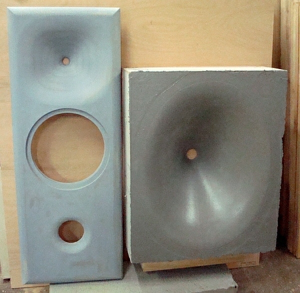

Some more pictures I just must share...
(18" woofer + 20" OSWG on the left.)
Very nice! Any more info?
Mitch
I had ideas about making a large waveguide and an 18" woofer (required for DI matching at the lower x-over), but the market for something that big would have been negligible. Premium performance is just not a real market want. Compromise, compromise, compromise, as long as it is small, looks "cool" and doesn't cost much. Not very appealing for people like us.

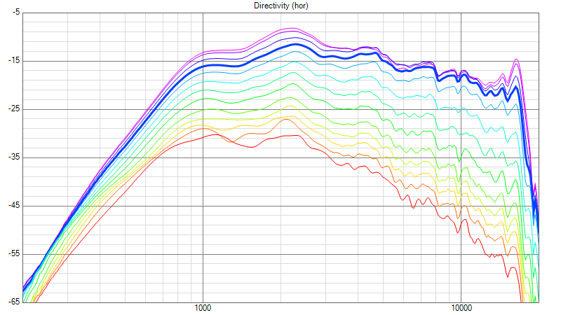

Do you see interface problem above 8KHz here?
Not enough detail, but yes, since the problems are not diffraction (lines are vertical not curved) my first suspicion would be a poor waveguide somewhere along its length.
If that plot is normalized then all bets are off since normalization ruins the picture.
Also, since it is a coax, that problem could also be due to the transition between the two. This is precisely why I never like coaxes. This always occurs.
