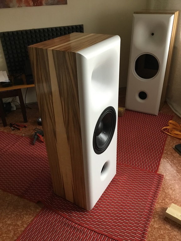

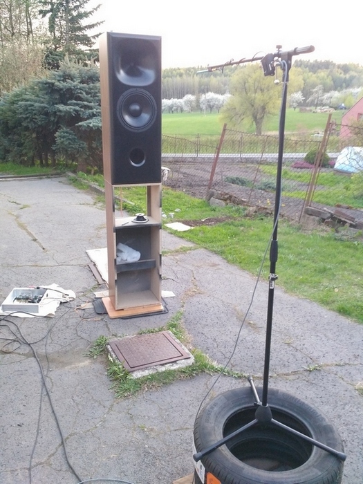

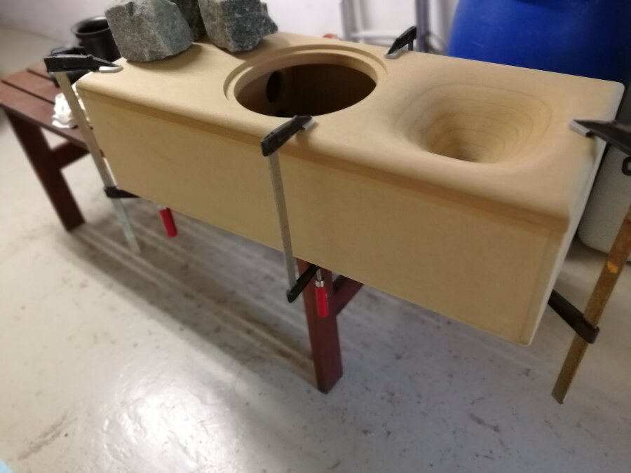

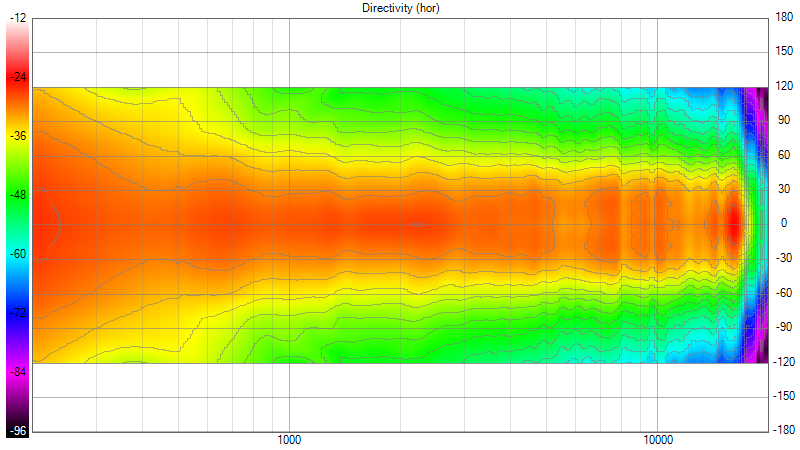

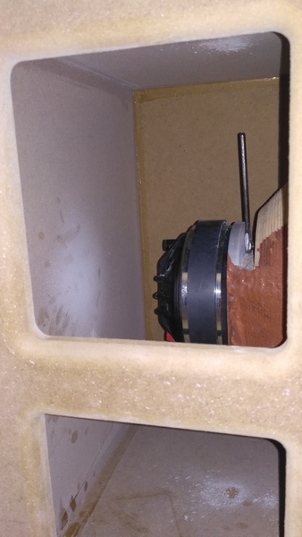

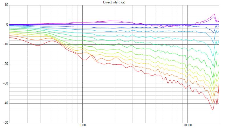

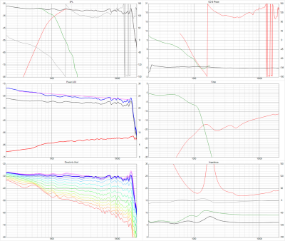

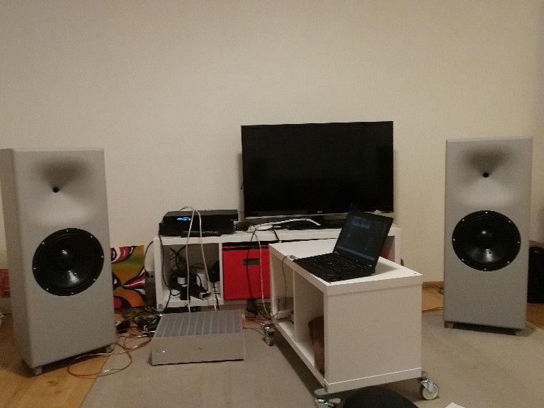

A diy project built around one of Marcel's (mabat) STH (now ATH4) waveguides.
Drivers: B&C DE250 + SICA 12SR3PL.

Very nice polar/directivity response! At what XO frequency?
Thanks.

That SICA Woofer seems to work well in two-way configurations despite being specified as subwoofer.
It would be interesting for a 12" MTM with a 1.4" + horn.
Regards
Charles
Yes, that's a very nice project by a guy who is an acquaintance of mine. Crossover is just above 1 kHz as can be seen from the pictures shown. What's even more attractive is the price - for the parts cost it's only about 1300 EUR (~ $1500?) for a pair including the baffles with waveguides milled in. Really nice and still not so big speakers.
The question is whether this loudspeaker qualifies for the criteria from the thread title. I would say "yes", but it depends... 🙂
I'd use at least two woofers and then it would be good for around 122 dB / 1m at an Xmax of +-7mm. I.e. with +-3mm (which is the maximum at which I would use a midwoofer of a two-way for critical listening) around 115 dB.
