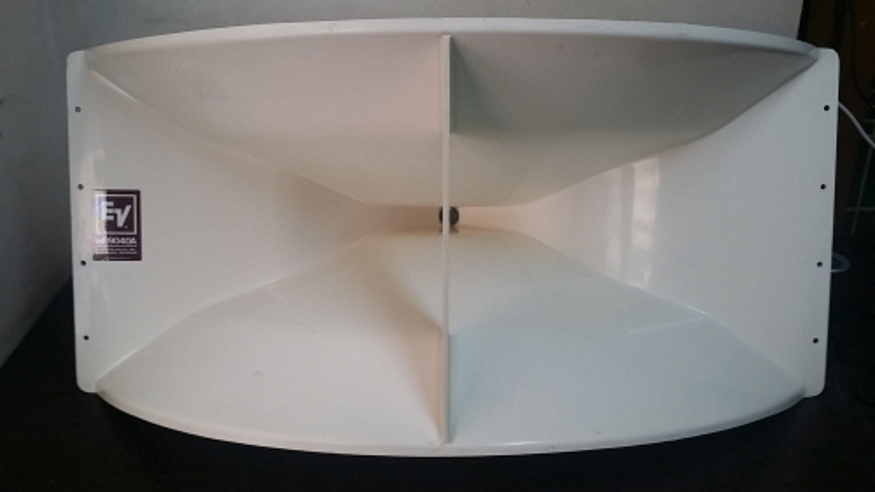

Originally Posted by barossi
What about Mr Don Keele's electro voice horns like HR 6040A or the famous HR 9040A?
Originally Posted by Ro808
These represent the acme of CD horn design IMHO.
What do you mean by "acme"? To me we have moved way past those older designs.

"Modern constant directivity horn design started with the work of D. B. (Don) Keele, Jr., John Gilliom, and Ray Newman at Electrovoice in the middle of the 1970s. Their work introduced the features that are the central methods for controlling directivity in all current horn design.
Their first design idea was a contraction in the throat immediately following the driver. This detail is emphasized in the White horn series they designed; however, the idea predates this horn (Keele, 1983). The narrow throat allowed the use of a larger driver and improved the directional control by letting the sound illuminate the sides of the horn, without the high-frequency beaming usually associated with larger throat sizes.
The second feature was a conical-exponential (CE) throat shape, which consisted of an exponential throat over a certain distance, after which there was a smooth transition into a conical (straight-sided) shape. The combination of these two curves allowed the control of low-frequency impedance by the use of the quasi-exponential throat expansion, and still maintained excellent directional coverage afforded by the conical shape of the sides.
The third step the group took was to address the problem of mid-range narrowing, present in most horns before this design. Their approach was to flare the mouth of the horn at a point, which was about two-thirds the distance from the beginning of the conical section to the mouth. The flare was added at an angle, which was about twice the angle of the original conical section. The added flare resulted in the high frequencies seeing one mouth size and the lower frequencies seeing another. The flare also allowed the transition between the horn mouth and the surrounding air to be less abrupt. The sound pressure distribution across the mouth of the horn was no longer constant but was higher in the center of the horn. The horn mouth no longer looked like a pure piston in a baffle and as a result the frequency narrowing problems (predicted by the piston model) that were associated with previous designs were no longer present.
The White horn series was highly successful. The design gave good horizontal directivity control without the mid-frequency beaming that had been associated with most previous horns. The vertical frequency control was not emphasized in the design in favor of a smaller vertical dimension. This shows the design tradeoff that is made between horn mouth height and the capability of controlling the vertical directivity over a wide range of frequencies. Because the vertical dimension of the mouth is relatively small, the frequency at which the vertical control begins is rather high—1.2 kHz. The White horn series was the first commercial product to be a true constant-directivity type."

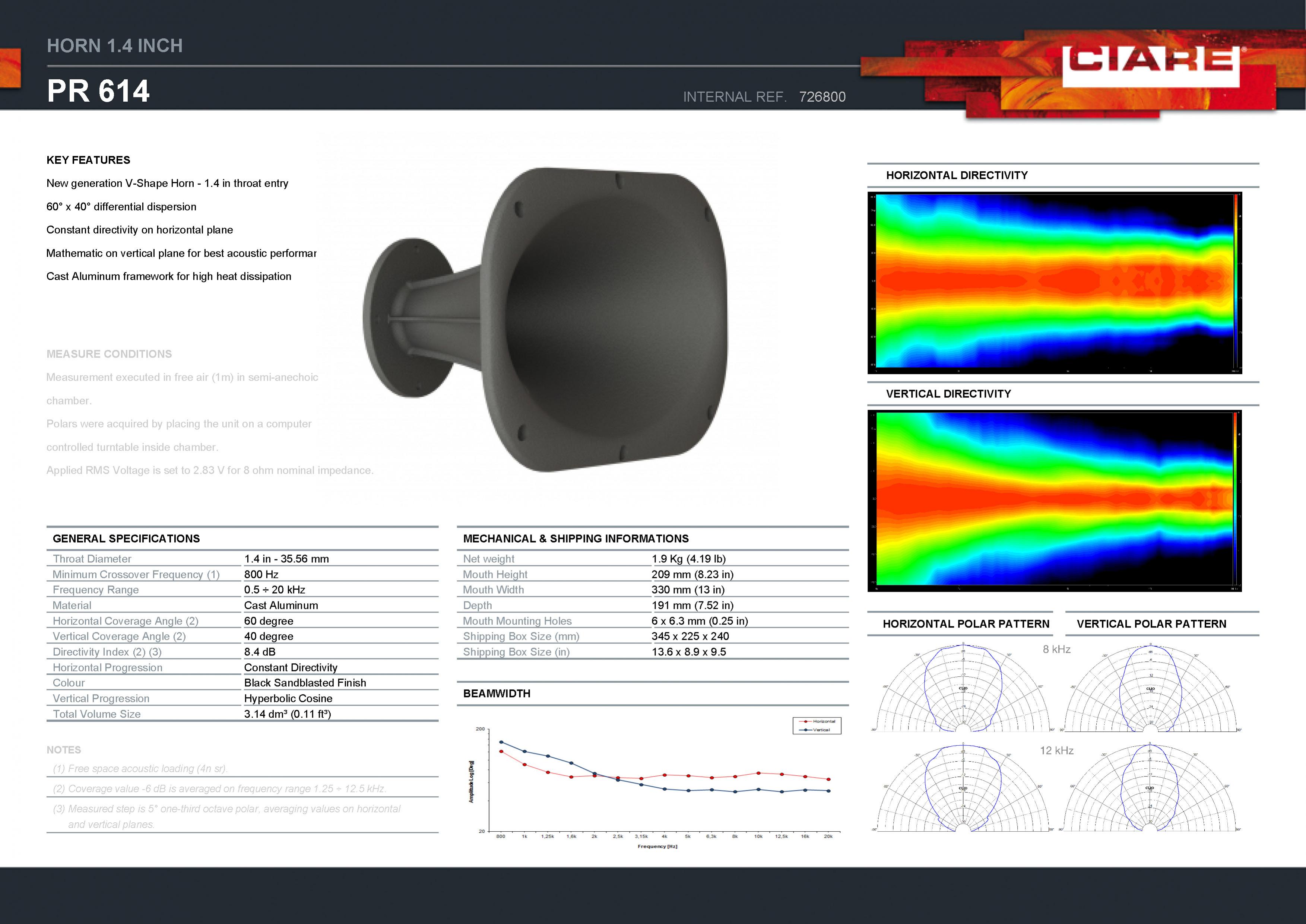

So what is the ultimate 'modern' designed horn to use for a 'big' 2-way setup (ie. to pair with 1x or 2x 15" bass drivers running upto 500-800hz)?

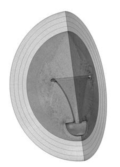

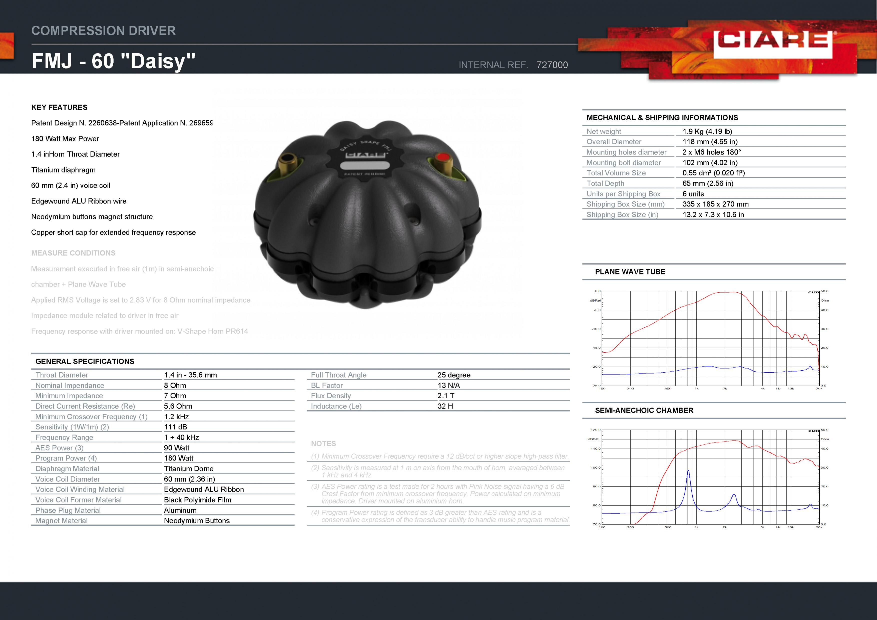

If you shop smart, the driver + horn shown in the pressure propagation .gif can be had for a just over €100, instead of > €350.
These were developed by a guy who also co-designed drivers and horns for FaitalPro and 18Sound.
Therefore, I expect the LTH142 and XT1464 would also work well with this driver.
The mesh that was used for the sims + specsheets:
There's no such thing as 'ultimate' or 'one size fits all' in audio 😉
It depends on your objectives/preferences, room, cabinet, compression driver etc. and budget vs ability to DIY.
If you want my opinion:

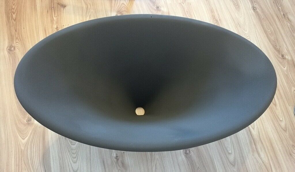

- For 800Hz, I would consider a (OS) waveguide
- For 500Hz, I would gravitate toward the (prototype) horns that jzagaya posted.

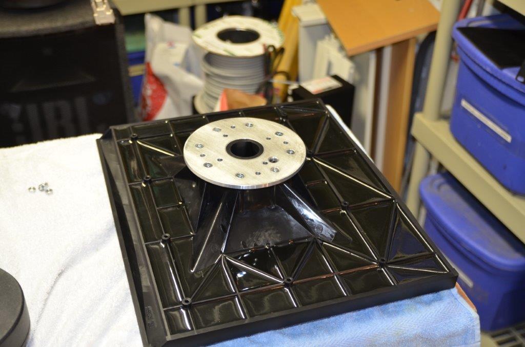

Yes, I would like to know too... The design I have now (JBL 2384 waveguide and 2453H-SL 4" large format driver with 1.5" exit) is from 2008 that sits on top of stacked 15" woofer crossed at 630 Hz. Sounds pretty good on and off axis as a constant directivity waveguide and I have posted the frequency response before.
But, as I say, that is from 2008, over 10 years ago. Aside from the KPT-402-HF, which is somewhat ubobtanium, I can't seem to find anything better. What do I mean better? Like you say, proper loading to down to 500/600 Hz, suitable for a 1.4 or 1.5" exit CD that can go that low, and extend to near 20 kHz. A constant directivity design (no "head in vice" please) with near perfect on and off axis response. And maybe a bit wider pattern than 90 x 50. The M2 waveguide appears to be a contender at 120 x 110 pattern, but seems to struggle below 1 kHz, both in pattern control and rising distortion, even though it is crossed at 800 Hz... No sure if that is the limitation of the 3" D2430K CD or waveguide or both?

jzagaja has also developed this monster OS waveguide that would work from about 600Hz.
To me, ultimate horn speaker system is modern/vintage sound mode switchable for new/old recordings, and I'm still collecting units for it. More than 2/3 of the vintage horn units I got from Ebay are very off spec or broken. 🙁
Thanks, but I can't find any info on the device or if it is available separately from the system images posted.

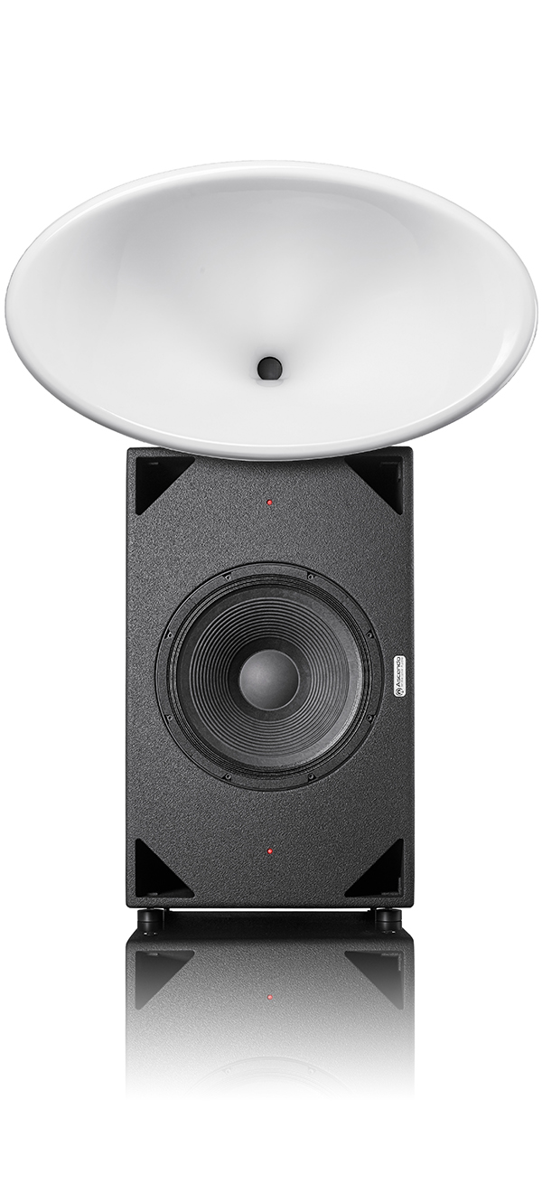

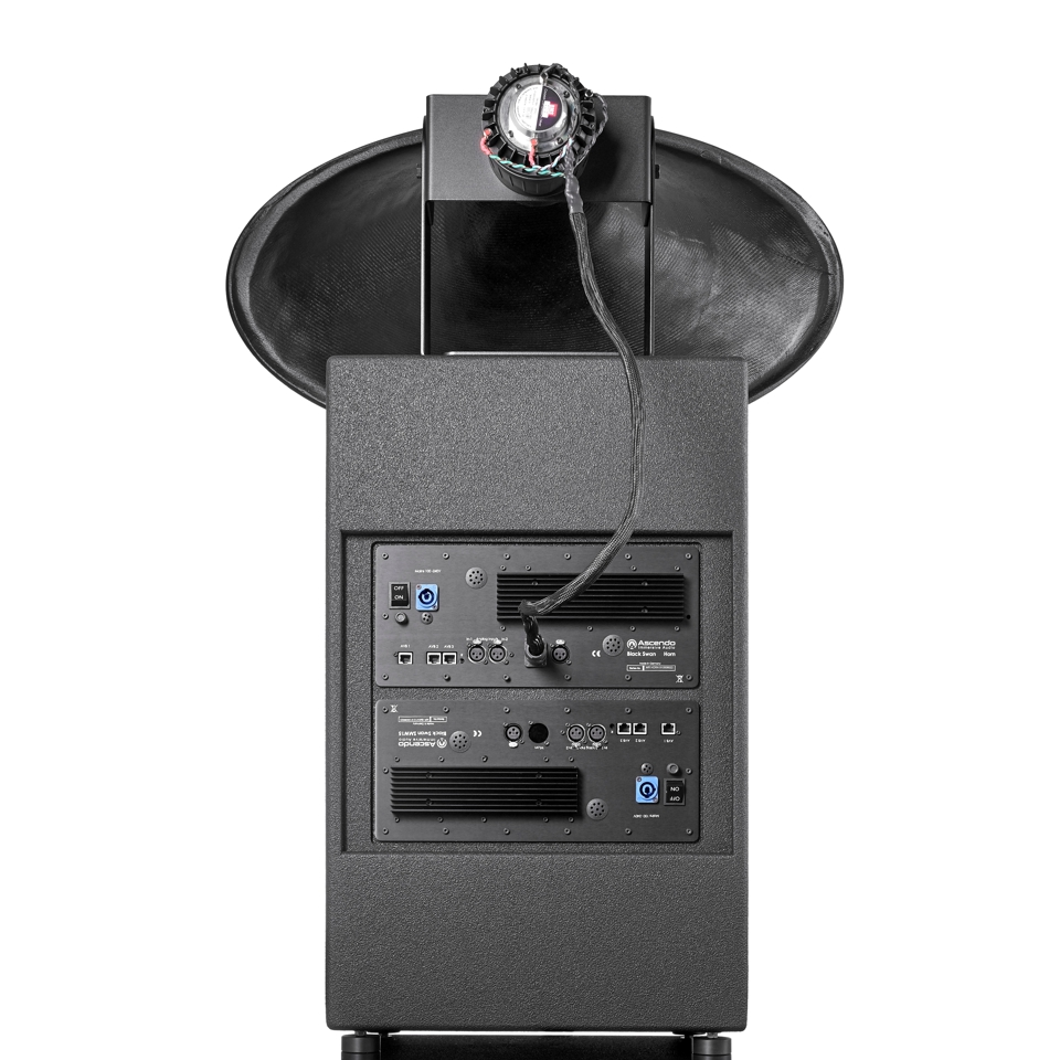

camplo, you might want to reconsider modular cabs similar to the 'Beyond the Ariel' system that was discussed many pages ago.
That'll make experimenting with different setups a piece of cake.
The downside: no 10.5 ft3 cabs 😀
BTW, the Black Swan cabs are also modular as shown in the pics.
