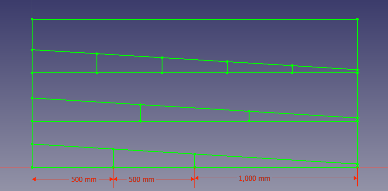

Hello all

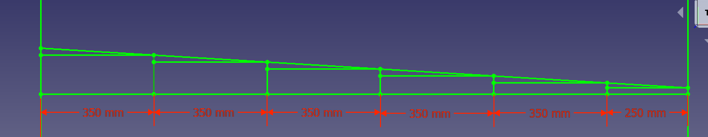

Please check if I am getting this. In this table representing stepped pipes, the lowest is "thingy" (until there is consensus on whether it's a BR or TL), its pipe lengths are too long, and the problem is pipe resonances. Is this correct, or are there other issues that I am missing?
Are the other two pipes on the table identical to thingy?
If yes, will using the top most pipe with 5 stepped segments fix the resonance issue?
Does the 2m long total pipe have its own pipe resonance problem that can't be fixed by chopping it up?
If Thingy is a BR, using PR will eliminate pipe resonance in a port, as there is no longer a port. Does the remaining driver volume also have pipe resonance? Or is that problem sorted using either the PR or 5 segment TL?
Does this summarise this thread so far?

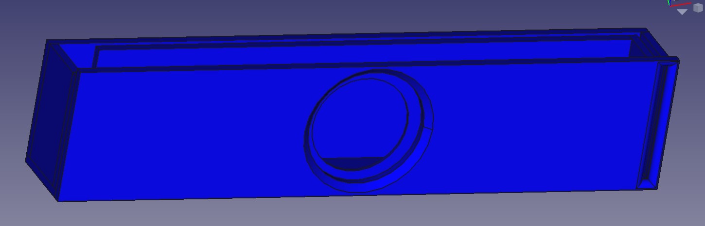

Enough distractions with the steps. Back to the Thing. We have worked out that the shelf needs to be rebuilt as a desk with a slide out keyboard rest and slide out drawer for fine tools as well as small tool storage. This means that shelf width limit is 900mm and depth is 300mm and height is 320mm. The only thing limiting height is visual access to the very large monitor in the bedroom through a glass window. Very apt for the distant monitor thread. I'll update pics in my DIY Grooveshop thread for the desk
Here is the Thing redone to 900mm width. The design is apparently all the worst that can be put together:

Box aspect ratio and the length of the port as well as the volumes make it look and model like a bad 2 stepped segments TL. Hornresp file attached
Bad frequency response in HR
Inefficient driver
Pipe resonances
Chuffing
Am I missing anything? On the positive side:

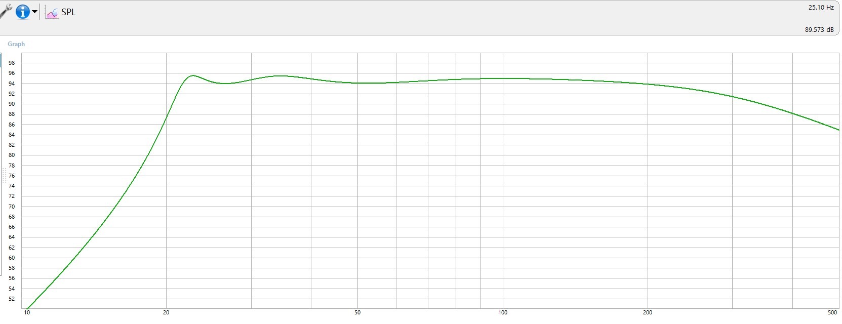

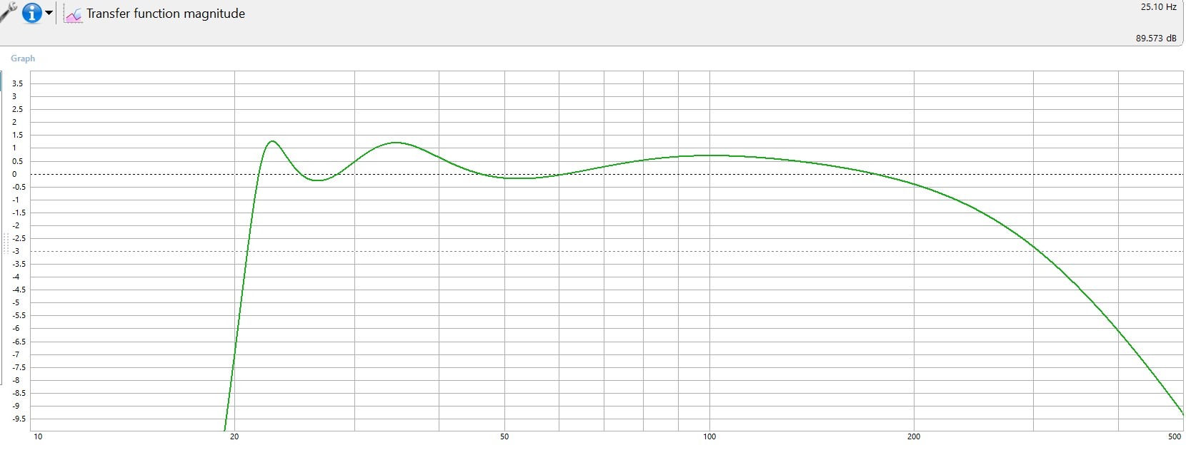

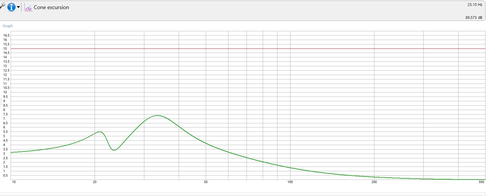

Winisd frequency response looks awesome with some EQ down to 20hz. File attached
Guys, please help me learn this a bit with a commentary on the Winisd graphs. To me, they look good but I really am not qualified to claim that. This is with 10db boost at 30hz. What is Winisd saying about this, can the driver take that boost? Is the amp power enough to apply that boost?

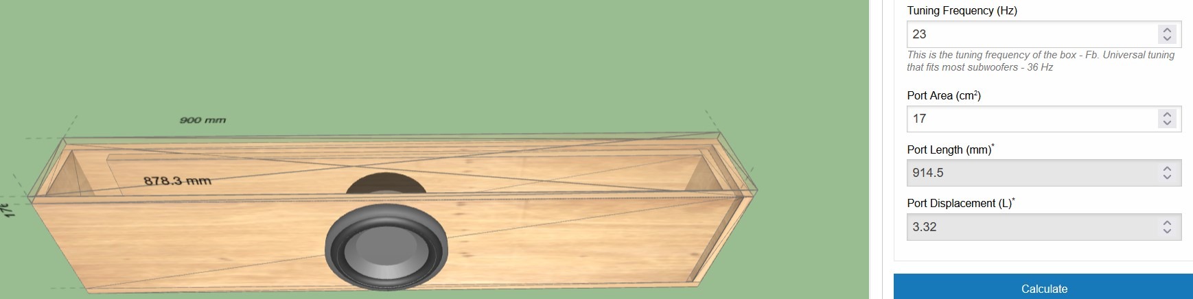

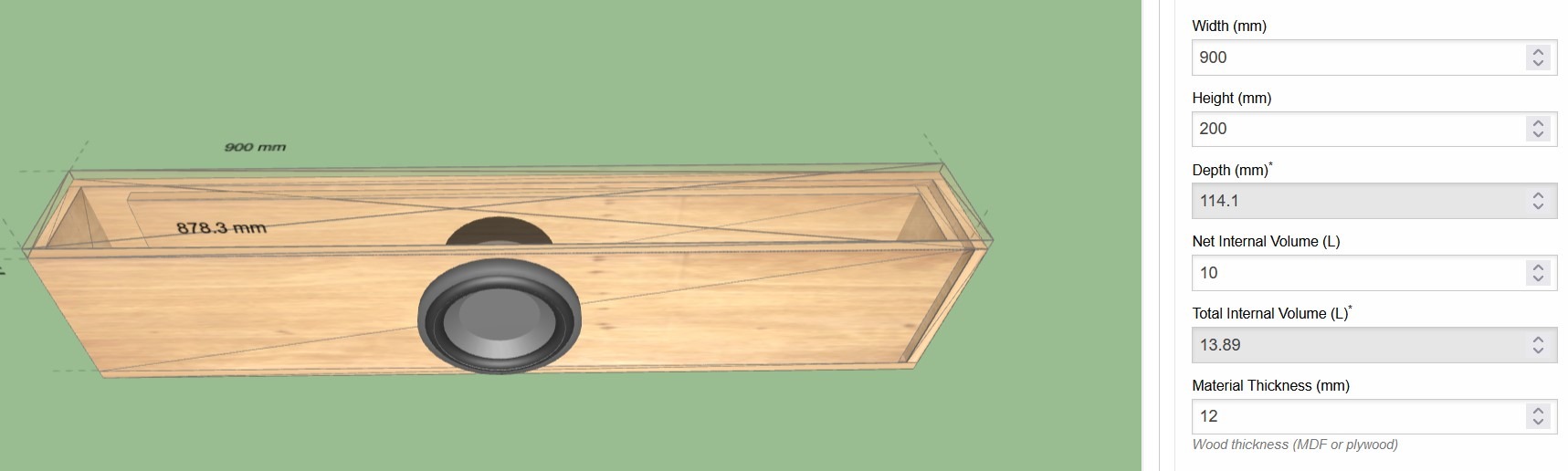

This is the Thing as laid out by an online calculator to available shelf area and Winisd
Ready to be cut in MDF. To avoid too much work and keep it to the calculators dimensions, I am keeping it plain. The plan is to give it a look based on sharp, clean edges. Veneered in real birch with some printed trims and an ebony front panel

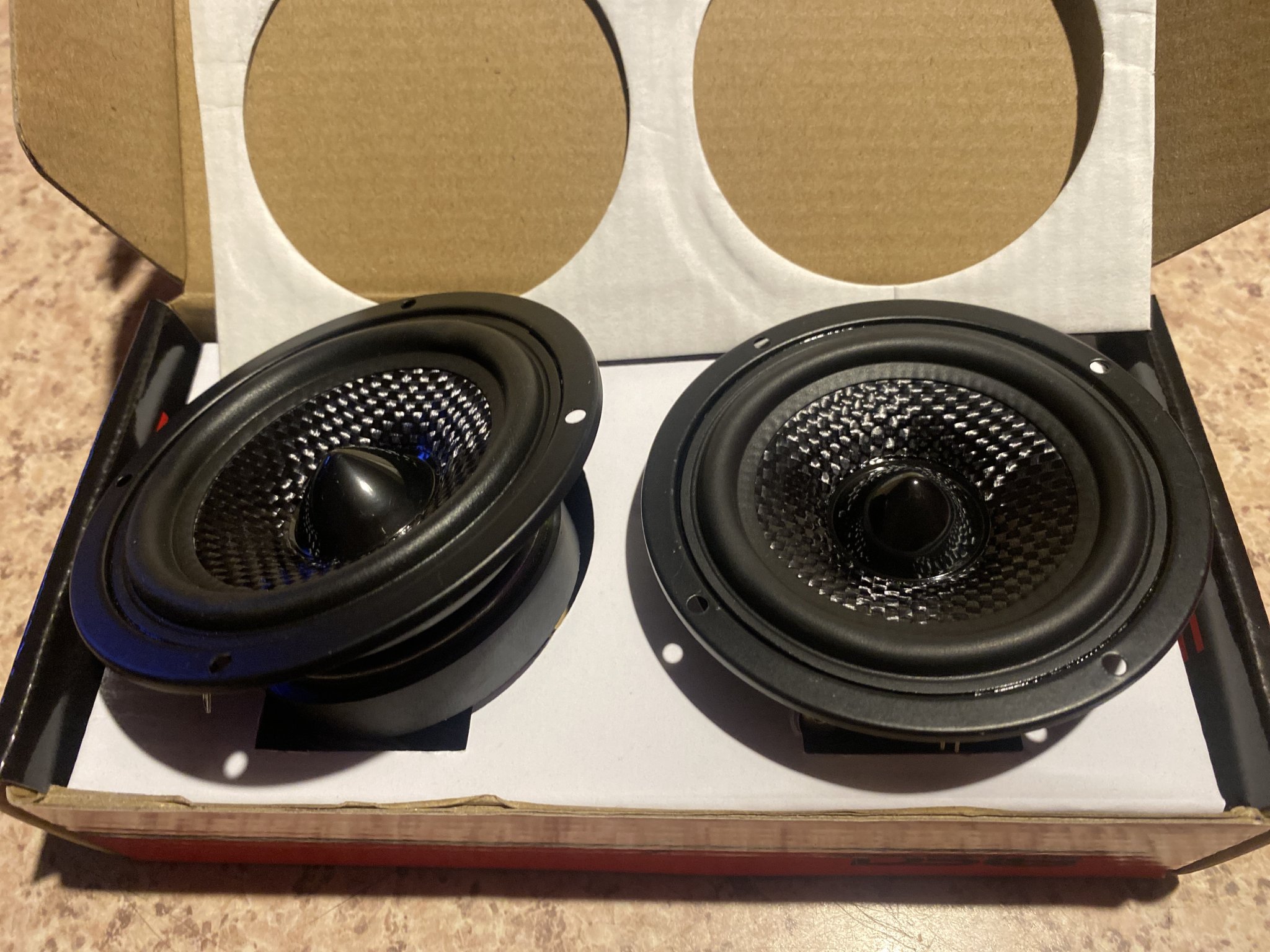

I hope Erica.C's 150wrms+150wrms FFA001 amp module is not too much amp for them as they only have a 40wrms rating. The sub driver is DVC and the amp for it is the FFA002 with 300wrms+300wrms
Only the sub driver and another set of FR drivers are left to arrive. All the MDF, biax fibreglass, epoxy, fumed silica, real wood veneers and finish I keep on hand

The FR drivers on the other hand, I have prior experience with them, and they are sweet and easy to listen to at moderate volumes and really composed when pushed hard. The sound is similar to low efficiency bookshelf speakers from UK. The driver in question is the ZXI-354 and since they are directed at sound quality competition tuners, they come with full specs unlike usual car drivers

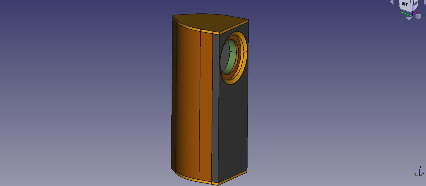

The cab (Cub) that I designed for foam sandwich is sealed, but the design is flexible and based on my universal template. The height can adjust up or down even after initial assembly, thereby changing the internal volume. It can be turned in a ported or TL, again even after assembly. Any similar or smaller drivers can be fitted using a printed adaptor to fit the designed driver cutout. The FreeCAD file can be used to print, CNC or hand cut the materials. The complete can also be printed to various degrees. All the resources to this and more are in the files
I am making both FreeCAD files available via PM to the forum in appreciation of all the help getting here and enabling me to go further. Support for these CAD files and the build process will be in a build thread once it's been determined if such an animal is worth creating. To be honest, I don't yet have what it takes to make that call and relying on further guidance here

I would really appreciate some help in interpreting what Winisd is saying in the file that I attached. Thanks guys
Re your WinISD model, a couple of sweeping generalisations:
1: Those are really unusual parameters for any driver - though I can see at least one typo already (Cms simply can't be that high). Are you absolutely sure the rest are all correct? Please post a copy of the datasheet for verification. Also, when inputting parameters, it's best to follow the recommended order of input in the HelpFile to make the model as accurate as possible.
2: Assuming the TS parameters are all correct, you are reeeeeaaallly stretching that driver way beyond what it seems optimised to do. In general, tuning a little bit below Fs isn't normally a massive problem, but here you're trying to stretch over an octave below - that's just too optimistic IMO. Choose a more suitable driver if you're serious about getting any remotely useful output that low.
2a: as a consequence of the above, your underlying, unprocessed response has a significant peak (around 5dB relative to the minimum in-band level) around tuning. That is likely to have audible consequences even when EQ'd. This Thread shows how responses that have more peaking also have more "ringing" or overhang of the output relative to the input, which is a large part of why many people characterise responses that rely on this kind of resonance as "slow" or muddy sounding.
3: Unfortunately, WinISD doesn't update the "driver input power" fields on the Signal tab to take account of the filters. This means that while you thought you were modelling at 600W input, you're actually modelling the response at 600W PLUS the 10dB of gain from your EQ (again, assuming correct TSPs to start with). That means you're effectively modelling at 6000W, which will certainly not be practical. Realistically, this driver just can't be made to do what you're trying to do. Again, choose a driver that's more suitable for your actual goals rather than trying to stretch this one so far from what it's optimised for.
HTH,
David.

OK, and another thing, I just opened your HornResp record to see if the driver parameters there made any more sense, and several are completely different - eg BL is twice the value, Mmd is higher than the Mms in WinISD (it should be the other way round), Le is obviously another huge typo of some kind. On the model side you've also input L34 in mm instead of cm.
The thing is you've got to make sure you're actually modelling with the right data otherwise the modelling, and all the help people are trying to give you, is wasted.
So, please take this as a reinforcement of my earlier request for the Datasheet for the driver?
D.
Edit PS - just so I don't sound too bitchy, there is a potential upside to finding out the parameters might be wrong - if I cherry pick the ones that seem to go together best, the driver is quite a bit more efficient than in your 1st WinISD model, so might be able to get up to 8dB louder while staying at about 600W, instead of "needing" 10x that amount of power.
