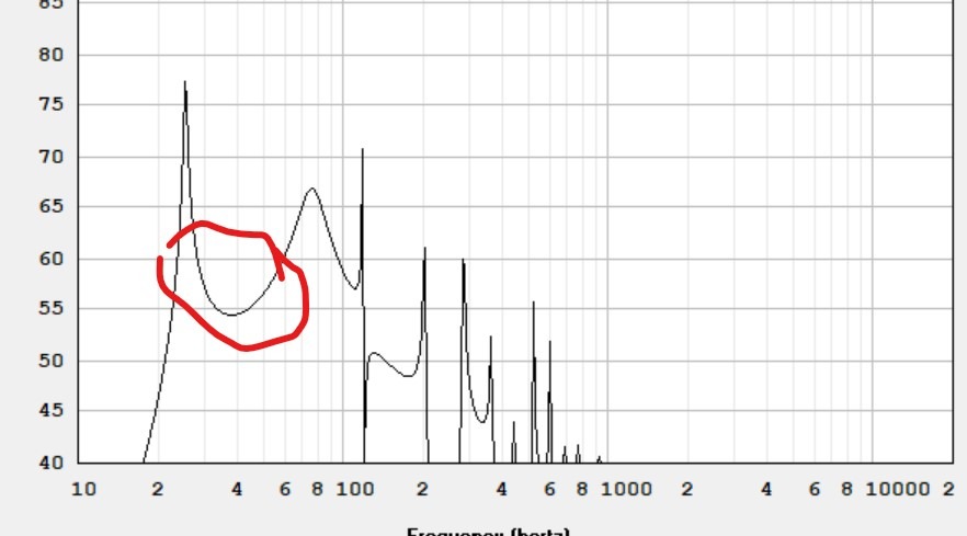

Randy, you need to add some dampingm to really see but… doesn’t look great — attempt to get to low — to someone who mostly ignirs the undamped graphs.
List all the peaks — frequency and magnitude -- each represents a resonance. The spacing I believe in a reflex you will not see them. The relationship between the numbers tells a story.

That wide slump over 40hz, is that a dead zone? Bad zone?
Winisd returns a strong flat result around that same area

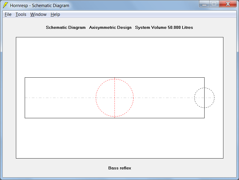

Dave, you mentioned aspect being the difference between BR and TL and as everyone has picked up, the form factor is forcing two significant pipes to form

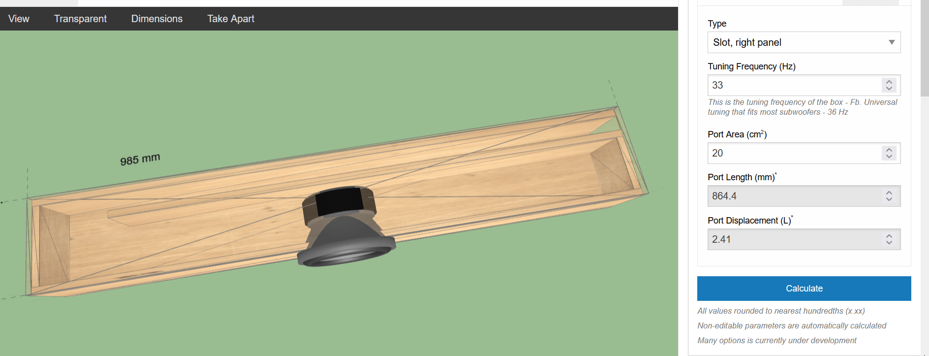

Thanks for the suggestion. That shouldn't cause any probs in drawing something like that in if I can translate what HR and Winisd results to CAD. This is where I am stumblingIt looks like a pretty severe port for a bass reflex and I would double-check the velocity of air to see if you are going to get chuffing at the port at high excursion. Your last drawing shows a port at the front, perhaps you could consider a symmetric port on either side near the speaker to keep the symmetry? Like the drawing below...If you need room for the other drivers you could just move the ports back...just like you have on the right side of your drawing, only shorter.

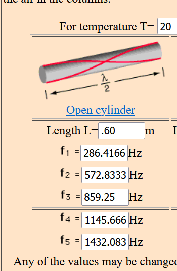

If my port is 60cm, xover at 200hz should keep all these resonances very down. Is this correct, am I getting it?No expert, but FWIW, etc., extreme MLTL to me since two distinct pipes/ducts..........pipe resonances

This wide slump over 40hz, its down over 10db from the hump higher up. Is this a bad frequency response or am I not reading this right?

The big dip indicates an under-damped alignment; it won't be that bad in reality, but there will be a sag in the response.

Randy, treating it as a bass-reflex for a moment, you are meant to tune the port to a particular frequency - which as Allen said is the resonance frequency of the air in the port. You haven't indicated what tuning you intended in the first instance when you were designing it as a bass-reflex box. For example, in the case of the last bass-reflex speaker I built, the woofer had an Fs of 52Hz, and the box was tuned to 50Hz after some tweaking. Dickason's book appears to suggest starting with your tuning at the Fs of the woofer (although the book doesn't explicitly cover this very well). Then tweaking the tune can massage the bass response a little around that frequency.
I agree with your post, but I'm afraid I wasn't clear when I said this so I'll explain. There are two resonances. The wanted resonance is the one between the mass of air in the port and the compliance of the air in the box. The one I was referring to is the unwanted resonance caused by the physical length of the port against the speed of sound, which is the pipe resonance.which as Allen said is the resonance frequency of the air in the port.

I just wanted to see if I could stick home theatre capability to 20hz in a 4.2 phantom centre, fore and rear soundbars just to mess around with things and learn more CAD and sound modelling. It will have a place in our meagre parental chill area for late night movies

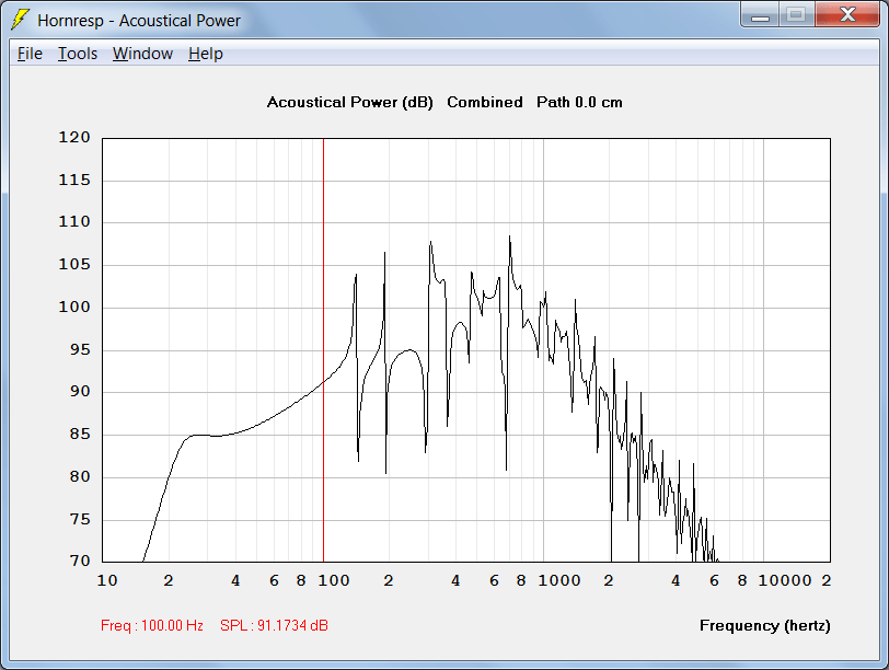

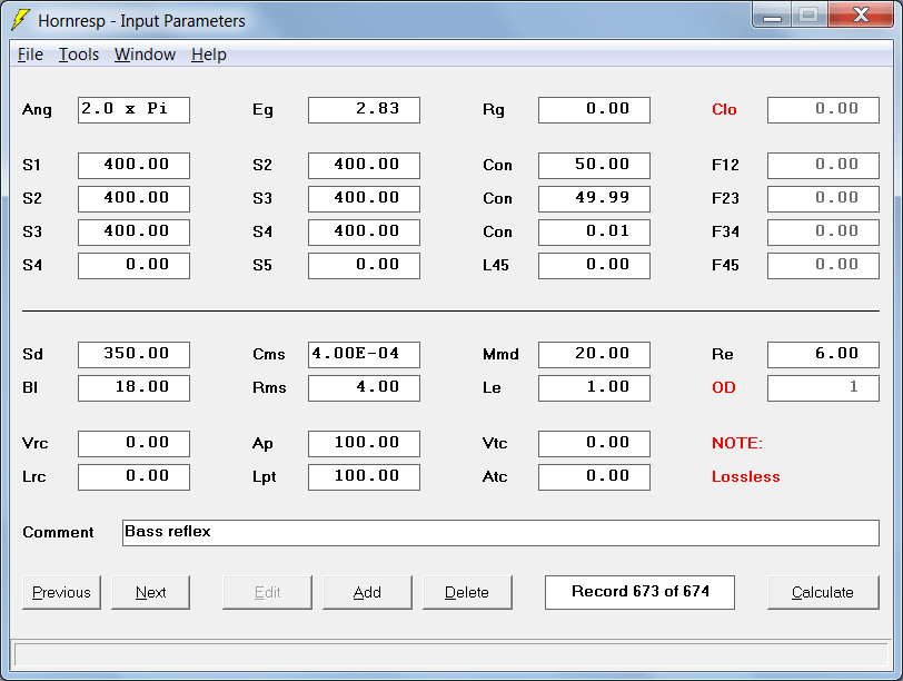

Should I rely on Winisd for a bass reflex or HR for TL? Is this a BR or TL?
In Hornresp you can model it as either, the results will be the same.
Attachments 1 to 3 - Bass Reflex (lossless)

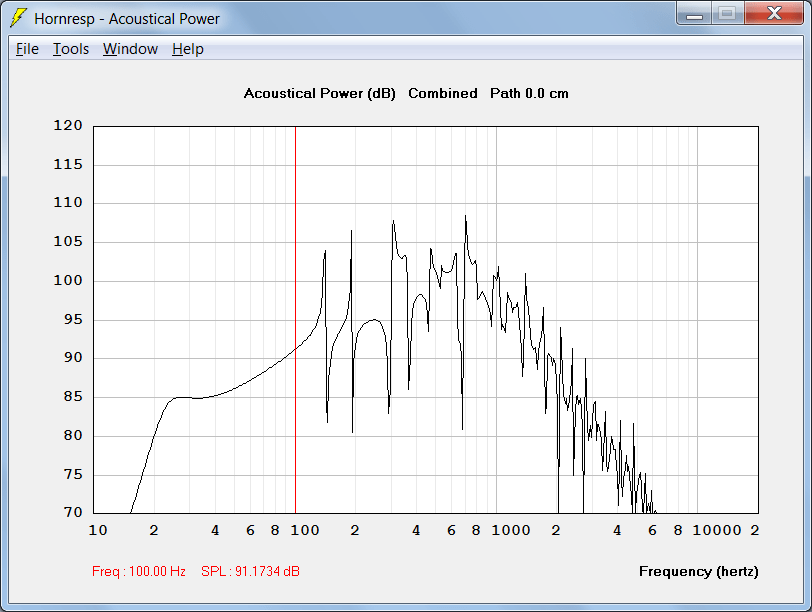

Attachments 4 to 6 - Transmission Line (with BR internal end correction added)
Thanks David, thats awesomeIn Hornresp you can model it as either, the results will be the same.

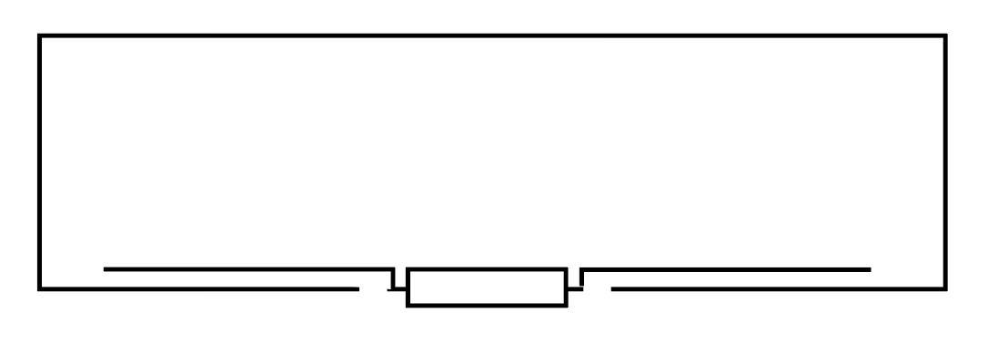

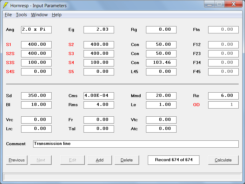

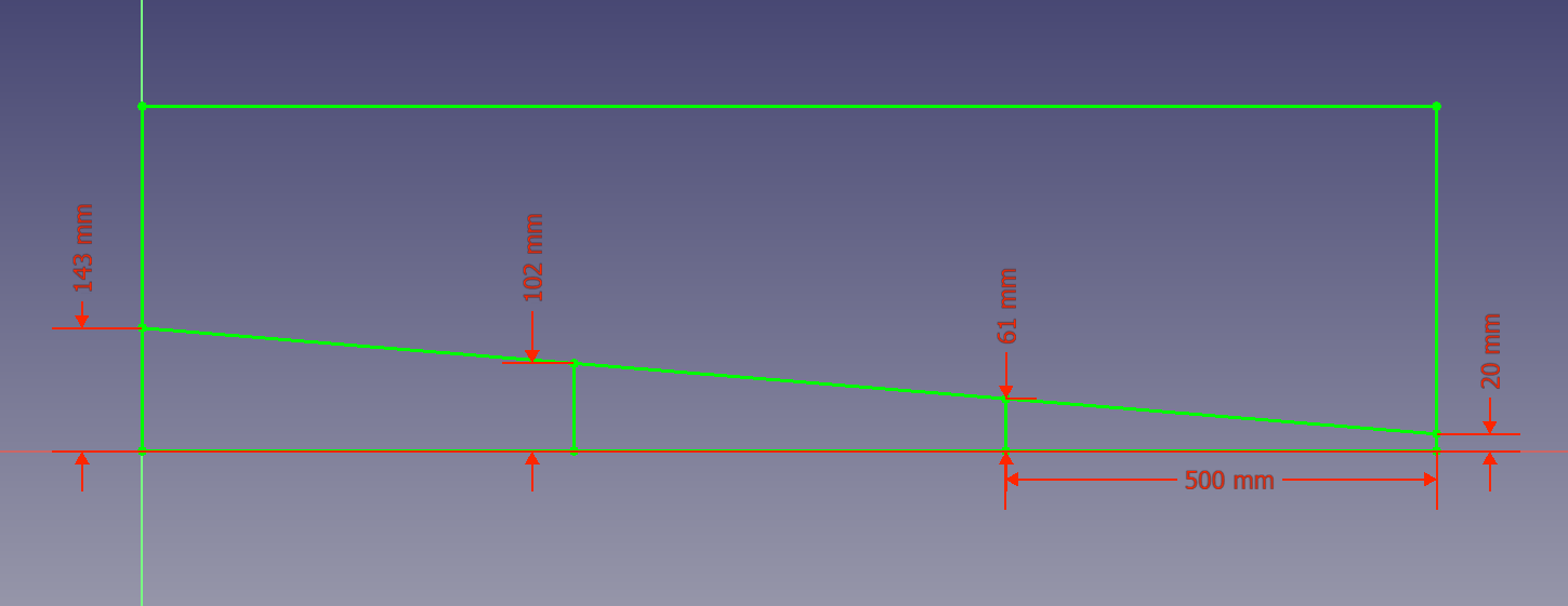

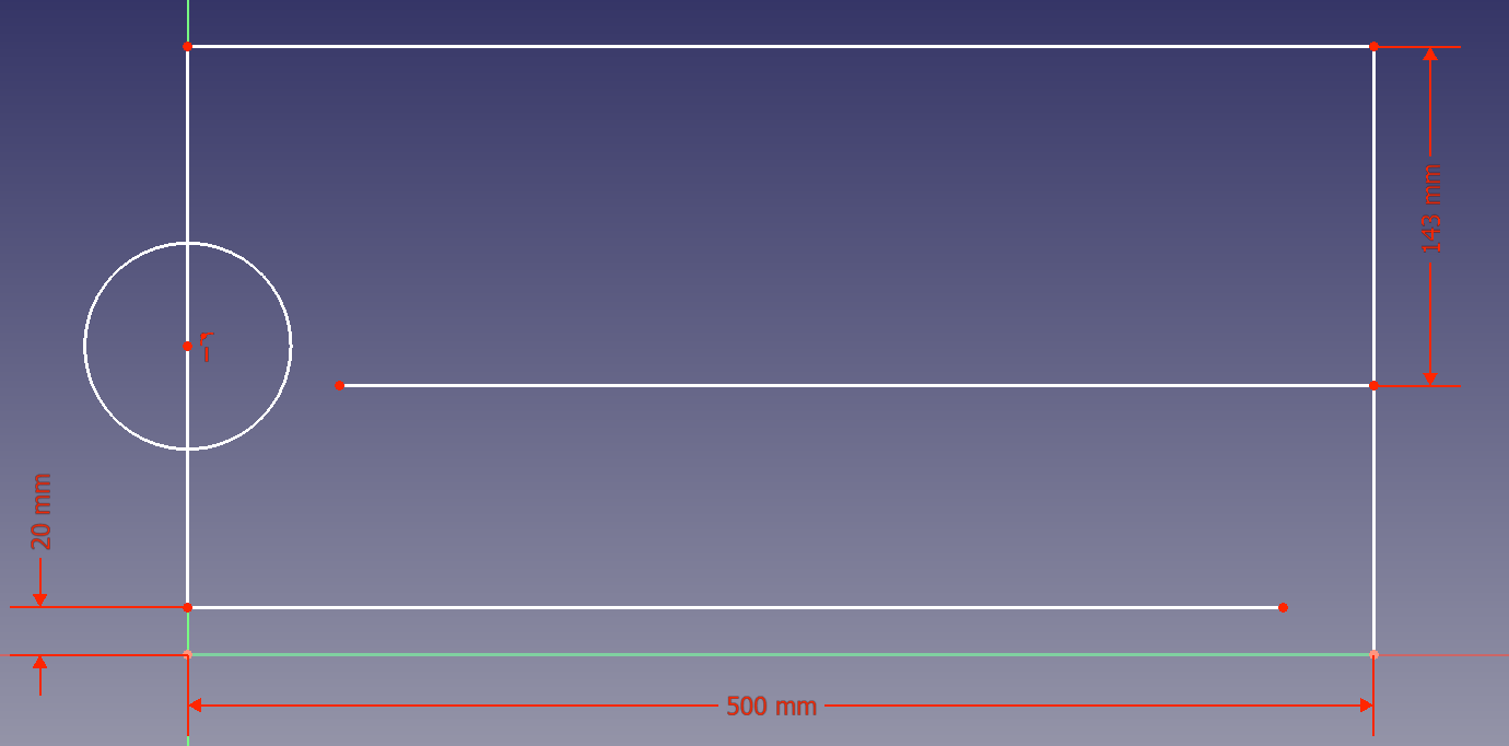

I am having another issue that has me stumped. Is the process for parallel wall pipe segments totally different from tapered segments?
3 segment pipe = 6 faces =
Needs data in S1 to S4 = 4 faces
This is the table, Ignore the 'mm', it's representing the area and each pipe is 500mm long
Drawing the pipes. I take it that the fat end is S1 and the skinny end is S4. What is stopping me in tracks with HR is to where to apply S2 and S3
Has this been an issue for anyone else? Is the middle pipe width S1 too, or S2 or S3? Are the two internal openings S1 or S2 or S3 or even S4 for the second one. I can't translate HR output to CAD without knowing where to apply these values from HR. I have asked about this previously without any feedback from anyone
Does anyone know how to apply these?
Model your cab. Subtract that cab volume from a block of air. Measure xsec areas along the line length of the air volume where appropriate. If quarters are shallow/tight, be sure to subtract the xsec area of the driver where appropriate. Plot that curve S(x) and it will be apparent what you need/want to capture in your sim models. Lather, rinse, and repeat until sick of drudgery iterating and revising both cad and sim models, then visit Brian's diysubwoofers.org and poke around in boxplan configs for an easier way 🙂 Alternatively, work only on the block of air. Review what David posted above vs the shape you get with your plotted areas.
Are you saying to loft the taper folded through a volume? But S1-S4 naturally fits a tapered fold so its not difficult to plot, my question is about applying S1-S4 to the three physical pipes with parallel sides. Difficult to review without being able to plot firstReview what David posted above vs the shape you get with your plotted areas.

Hmm, it's my understanding that historically HR only uses CSA of circular pipes, so convert CSA to whatever square/rectangular shape you want.

I was glad to hear David say that it can be modelled as either, and very appreciative that he took the time to show by example. For the first one, he did 2 identical pipes and a stepped one. Not tapered! There is absolutely no way to keep 4 varying faces from a taper fair and map it to 3 varying cross-sections. Something needs to be assumed, and I thought I was lacking the education and sense to make the correct assumption. Turns out it is an input issue
To date, I couldn't insert a different value for SD at the step, as the last S* in one row wants to be the same as the first S* in the next row in Hornresp and my previous queries re this didn't attract any input. I noticed the red labels were different in David's pic and realised that I could change that to S*S and now am able to model in steps too. The whole time I kept talking taper when all along it was steps and that I had to convert the taper to steps to use the program correctly
I realise that I have been made sport off and take it in good spirits, but do wish you guys had pointed out to change that setting. All is well, armed with that, I can try to make cabs that work like the sims
Sorry man, I think you misunderstood my last query. I am ok with converting from circular to rectangular. I was having trouble creating the step due to having missed a setting in Hornresp and having learnt the program from a tutorial on tapering that missed this little detailHmm, it's my understanding that historically HR only uses CSA of circular pipes, so convert CSA to whatever square/rectangular shape you want.
