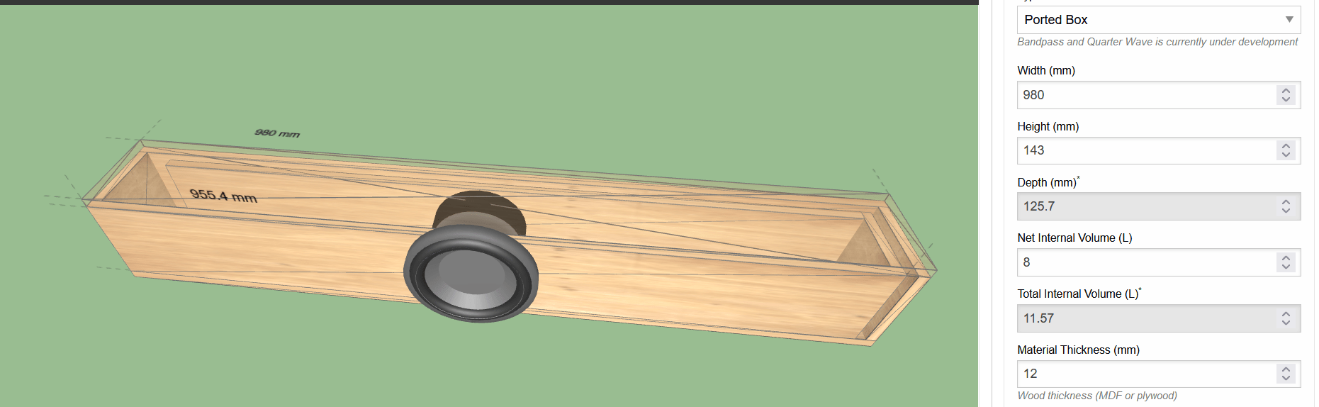

I redrew the cab as BR in box modelling. This was to get rid of the throat adaptor so that I may attach Hornresp files as recommended earlier in the thread. I don't really know if I should stick to the taller cab, as the 3.5" FR drivers really sound amazing on a very narrow baffle and with a dish fitted over the cone that masks everything but the cone and roll surround. I have worked out the best sounding taper and height for this dish by listening for the best spread around the listening room, which is being used to lay out the interior of the 20' houseboat that we are building slowly in semi retirement as funds and time permit. The trailer and highly modelled cat hulls are done. The hulls will plane safely with twin 60s and cruise frugally on electric when not up on plane
For this BR, I dropped the tuning to 23hz as per recommendation to see if a bit of eq can get this flat to 20hz. Doesn't need to be loud, it's for nighttime movies. I haven't run Hornresp sims yet, but Winisd shows flat to 20 with eq
We know it can be modelled in HR as either, with the same results, apparently. The shape of the box is constrained by the space on the counter where it will go. Pipe resonance will be a challenge and a PR may be the solution
The original question is without answer, though, is this one here now a BR or TL?

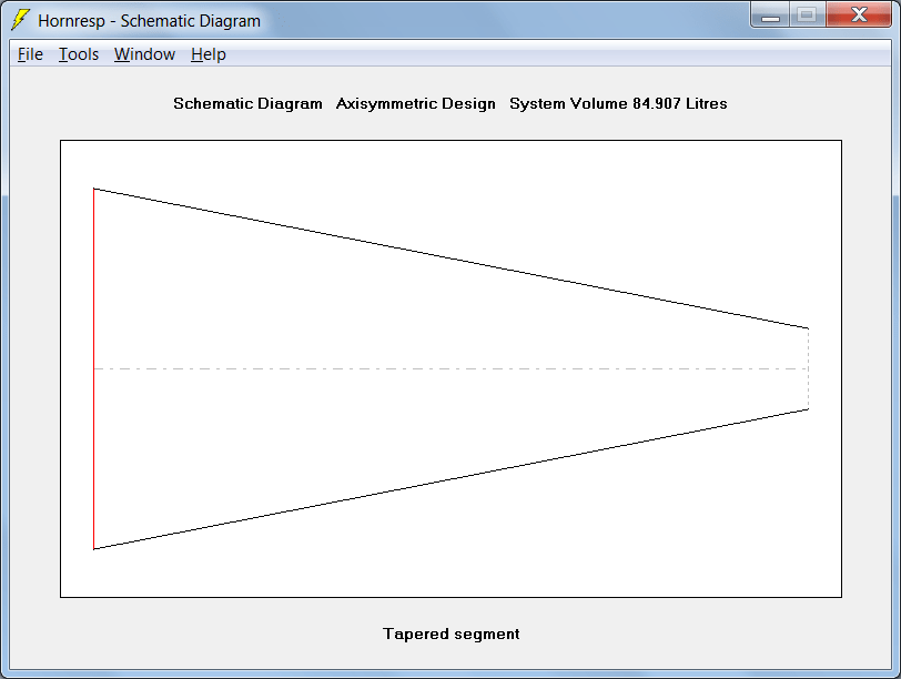

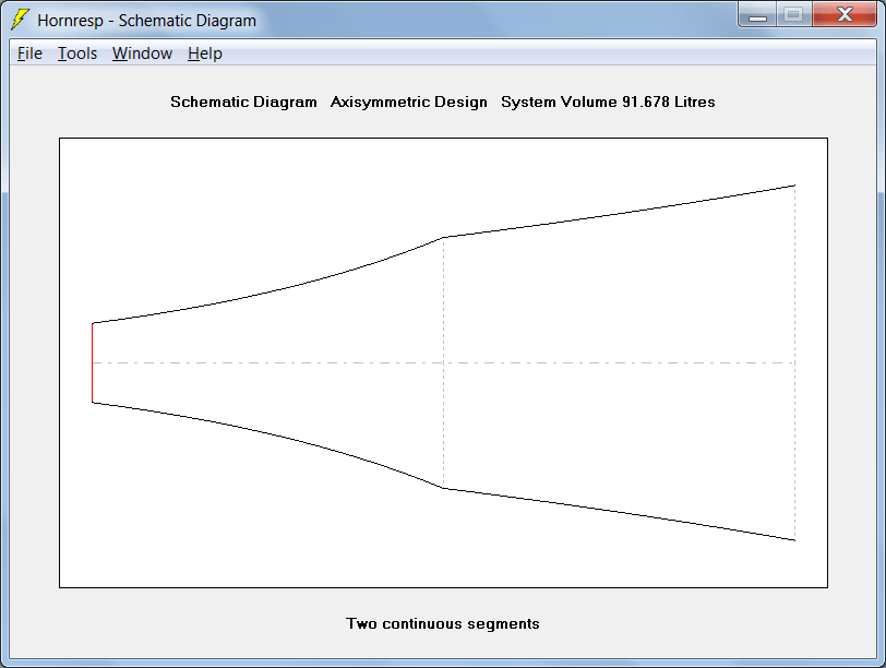

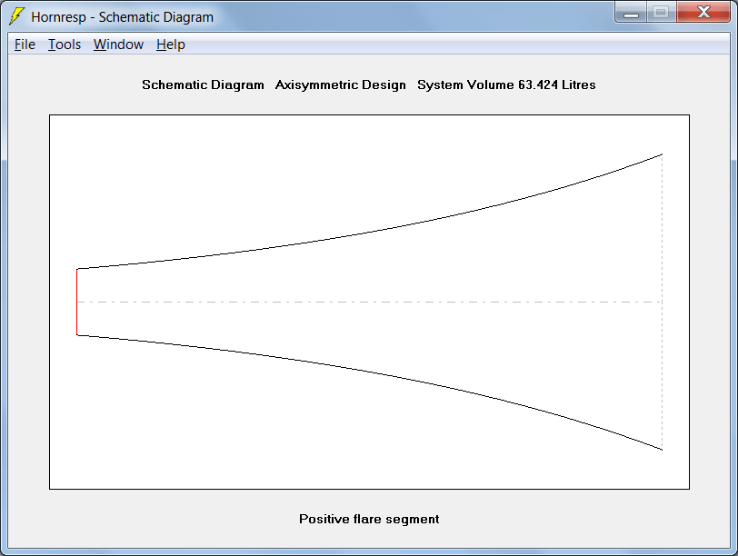

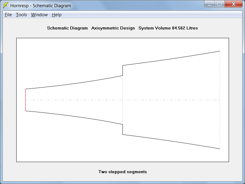

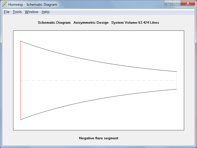

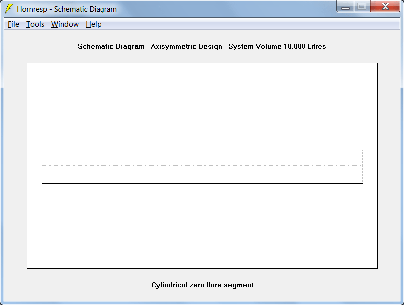

3 segment pipe = 6 faces =
Needs data in S1 to S4 = 4 faces
Hornresp assumes continuous segments by default. For a three segment system this means:
S1 = Segment 1 throat area
S2 = Segment 1 mouth area and Segment 2 throat area
S3 = Segment 2 mouth area and Segment 3 throat area
S4 = Segment 3 mouth area
Attachment 1 in my previous post refers.
As you have found, it is possible for the user to specify stepped segments. For a three segment system this means:
S2S = Segment 2 throat area
S3S = Segment 3 throat area
Attachment 4 in my previous post refers.
Attachment 1 below shows a cylindrical zero flare segment
Attachment 2 below shows a positive flare segment
Attachment 3 below shows a negative flare segment
Attachment 4 below shows a tapered segment
Attachment 5 below shows two continuous segments
Attachment 6 below shows two stepped segments

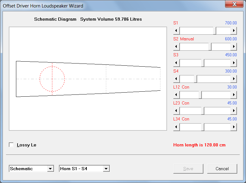

David, I opened it and closed it. I didn't know what all the sliders did and what the drop-down menu set at the bottom did. I can't even find where to change the signal power like in Winisd to see what the excursion did at a lot higher power. It's been suggested to me that the driver is good for over 600w with music and that it is very DSP friendly in a very tiny ported boxes. I can sim the eq and power in Winisd thoughHave you tried using the Loudspeaker Wizard tool?
I strongly recommend that you open it again and just experiment. The Loudspeaker Wizard is a very powerful and useful tool.
Which sliders don't you understand?
As far as the drop-down lists are concerned, the one on the left selects the output chart or schematic diagram to display, and the one alongside it selects the input parameter sliders to display.
To increase the power simply increase the value of the Eg slider. The default value is 2.38 volts which represents 1 watt into an 8 ohm load.
Setting Eg to 70 volts will give you 612.5 watts into 8 ohms.

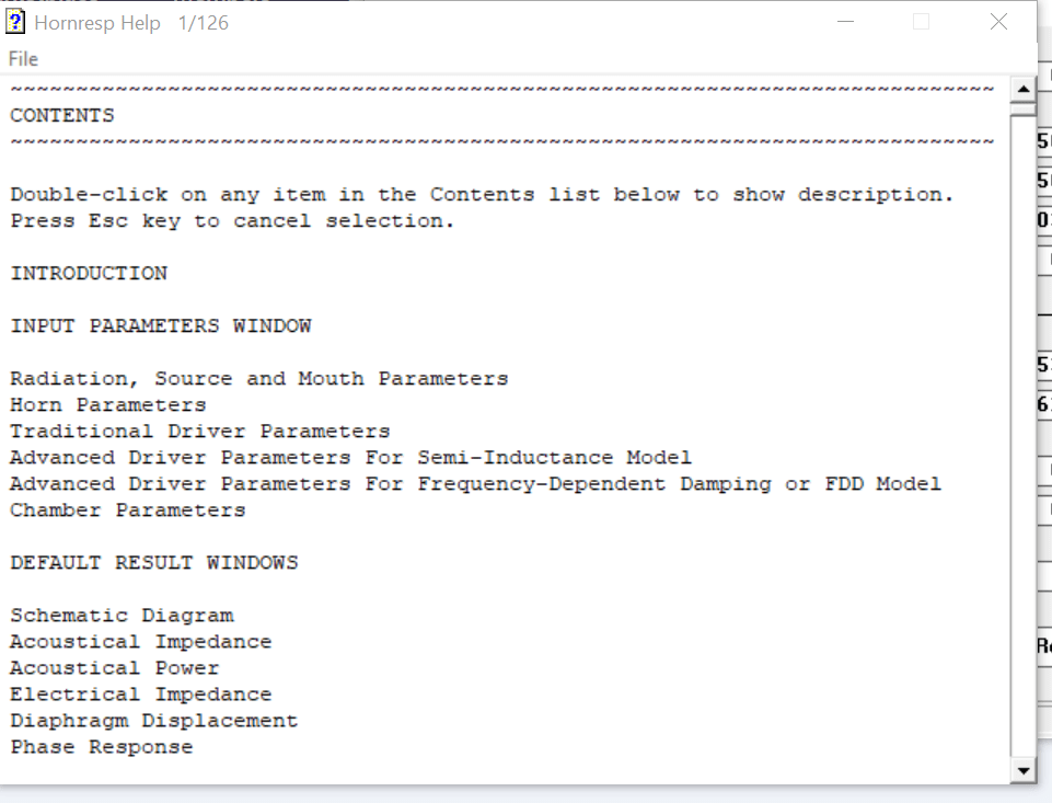

Thanks again. I thought the help file might be incomplete, it stops at "phase response". That's why I couldn't find much help in it. But my bad, for some reason the mouse wheel won't scroll it. It made me think that was all available. I can see now the scroll bar works though and can see more on that list so will have a good look through thatSee the Hornresp Help file for further details.
