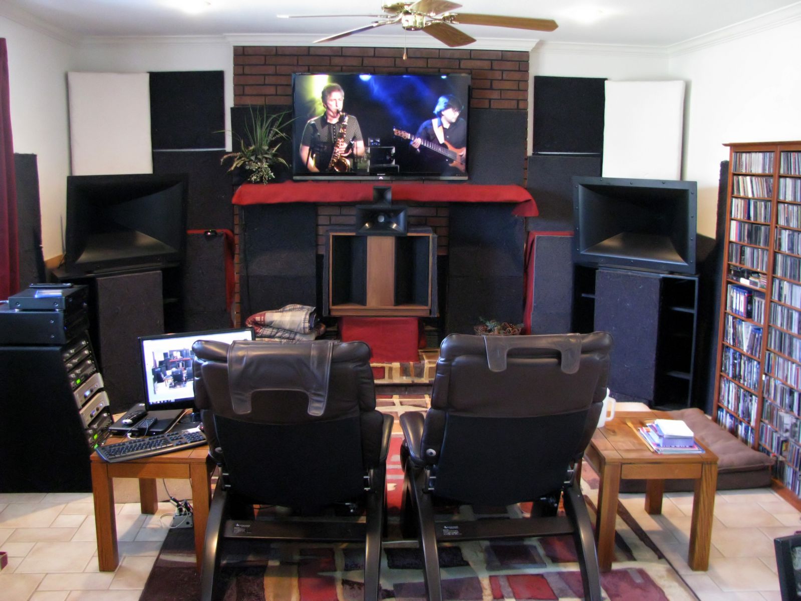

Years ago, I acquired a pair fully horn loaded loudspeakers from commercial cinema duty (Klipsch Jubilees)...which was designed with a requirement where no seat in the theater can be a bad seat acoustically, i.e., no "head in a vise" compromises. I started to look for a center loudspeaker to support a 5.2 array because I couldn't accommodate a third Jubilee in the center position. My first trials included various loudspeakers and one "horizontal MTM center loudspeaker"-like you showed, above. I immediately found out just how critical the center channel sound quality actually is. By far, the center channel is the most critical loudspeaker in a multichannel array.
What differences did I hear for a center between two Jubilees (TAD TD-4002 drivers, dialed in carefully using DSP)? Huge timbre mismatches and apparent source width problems (the apparent width of the center channel vs. the left and right front channels). After a few passive-crossover loudspeakers were tried, I used a Belle (also fully horn loaded, but much different size and performance than the Jubilees). This loudspeaker was elevated to be on nearer the centerline with the Jubilee HF horn centerlines. In short: it was terrible. As a last resort, I tri-amped using DSP crossover and found it still sounded bad but using passive crossover conditions (i.e., no time delays).
Then I dialed in the phase/time alignment of the Belle. Suddenly, it matched the Jubilees--in terms of timbre and also clarity. I later swapped out the tweeter (K-77-->Beyma CP25) which solved a high frequency harshness issue, then I swapped out the midrange horn/driver (K-600/K-55 --> K-510/P.Audio BM-D750, a.k.a, "K-69-A").
I used that setup for a couple of years. The timbre of this center channel matched the Jubilees. It wasn't quite seamless when walking across the entire 15.5 feet of room width just behind the listening positions: you could hear a small change in coverage when walking through the 1/3 and 2/3 positions laterally, but it was "good enough". I later found a better solution (i.e., the K-402-MEH).

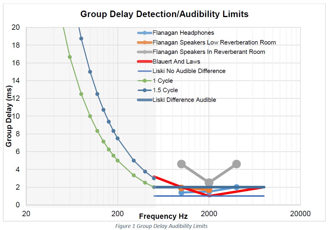

By the way, the reason for the distinction that I made with the term "linear phase response": I haven't heard any differences if the group delay plot is flat (within certain plus or minus constraints vs. frequency), regardless of the tilt of the phase response (of course, within reason). In this domain of interest--electro-acoustic loudspeaker performance--I think typical definitions used in electrical circuit theory might actually clash with loudspeaker/room acoustics usage. YMMV.
