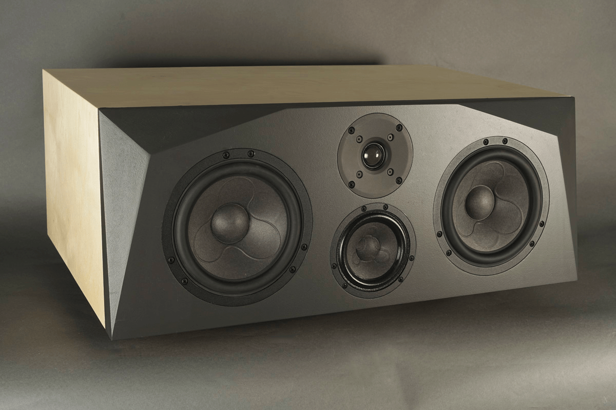

Hi Everyone,
I haven't been here in a while but a recent built by Troels Gravesen has made me think about building a new, 3-way active center. Mostly I'm intrigued by the Illuminator 12MU he used.
Here's my question. Assuming I go fully active with a similar design, is there any benefit to digitally delaying the tweeter or tweeter/mid to co-locate the acoustic plane for all 3 sets of drivers?? In simulations I've tried before using 2-way speakers it seemed the only real benefit was smoother off-axis response. Assuming I went with a 3-way active amp/crossover is it going to be worthwhile to attempt to simulate this using digital delays?

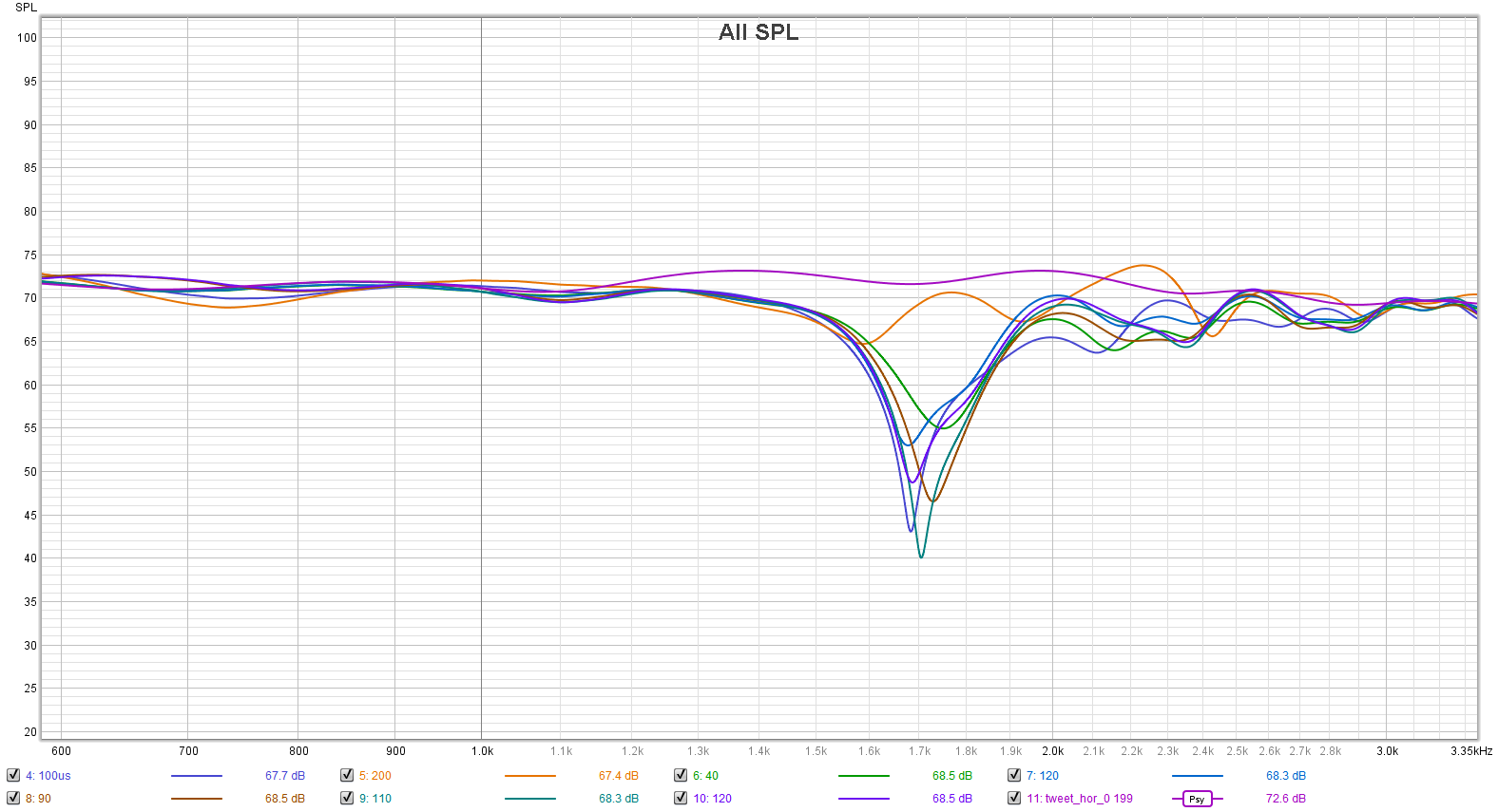

The above is from me inverting the tweeter and adding small amounts to the delay. The top line is with the tweeter back to normal and with the delay.
To flip the question, do you want the drivers to be -5db or -30db in phase?

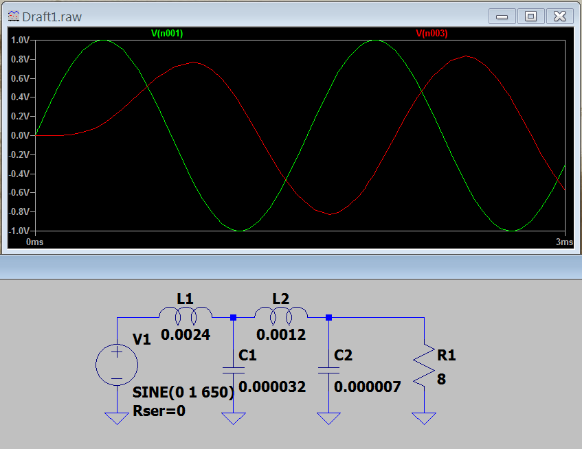

In short, a digital time delay delays all frequencies by the specified time. Whereas (passive) crossover phase altering (by altering the crossover slopes) are not.
The two waves looks different. With digital delay, they would not differ from each other just one would be delayed, compared to the other.
This example shows that they are different things.
