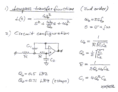

For an active filter, it's quite simple: just cascade two Butterworth filters of half the order. For example, if you want a fourth-order Linkwitz-Riley low-pass active filter, design a second-order Butterworth active low-pass filter, make two of them and connect the output of the first to the input of the second. The two Butterworth low-pass filters now together form a fourth-order Linkwitz-Riley low-pass filter. It's more complicated for passive filters.

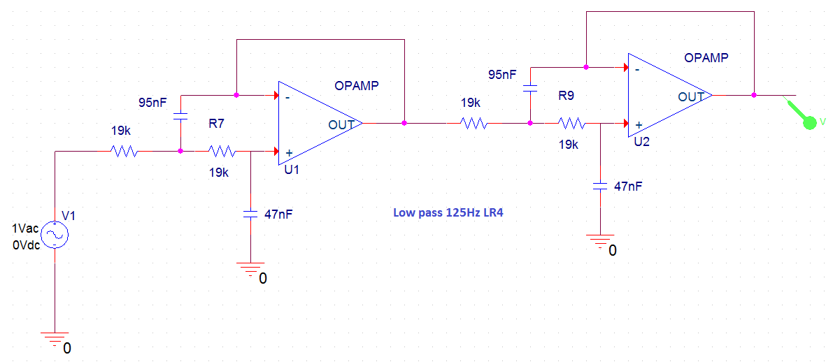

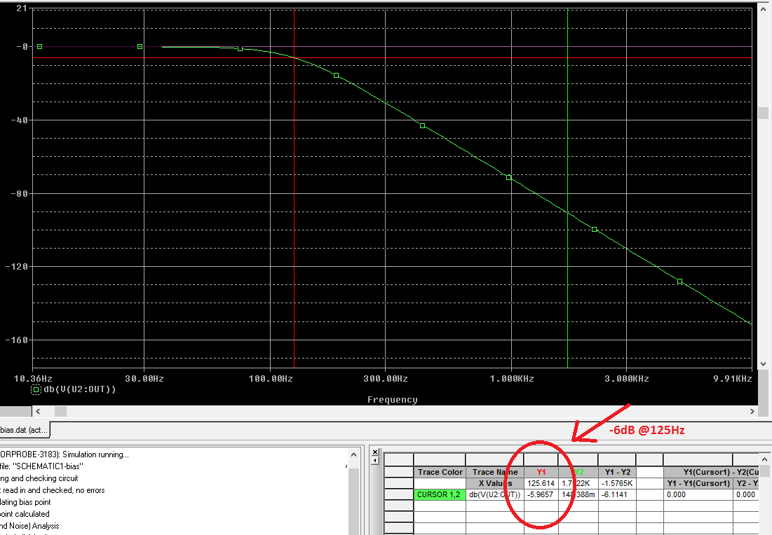

I just tried the low pass using fo=125Hz and 24dB/oct.
See the results. After dinner (my napoletana pizza!), I'll try the other filters.
I followed the formulas below (from the site I indicated).
I defined the Fo, Q0 and C2.
R and C1 were calculated

See the Linkwitz-Riley L4 (4th order) crossover actual simulation in OrCAD Capture.
It was easier than I thought 🙂
R and C were just chosen arbitrarily for simulation. Maybe I'd increase a bit the resistors to drain less current from opamps.
You can exercise the formulas in order to optimize the C and R for comercial values and/or associations.

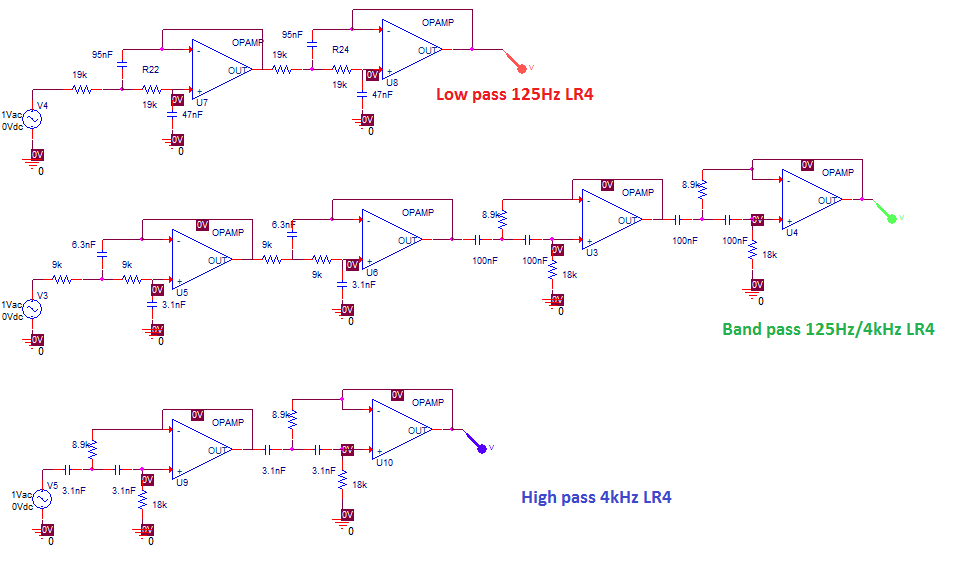

The band-pass are just a cascaded block of low pass + block of high pass.

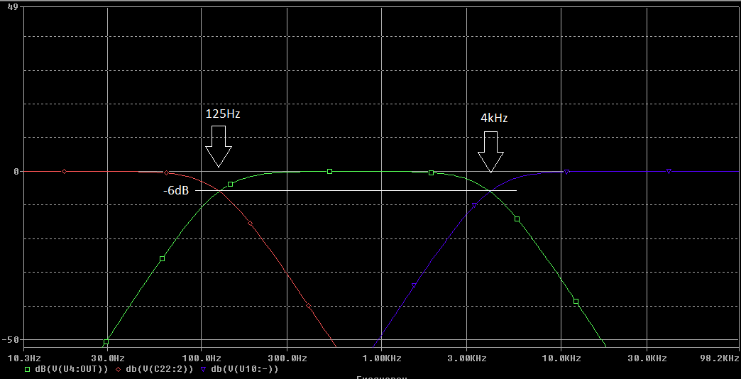

And remember, this is just the exact flat crossover electrical signal.
Acoustic flatness will only be achieved by measuring the speakers with a mic and adjust the circuit for it.

For my project i will use that combination of linkwitz riley and butterworth filters to give that almost flat response.
The one that witwald proposed, which has the best flatness.
It has a 30Hz butterworth HPF connected to a LPF 125Hz Linkwitz-Riley one;
then a 125Hz HPF Linkwitz-Riley connected to a 4000Hz LPF Linkwitz-Riley one;
then a 4000Hz HPF Linkwitz-Riley connected to a 20000HZ LPF Butterworth one.
All of those filters are 4th order.
It is slightly flatter than the solution with all Linkwitz-Riley filters. So i'm going with this one.

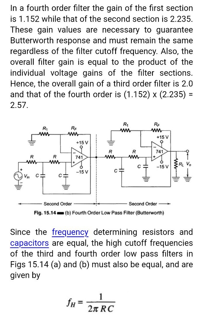

By the way, just to be on the safe side and not waste any components, is this the correct way to design a butterworth filter?
What i exactly mean is: Is the schematic, formula, and the fact that i need to make the gain of the first stage 1.152 and the gain of the second stage 2.235 correct to design a 4th order butterworth filter?

Two Butterworth 2nd order gives you a 4th order Linkwitz-Riley which is considered optimal for audio. In case you want a 4th order pure Butterworth (Q=0.7 and 3dB attenuation at Fc) you have to adjust the Q for each 2nd order Butterworth.
The Active Filter Cookbook by Don Lancaster giives accurate directions. Despite of the funny name it is better than you'd expect. Low pass filters on page 118.
I have already some gain added after the filters. I calculated it such that when the volume of the preamplifier is at maximum, the output of the amplifier that i'm using will be almost at maximum.
The problem is that i actually dont know if i'm using the right schematic and formulas to design a 4th order Butterworth filter.
I posted an image that i found on a site, but i dont know if it is correct.
On that PDF i can't find how to design a 4th order butterworth filter...

I cannot understand if what i'm making is an actual 4th order Butterworth filter, because i can't find any solid proof online about that.
Let's keep this simple:
I made this filter on a prototype board:
It has two sallen-key topology 2nd order filters connected togheter.
Filter resistors are equal values and filter capacitors are equal values.
In this case for 125Hz, using The formula Ft = 1 / 2*Pi*R*C and its inverse formulas, i calculated R = 1275 ohm (1.2K + 75R) and C = 1uF.
I used polypropilene capacitors and low thermal noise resistors (25 ppM °C).
The gain of the first stage is set to exactly 1.152220, and the gain of the second stage is set to exactly 2.234, for a total gain of 2.574.
Now my real question is: did i make a 4th order BUTTERWORTH filter?
Here is Also a schematic, but it's not very well made, i'm learning to make them much better. Use it as a reference if something i said before wasn't enough.
As i said before i'm asking for help here because i just couldn't find a solid proof that what i made is a proper 4th order butterworth filter.
