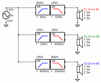

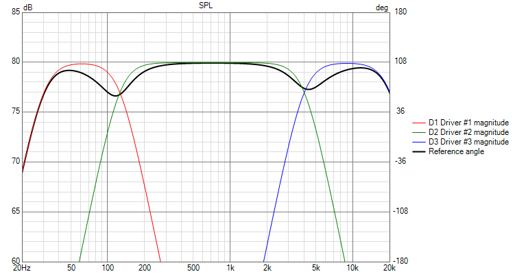

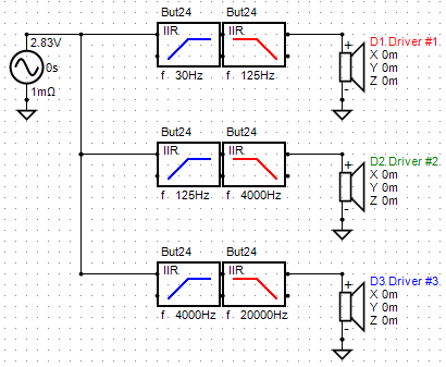

@Gianluca_2000 Based on your description, I believe that you are expecting the summed response of the three filtered responses to sum to a flat response.
A high-level VituixCAD model of the situation is shown below. It consists of the 4th-order HP and LP Butterworth filters used to create three sets of bandpass responses. For the purpose of the examples, that follow, the frequency response functions of the drivers are assumed to be ideal, perfectly flat response functions for all frequencies.
The above model produces the following bandpass response functions and overall summed response. Note that the summed response is not flat, peaking by about +2.5dB near each of the two crossover frequencies. This probably isn't the response that is desired.

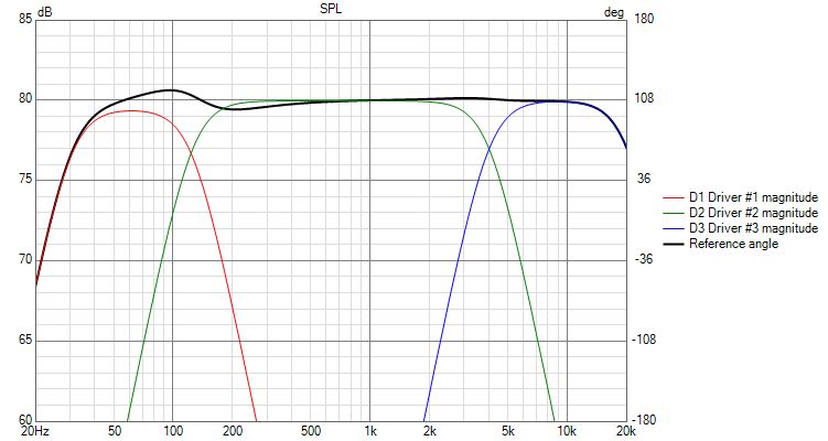

Inverting the polarity of the Driver D2, we obtain the following, which is also far from ideal. Now we get severe dips in the response.

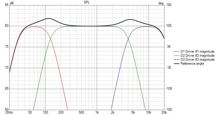

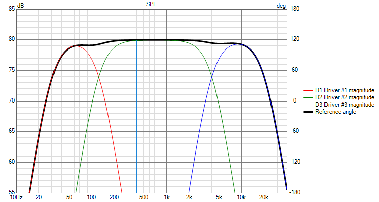

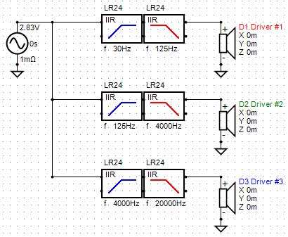

Let's change Butterworth filters to Linkwitz–Riley filters, keeping the order the same (i.e., 4th order).
As shown below, the summed frequency response is now much flatter.

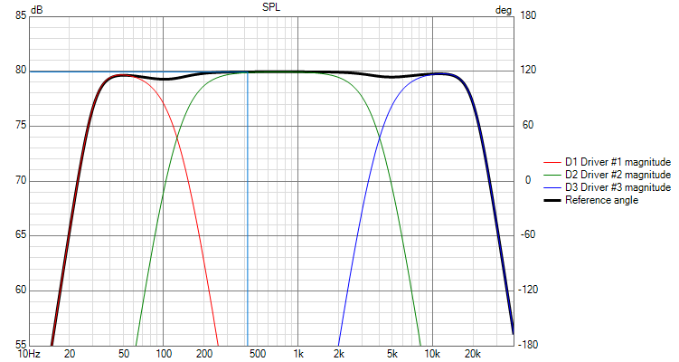

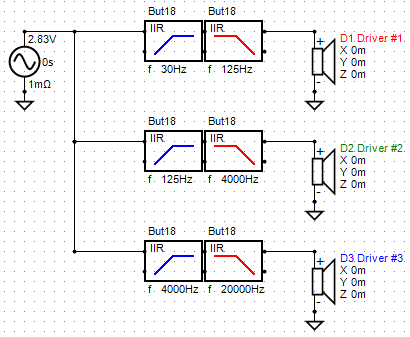

Let's try changing the HP filter on Driver D1 and the LP filter on Driver D3 back to a Butterworth filter.
Now we obtain an improved, slightly flatter summed frequency response.

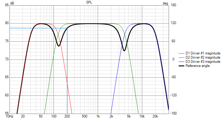

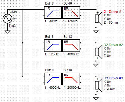

Here is a VituixCAD model of the 3rd-order Butterworth filter approach.
This produces the following bandpass frequency response functions and summed frequency response. It's still very far from flat, with dips of about 3dB and lots of phase cancellation between the filtered responses.
Inverting the polarity of Driver D2 produces the following result. Here we have peaks instead of dips. The largest peak is about 1.9dB high.
These relatively poor results are produced because complementary 3rd-order Butterworth filters are very sensitive to phase errors through the crossover region. If we shift the locations of Drivers D1 and D3, we can achieve a better result.

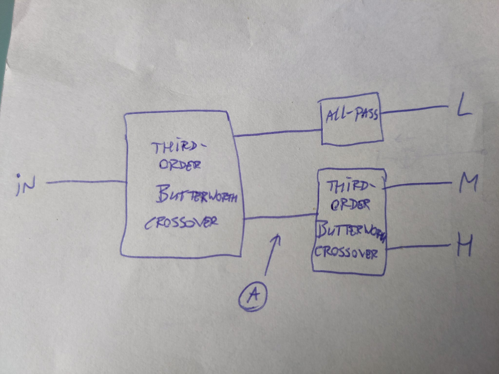

You can also use a cascaded structure and an all-pass: two cascaded two-way crossovers and an all-pass in the path that only goes through one of the two.
The response from point A to the sum or difference between M and H has an all-pass characteristic, either second-order Q = 1 or first order, depending on the chosen speaker polarities (see https://www.diyaudio.com/community/...s-vs-group-delay-with-lr4.416178/post-7760275 ). Also apply such an all-pass to the L channel and the on-axis response should be flat again - with ideal drivers with a bandwidth from 0 to infinity and with perfecly aligned acoustic centres anyway.

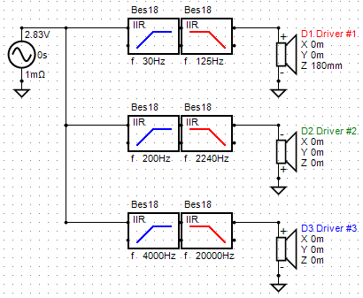

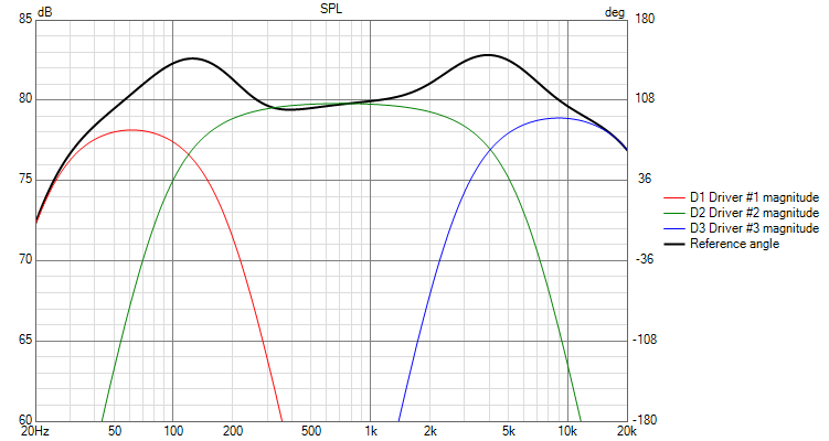

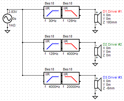

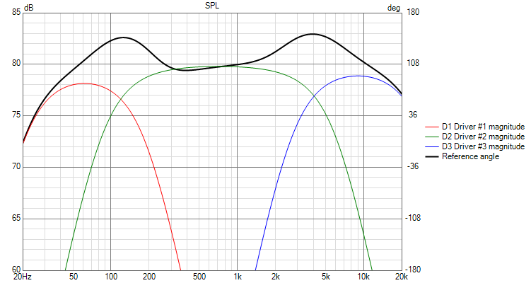

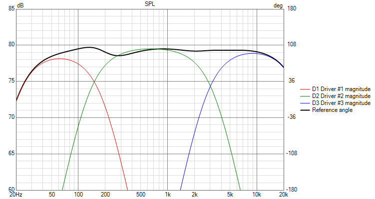

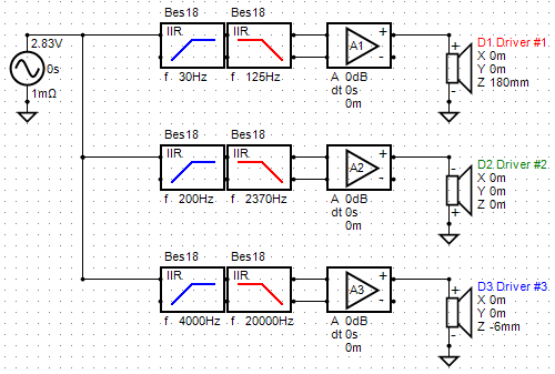

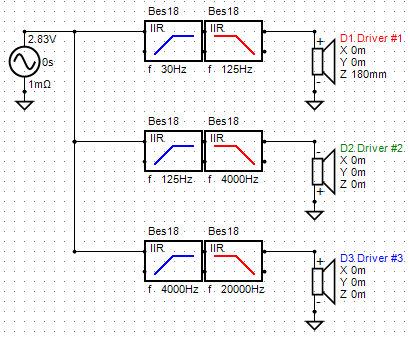

I was curious about the possibility of using Bessel filters, as they don't have complementary combinations of lowpass and highpass filters.
Below is a VituixCAD model of a 3rd-order filter configuration using the Bessel topology.
The bandpassed and summed frequency responses are shown below. It's not a particularly good result, with the largest of the two peaks being around 3dB high.
To improve the summed response, we can adjust the cut-off frequencies of the high-pass and low-pass filter sections of the filter block acting on Driver D2.
The above diagram shows that the frequencies of the filters acting on Driver D2 have been changed to 190Hz and 2240Hz. The summed response shown below is now much flatter, especially for that part of the spectrum involving the high-frequency Driver D3.

But looking at one of the graphs posted here there are still peaks, somehow. How can i attenuante them?
If you want to make sure at least electrical signal will be flat, just use the Linkwitz-Riley aligment (12dB/oct or 24dB/oct).
Transition will happen at -6dB and acustically it will sum up to 0dB if speakers have the same sensibility.
In your case, differences on speaker sensibilities will be compensated by the 3 individual amplifier gains (knobs).
Look at the simulation Witwald did on 2024-08-13 8:12 am - it is flat.
Linkwitz-Riley aligment gives you flat electrical response.
