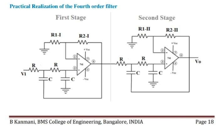

Hi, i'm having some doubts on what kind of filter to use for audio and on if i made them right.
I need those filters in a preamplifier.
I designed three band pass filters:
1)30 - 125Hz (Subwoofer)
2)125 - 4000Hz (Midrange)
3)4000 - 20000Hz (Tweeter)
I designed them to be butterworth filters, but are they actually good for audio applications or they introduce too much distortion?
Every stage of the BPF is actually a 4th order filter. A 4th order HPF connected to a 4th order LPF.
For example, the first 30 - 125Hz BPF is made out of a 4th order 30Hz butterworth HPF connected to a 4th order 125Hz butterworth LPF.
Also, i decided to use a buffer OpAmp between the HPF and the LPF.
Is it going to make a difference or it's useless?
Is this going to work or it is better to change topology?
Here i posted a schematic that i found on the internet. It's 4th order butterworth LPF.
Imagine my design as one of those connected to another one of those but with the resistors and capacitors swapped (HPF). (Of course the two resistors for setting the gain are always in the same spot).
So, by swapping the resistors with the capacitors and the capacitors with the resistors, will it become a HIGH PASS filter with the same cutoff frequency formula, or the formula for calculating the cutoff frequency changes?
I mean, the formula for calculating the cutoff frequency for both LPF and HPF is the same?
I used this formula for designing both HPF and LPF:
Fc = 1 / (2 * 3.14 * R * C).
This is because the two filter resistors are the same value and same for the two capacitors. 3.14 of course is pi, i dont know how to type it.
Is this the right formula?
I also followed the rule that the first stage of a fourth order butterworth filter has to have a gain of around 0.152 and the second stage has to have a gain of around 1.234.
So both combined will have a gain of around 2.57.
This is only for a single LPF / HPF 4th order stage though.
So i think the total gain of a complete BPF is 2.57 * 2. (Because it's 4th order HPF + 4th order LPF combined).
Is this right?
For the best accuracy i'm going to use ±0.1% resistors and all capacitors are polypropilene for best audio performance.
But before placing the order, i wanted to ask...
Did I make some mistakes or those filters are going to work fine?
I'm basically a newbie in this kind of stuff, and this is a personal project.
I'm sorry if i made a lot of mistakes that might be ovbious to you.
If you need more information than what i provided for now, no problem at all, i will provide them.

But this is just the preamplifier... I'm buffering the outputs of the three BPFs as well, so that their behaviour won't change when i load the signal more at the output of the buffer OpAmp. That signal is not going to be loaded much anyway, because it goes to the input of the amplifier that has a high impedance (47Kohm).
Like this is will work with any speaker... Right?

Yes it is good idea to use input buffer to drive all filter sections
Also possible or often needed is individual gain control on outputs as well.
Since you will likely need to control levels. Since sub will likely need slight boost
and tweeter slight padding.
Your schematic shows common filter with gain.
If you do add individual gain controls for each output.
Then of course not always needed to add gain at filter stage but after
keeping filters unity gain.
I'll assume schematic is shown simplified for example only.
Full schematic of course would show power rail decoupling capacitors.
And likely not be using 741 opamp and using typical quad package low noise
audio types. Since 8 pin chip for every stage would be obvious nightmare for layout.
I would review some basic designs here for inspiration of 24 dB active crossovers
4th order Linkwitz and butterworth otherwise pretty standard normal stuff for crossover.
Q at cutoff could be fine tuned if tested in simulation depending on specific speakers used.
With simulation it would show more precise response and calculated values be more
precise and matched to exact speakers and baffle response to be expected.
If additional gain stages not wanted to simplify design. You could set individual gains
more accurate as well

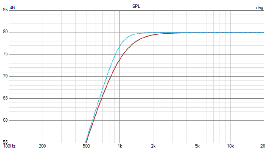

Overall? We could describe that verbally. Butterworth has flat power and flat response on the target axis. Linkwitz-Riley has a relative power dip by comparison.
Even-order Butterworth gives a 3 dB peak on axis, while Linkwitz-Riley does not. If you want a flat response on axis and a flat response for the power averaged over all directions, you need odd-order Butterworth - but then the outputs of the crossover are not in phase (nor antiphase), causing a tilt of the main lobe and more sensitivity to small phase errors of the drivers than with Linkwitz-Riley.
Sorry, yes. In practice it's fairly arbitrary and my point is that the variations that remain..
Such as? And how can anything be better than maximally flat?
..after globally equalising (anything can be made flat that way), are what make the decision to go with one or the other.
