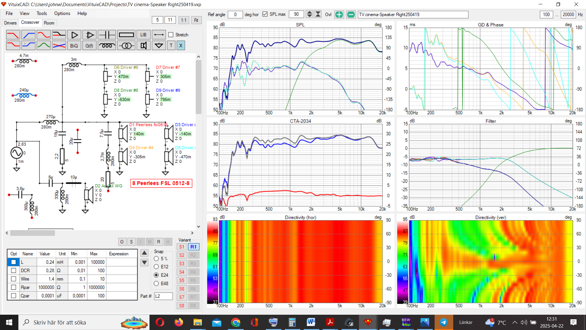

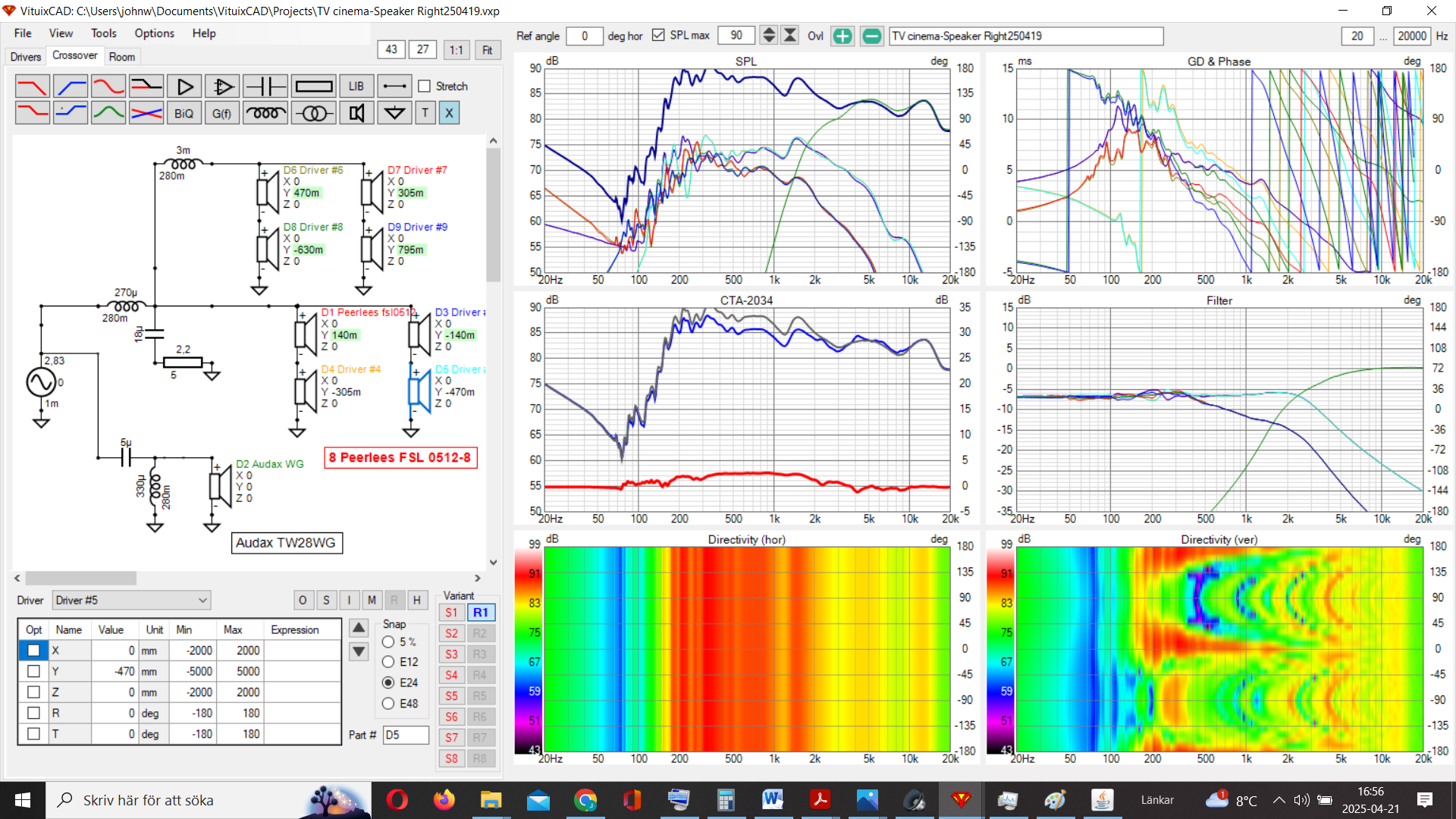

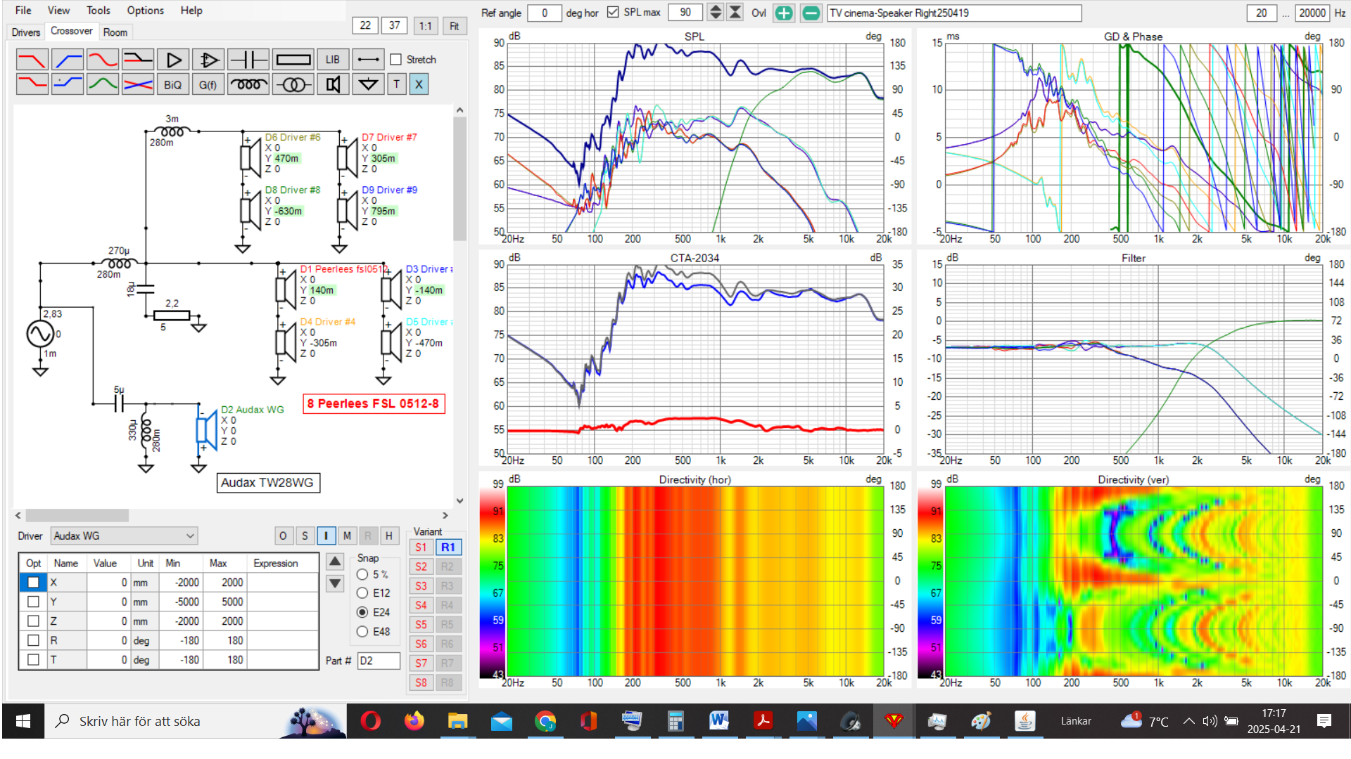

Is any of these 2 xover technically preferable?

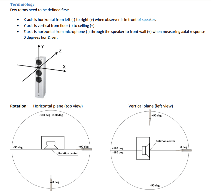

How i make a "polar plots" ?
Right click the directivity plot and choose polar map. Right click on the impedance plot and choose directivity chart. Right click on the impedance plot and choose polar map.
And can i use the measurements from 2 days ago to "make polar" ?
You have changed 'Y' for the crossover. The polar map will show this difference now, even if you don't measure at many angles.
If my cabinette is 230 mm wide with rounded corners, and the WG is 175 mm wide placed in the middle.
What is the X axis ? (115 mm ?)

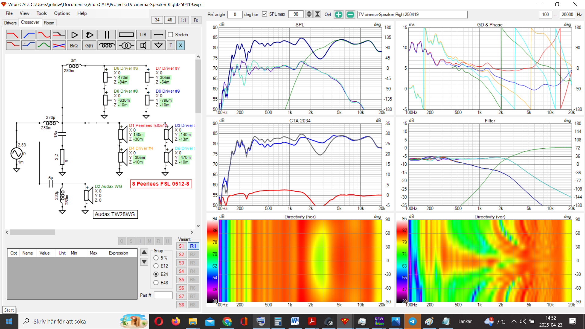

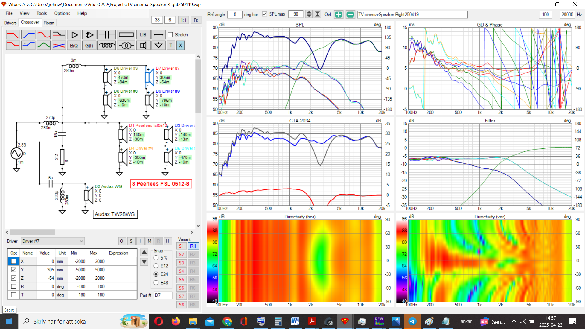

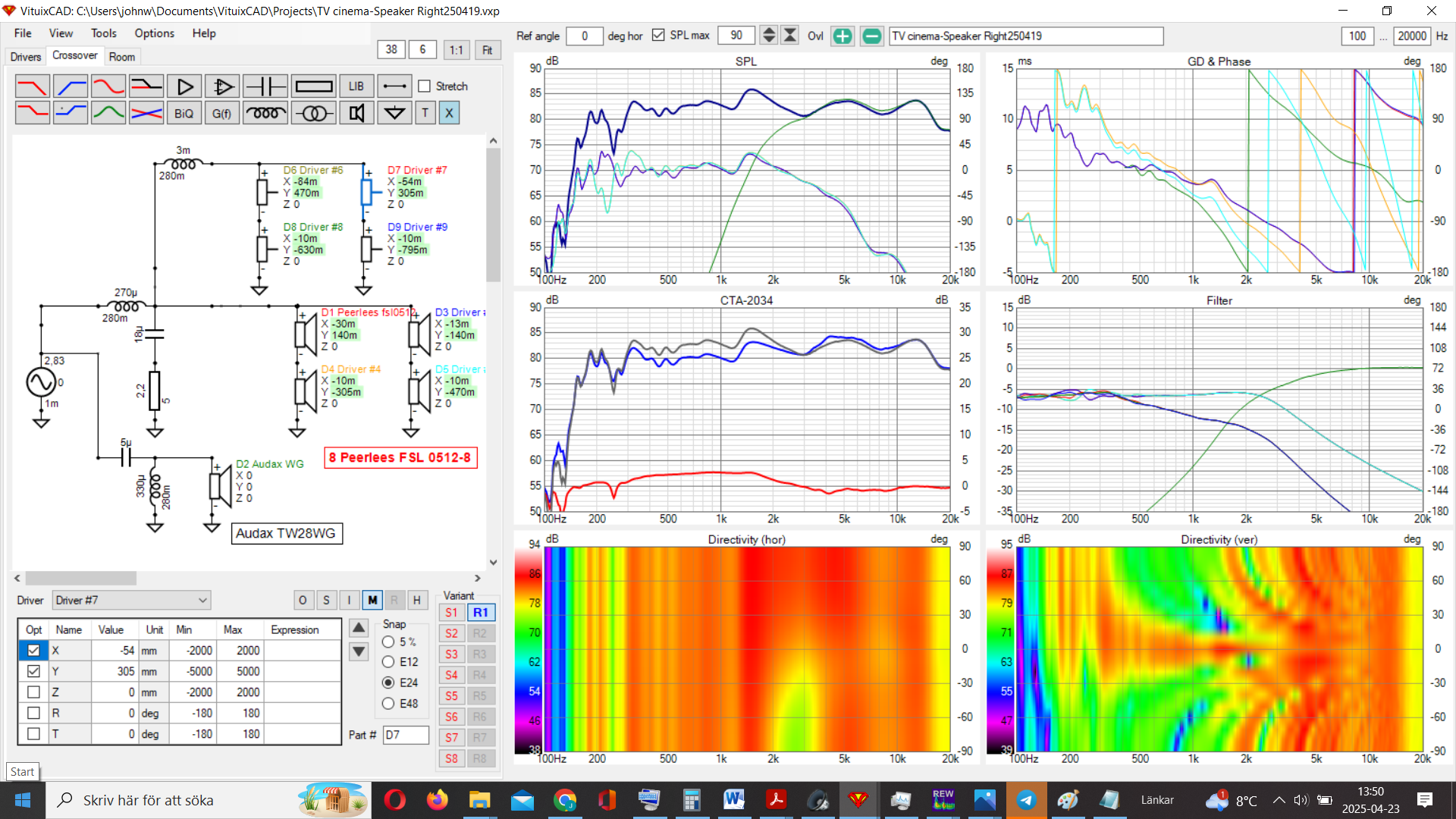

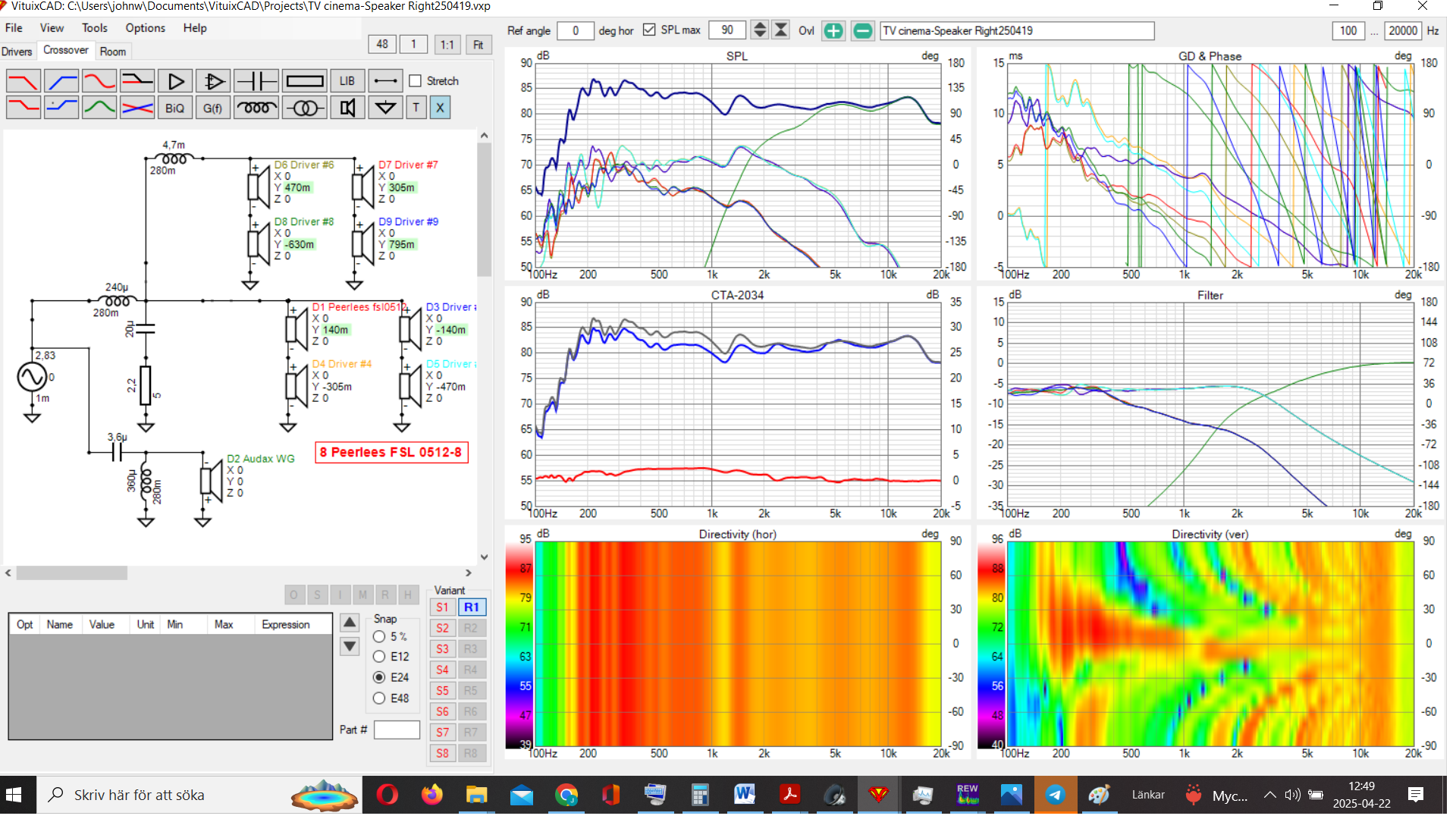

Here is the simulations for the xover. (think i mixed them up before, my head was spinning after a long day)
Named Polar 1 is just the xover with our settings.
Polar 1 inverted tweeter, is the same but with inverted tweeter.
Polar 2 is the same BUT with all drivers unmuted.
Polar 3 is the same but with 24 dB on midrange insted of 12 dB (as polar 1)
Can you see something on this polars ?
For me its just like a rainbow but not as pretty.

I don't grasp the gist of "Remind me..." - sorry for my limited language skills.
It was a fun response to your joke. It did not translate well. I was not offended 🙂
For the rest of #24 I cant tie the comments to what I wrote in #23.
You said - [my bet is that the more point source, the better image. I see a true point source as the "grail"]
..and I said it will be circumstantial. This means you can find good results the way you are going but it is not because of the point source itself, but because of other things.
It isn't straightforward to translate images to sound. I don't think you should focus on these unless you are getting something out of them.
I would unmute the woofers before assessing the polars. I'd look for areas that stand out as missing or too strong, maybe you can optimise the line array that way by trying the woofers alone. I'd then see whether the tweeter makes an improvement or ensure it does the least damage when crossing.
This is the data based way to ensure you blend the two radiation styles and to assess them separately, it saves you taking measurements at different places around the room. The other way is to listen. If you EQ to your liking and there are outstanding non flat areas in the listening axis EQ it can be a sign of off-axis problems.

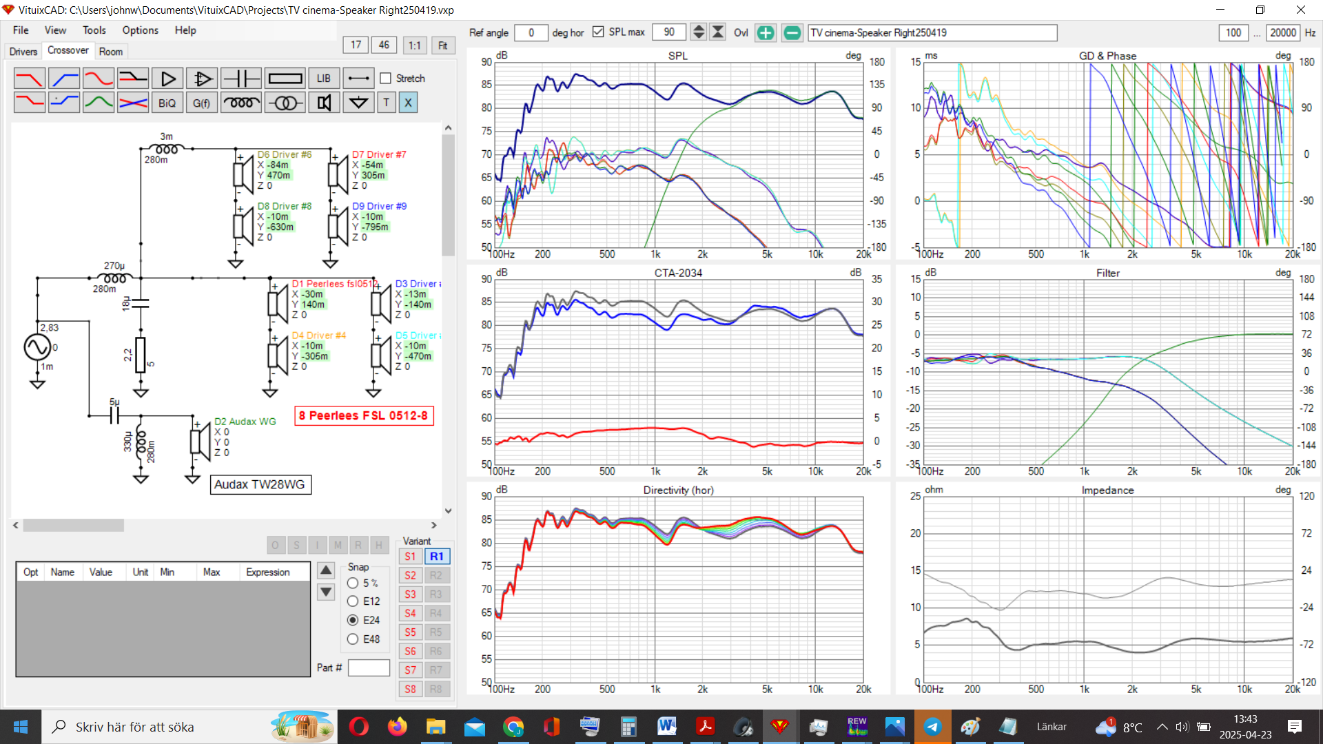

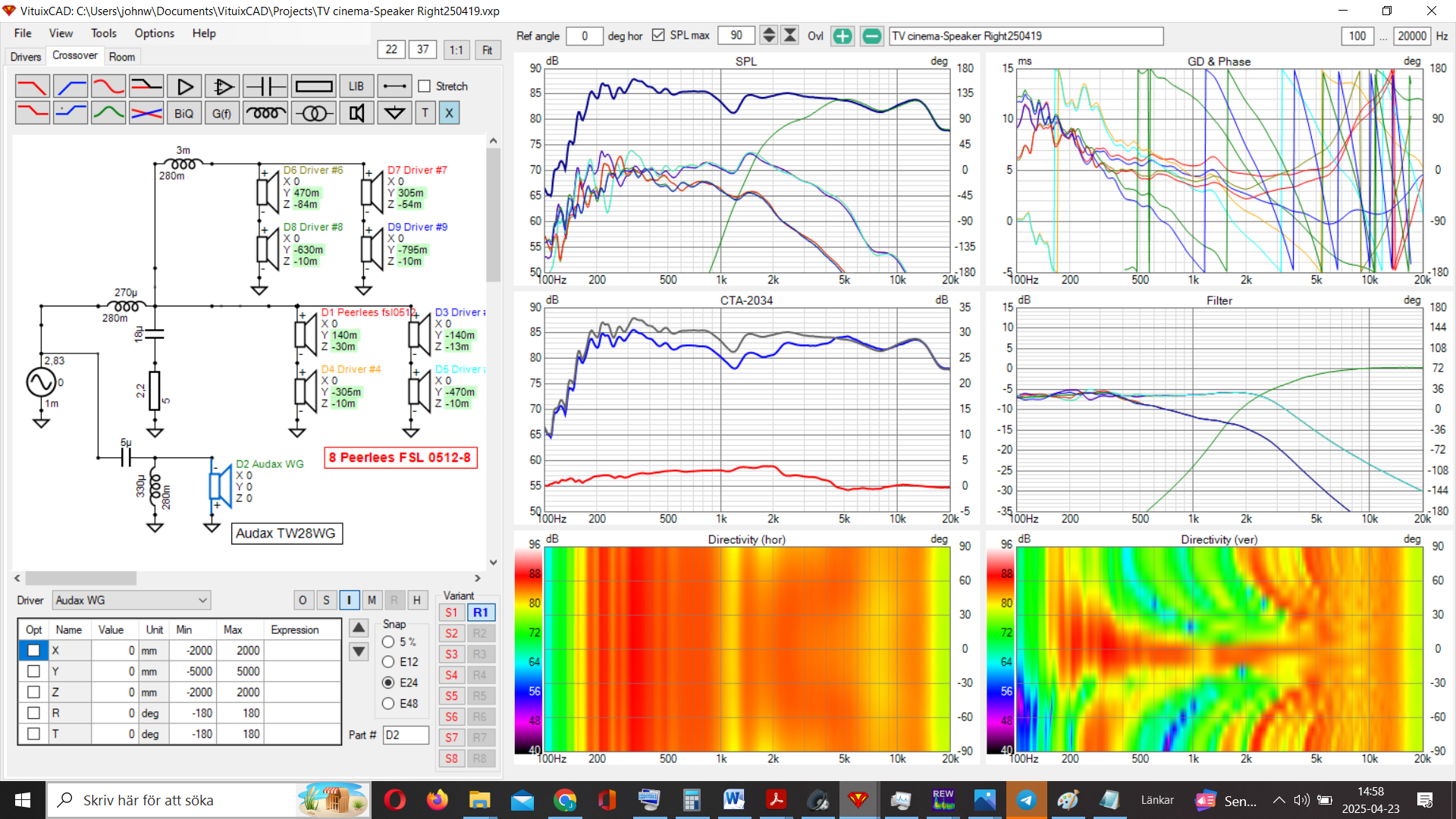

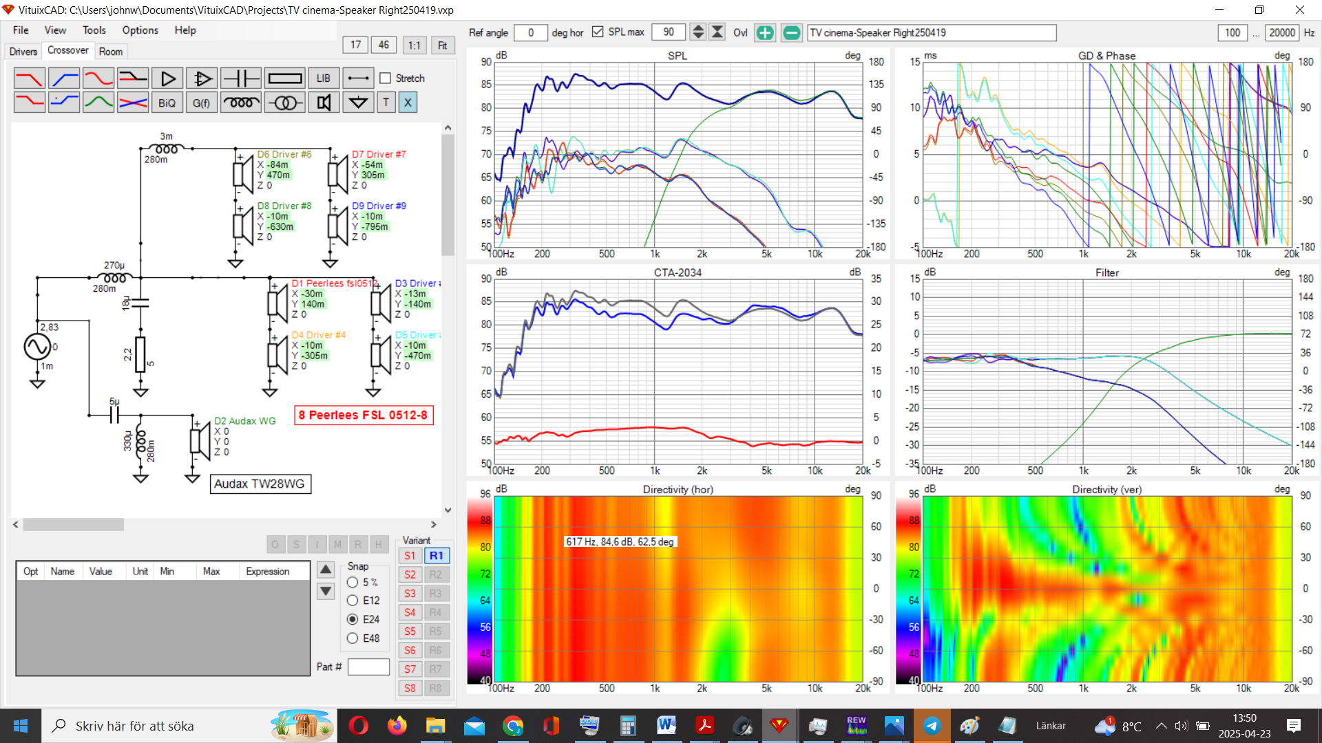

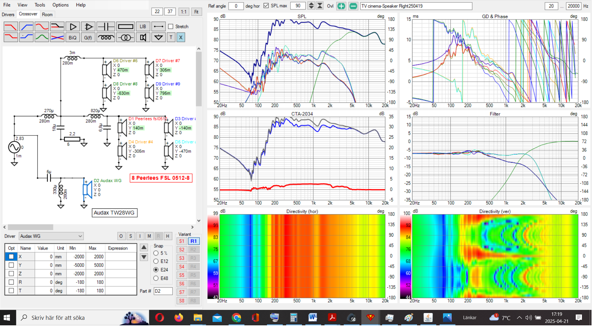

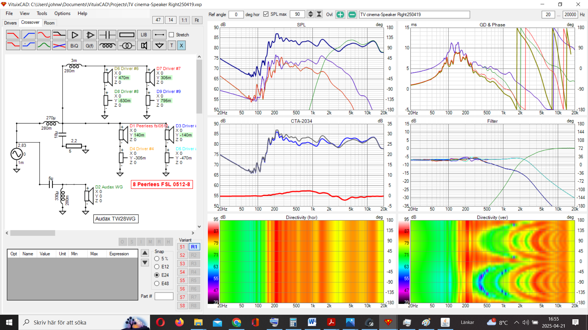

I try to learn a little about interpret polars, and change to +-90 degrees insted of 180.
Here is without the woofers (woofers muted)
And anotherone with woofers and some changes in the xover.
In your eyes better?...same?...worse?

The muted ones may be leaving holes in the coverage.

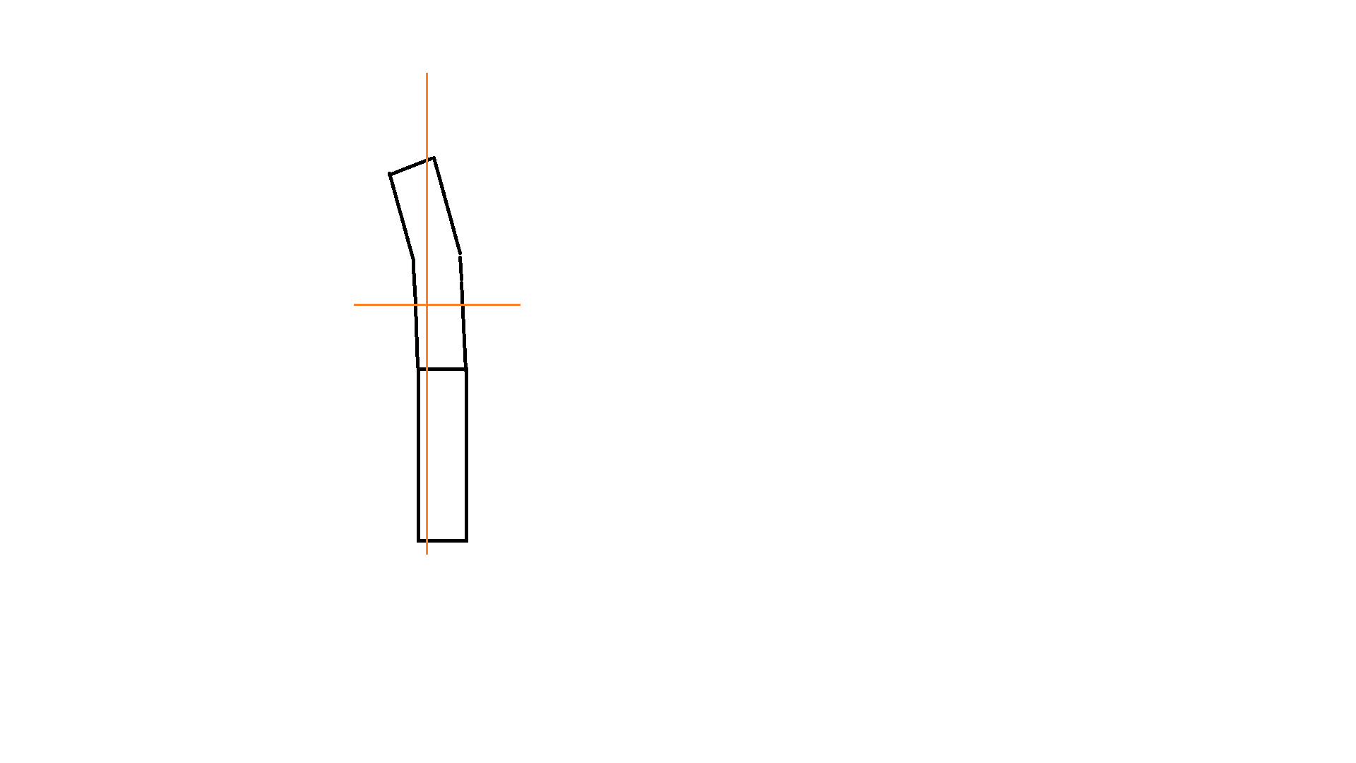

Okey now for the first time, i also put the X-axis in VituaXcad.
Hard for my brain with this curved speaker, but i hope its right.
EDIT: Skiss on speakers X axis from the side.
