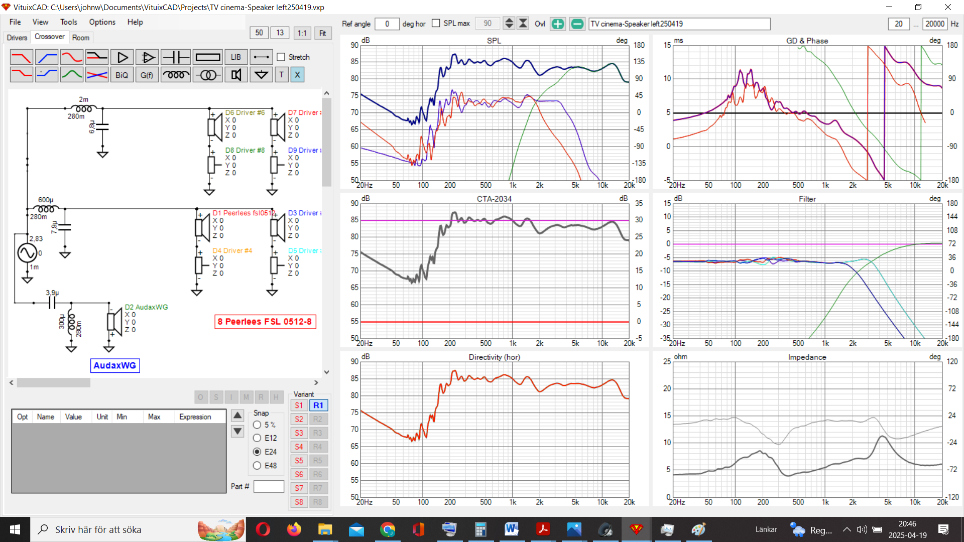

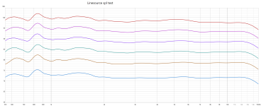

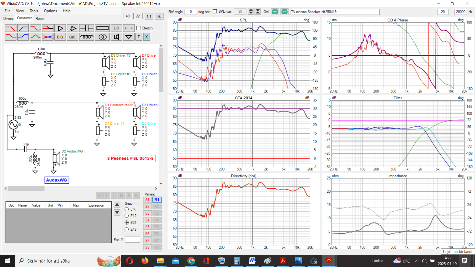

Is any of these 2 xover technically preferable?

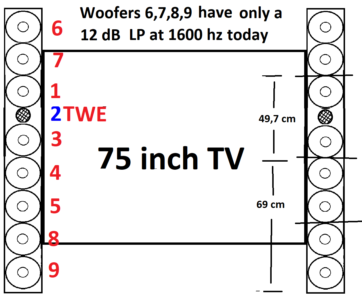

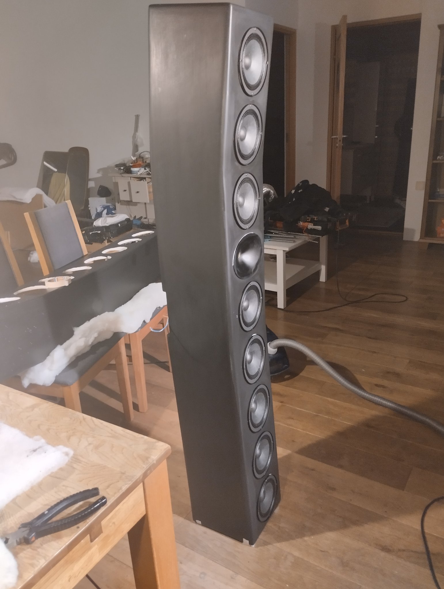

I have diy a 2,5 way 9 drivers linesource with pointsourse "function/treat"
And I have now listened to a few different filters for 1-2 months, & have started to minimize the number of components as I felt that neither a notch filter nor even using HP added anything in terms of sound.
Real happy with the sound even if maby some small tweaks is left on the xover, but use 2 different xover today for left and right speaker.
I want to finish them and mount the "finish xover" on a plate inside the speaker, so the speakers is "completely finished" to be connected from my amp.
I have a bad habbit to not finish my diy´s xover, and have loose hanging xover on the floor and parts everywhere.
And sometimes my kids ran into them, so i have to almost "start over"
So this time I WILL "finish them"!

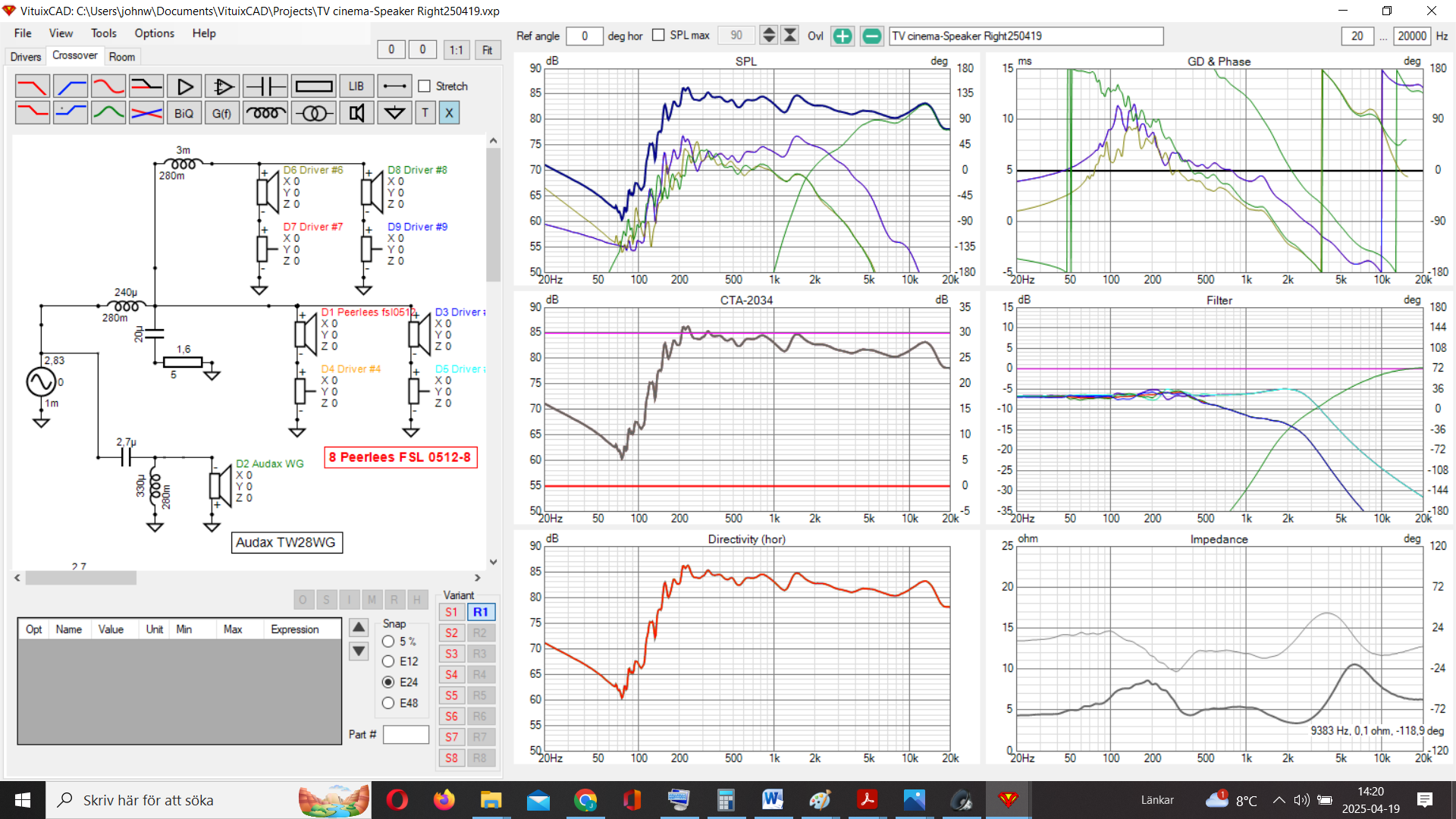

Is any of these 6 parts xover "better" purely technical, phase wise, impedance etc ?
The wiggle at 1300 hz dont exist in my measurements from 2 meters or further away, and i sitt about 3,2-3,5 meters from the speakers.
Today crossed around 3K to the WG tweeter
best regards John

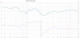

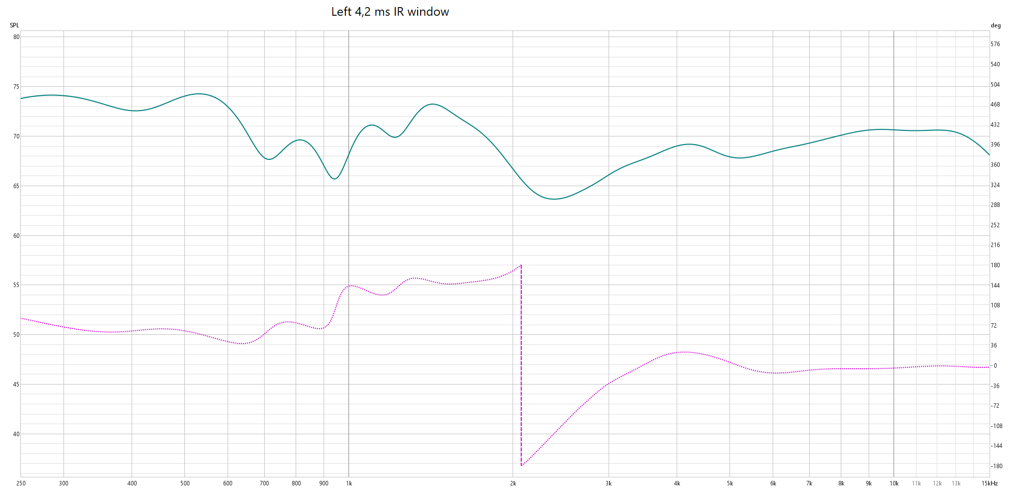

And what is that?
Phase problem ?
4,2 ms ir window
just spl measurement look like this

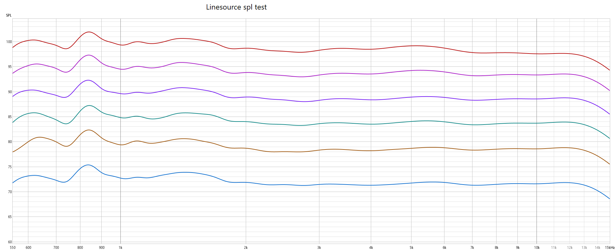

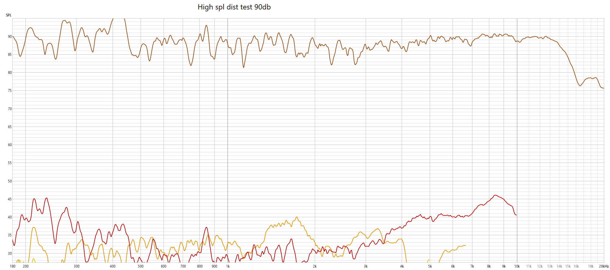

There is a dip and phase changes 180 degrees. What is the difference between this measurement and others?
Different xovers and now more "life-like" measurement with mic in headhigh (as the final possition will be with the speakers up on the wall)
The 2-3 previous xovers both used big coil and notch, and have 18 components.
They where also to big to be mounted inside the speaker at the backside.
Why have you chosen not to set the Y positions in vituixcad?
Mostly because I felt like I didn't have a grasp on what to do.
But now i have make my first try!
Doe´s it seems right?

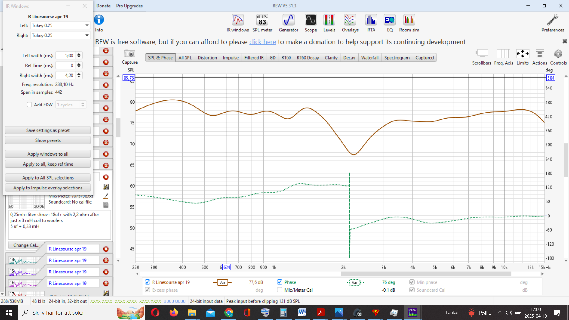

Now you can see the 2100 hz dipp more clearly.
The phase did not suddenly change 180 degrees. The graph shifts the phase when it gets to 180, and starts it again so that it stays on the graph.
The dip is caused by three drivers fighting each other at that frequency. Personally, I would not want the outer woofers running high enough to interfere with the tweeter.
I also don't like the way the responses are shown in that software. I may be wrong, but something looks way off to me.
Why are the cones missing on half of the woofers?
Try this. Remove the tweeter from the sim for a while, and see what the woofers / mids sum looks like. It needs to be smooth. It should look like a LR4 or something. This software is not showing it, and it's showing 12dB summing which doesn't happen.
Okey.
I was thinking "like that", but this is the first time this type of "problem" came forward for me.
Been my originalplan/design to let the outer woofers fall from ca 1000 hz (and not really like it looks today)
But soundwise this also sounded "good", so i "give it a shot"
When i measured the drivers in my cabinette, i measured them in pairs.
So spl in measurement used in all my simulations are for 2 drivers, exept for the WG tweeter.
Thats why i muted one of each in every pair 1&3, 4&5 for mids and 6&7 upper woofers and 8&9 lower woffers

You want to position the tweeter also (x,y,z) or the simulation is not worth a lot. It's only if you place all the drivers correctly on a correct box (the one you use) that it will tell you something valuable as all drivers interact with constructive or destructive interference. If you take a few out and look how the remaining ad up, it will be totally different when you add back the removed ones...
Baffle is not flat - you probably want to model this as the drivers are tilted... this only matters if you have supplied directivity data - like 15, 30, 46, 60 deg FR curves.
If it's 360 deg omni, or at least has equal vertical and horizontal directivity, it would be. But a narrow tall speaker are hardly ever a "point source".
I wrote "2,5 way 9 drivers linesource with pointsourse "function/treat""
And I perceive it as if the sound comes from one point & the singer's voice is exactly where it should be.
What do you want me to call it, so people understand what I'm trying to build? (and to make you happy)
I don't really know what it is. In an other thread about this speaker it was called "line source". But it is not a true line source either because such speaker has no single tweeter in the middle. I just wanted to inform you that it is not a point source, thats all. My happiness wasn't effected either way 🙂
