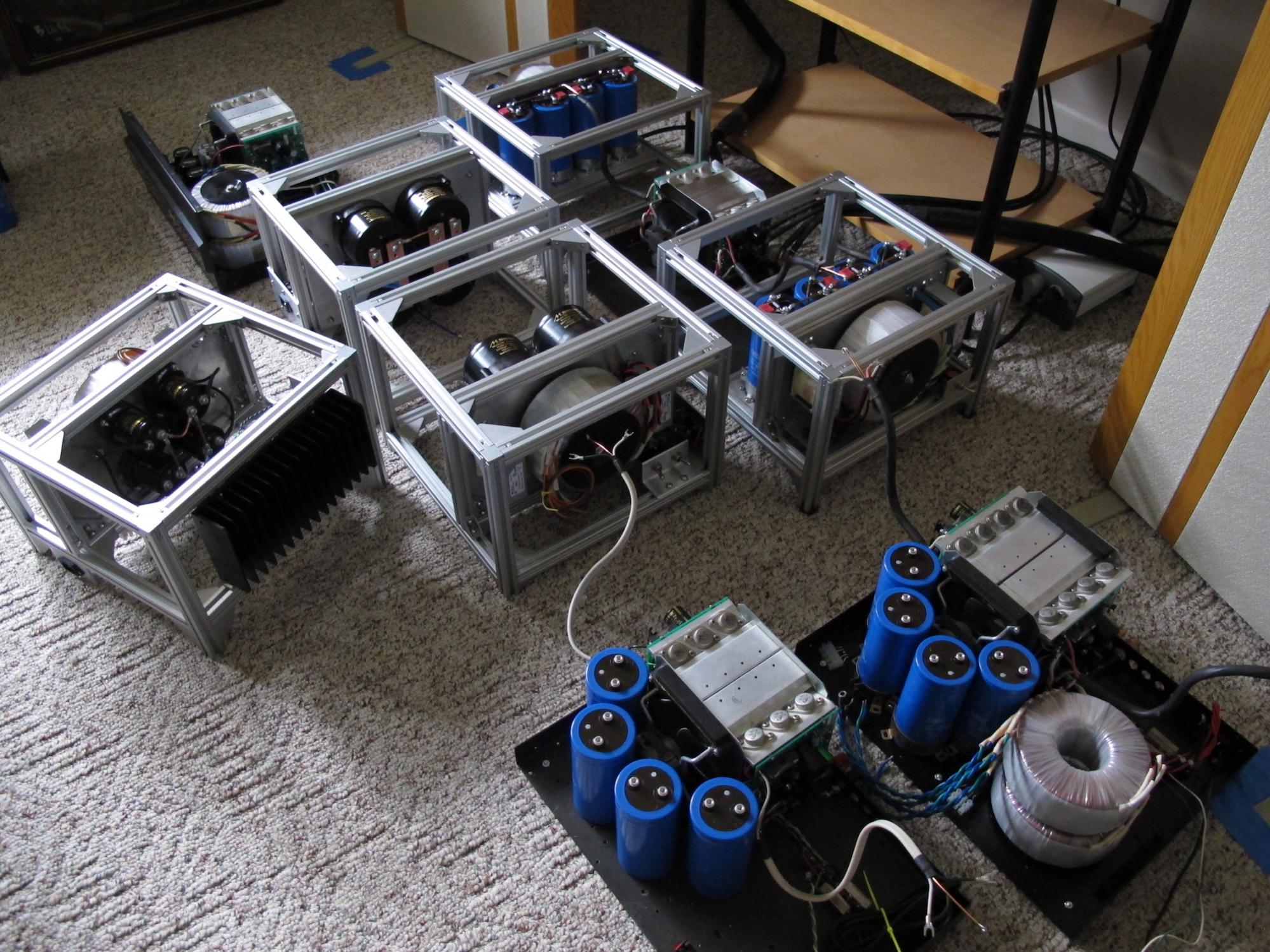

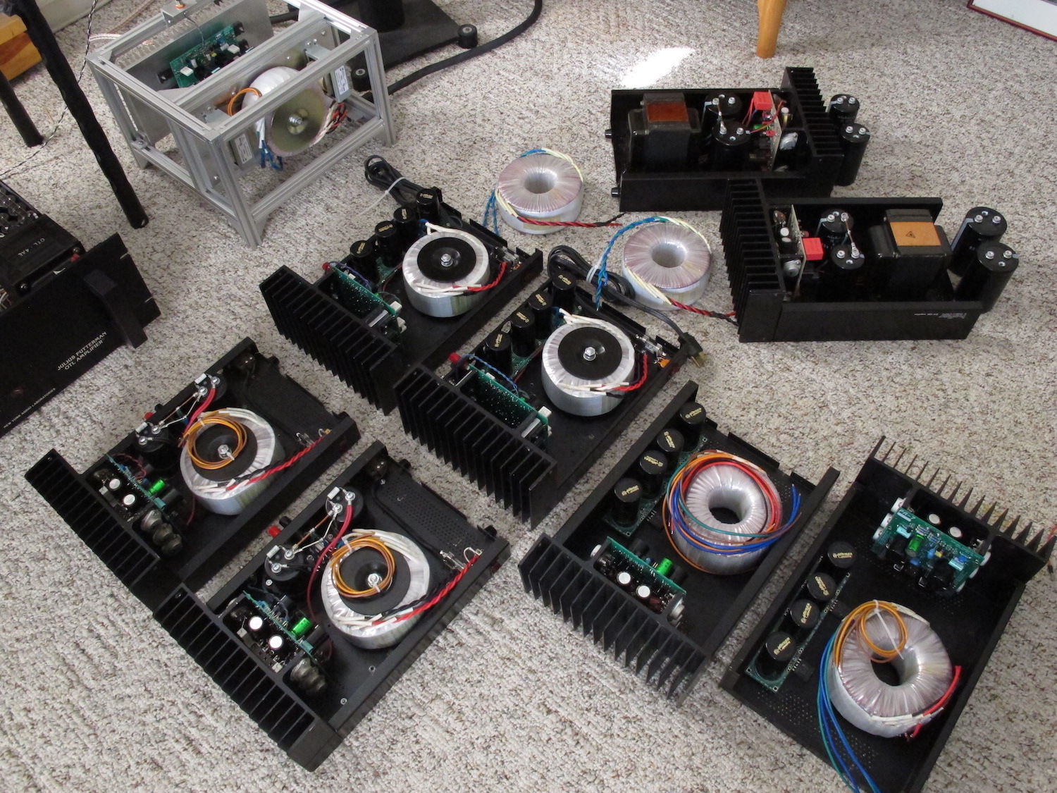

I am busy currently ACTIVELY modeling the ideas and the very topic at hand here.
The basis *were* Hafler based amps, available / affordable scale of economy to have multiple.
Built half with Exicons. All scaled with BEEFY 63 - 82 - 90 volt power supplies,
different brands of caps [which *some* would argue all sound the same]
it would be impossible to detail my very linear pathways evaluating the
hierarchy of these premium grade parts
. These images tell a very limited story,
which supports, the actual building the best damned power supplies (we?) I can.
The CLC frame amps (image 2), are result of significant frustration of being trapped,
virtually confined to a box... I began thinking / building outside of the box.
Things ARE much better... I had to build from scratch to get
what I wanted and needed, I could not "buy it".
Build "better" power suppl(ies) to
test "better audio circuit(s) to
test better power supplies to
test a better...
The power supply is too often neglected,
is likely misunderstood? is too expensive
...for most. I .always. start there...
If I did not already' own, have built, am building
all these amps, I would be buying a freaking 2200II
I will admit to a little obsession with the topic,
I am wading knee deep in chassis's currently,
thinking a lot about this.
*I already typed this, am struggling posting it.
Sorry not to thread jack, it supports my
expressions here, for those unfamiliar
with my posts and build efforts.
