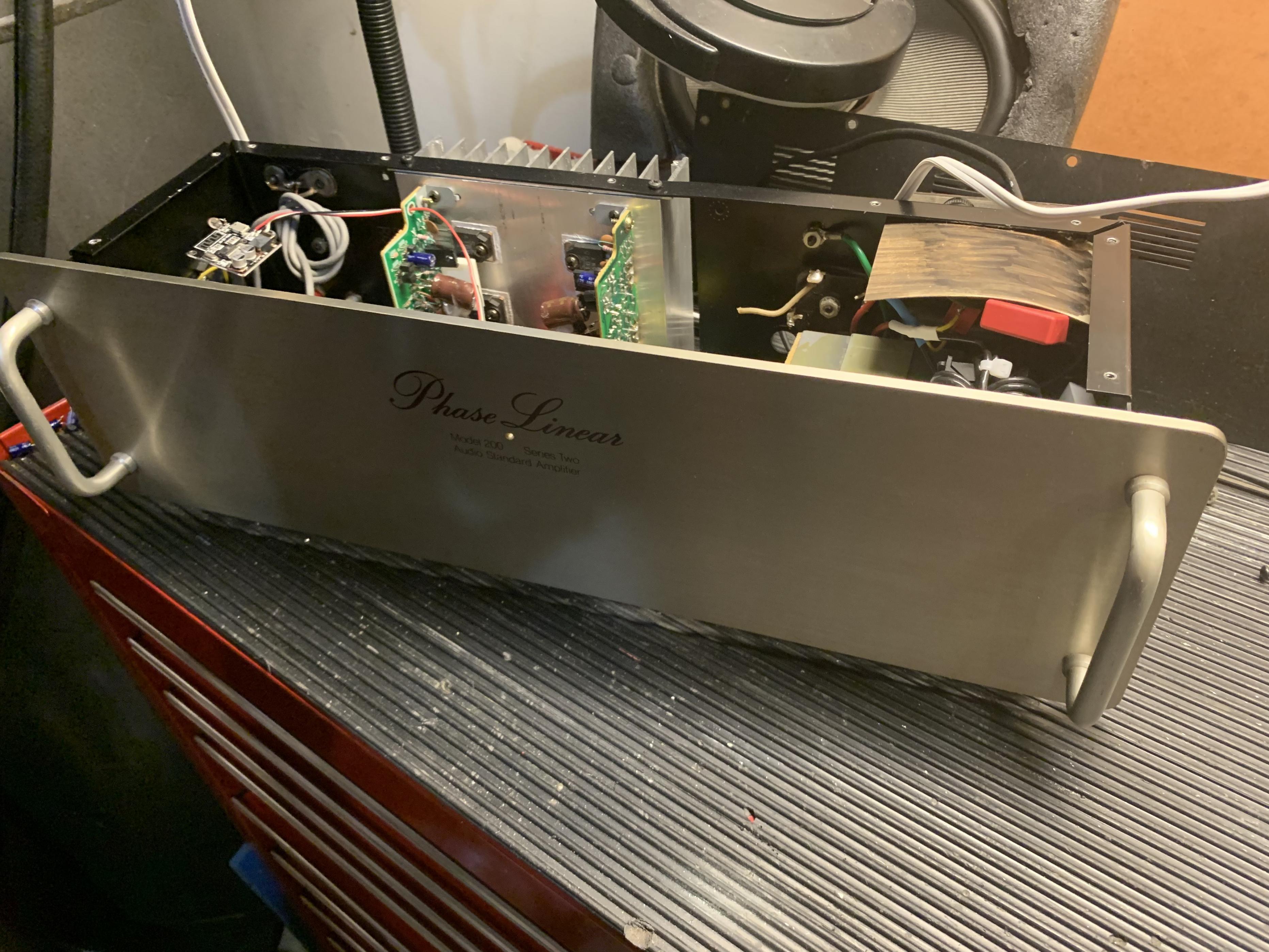

I prepared an HCA-1000 for my mom who listens to the same types of music.
I used Nichicon KW for the large filter caps, Some Nichicon KZ for the smaller electrolytic caps.
The signal-pass through cap in the servo was swapped for a Russian K71-4, 1uf. The multiple cascading smaller bypass caps were all removed, and replaced with single K71-5 .1uf for each rail.
I also replaced the servo op amp with an ad744. There’s a feedback resistor that was changed for a Caddock also.
That’s all I recall at the moment.

What kind of difference do you feel the modifications made? Was it worth the time and effort?
Phase Linears aren’t for people who obsess over detail in the sound. They are for people who play their music LOUD, but not so loud that it’s screeching and obviously clipping. That will cause it to overheat and potentially blow transistors.
I mean, are they really that much worse than anything else from that time period? I mean, wasn't the original PL700 released in 1971? I struggle to think of any 1971 amps that I'd want to own from a fidelity point of view.
Okay, fine, McIntosh made some, but they weren't exactly affordable.
Of course, the HCA2200 blows any of the PL amps out of the water, at least when it comes to linearity.
Each part added a positive change, however I couldn’t confirm the large filter cap difference as the originals were pretty sacked. Most of it was maintenance with the electrolytic caps, the rest was pretty easy since it was already apart. Those Cold War era polystyrenes are very nice parts.
Not any worse sound wise than other amps of that vintage, but the 700’s reliability leaves a lot to be desired. You can’t really get crazy with it. You *can* with a 400, if you have one of several decent output transistor sets in it. Those being the Fairchild PL909, 2SD555, 2SD424, or MJ15024. Anything else really has to go. And only the MJ15024 should be used in a 700.
Actually I *am* a fan of the PL’s - for nostalgia, not for doing anything serious. One day I want to build a reliable 700 into a series 2 chassis. I have ideas.
