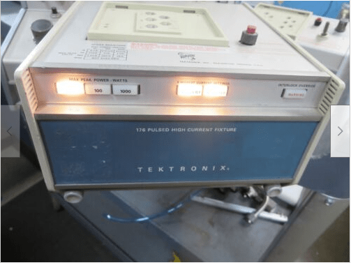

No, you can not use a Tektronix 575 or 576 to match MOSFETs. You will exceed their "safe operating area". Tek made a specific plug-in for MOSFET testing with the 576.
If you measure Vgs(th) for devices, at the same temperature, you will get good matches. NP describes the procedure quite well.
Just to tie this out -- here is a snap of a Tek 176 high current pulsed tester for the 576. It's on EBay for $700.
It's a bit of a pain to take the curves from an analog device like the 576, take a digital pic and use a curve capture program to render the data into CSV.

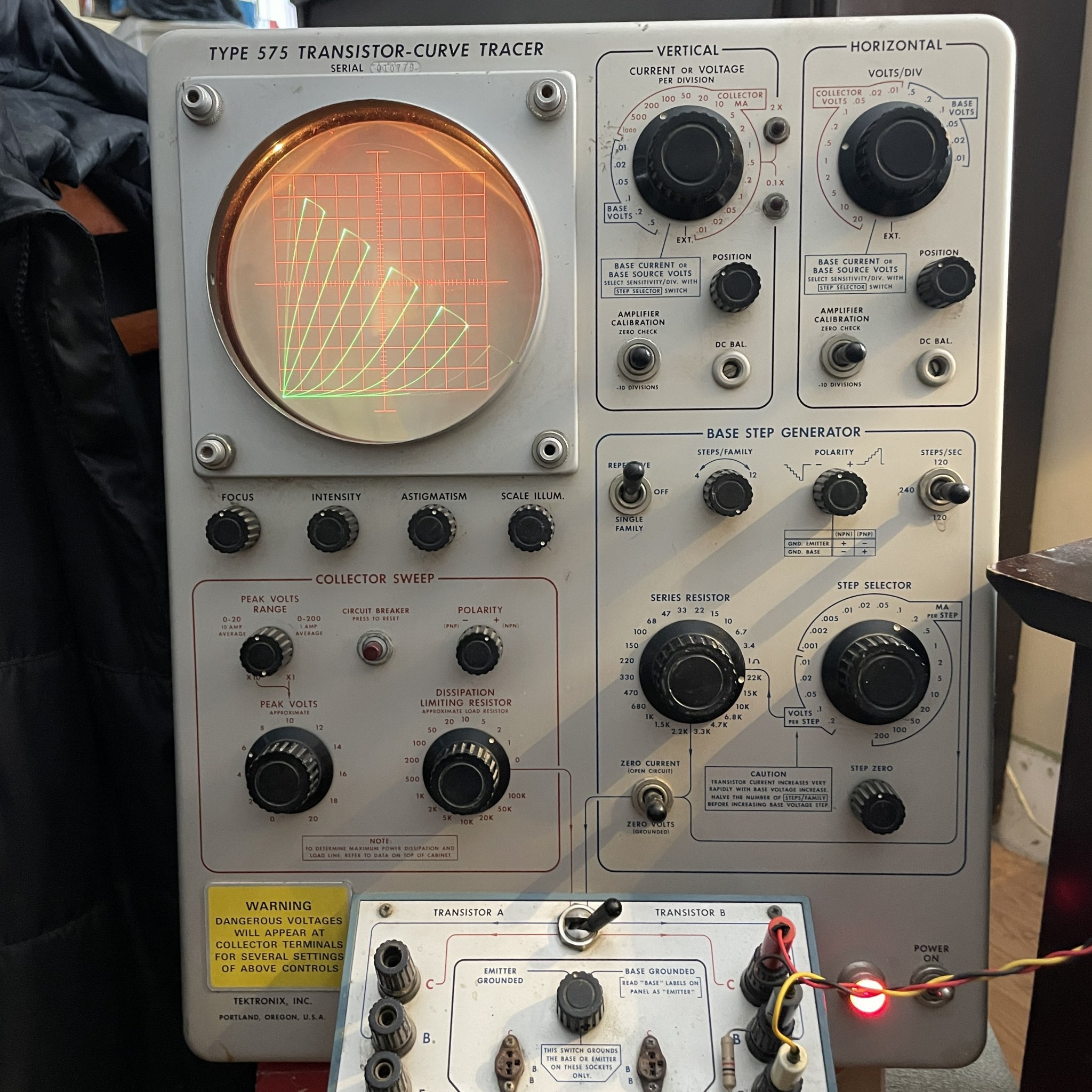

I thought I better add to this thread as well as I had great success today in getting my old 575 curve tracer to work with JFETs. You can see more detail in my thread here.
LU1014 are these real?
I was able to test the LU1014D and it showed very triode like curves. Pretty cool being able to test FETs now with this 60's piece of gear. I'm going to try MOSFETs this weekend...stay tuned.
