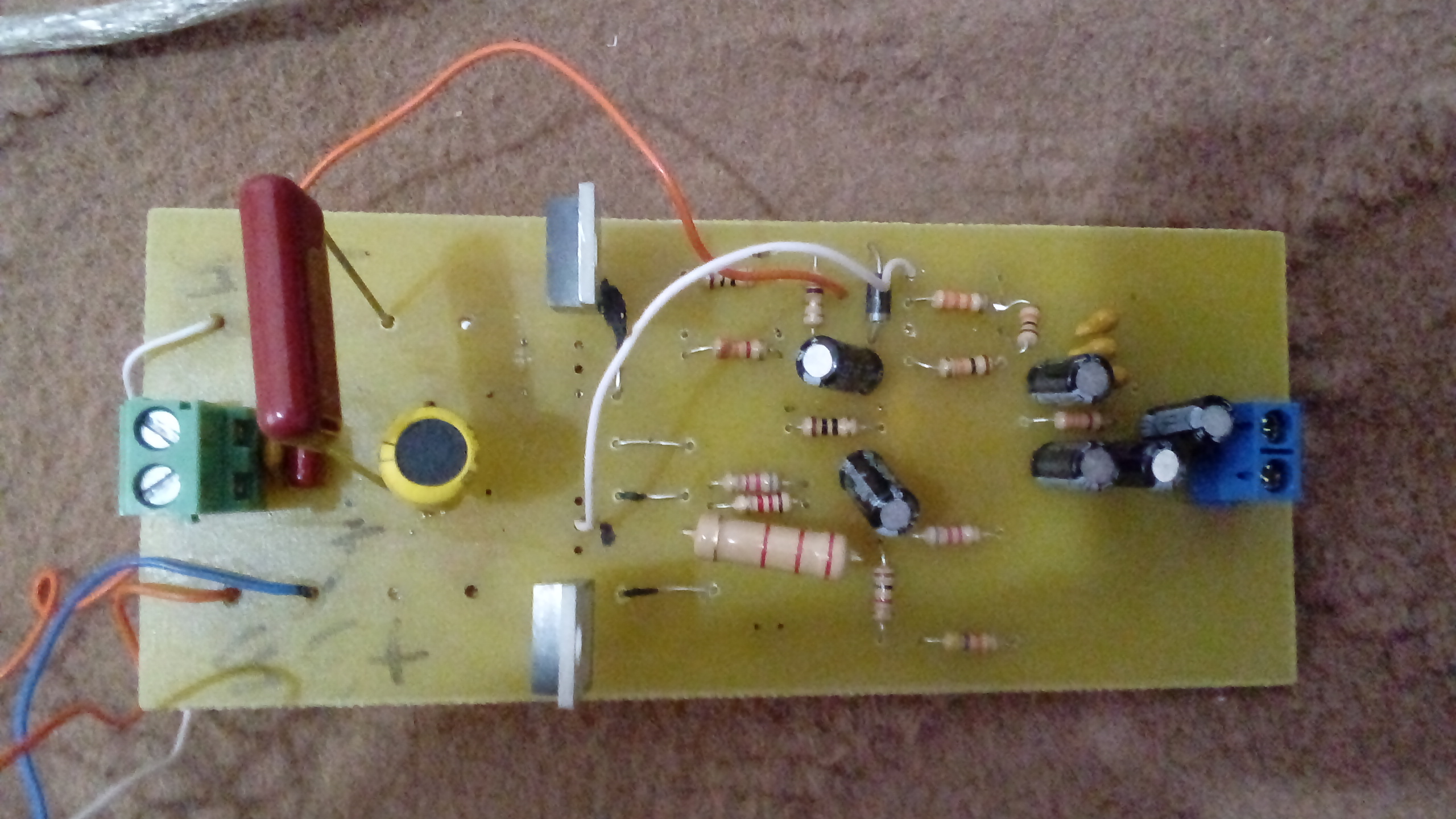

I love amplifier .all of them but class D special for me.l try for 3 month work irs2092 amplifier and result equal waste time and money .
First l build schematic in datasheet .i. Use exactly same part in schematic and supply and mosfet but never work.l use +-35 regulate voltage for supply.the problem is one of. The mosfet is all time On and DC voltage -37 volt in terminal speaker.
This schematic
I change value and replace all of resietor and capacitor due DT ,OC ,...
But it not work at all
I change mosfets such as irf3205 irf4227 irf640
But the result is supply voltage in speaker

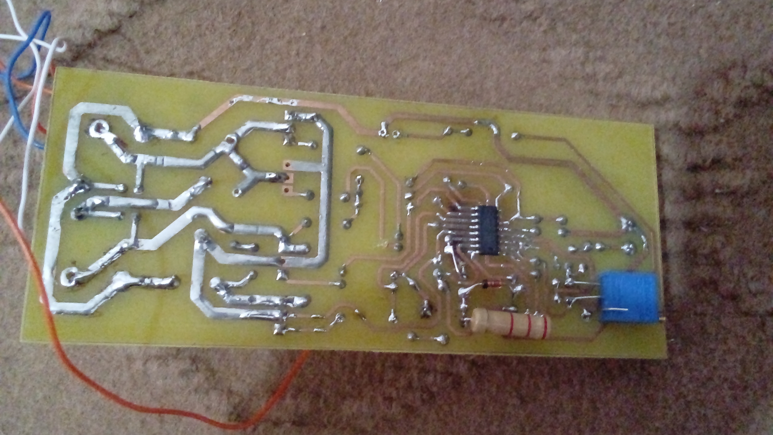

This is board i make

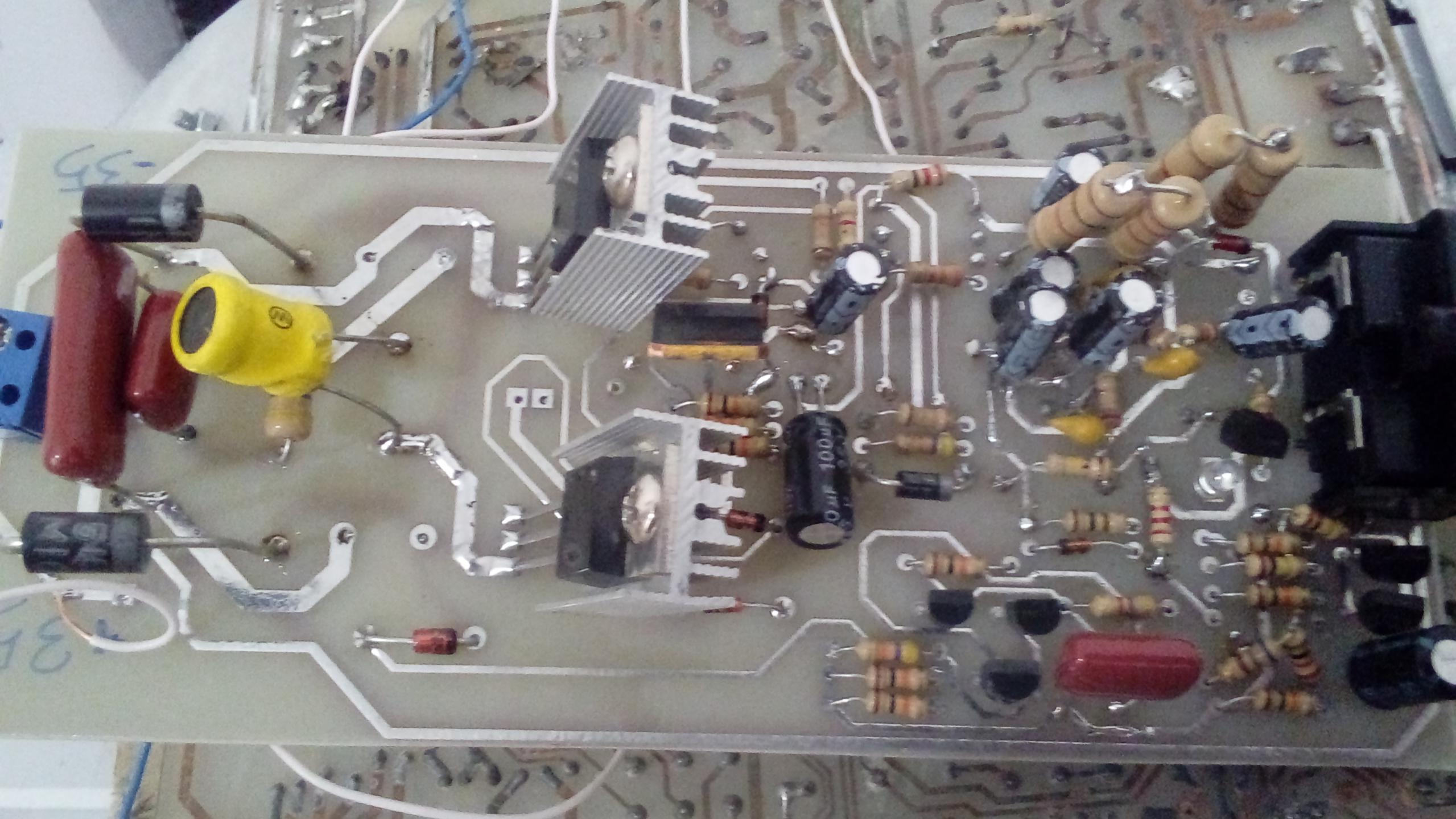

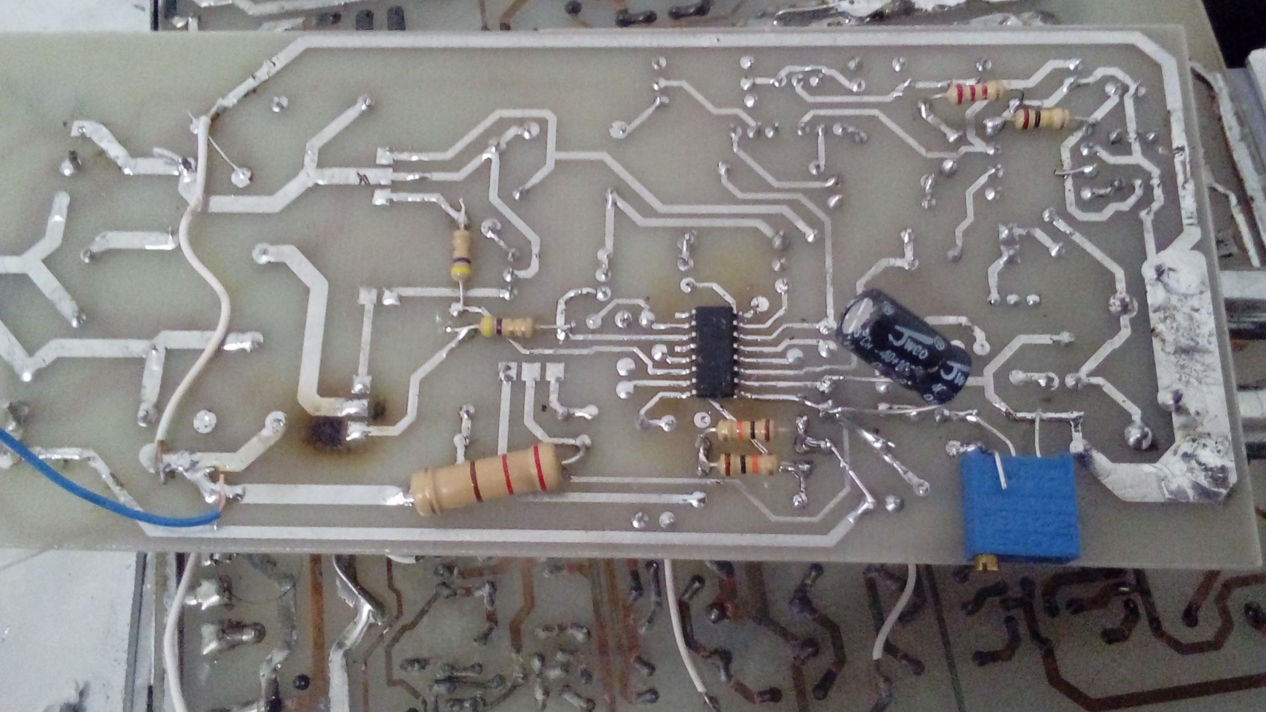

When i tired from this board i make iraudamp7 and assemble the same part in schematic
This borad iraduamp7
This amp also not work and the same problem.

Have you been around it with an oscilloscope ?
Are power supply voltages all correct ?
Does reset pin go high and low ?
Does irs2092 put out hi and lo pulses to mosfets ?
The 2092 should have 100nf very close to supply pins.
The mosfets should have 100nf from power supply pins to zero volts very close.
I have designed a few amplifier s using irs2092 and they all work.
So there is a problem in your circuit.
I havent oscilloscope.
I measure voltage with voltmeter and i sure +-35
I dont think cap104 help for run irs2092
But i put this caps near supply and mosfet
Dosnt work yet
